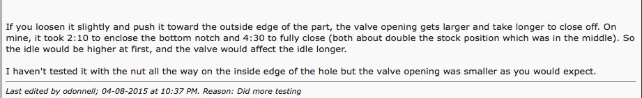

wonkipop   mine does the same. have done all the checks back...   Nov 7 2021, 04:50 PM

Van B   The temp switch is an interesting point. If in fa...   Nov 8 2021, 09:17 AM
wonkipop   The temp switch is an interesting point. If in f...   Nov 8 2021, 04:16 PM
emerygt350   The temp switch is an interesting point. If in ...   Nov 8 2021, 05:30 PM

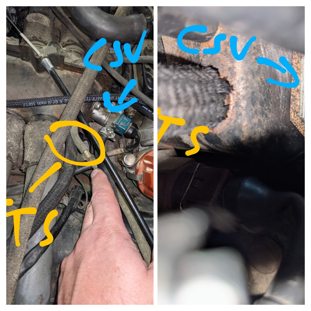

Van B   Is the cylinder head temp sensor the one on top of...   Nov 8 2021, 07:16 PM
wonkipop   Is the cylinder head temp sensor the one on top o...   Nov 8 2021, 07:28 PM
Van B   I was hoping you wouldn’t tell me that was the C...   Nov 8 2021, 07:49 PM
wonkipop   there is a technique for getting it out. and the ...   Nov 8 2021, 08:07 PM

Van B   Ok folks, I’m trying to be cool here, but I canâ...   Nov 11 2021, 11:03 AM

wonkipop   i've just remembered something too about the h...   Nov 11 2021, 04:39 PM
emerygt350   You can also do the reverse. You can pull the cle...   Nov 11 2021, 05:24 PM
wonkipop   yes @emerygt350 , that would all work to duplica...   Nov 11 2021, 05:34 PM

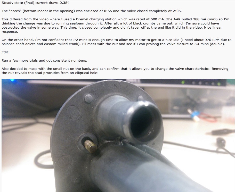

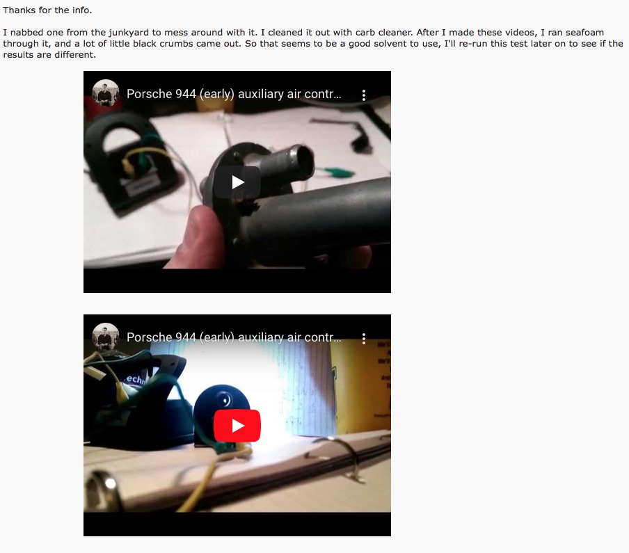

Van B   Found this on the YouTubes: FGEvf16nNQM This is e...   Nov 12 2021, 05:44 PM
StarBear   Found this on the YouTubes: FGEvf16nNQM This is ...   Nov 12 2021, 06:34 PM
wonkipop   @Van B & [b]@[url=http://www.914world.com/b...   Nov 13 2021, 06:05 PM
emerygt350   You have to do the aar tests. They cost nothing a...   Nov 13 2021, 08:48 PM
wonkipop   i just did a cool start. its about 4.5 hours later...   Nov 13 2021, 09:45 PM
wonkipop   i also have just had one other thought for Van B. ...   Nov 13 2021, 10:03 PM
