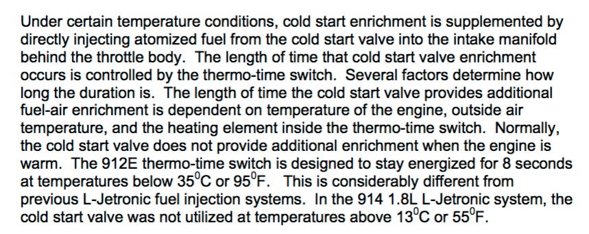

after reading one of your posts a few back where you mentioned the 912E manual you were looking at, i searched that up.
came across something i thought was interesting.
they really changed the characteristics of the cold start injector and thermo switch on the L jet 912 2L.
its currently 19.8C right now in melbourne.
maybe its a little cooler in the garage.
but its definitely not 13C out there.
and it definitely ran off the cold start injector for sure when i fired it just then and nothing else. but who is to say that info there is strictly correct from that manual.
point is i found it interesting that they really beefed up the cold start for the 912E.

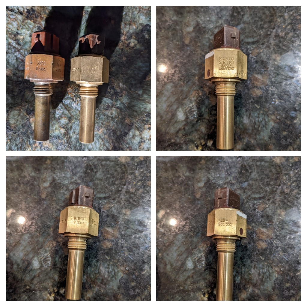

Regarding your 912E reference, that is entirely determined by the thermo-time switch. Essentially, what that manual says references a TTS that is NLA.
You can see here that my old dead switch was a 35c switch (912E). The new Nissan switch is 19.5c. But both are still 8sec.

they take time to reach that cut off temp as well.
i'm betting the 914 works approx like this.
at 55 its on for approx 10 seconds.
and by 65 (or 68) its off.
and it takes about 8 seconds to get to that cut off.
that kind of spec would meet the crazy demands of the EPA in 73.
68F was the temp the EPA was obsessed with.
anything could switch on under that temp for a cold start, but above that temp they saw it as outside "the law" when they cracked down.
VW used 65 F to give themselves a safety margin on EPA edicts.
meaning - start your car at 60 and it fires for about half that time. say 4 seconds.
and below 55 it can theoretically fire for even longer because its going to take longer to hit 65. hence references you find to it operating for anything up to 20 seconds max.
once the electricity hits it it will reach 65 and cut off no matter what, from a really cold temp even well below 55 by about 20 seconds later.
thats my take.
but then they come along with the 912 and they want it to work at a higher temp for that 8 seconds. which means it must fire for longer when its down at that lower temp of say 55? and the EPA must have relented and said, yes you can have that, its only on for 10 seconds, we will allow it, it cannot operate as cheat device, etc.
or is my logic out here?
whatever it is they wanted more fuel dumped in the 912 for longer and at even higher ambient temps to get it going.
i might be a research monster but i can only find stuff experts have written.
and there is sweet F A out there on these early L jets covering this particular problem.
it seems 928s suffered a bit from something similar.
and there is discussion in forums about symptoms not unlike this with ours.
i need to find out more about 928s of which i know zero.
i think they have an AFM and not a mass flow meter like late 70s 911s.
but i don't really know.
i do know that 964s have an AFM with flapper just like ours.
porsche reverted with those.
it didn't work too well i believe as they like blowing up their AFMs from stories i have heard. bit of a big backfire and its all over in there.
