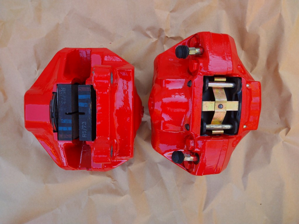

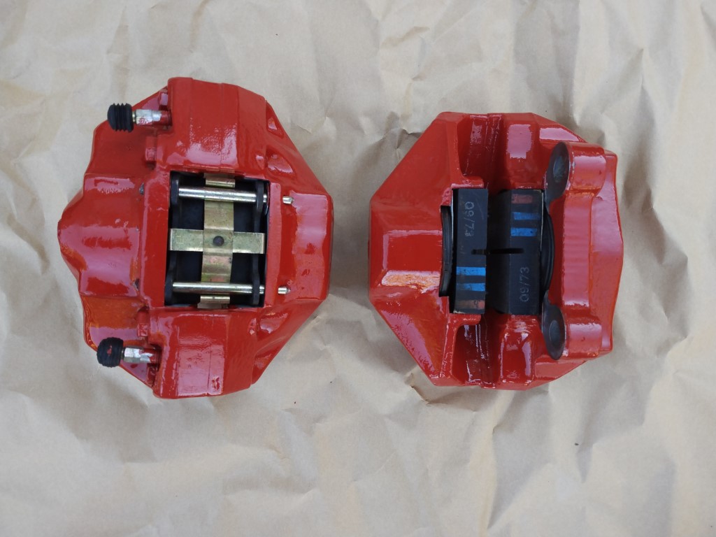

Short version: for sale, a pair of "NOS" front brake calipers for early 914s, painted red.
Long version: I had these calipers advertised in another thread a few weeks ago; these came to me as spares for my 1974 street car. A fellow 914World buyer snagged them.
Unfortunately, when the buyer went to install them he discovered the offset was wrong; after measuring the offsets between those calipers and some I have at home we discovered that these were not for my 1974 car but instead for the earlier cars (1970-1972? Someone please verify the years.)
Back story is that a prior owner of my 1974 street car installed BMW calipers but instead of milling the mounting ears to correct the offset he chose to install the early rotors onto my car. Why he also had a set of NOS calipers is beyond me, but I guess that gave him the opportunity to put those on later.
Regardless, I need to "make good" on this transaction. I am shipping another set of calipers to the buyer and he's agreed to hold these NOS ones and ship to the new buyer.
As noted, I'm convinced they're NOS and the buyer confirmed this. Before he realized they would not fit he painted them red, so it's very very clean.
Asking $250 shipped Priority Mail CONUS. PMB gets $350 for a pair of rebuilt (plus $200 core if you don't have that) so I think you'll be pleased with these.

Got to be LATE calipers because they are dual bleeder and have thick brake pads.

Hmmm....well, the offsets indicate that they're for early rotors. They are 3mm farther inward than the late calipers. When the buyer tried to install them on his 1974 car they were contacting the outer face of the brake rotor.
This means they are even more rare than I thought! Once in a lifetime opportunity for someone to have a set of NOS new-style, dual-bleeder, bolt-through calipers on their older car. (IMG:style_emoticons/default/drunk.gif) (IMG:style_emoticons/default/beer.gif) (IMG:style_emoticons/default/biggrin.gif)
I'm confident someone can use these new calipers. I need to make the situation right for the buyer, all proceeds go directly to him. Let me know what you need!
Sorry for the difference in scale; the buyer has the new red ones and I have the used yellow ones. The red is the ones I'm selling, the yellow are a set of known-1974 used calipers I have on hand (I'm shipping the unpainted ones to the buyer for his car). You'll note that the distance from the mounting face to the center of the rotor slot is 3mm, exactly the difference between early and late calipers. So I'm very confident these rotors will bolt up to an early car.

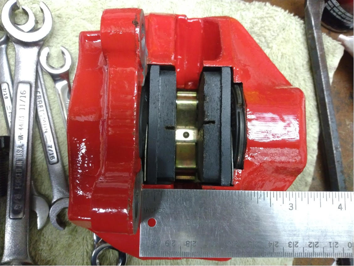

Nothing? Here's what they looked like before painting.

In your picture with the yellow caliper I see an old late caliper next to it...lay the ruler on it just like you with the red caliper in the picture above...
I'm looking for the distance from the part that shows between 2 3/4" to 3 1/4" in the red caliper ruler picture
Wondering if this dimension is the same or not between the known late caliper and the mystery caliper

@PatMc , in the photos above, the red ones are the "NOS" ones. They are the same calipers as the ones two posts above, but the buyer painted them red when he received them, before test-fitting and finding that the slot is hitting the outer face of the rotor on his 1974. Looks like he replaced the pads, too.
The photo of the yellow and unpainted older ones, both are 914 "late" calipers. Exactly the same dimensions, I measured the yellow one but I've already shipped the unpainted older ones to the buyer so he has a set of known-late calipers.
So...where ya going with this? What are you thinking?

I'm seeing the dimension in your picture to be about 1.5", which would correspond to the dimension of what we know to be the earlier casting, so it would have the shorter piston in it. I guess it's the mid model unicorn set.... Double the price due to rarity.

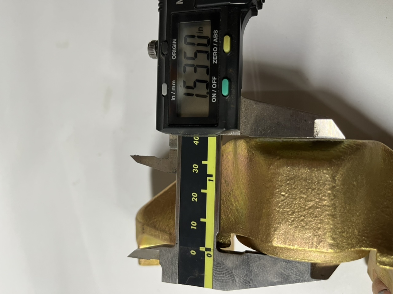

@Geezer914
John, when you get the replacement calipers (should be today?) take those measurements above on them.

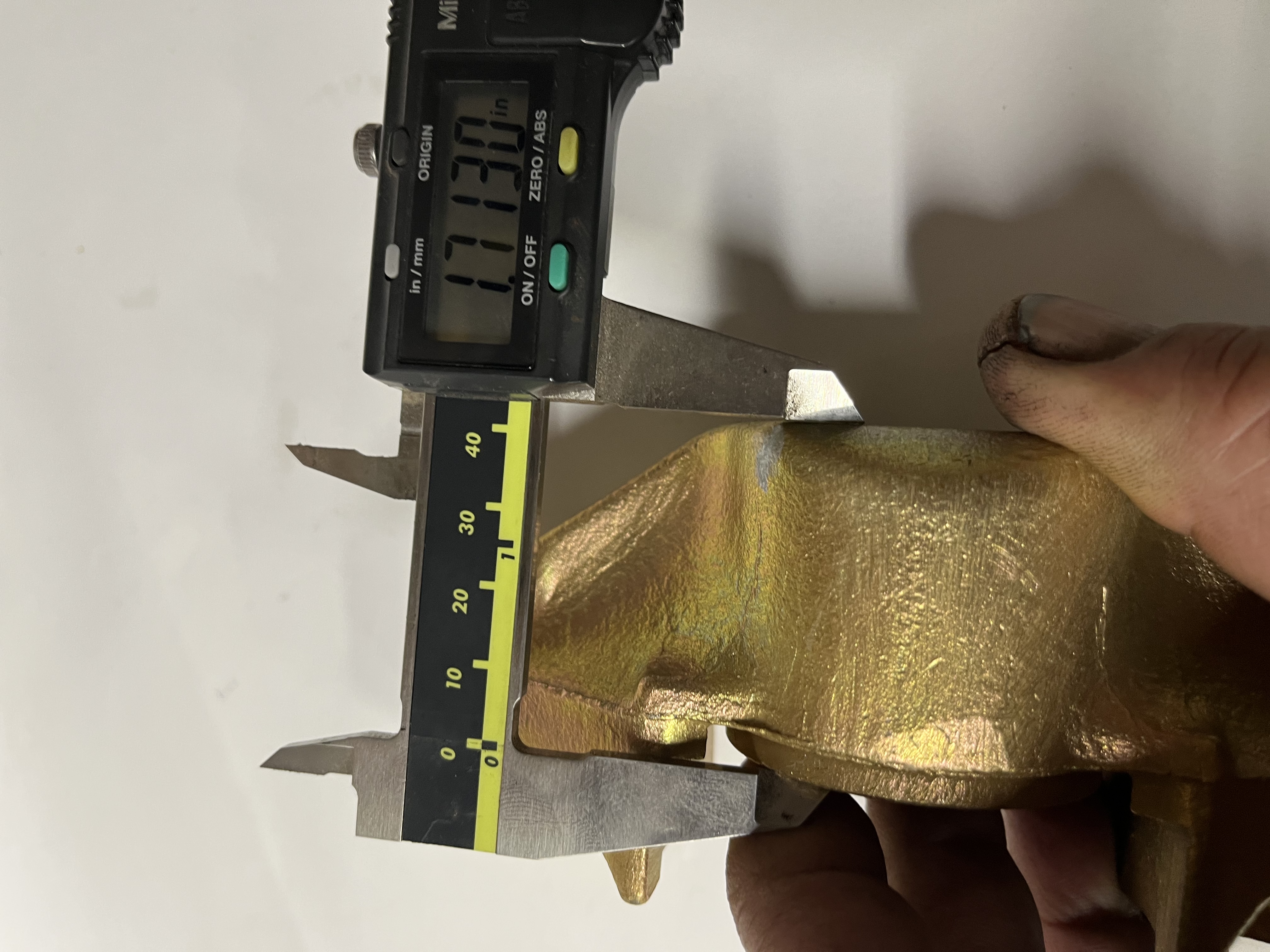

The red calipers measure 1.537 inches. The new ones that fit from your race car measure 1.714 inches So the red calipers fit 70-72 cars with early rotors.

Thanks John! So the ones I sent this week off the race car bolt up Ok? That's a relief, glad to read that. This supports they're late calipers and there's nothing funky on my race car*.
