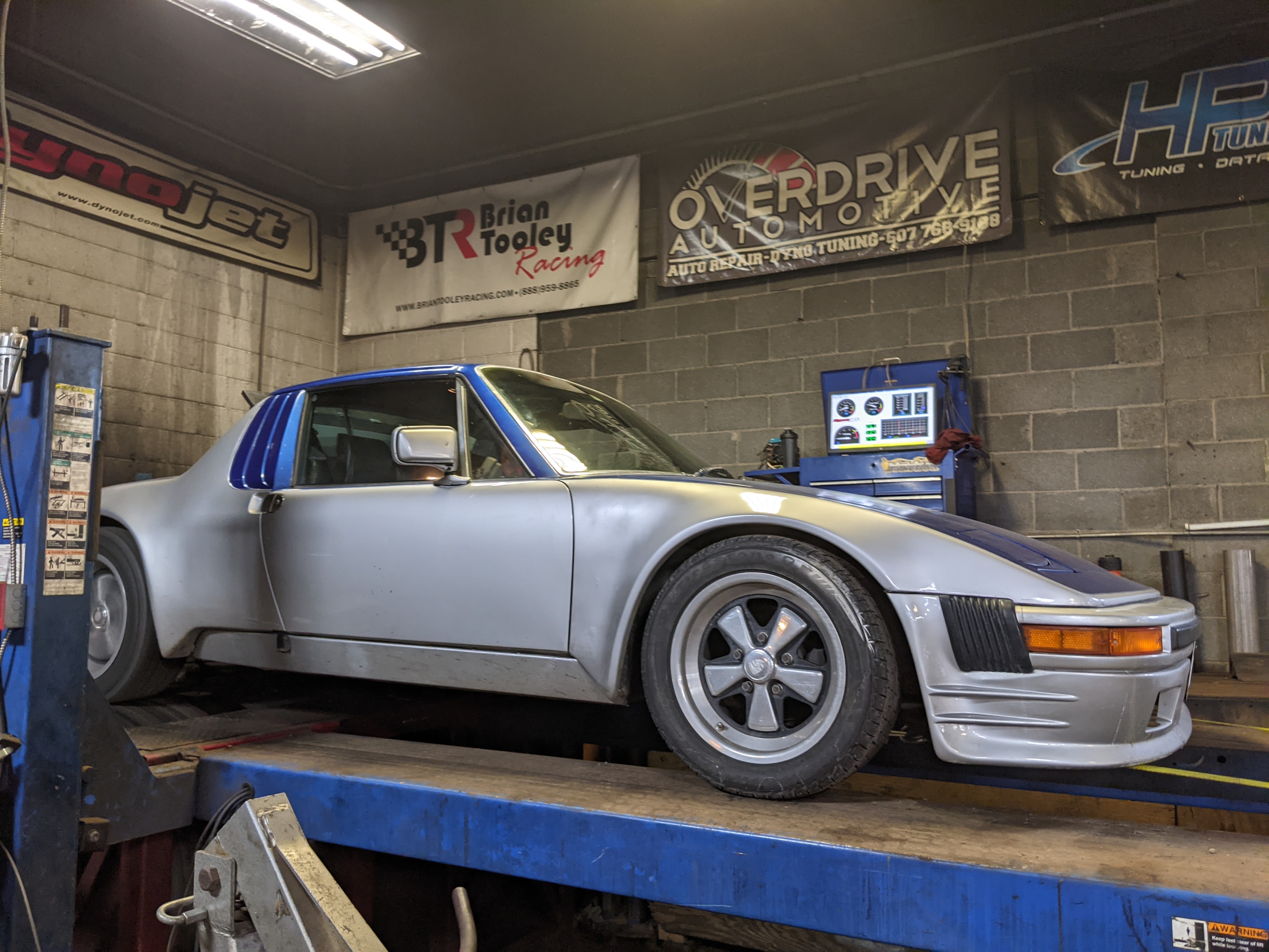

Just got back from the Dyno. We were able to tune the mps reasonably well. Still have a little leanness at wot and lower rpms and richness at wot at high rpms but overall pretty smooth. Waiting to get the figures from the shop. If I remember right it was 77 horsepower and 105 lbs of torque at the wheels. I am running big 225/50r16s so I suspect I would pick up some more with lighter stock rims and tires....
I will post the graphs as soon as I get them.

Tom at overdrive automotive in Binghamton NY is great. Drilled a bung in my exhaust (muffler, not the stainless) for the 02, probably 8 pulls plus all the idle and part throttle tuning. He really is great to work with. I described how the mps works, the ECU idle richness, etc. I have the tangerine racing tuning kit on my mps. He just dived in and had fun with it. One thing I will mention, we tried to advance the timing a hair to see if there was more there. We lost 20 horsepower with just a couple degrees of extra advance. Crazy how bad it was.

Funny thing is everyone in the shop "knew" when we screwed up the timing. They were not paying any attention till that pull then everyone was like "ouch!" What happened!?

It got super rich, black smoke everywhere. Lost 20 horsepower. Tom said he maybe put 5 degrees into it.
Judging by the couple hundred rpm at idle increase I think that was about right.

QUOTE(Van B @ Nov 22 2021, 10:17 AM) *
doesn't the 123 ignition let you create a custom ignition map; as in being able to advance at high RPM without being forced to advance across the whole curve?
I'm struggling to get my head around how advancing further causes increased richness. Unless it was so much advance that it was igniting prior to sufficient compression was reached to achieve a full burn.
I think that is exactly what happened.
And I have the non-bluetooth 123 so I believe I only have the built in mapping to work with.
