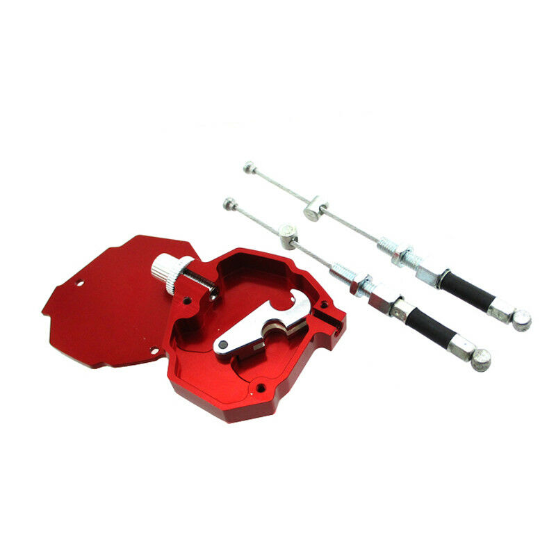

What part of your body was amputated? Could you add a hand controlled clutch control level like a motorcycle clutch to a custom made shift lever? Clutch modulation would be the same as a motorcycle. Of this is possible you could be driving in a couple days. Sorry to ask for additional personal info but it would help us understand how to best assist.

What part of your body was amputated? Could you add a hand controlled clutch control level like a motorcycle clutch to a custom made shift lever? Clutch modulation would be the same as a motorcycle. Of this is possible you could be driving in a couple days. Sorry to ask for additional personal info but it would help us understand how to best assist. You know Rick, that could work. My cousin lost his leg and had to alter his life. I just assumed that was what was up. A devise like this built to proper proportions should allow a tall shift knob, angled forward a bit with a m/c clutch handle. ![]() |
