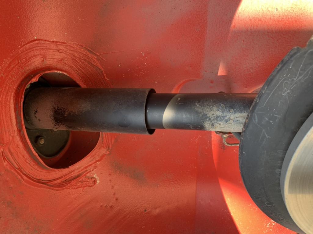

Are the 914 front struts green or black when stock? Mine are black but I have seen green ones around as well.

I'm no expert, but I believe Boge's were black. I think some may have come with Bilstein's. I believe the Bils were green at the time. Come to think of it I believe they also offered Koni's on some models, so Orange

914-4 came with Black Boge. In 1973 Bilstein Green gas shocks where offered.
914-6 came with Gray Boge

My ‘74 parts car has black struts with green upper sleeves/hats… and I’ve seen this before on other cars. Actually I also have a set of 5-lug 3” struts that came to me the same way. Was this how they came from the factory and what inserts would they have had? I don’t believe these are the rare bilstein struts as those are ALL green if I’m not mistaken.

Some Bilstein inserts came with green Bilstein top caps/dust caps.

Yes aftermarket used the black Boge base
Koni had Orange Top
Bilstein had Green and Yellow

Ok so inserts would have been “ bilstein for boge struts” rather than the rare all bilstein set up.. got it, thanks.

FWIW I had some NOS 914-6 front struts that were gray

Factory Bilstein"s were ALL green.
