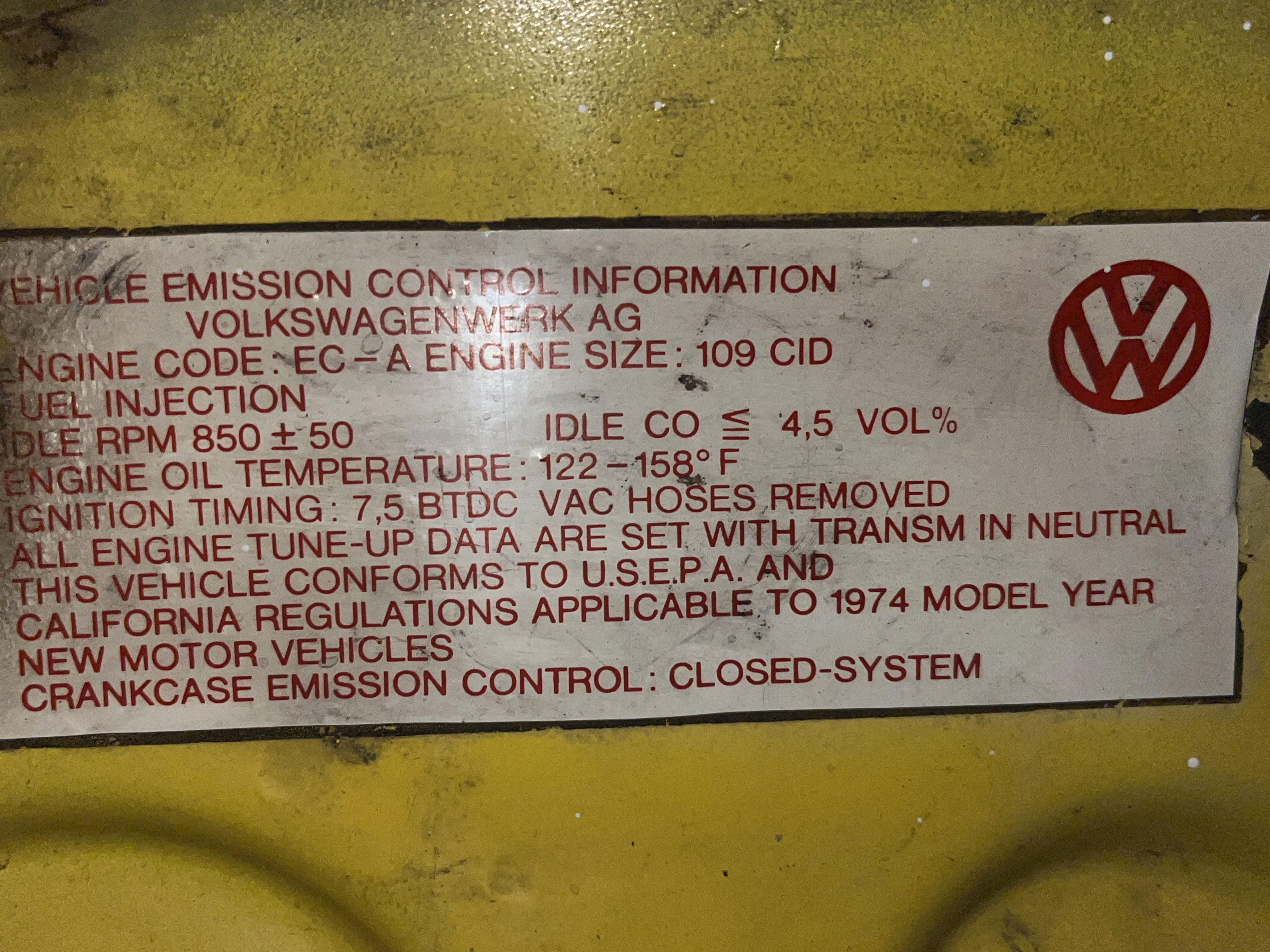

Here is another data point

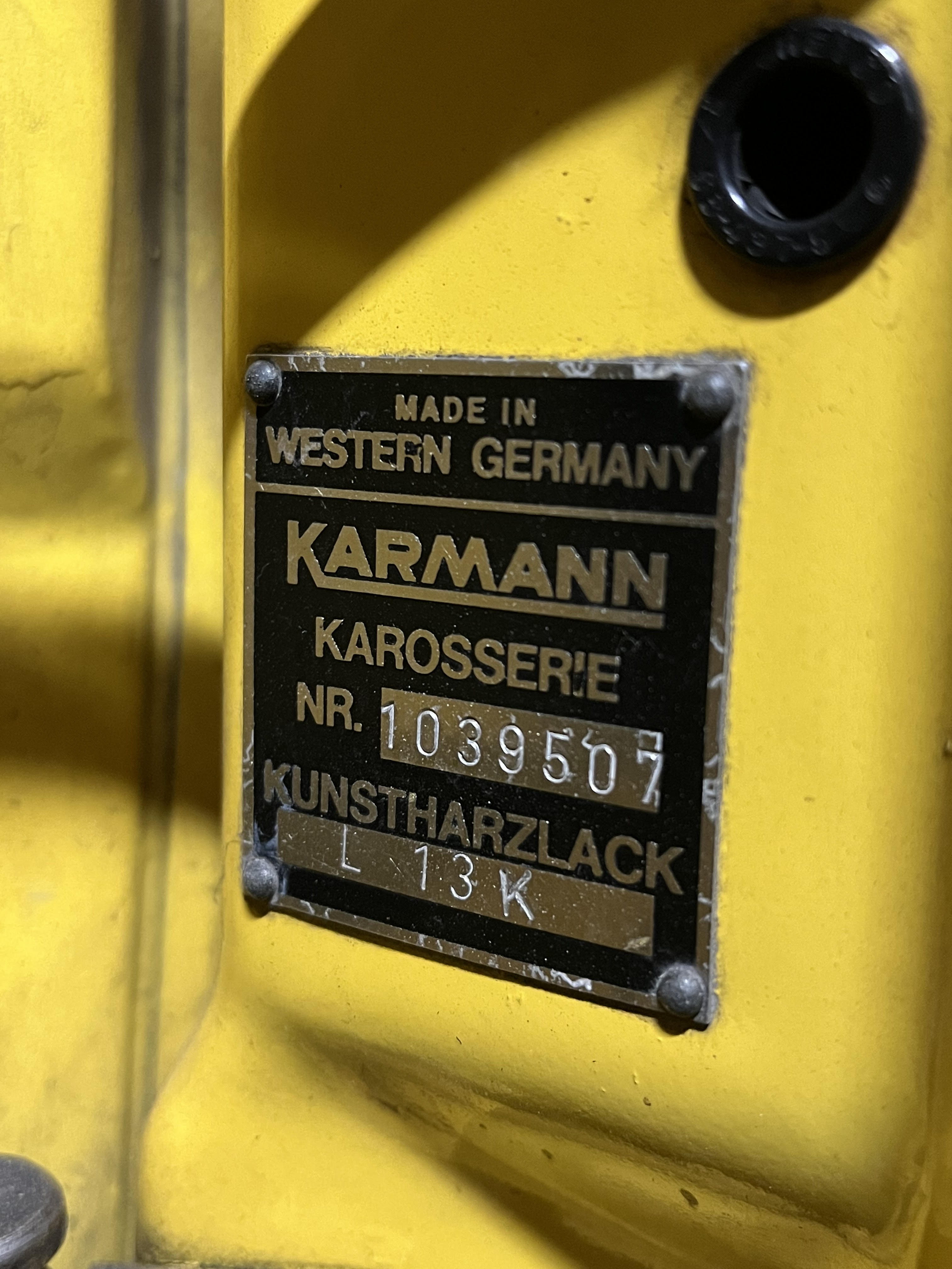

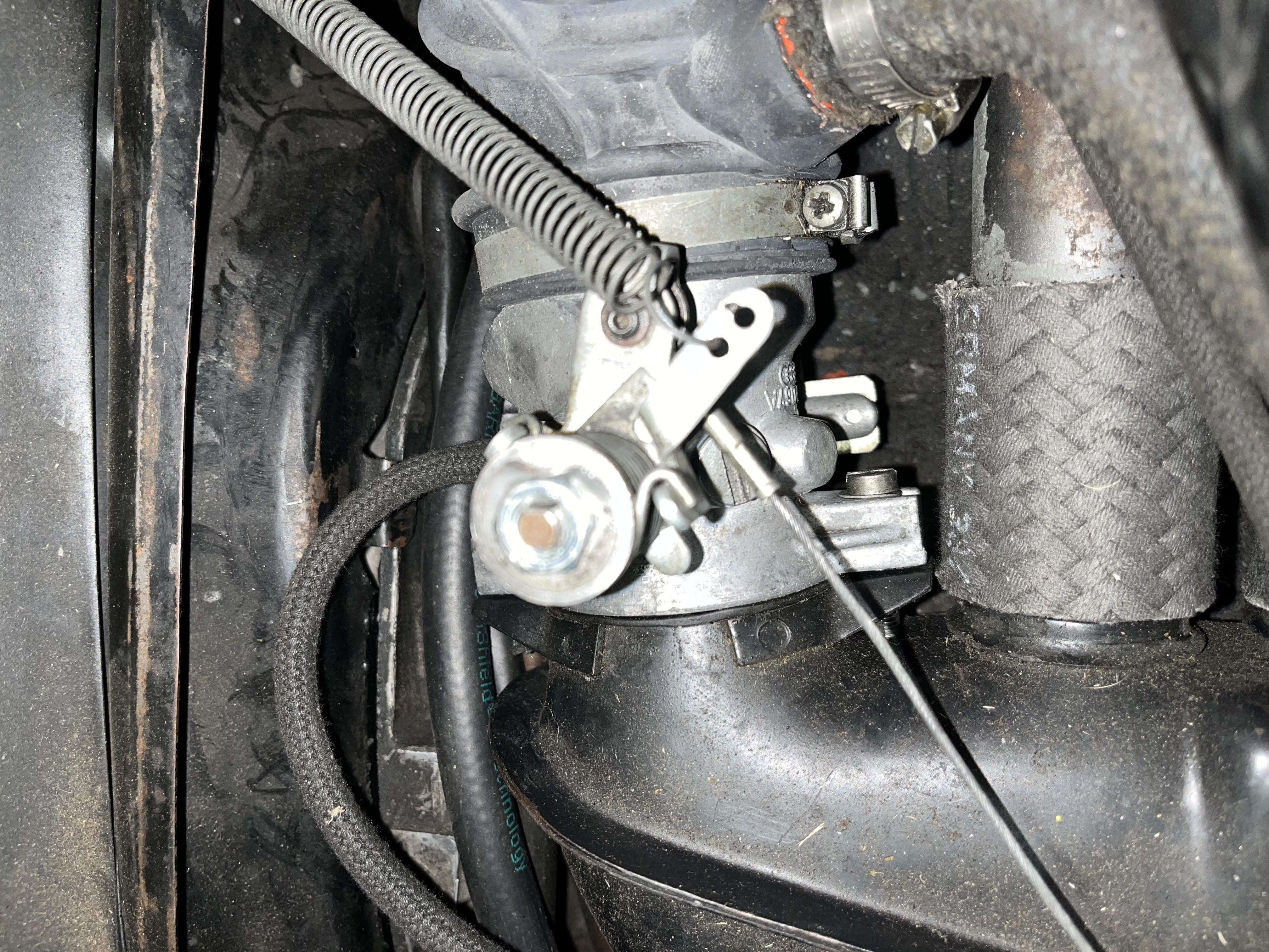

And the rest (wouldn't let me attach to previous post)

@jonferns
thats a sweet looking car you have there sir. and an EC-A. (IMG:style_emoticons/default/beerchug.gif) (IMG:style_emoticons/default/beerchug.gif)
i see something interesting.
am i looking at it correctly - does the retard port on the throttle body not have a hose connected to the retard side of the distributor?
do you know which state your car was delivered and sold new.
thanks for contributing.

@wonkipop
There is no retard port on the throttle body. I will have to go back out and check the layout of the hoses from the distributor.
Car was delivered and sold new in California

QUOTE(jonferns @ Dec 10 2021, 01:45 PM) *
@wonkipop
thanks mate.
i can see the retard line going off somewhere.
i'm guessing its been maybe plumbed with a T into the decel valve line?
its interesting because it maybe has the same plumbing set up as @L-Jet914 car.
his EC-A was sold new in california too.

@jonferns .
so your throttle body is one of these?

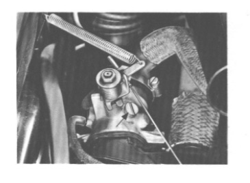

ok @L-Jet914 i took a look at your spring set up in your photos this morning.
could not find anyone else in photos in thread who had the spring reversed and connected to the plenum like yours.
your throttle body is the same as all of ours in terms of its top set up.
i think you need to take a look at it. the spring is there in case your throttle jambs or its main wound spring screws up and your throttle sticks wide open. its the failsafe that is meant to pull the throttle closed. the way its hooked up i think its going to do nothing?
what might have happened is someone along the way, familiar with VW rear engined set ups has, (out of habit?), hooked it up the rear engined way. which works when the throttle cable is coming through from the opposite direction. they have not thought it through properly?
i've attached an illustration from the factory manual.
i've attached a photo of a 412 engine bay where you can see how attaching the spring to the plenum would make sense for the rear engined car - but not yours?
i'm not there to see it in the flesh, but i blew up the photos and i see nothing different about your throttle body that shows its any different to ours in the top assembly, wound spring catches etc.
