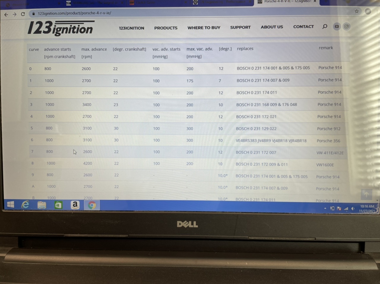

Got partial load in a good range centered around 13 to 13.5. Give it a little and it drops to 12, take of the gas a little it moves up to 14.7 (not sure why it hits it on the mark like that but there you go). I noticed that as I approached what seems to be good partial mixtures, my idle mix was changing and that as I get closer to where it probably should be that adjustment knob on the ECU is getting closer and closer to the factory setting. Still working on the WOT. Started out Lean across the board, backed out the stop screw and got that to around 12 never leaner than maybe 12.5 or 13 but I noticed after my partial load tuning it looks like my WOT is running a little lean again. Need to double check that when I get another chance. Sucks how all these adjustments interrelate. My 123dizzy is running on retard (A) at the moment. I cant stand high idle. Not sure why it bothers me so much, but it does. Luckily I can access the pot without removing the dizzy so it's easy for me to switch back and forth. When I am all done I might give advance a try again. Here is a plug after an hour of mixed driving. Looks pretty nice. |
