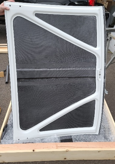

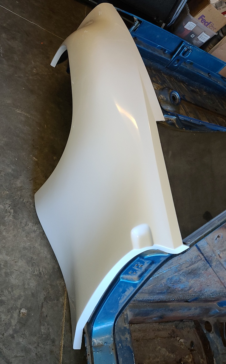

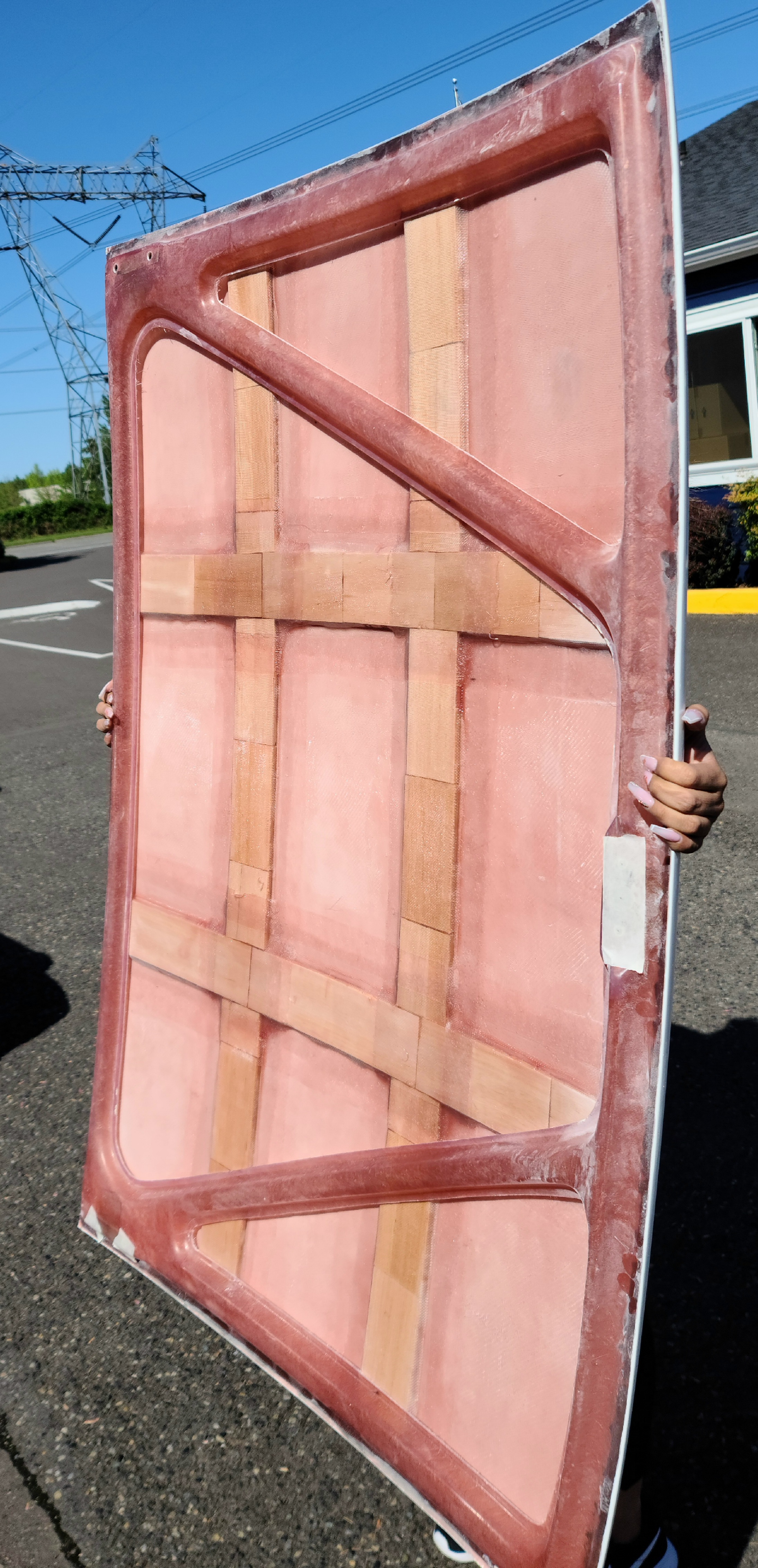

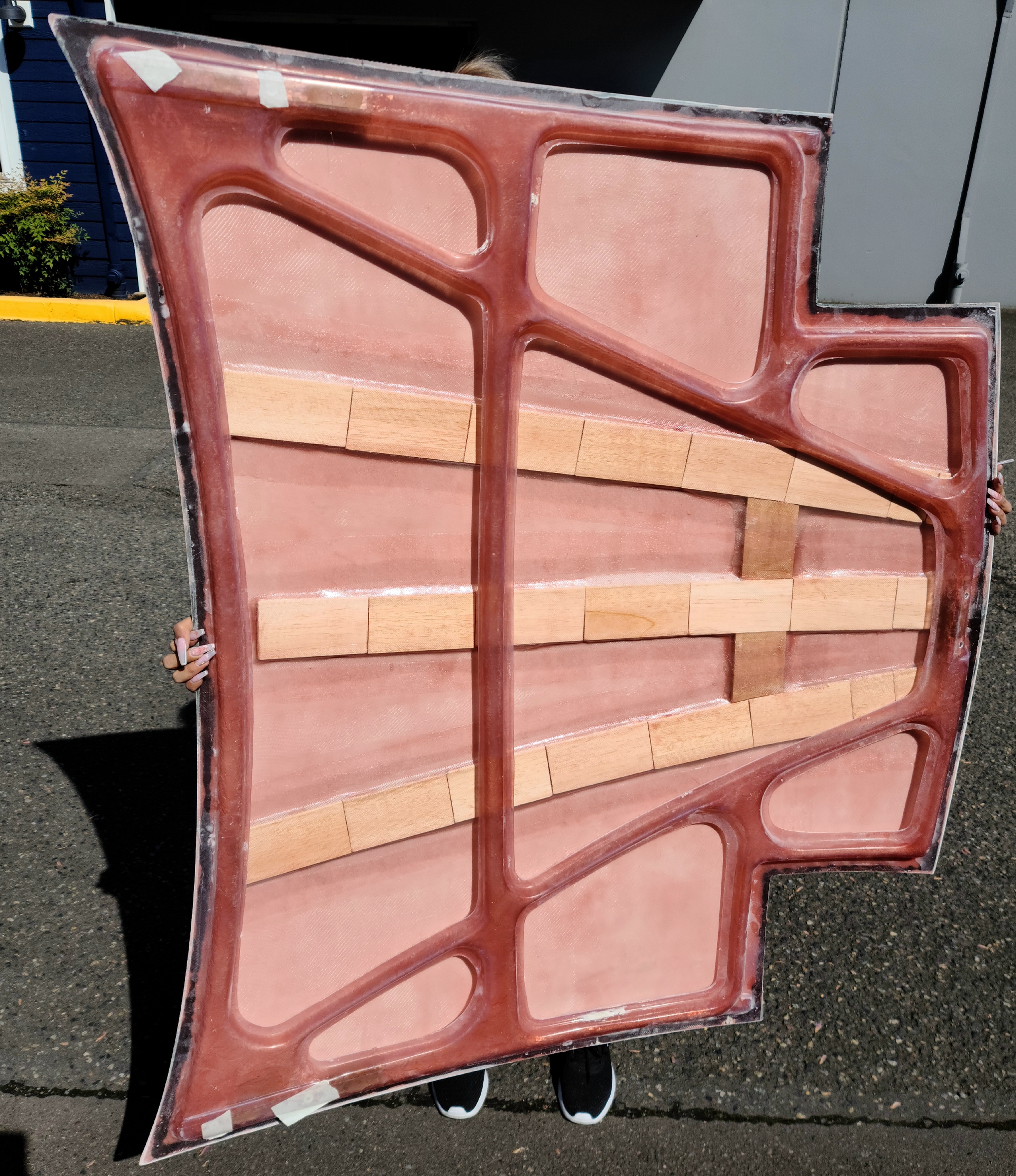

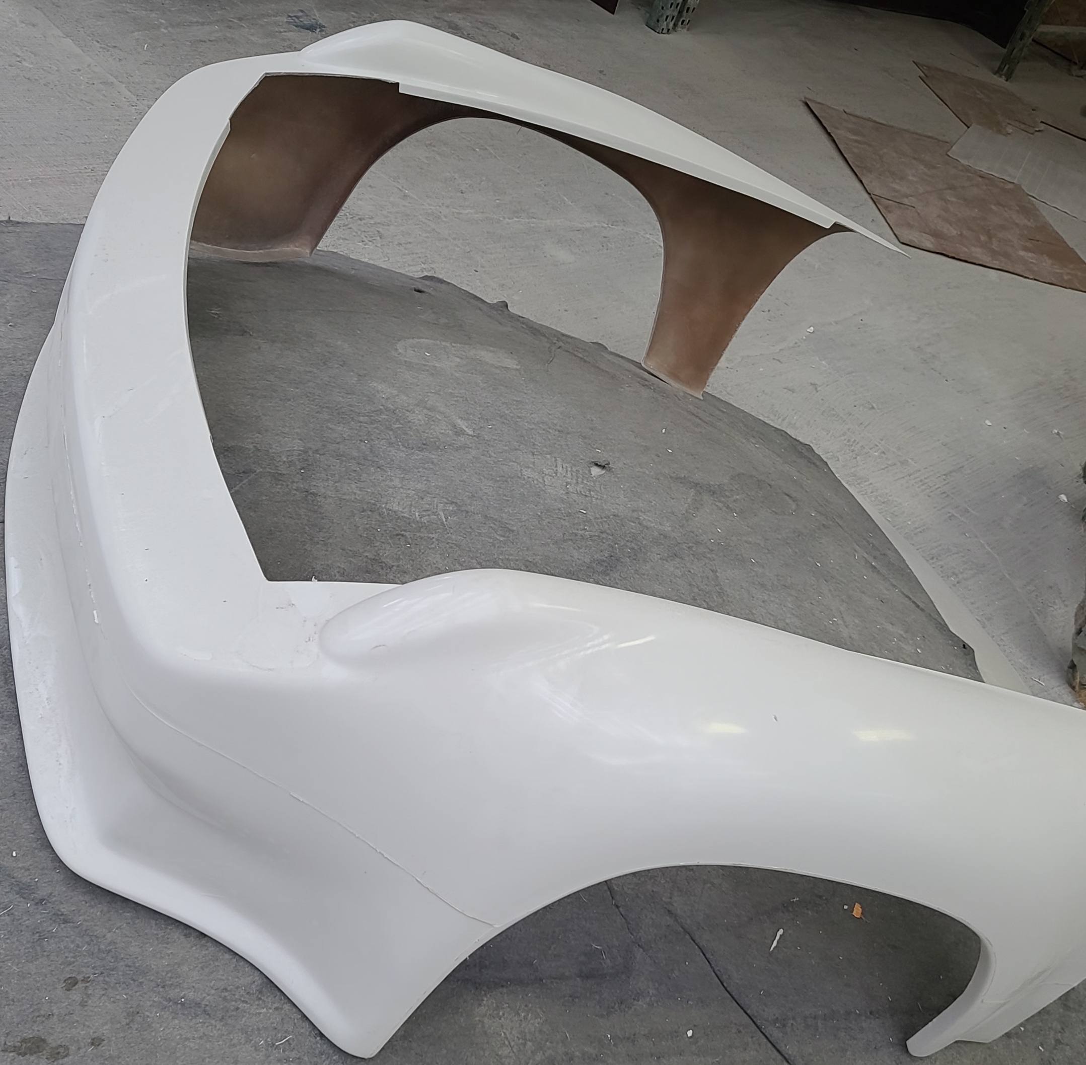

Sheridan made a kit that we bought the tooling on and have been making improvements on. I think it was one of the most complete.
We are looking at putting together a package in one box that includes the front section complete as shown below, as well as the front and rear hoods back flairs, lower rockers with flairs and door skins.
Heres some pics

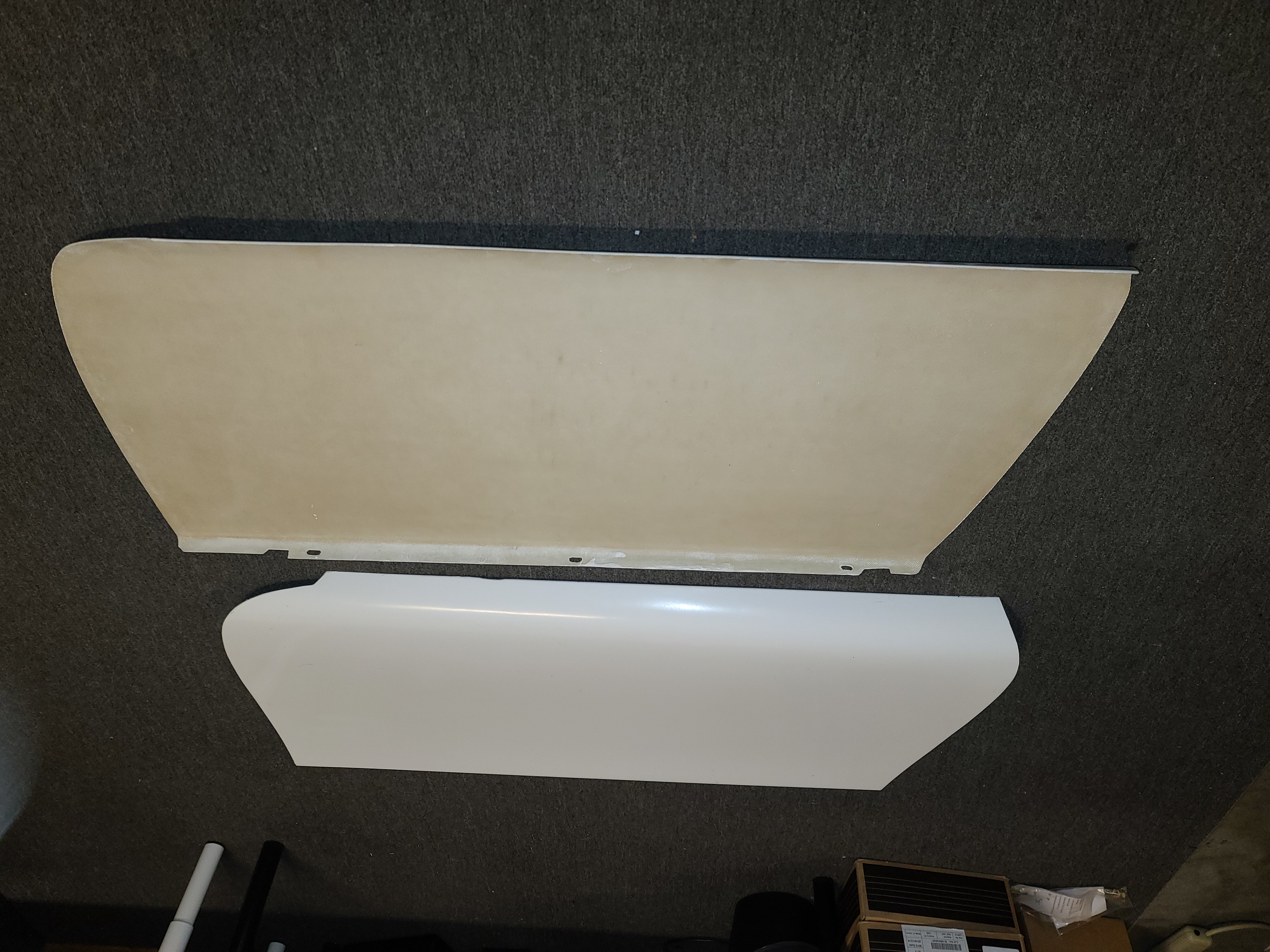

Door skins

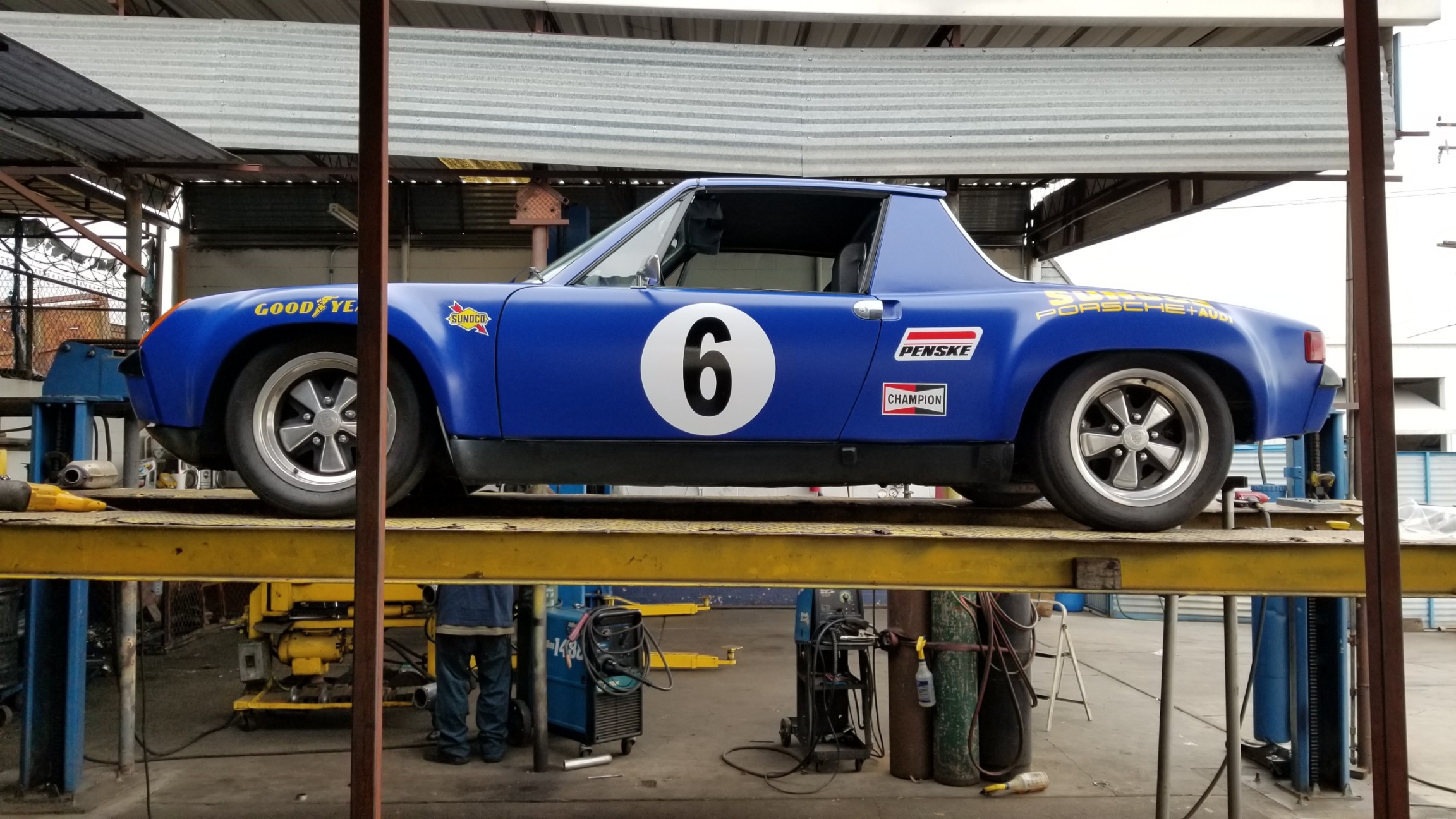

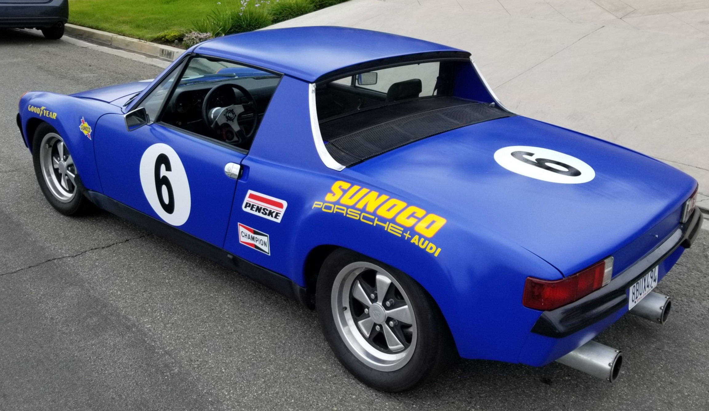

Mine is all glass except for the doors.Attached Image

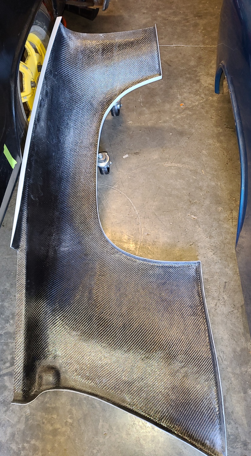

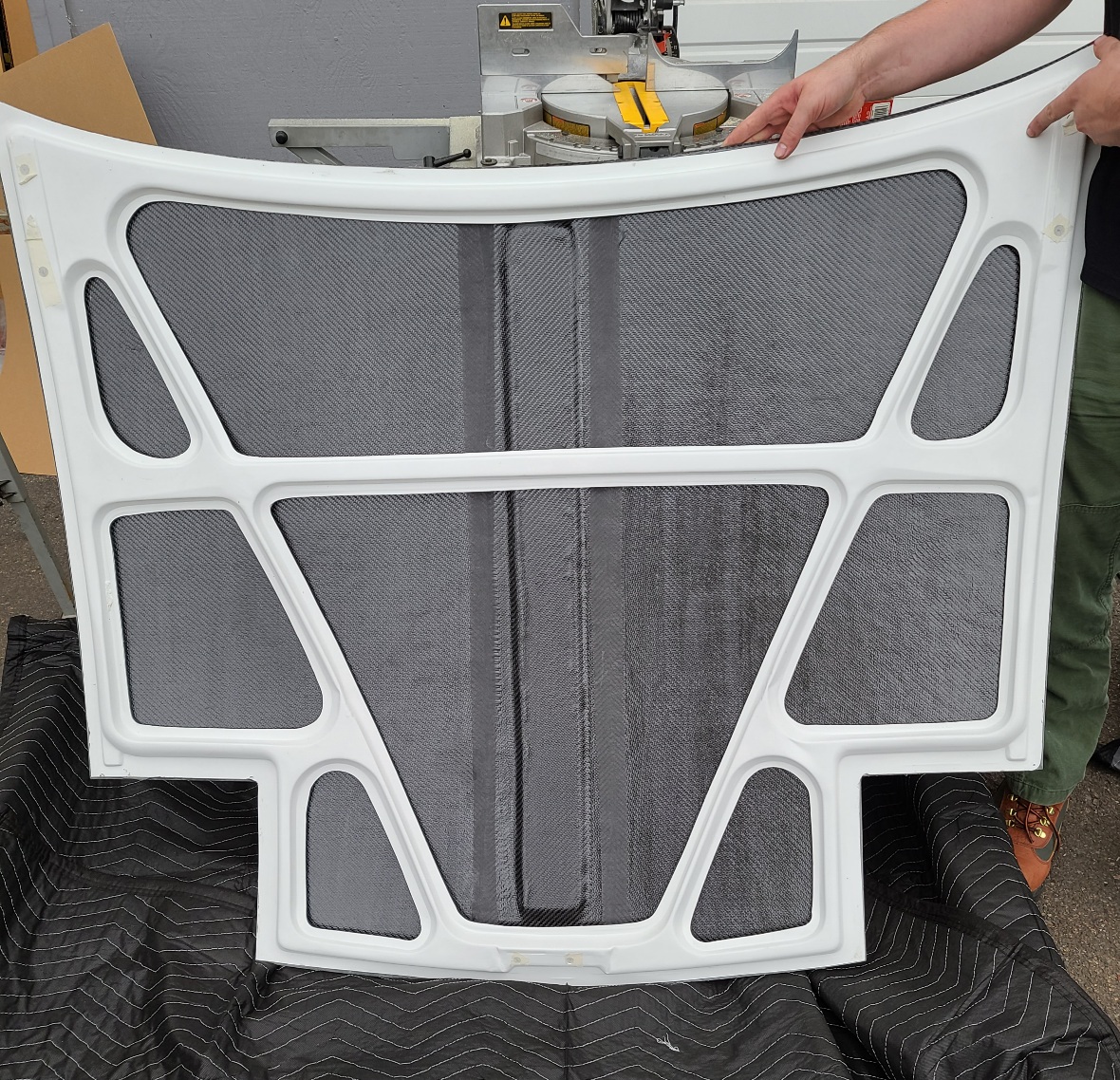

Hoods in carbon fiberand OEM matt GT style

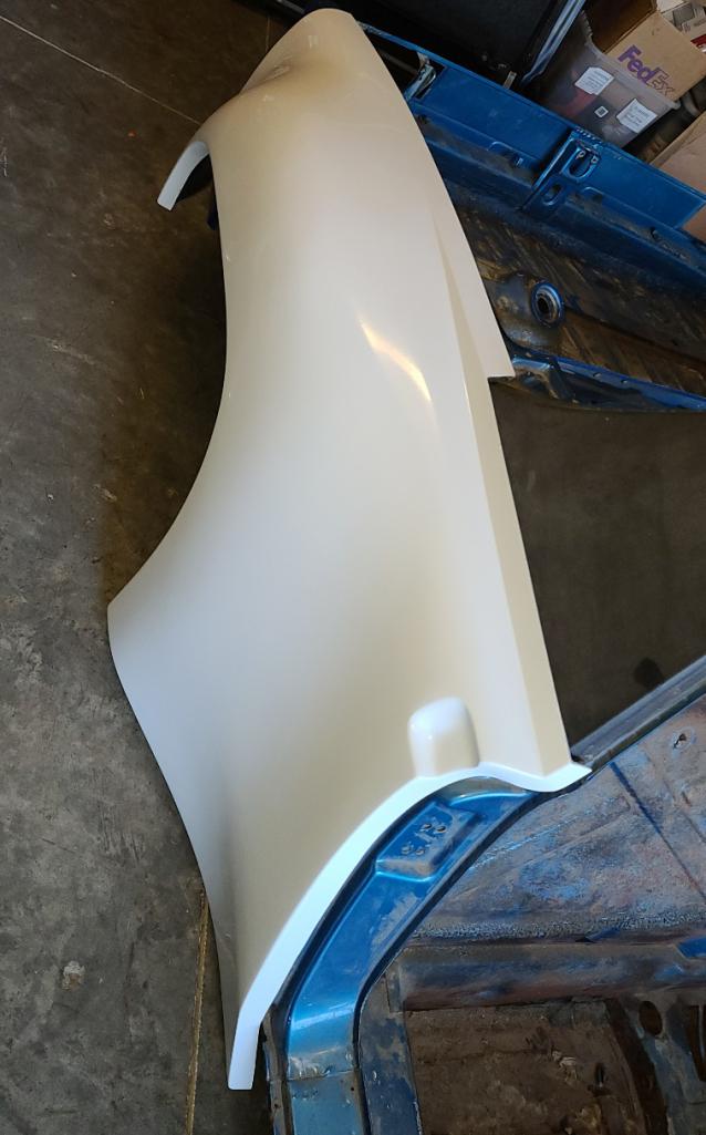

Rear quarters

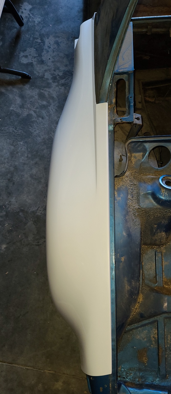

Rear GT

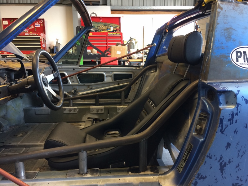

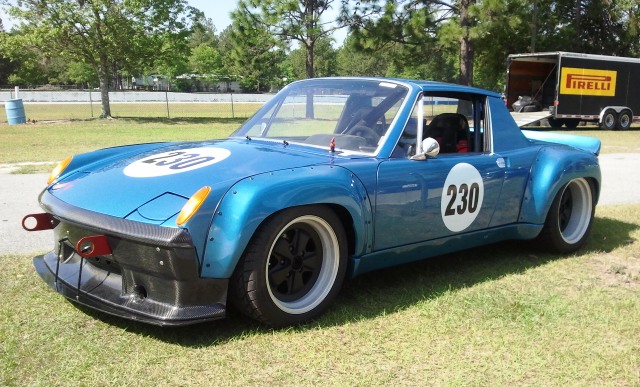

FWIW, fiberglass flares, front & rear lids, bumpers and rocker panels on my street / occasional track day car. But, went for steel late model doors (with the reinforcing panels) PLUS full roll cage with door bar. If I was doing it all over again, I'd keep the roll cage door bar - but may look to lose some extra weight on the doors - possibly fiberglass skins.
- Tony
Random fact: My car weighs in at 2150lbs wet. Weight saving from fiberglass (and interior delete!) is offset by roll cage addition and steel chassis strengthening panels & material

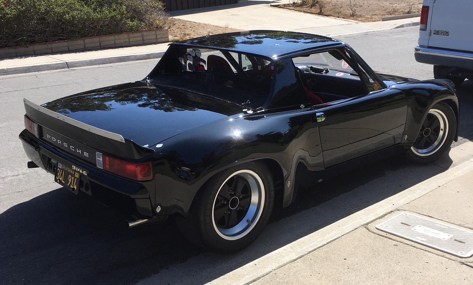

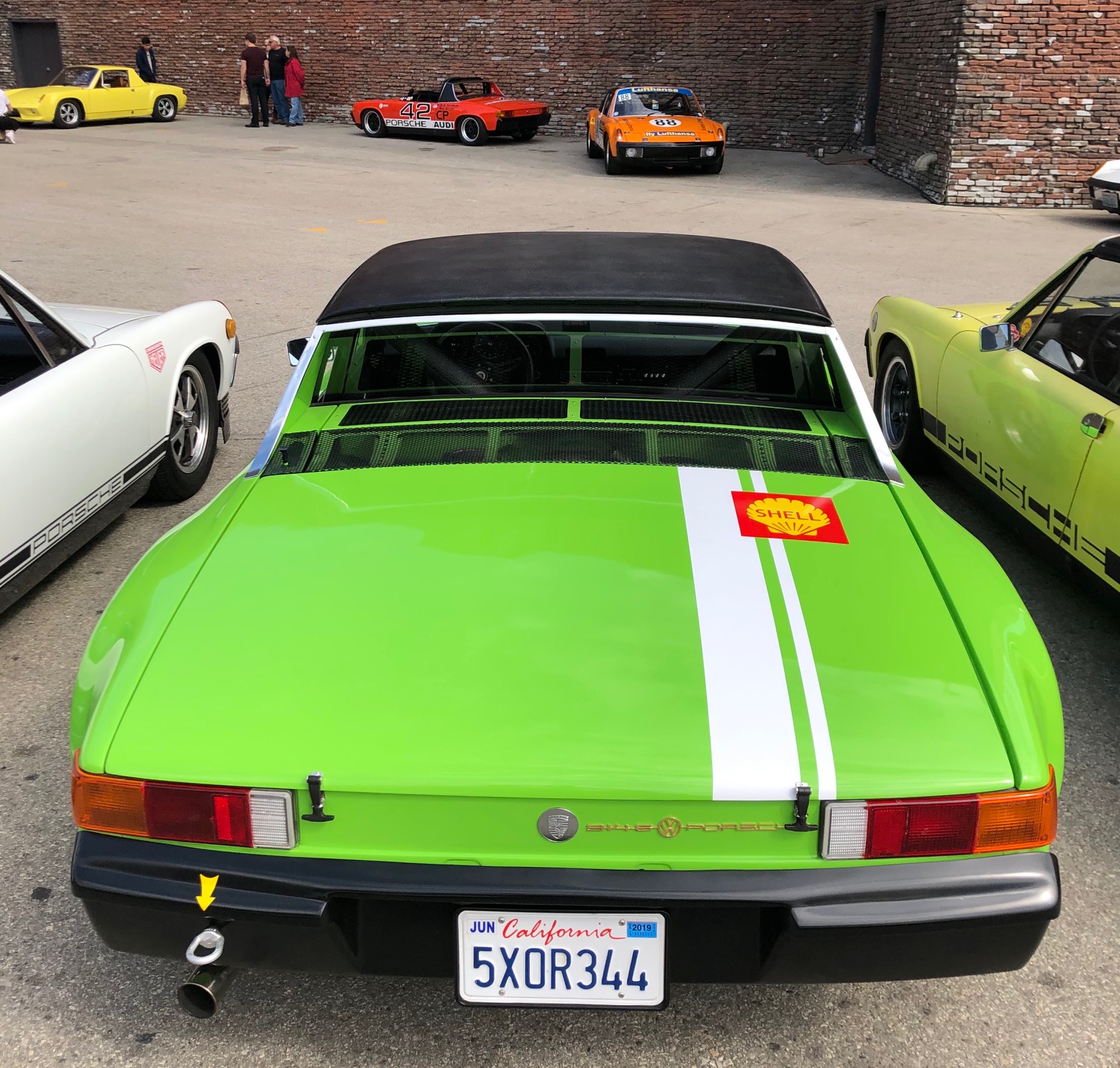

I'm running FG hood, trunk and bumpers on this one.
But has steel flares.
Will snap up some 914Rubber FG lids when they become available.
Oscar
