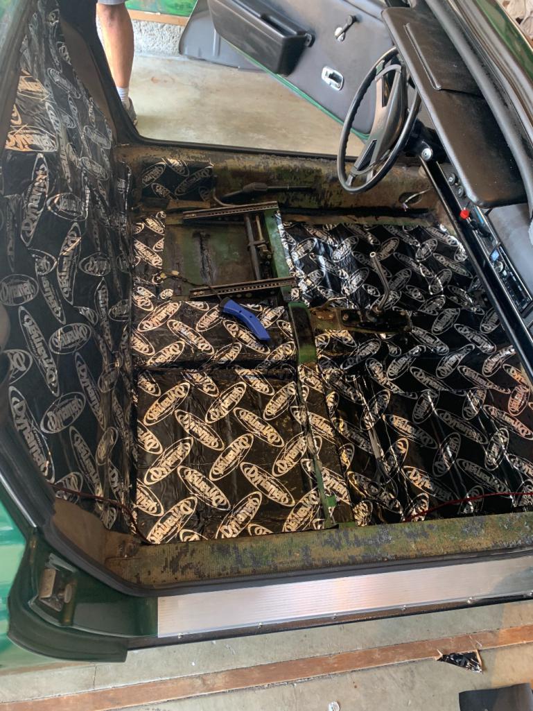

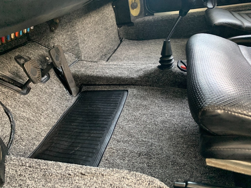

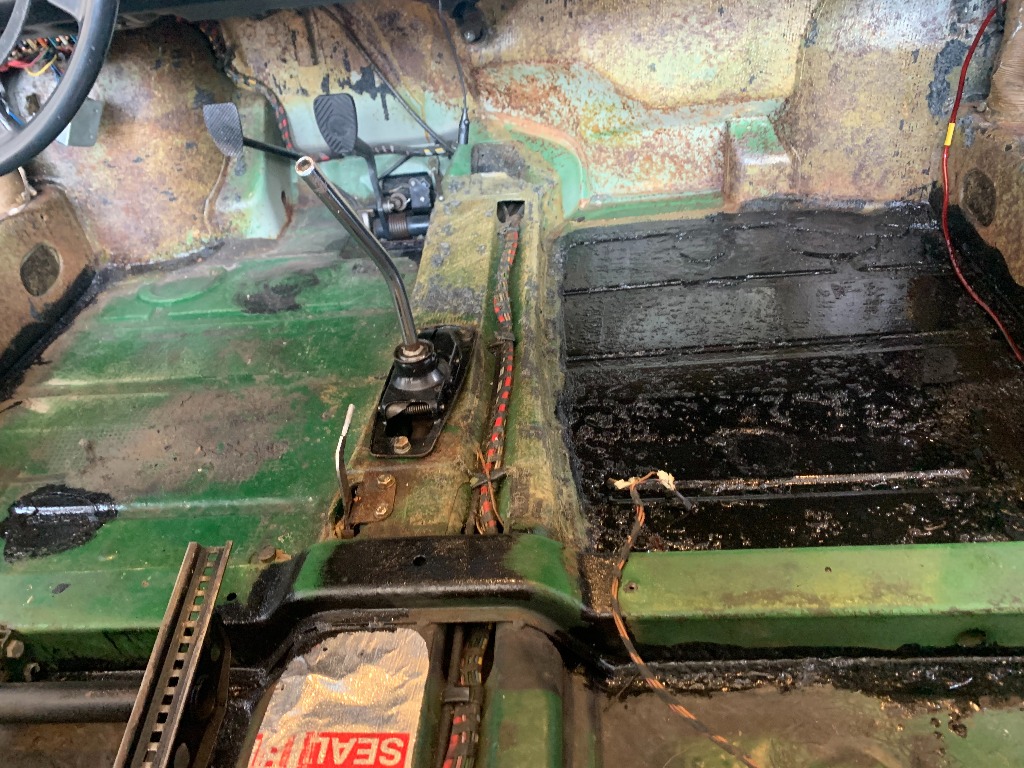

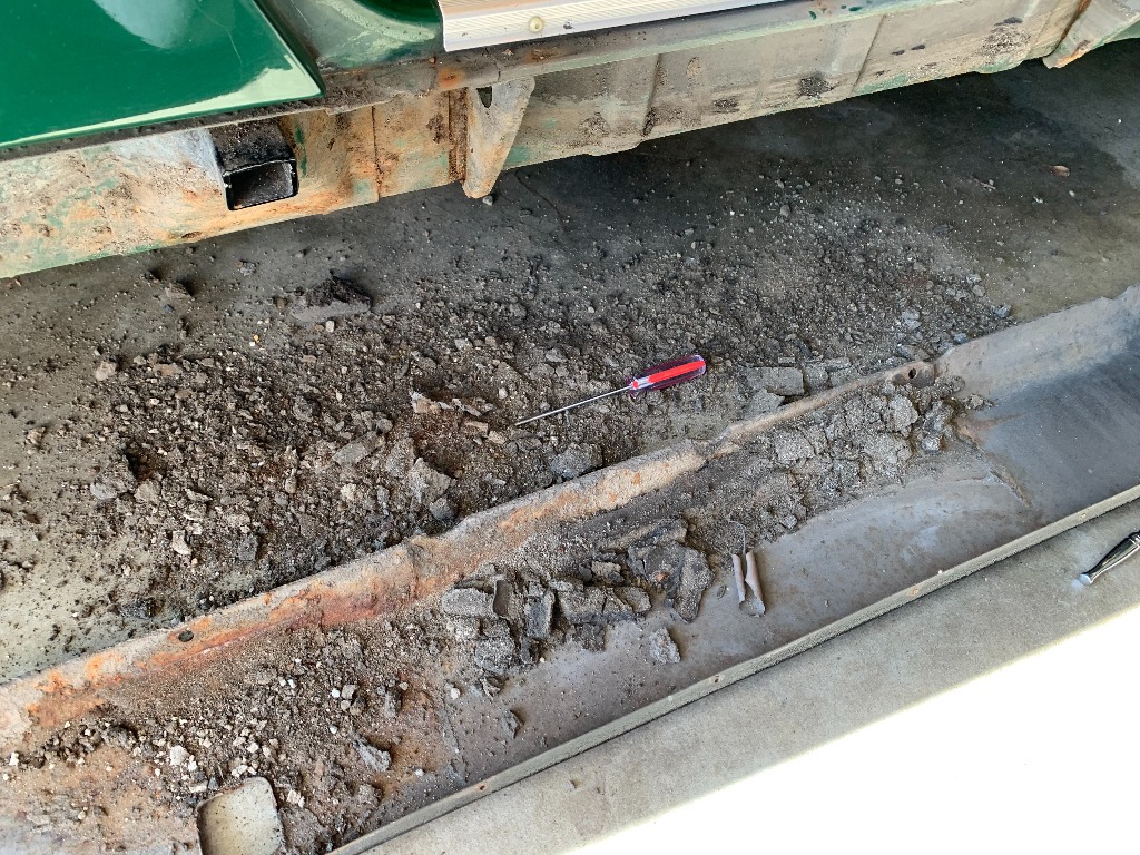

Looked through my photo collection and found some more on the 914 (and Dad's 911).
I had heard that dirt accumulated under the longs, and I had no idea if or when the PO removed them. I was greeted with about a pound of dirt on each side. Luckily both sides were solid. Both sides were given a coating of rust proofing to be safe.

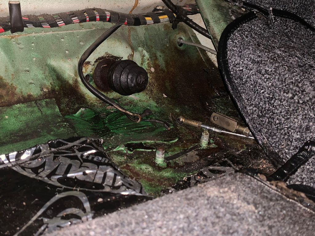

The installed carpet was well worn, and I wanted to check the firewall, footwells, and floors for rust when I first got the car, so I stripped the interior and installed (Maybe too much) dynamat and new carpet while I was in there.
After stripping the interior, the passenger side tar mat was peeling up, so I wasn't sure if there was rust under there. Chiseled it all off, and was greeted with only mild surface rust so I got rid of all that and gave it a protective coating.
Dynamat Installed
New Carpet Kit Installed - I am pretty sure the kit was for a later model 914 with the shorter passenger footwell but I used spare carpet and covered the bare spot, you can kind of see it in the picture, and now it is barely noticeable.

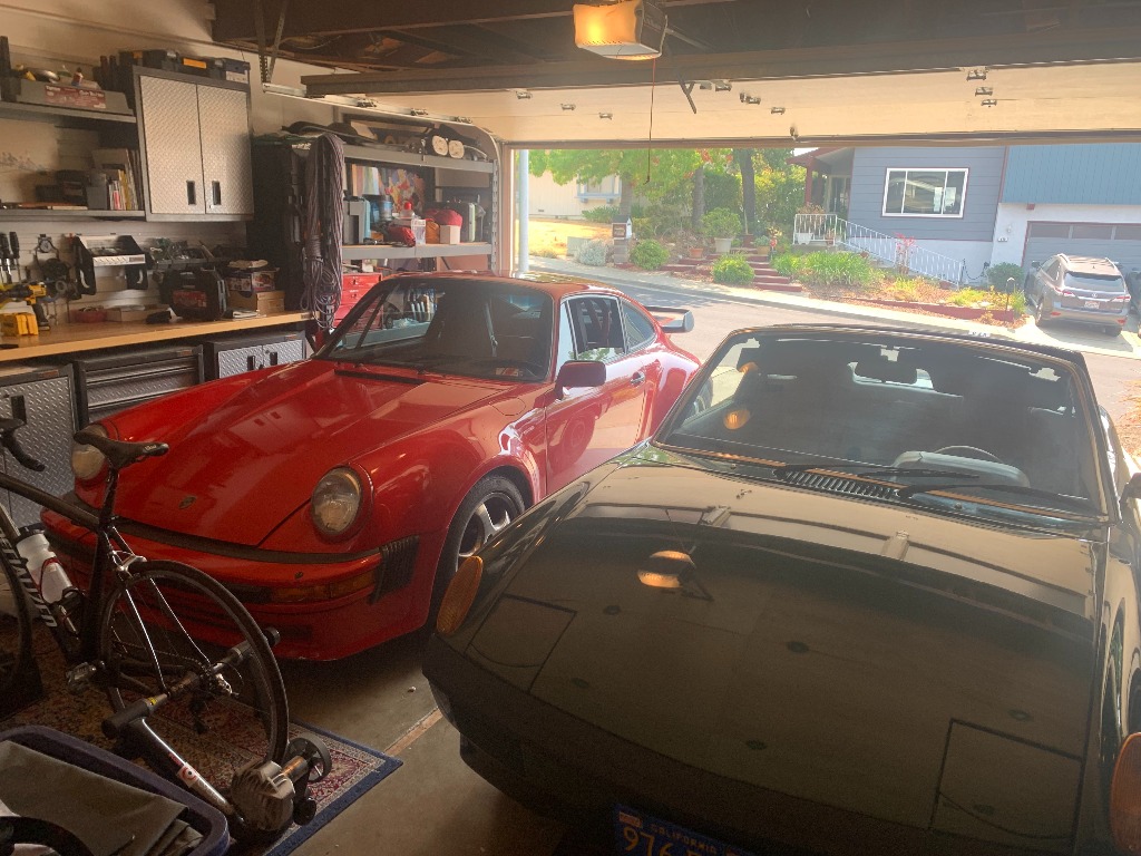

Last photo for now, the only one I could find with my car and my Dad's in the garage. It's a 1970, but has steel flares and postdate bumpers for a 930 look. It's also got a 3.2 Carrera Engine. At the time it was the only manual car in the family, so it is also what I learned to drive stick in. (No Pressure!). Thankfully I did not grind any gears, although the starting on a hill lesson may have taken some life off his clutch!

Nice work - looks solid.
What did you use on the longs and the floors for protection - POR15?

It looks like you have a nice solid car.

QUOTE(FlacaProductions @ Jan 2 2022, 08:11 AM) *
I used a couple cans of POR15, after sanding the surface rust off.

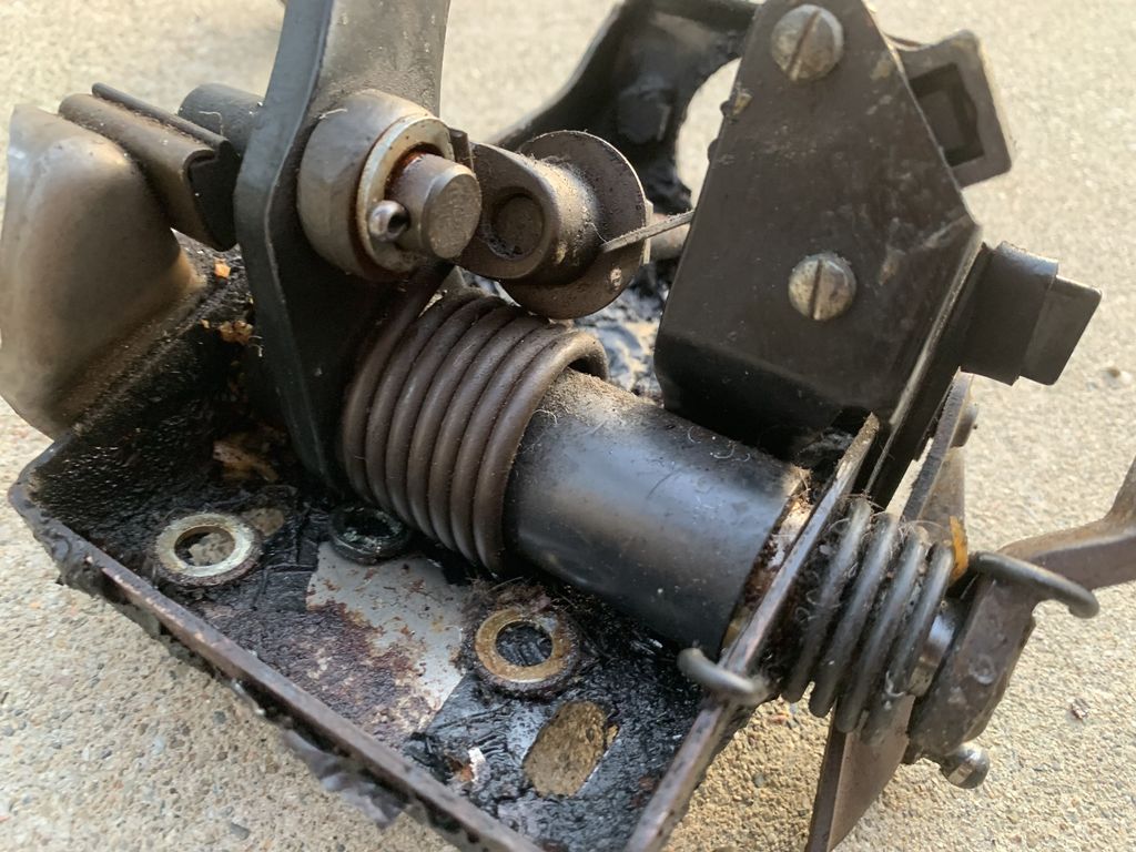

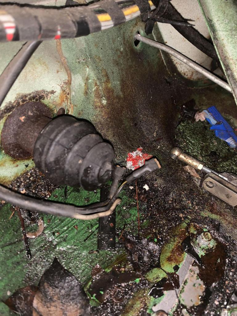

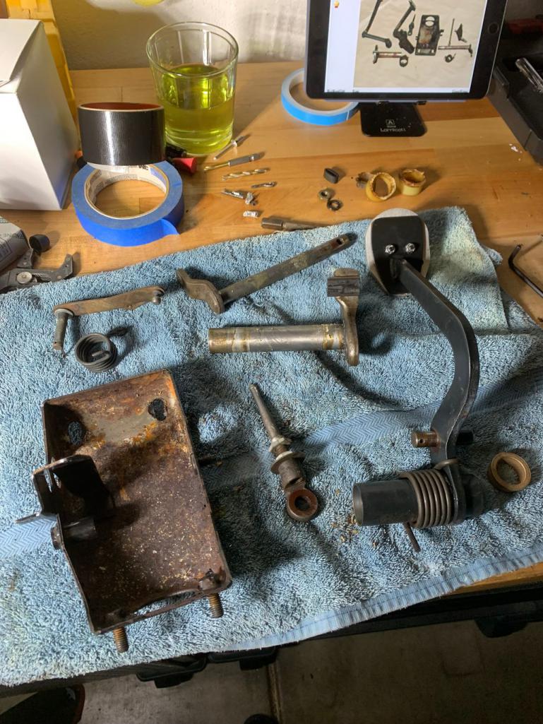

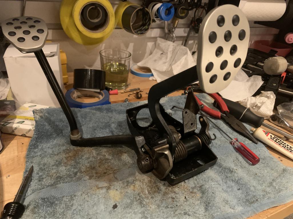

After noticing the amount of play in my accelerator pedal, along with the annoying squeak every time I engaged the clutch, immediately went here to research solutions.
Found out pretty fast the nylon bushings disintegrate, and looked into my pedal cluster and saw a nylon graveyard. Bronze bushings were then ordered from Pelican.
Yesterday I removed the pedal cluster from the car and saw what a mess it was underneath. What I did not see was rust! (IMG:style_emoticons/default/biggrin.gif)
After removing the cluster
After a quick clean
The cluster fully disassembled, after following Eric Shea's excellent write-up on rebuilding the pedal cluster. Ended up carefully drilling out the old roll pin holding the pedals to the base, because the hammer was not persuasive enough. Eventually got things free and I had a new pin anyways so no harm done.
Sanded and painted the base, gave everything a good clean, then went about replacing all of the what used to be nylon bushing with the new bronze ones. Everything got a healthy coat of silicone grease before going in.
Pretty happy with the result! Looks much better, and while you cant see it after the pedalboard and carpet are in, you sure can feel the difference. Each pedal feels miles smoother than before, and the play in the accelerator cable is all but gone.

Nice work getting your 914 in good condition. The pedal cluster rebuild will be a world of difference. (IMG:style_emoticons/default/beerchug.gif)
