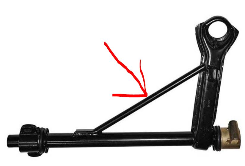

I’m still confused why people don’t just use the diagonal on the a-arms.

QUOTE(mepstein @ Jan 27 2022, 02:55 PM) *
They are not stressed to be used as a tie down, and you could end up with a bent control arm.
Clay

QUOTE(ClayPerrine @ Jan 28 2022, 03:51 PM) *
Clay
I’m not buying it. It’s a big steel rod. They are stressed a whole lot more every time you hit a bump or pot hole.

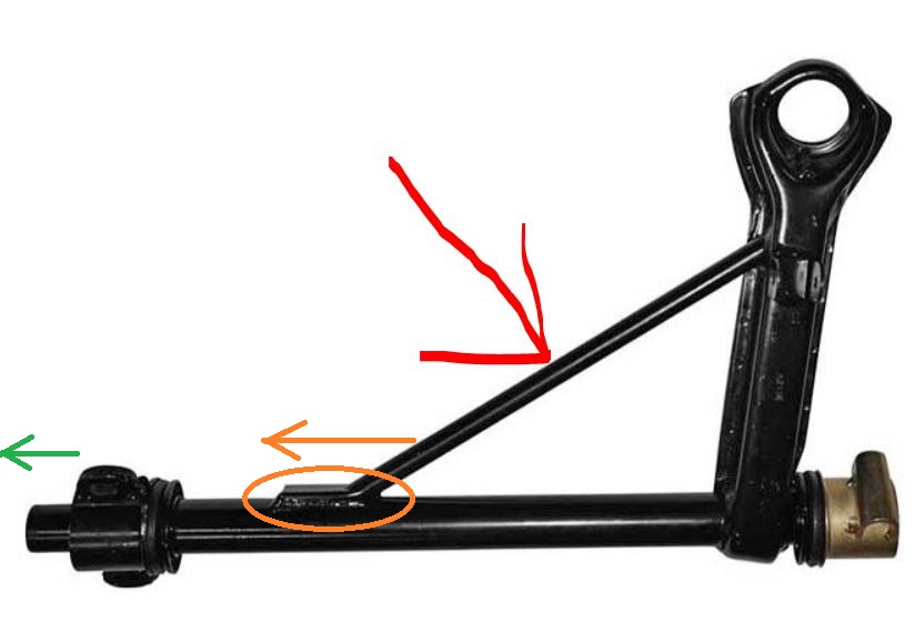

I've seen and removed a few with the diagonal bent right here from being tied down to a trailer or snatched from an off track track excursion or out of a ditch.
I was always amazed at this thinking it was very strong part but apparently not at certain angles...

So you can tow with the frame mounts with 3/8" steel keeping them spaced properly between point to point. You are also use 6 - bolts directly to the frame ( my design - 4 if you count only the factory mounts) in the front of the A arm. You will also be supported by the A arm and the rear mounts which have 4 more bolts.
Or you can attach to a tube that is welded to the mounts relying only on the strength of the welds. Forget about lateral loads that can distort that support. Yes that bar is not a primary structure. It is a support to hold assembly at the short end ( hub and wheel) in alignment.
So can you pull from it, yes. Do you want to???
