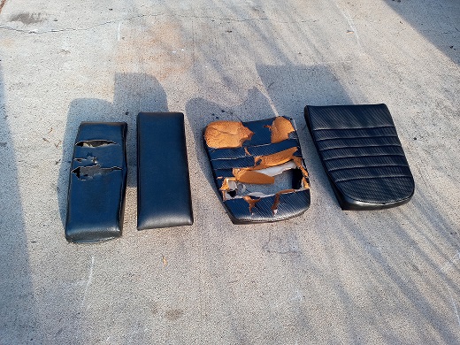

> The start of my interior redo, I think I got maximum mileage out of the originals

Here's a picture of two parts of the interior replacement I did today. Old and new. The seat cushion is from 914Rubber, the console pad from aaaupholstery. Both fit well, I do recommend buying an electric staple gun to save your hands. You'll be putting in hundreds of staples by the time your done.Attached Image Time for (IMG:style_emoticons/default/beer3.gif)

Very nice.
Doing the rest of the seat is way more time intensive. Much repair to the foam is needed. If you don't have a lot of patience I wouldn't recommend this job.

Don't forget to check out Ian's videos. May save you some time / effort.

The videos are great. Wouldn't of tried to do this if I hadn't watched them first.
