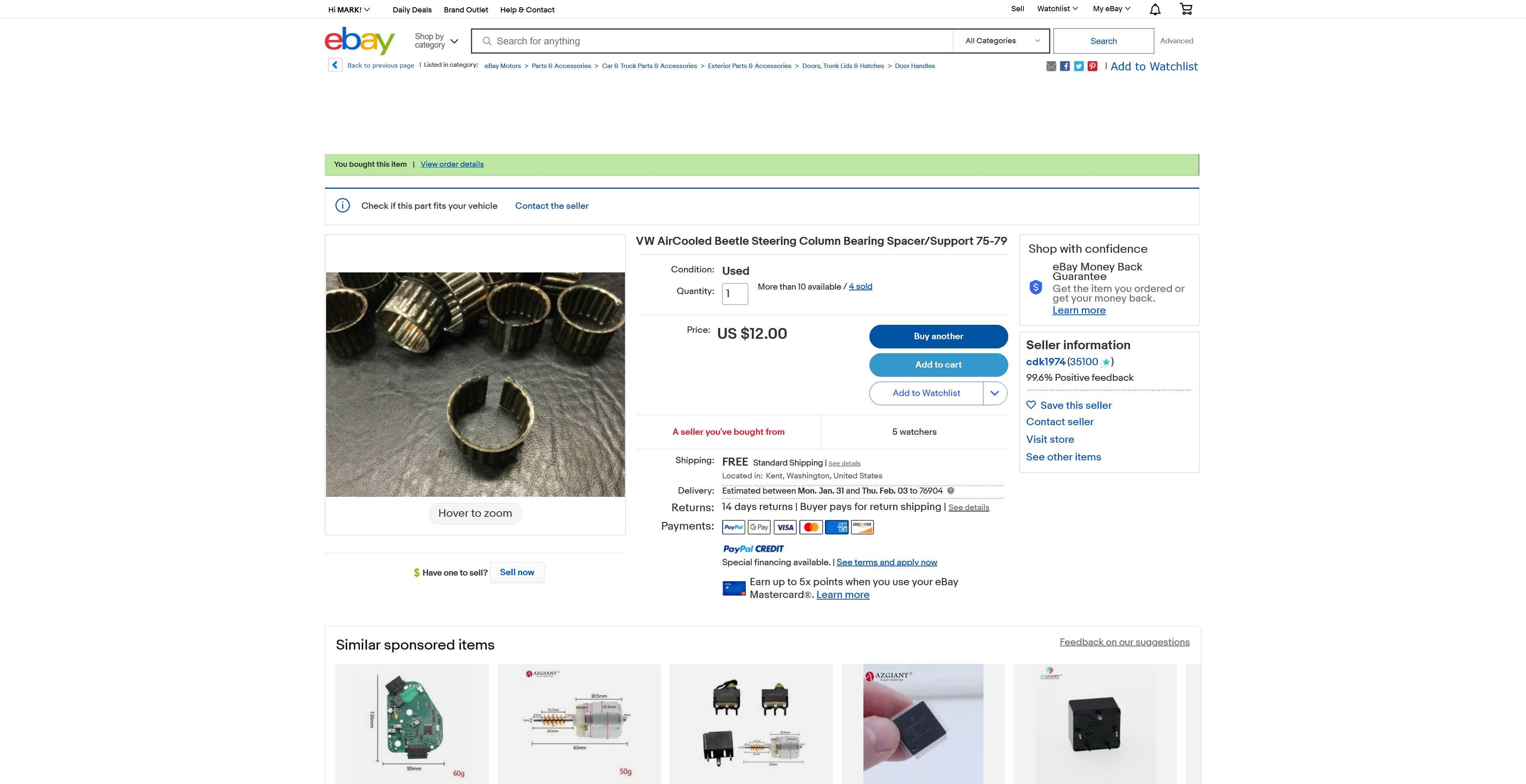

IF you have one of the plastic entered bushing in your steering column, you can use the VW Beetle one as a replacement. Place steel bushing on shaft, then run upper bearing to to shaft. Snug up bearing to shaft. Steel bushing lip goes to the inside to act as a stop.
Attached thumbnail(s) ![]() |
