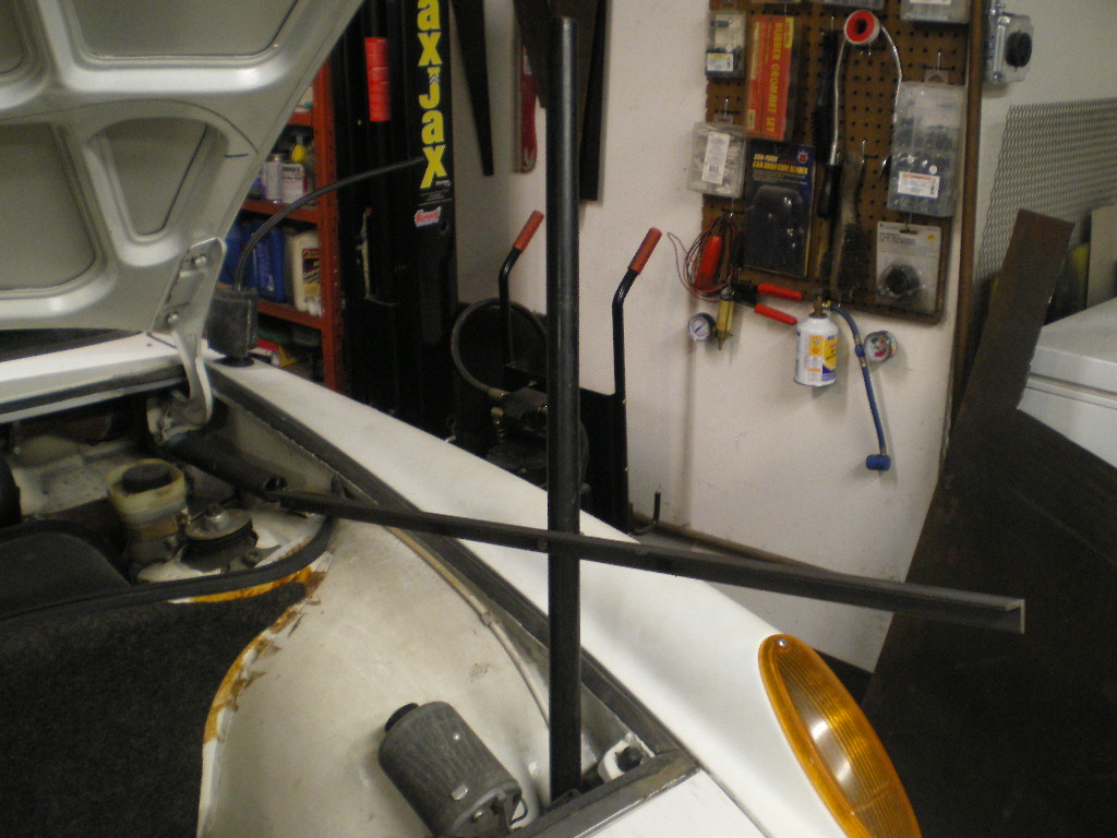

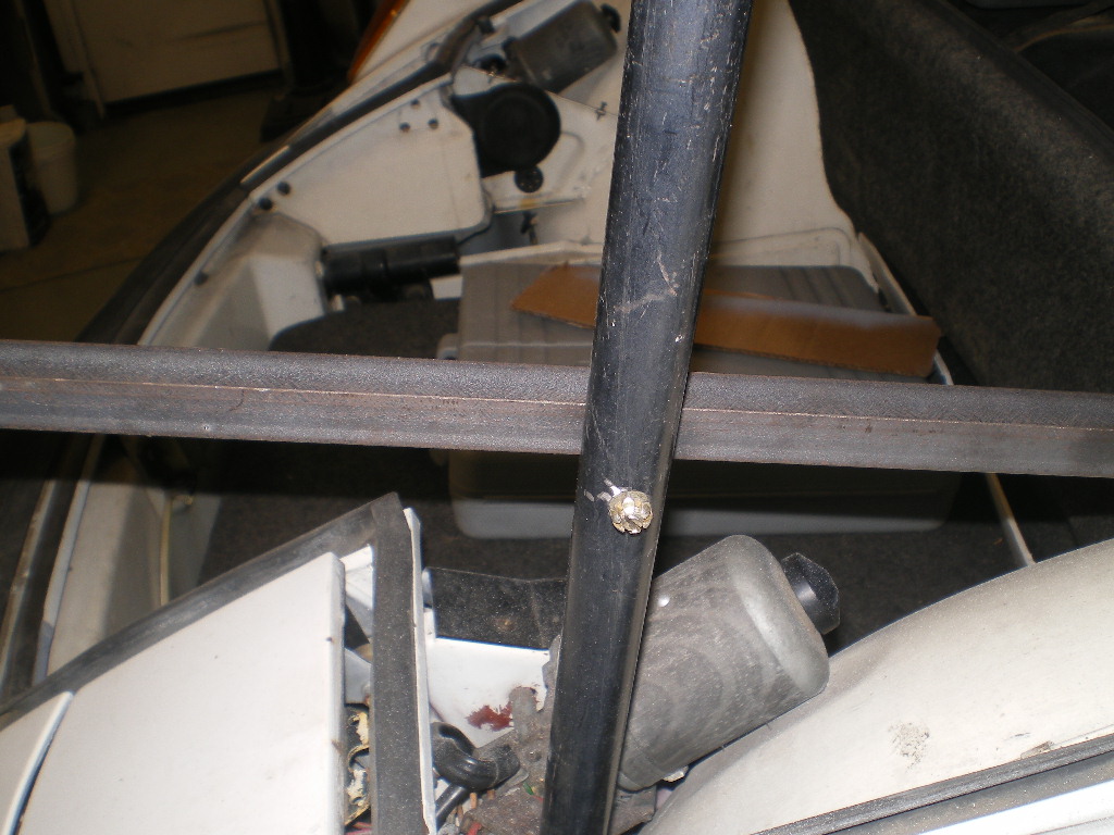

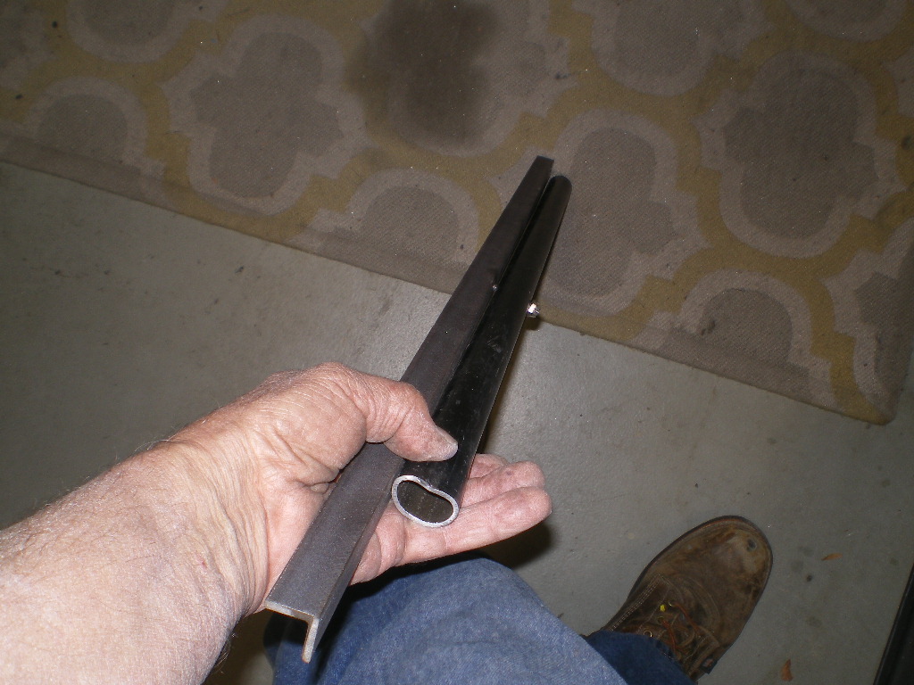

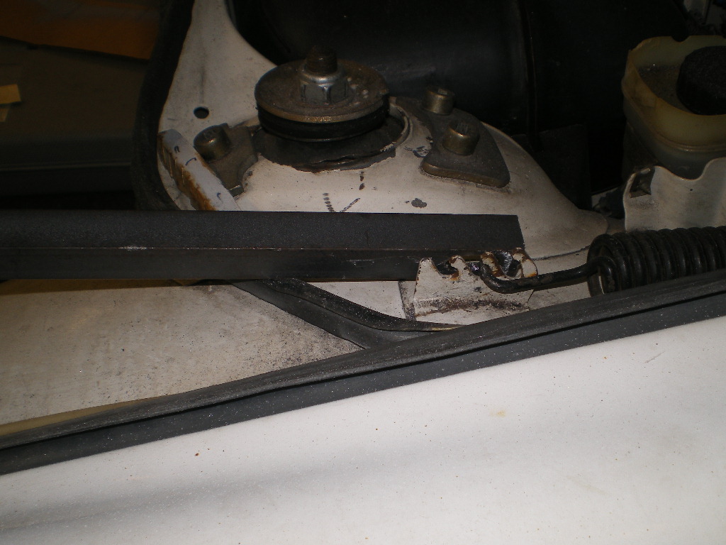

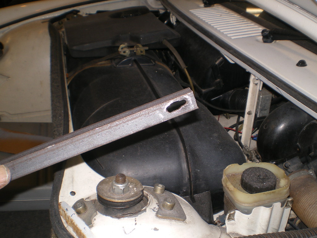

The last time I removed/installed hood springs was 2009. I used vice grips and brute strength. I don't have the strength anymore and after learning of someone who lost an eye doing it that way I decided to make this. You could use square tube where I used round or flat bar where I used angle. I flattened the end of the round tube some and wrap a shop towel around that end so as to preserve the paint of the wheel well. It folds up for easy storage. I used a 1/4" shoulder bolt to tie the 2 pieces together.

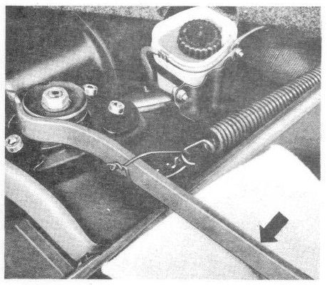

This one is homemade and in the FWSM

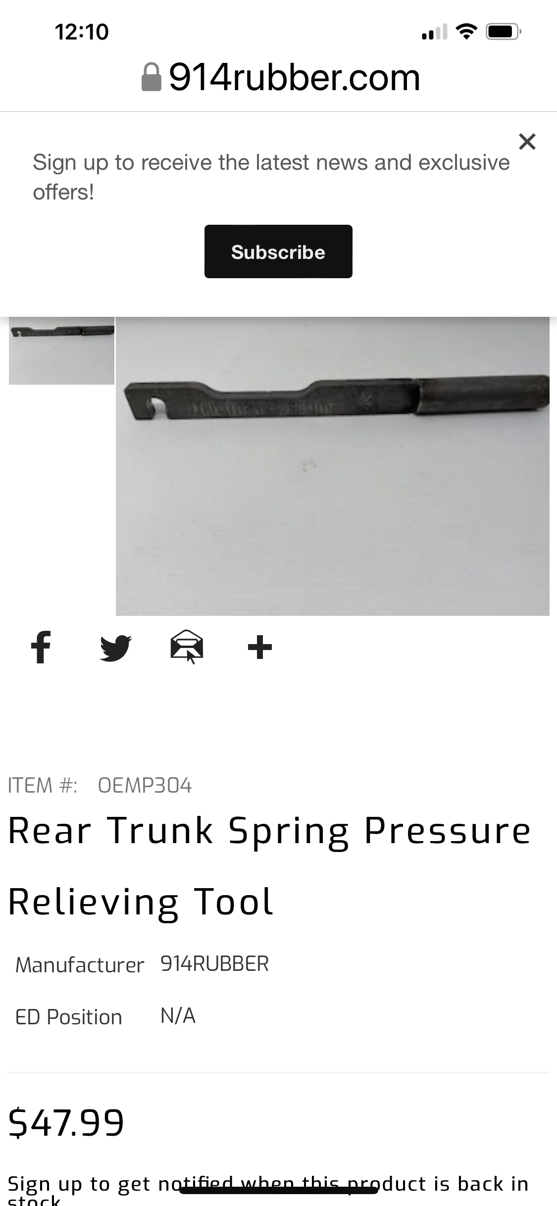

I bought a wrench for the rear from mc mark. I think 914rubber sells them now.
Edit - yes they do.
Mikey914
post Feb 1 2022, 11:19 AM
The rubber man
Posts: 12,786
Joined: 27-December 04
From: Hillsboro, OR
Member No.: 3,348
Currently out of stock, working on a new run. However, a new design may be in order. We had bought out the last of McMark's stock, and he's not going to make any more, so this may be the best juncture to do this.

QUOTE(JeffBowlsby @ Jan 31 2022, 11:23 PM) *
I made a version of this tool using a 1/2" drive breaker bar, coat hanger wire and a towel to protect the paint.

QUOTE(JeffBowlsby @ Jan 31 2022, 08:23 PM) *
That tool in the FSM is actually a tubeless tire iron. Parts guy at the dealership I work at as a tech had a pair and gave them to me to keep as he had another set. So I used it to remove my old hood springs and install the new ones. I used a heavy duty zip tie around the hook end of the spring while having the frunk lid propped all the way up. Worked like a charm.
Also interesting design on your home made tool 76-914.
