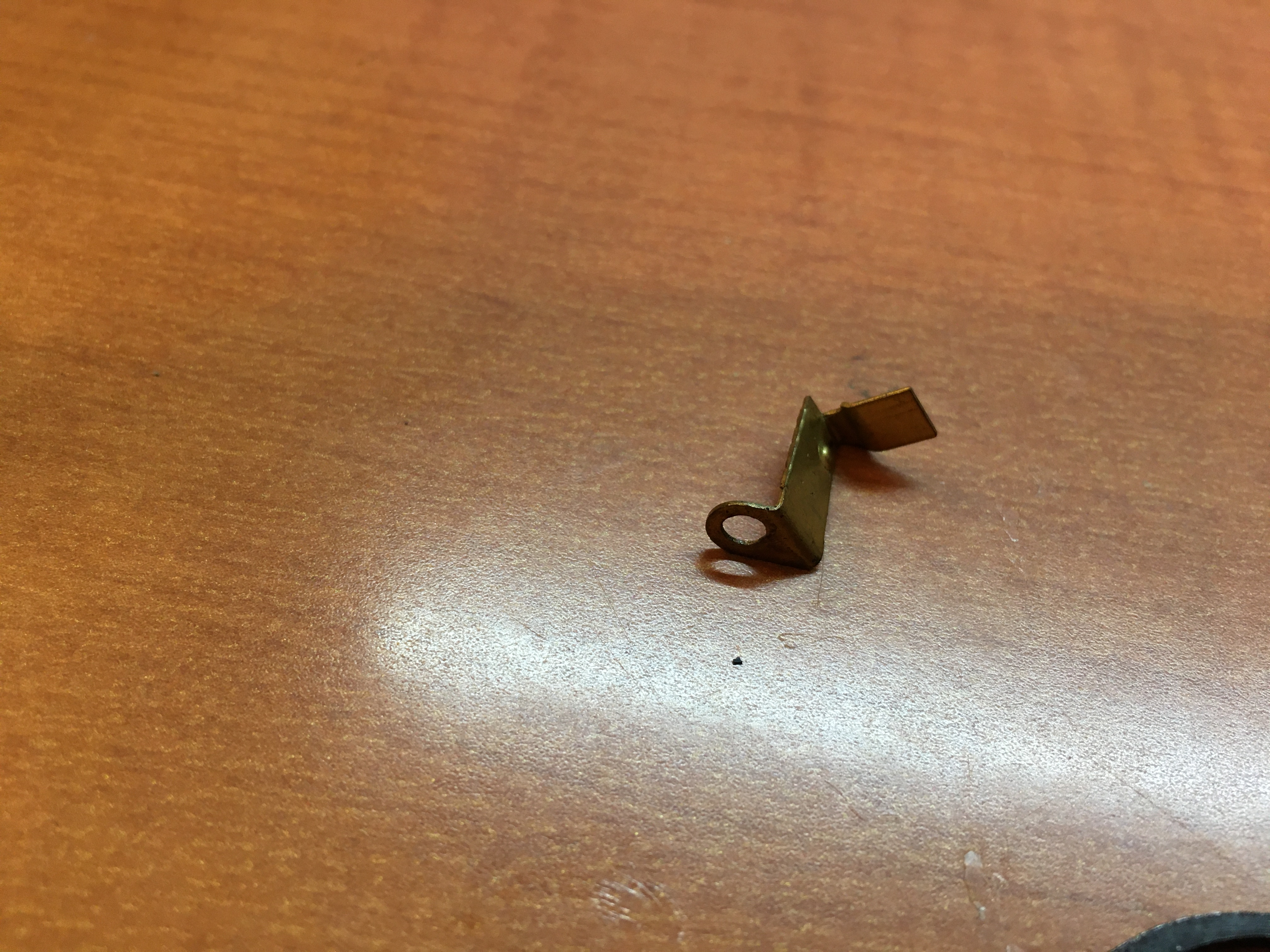

I took it all apart to have new matching keys made and now I’m having trouble remembering how it goes back together. Especially this brass clip with the hole in it. Does anyone know of a diagram or video for what goes where?

Goes in upper right hand screw. It slots in wiper switch. Not able to get pictures at this time

Mark has it right.
Remember that the head of the screw bears on the brass tab that has the hole and
the long leg slots into a recess in the switch.

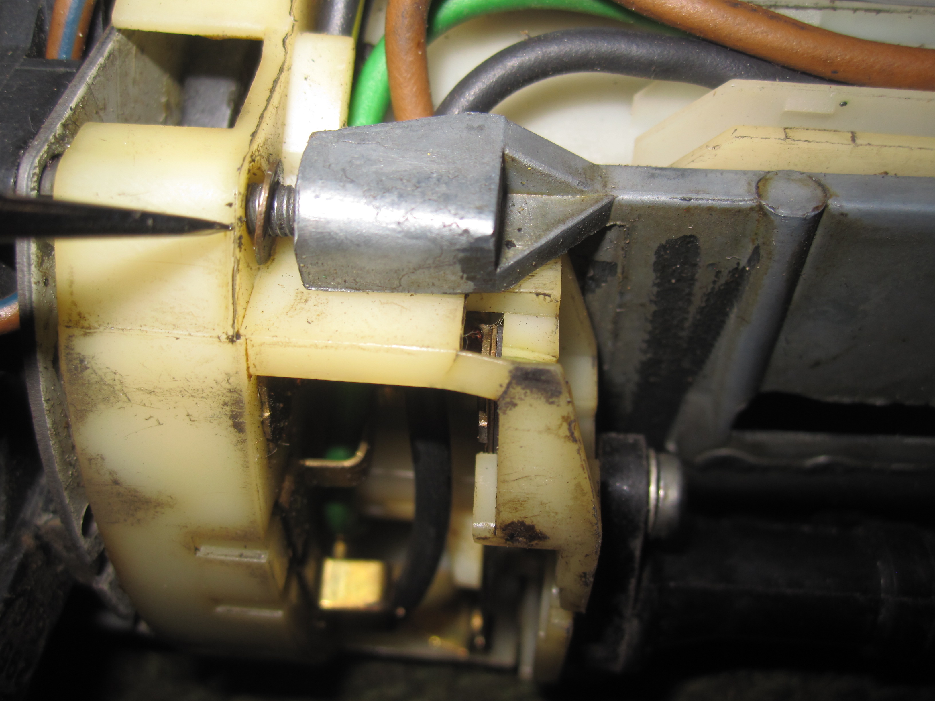

Does this help... (IMG:style_emoticons/default/confused24.gif)

QUOTE(rgalla9146 @ Feb 3 2022, 08:55 AM) *
Mark has it right.
Upon review.....check lower left.
There appears to a contact on that screw.
I don't have the brass part to test fit.

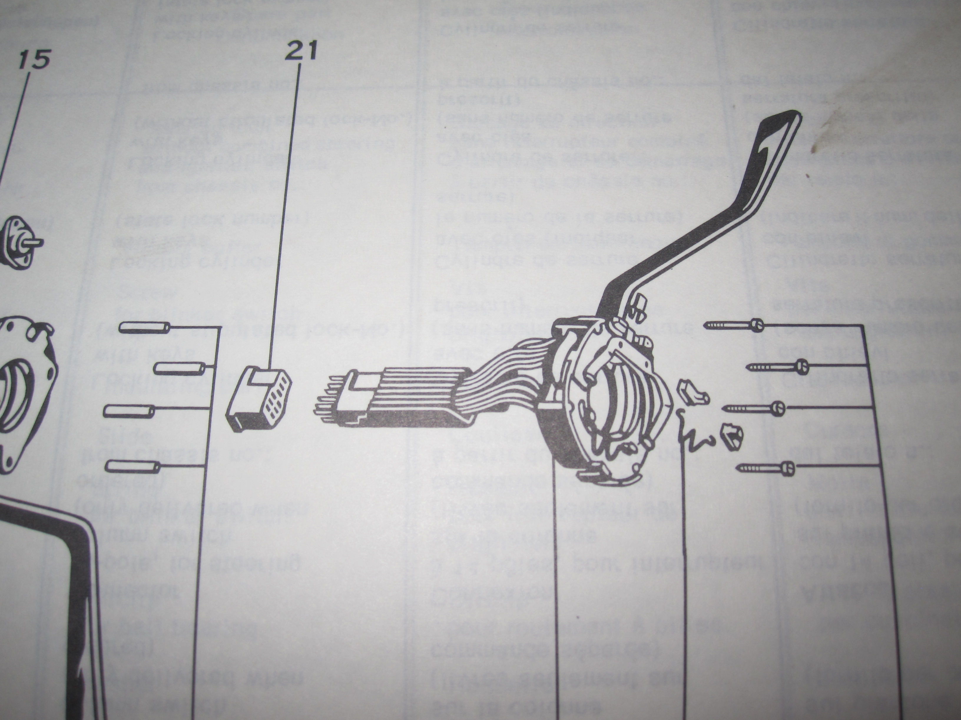

Upon even further review....The small part in the parts manual is not identified nor
does the diagram help in revealing which screw it goes to.

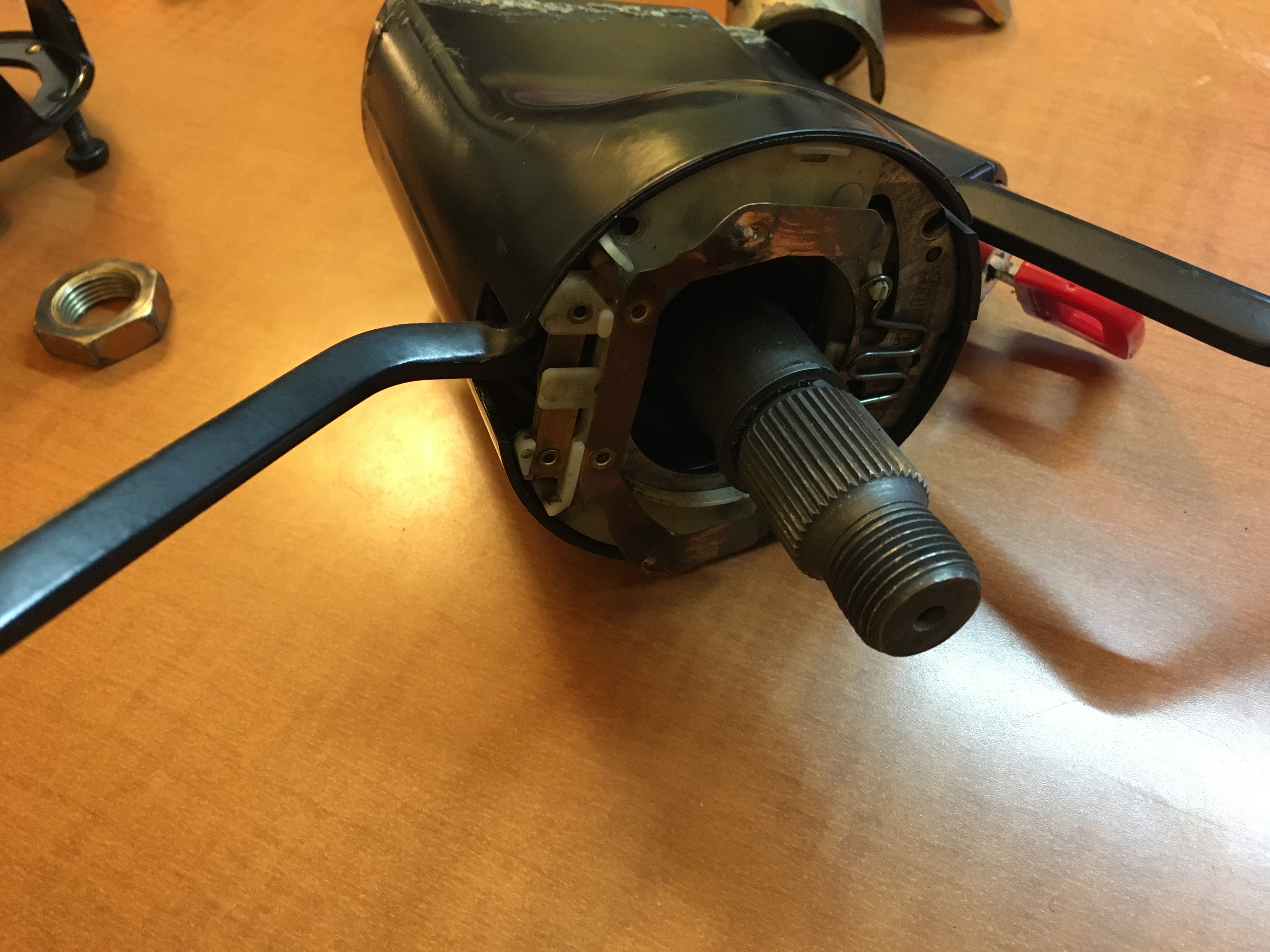

I’m good. Pulled out the windshield washer system years ago. Didn’t want water running up there. Looks like the part doesn’t need to be installed after all.
