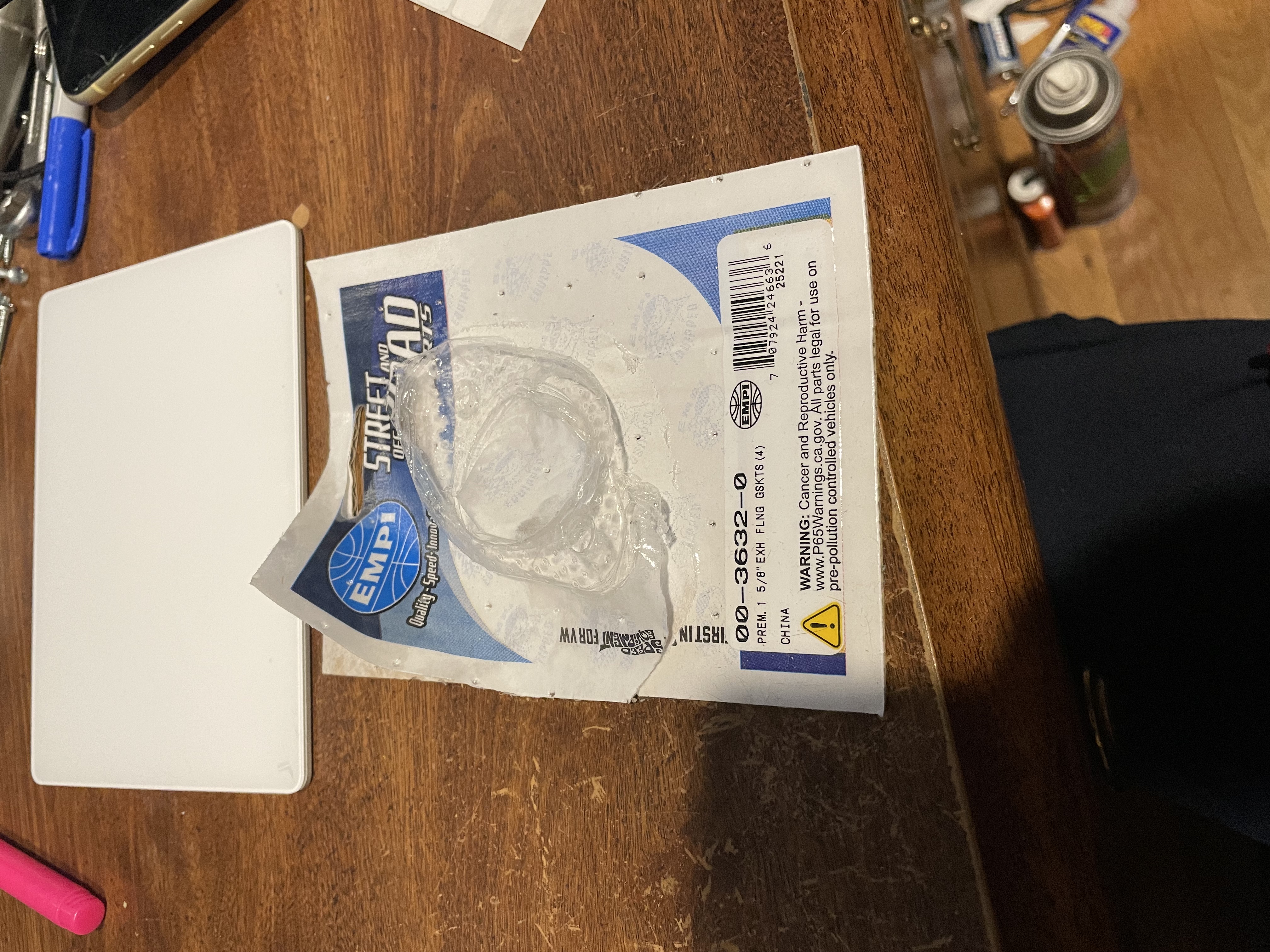

I have the 1 5/8 Tangerine stubs and need flange gaskets and for my stubs for 1 1/2. I found the ones from EMPI on Amazon.
I know these are not the 1.75 but you may want to take a look and see what they have for bigger apps like yours
