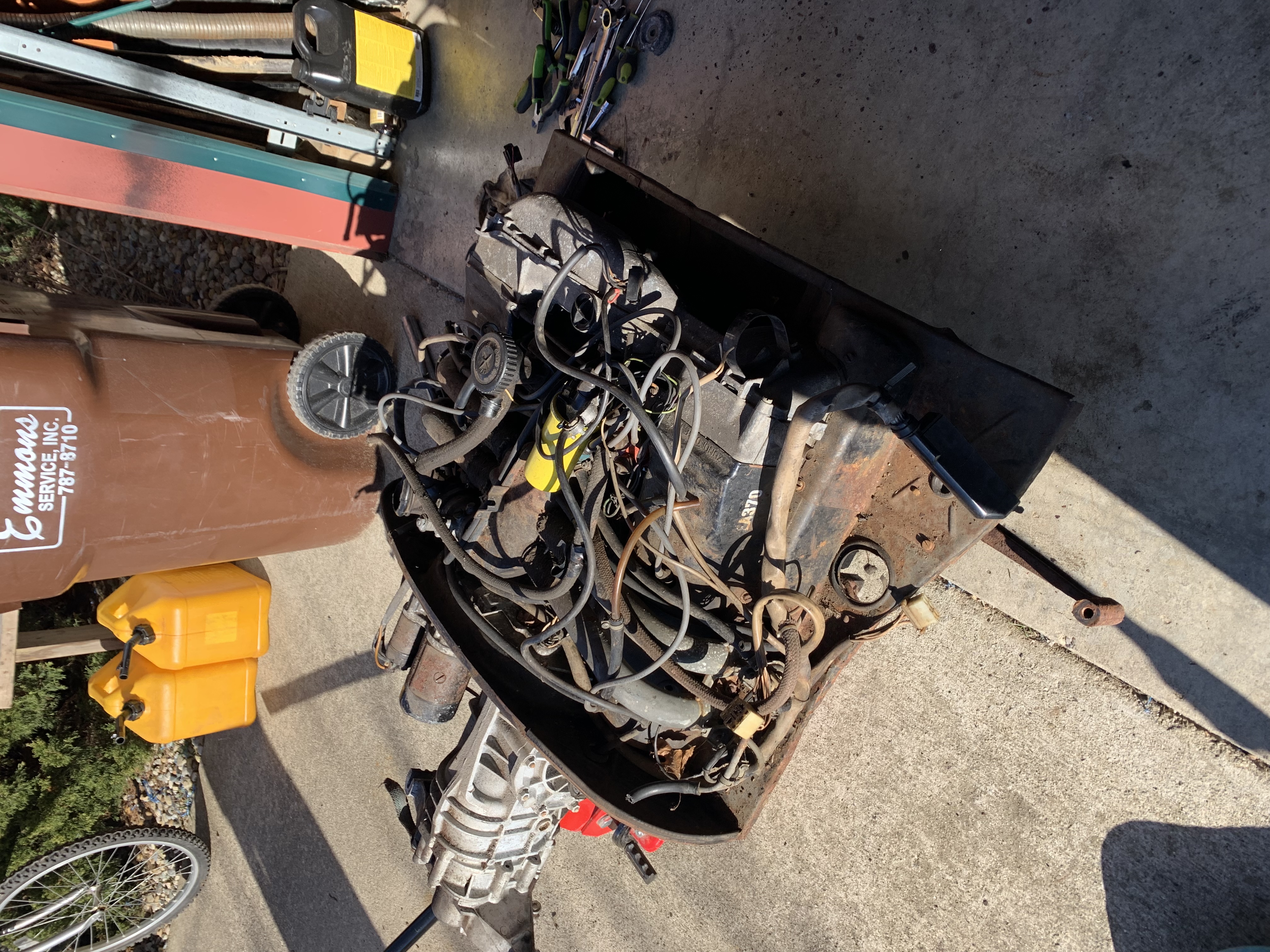

I have a ‘74 1.8L barn find - sitting 10-ish years due to FI issues. The flapper box is definitely tango uniform and literally in 4+ pieces. Other parts have been removed and am sorting through the rats nest of hoses and pieces. The entire system is in question and I really don’t want to try to find hard to find parts.
The engine was only a quart low and amazingly had very few leaks. The odometer shows 15k miles (115k according to PO). After pulling the engine, I put a ratchet on it (after oiling, etc) and compression “feels” good with no grinding, squealing or grit feel. Will be checking compression officially shortly. The engine’s rebuild history is unknown, so am doing a thorough check. If there’s any hint that it needs rebuilt, it will become a 2056 with microsquirt. If it’s useable as is, I’d like to use parts I have to get her on the road - namely a djet FI system. I would then run her (her name’s Saphira) with the 1.8L until I get a 2056 built. As it’s been said many times here - a 914 going down the road is always faster than one on jack stands!
I have a full ‘73 1.7L djet system and most (missing mps) of a 76 2.0L djet system. I would get a new harness for either djet and rebuild the mps. Assuming I get whichever djet system refurbished, is it a simple remove ljet and replace with djet (distributor too)? Or will the different compression/displacement of the 1.8L cause issues? Any electrical connection issues to the rest of the car? I really appreciate this community and everyone’s helpfulness! Any hints, tips or suggestions are appreciated!

CSoso   Good evening! Thank you, everyone for the rep...   Mar 27 2022, 06:14 PM

Van B   Something strange about that intake boot. Doesn...   Mar 27 2022, 08:48 PM
wonkipop   Something strange about that intake boot. Doesn...   Mar 28 2022, 01:45 AM
Van B   Something strange about that intake boot. Doesn...   Mar 28 2022, 10:22 AM
wonkipop   @CSoso thanks very much for taking the trouble t...   Mar 28 2022, 01:42 AM
