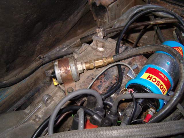

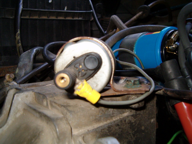

I am posting a pic of something mounted on the front of the engine on the passenger side. I can't find this in the books and have no idea what it is or what it does. If anyone knows I would like to know as well. (IMG:http://www.914world.com/bbs2/html/emoticons/confused24.gif)
Dave, the hts is coming in a 170 ohms when hot. Does that pass or is that bad.
Here are a couple pics of that thingamajig. The hose conected to it runs down into the engine tin right beside the distributor. The wire coming out the front connects to a green and red wire that goes through a harness and ends up on the corner of the relay board on the rectangle conector. (IMG:http://www.914world.com/bbs2/html/emoticons/wacko.gif)
Let me know if you have any ikeas.

another pic ot that thingamajig

never seen that before. seems like some kind of AAR device.

That would be an oil pressure sender, the purpose is to give you and actual reading and not a green light when it's too late.

woah....i thought it would be cooler looking. like chrome

Ah! Yes that makes sense. I have the extra gave in the car. So focussed on trying to figure this problem out that I can't think straight. VERY frustrated. (IMG:http://www.914world.com/bbs2/html/emoticons/mad.gif)
