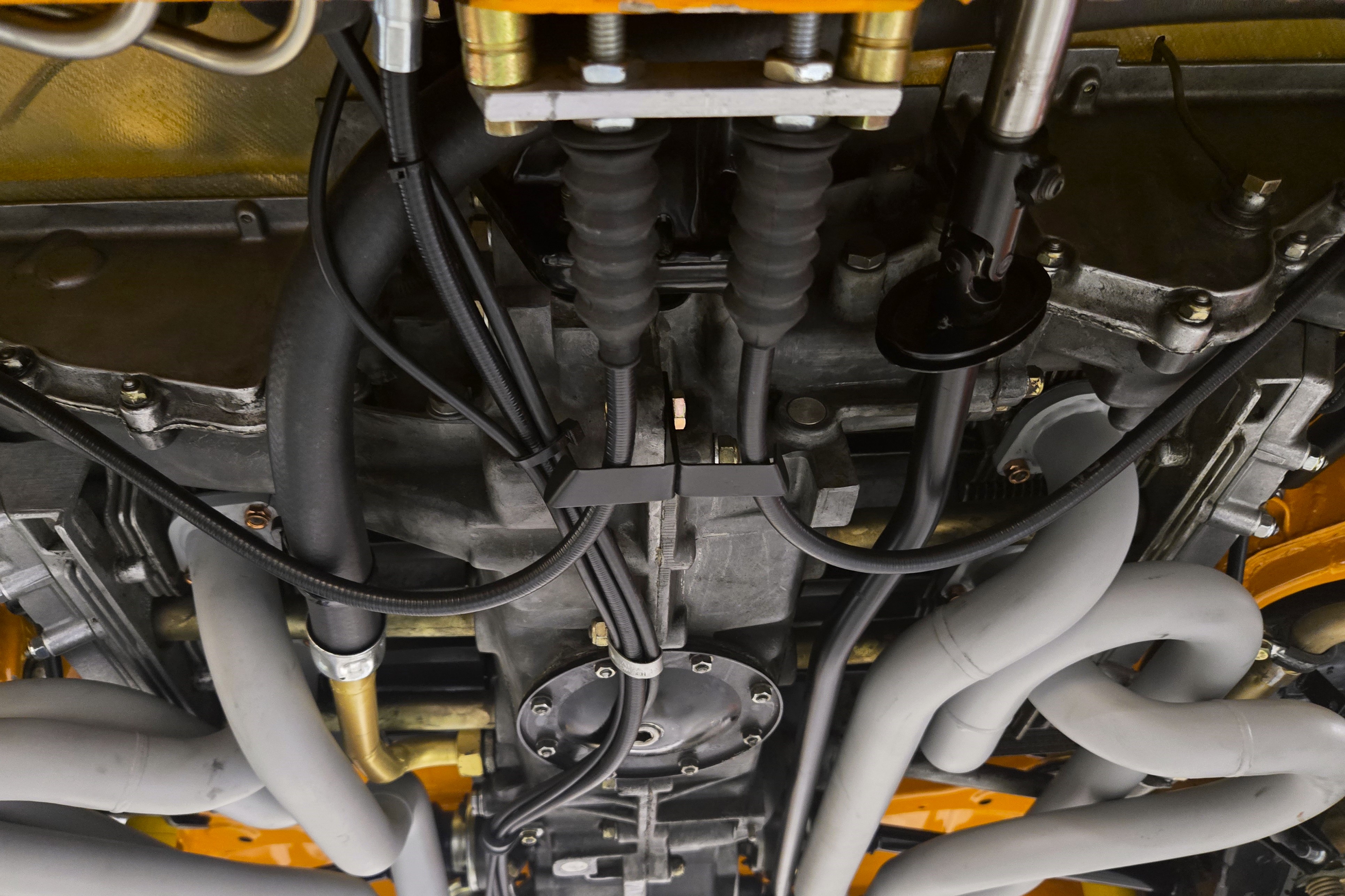

Nice build..
You may want to let the shop know that the trans cup washers are installed upside down.

QUOTE(Luke M @ Sep 20 2024, 07:17 AM) *
Nice build..
Hey Luke the upside down cups might be a deliberate choice.
It could be done to provide stiffer location of engine / trans for improved shifting etc.
Beautiful work all around.

QUOTE(rgalla9146 @ Sep 20 2024, 10:29 AM) *
Nice build..
(IMG:style_emoticons/default/agree.gif) Thank you, that's exactly why they're installed this way. Appreciate the kind words... and thanks Tom, the effort is worth it.

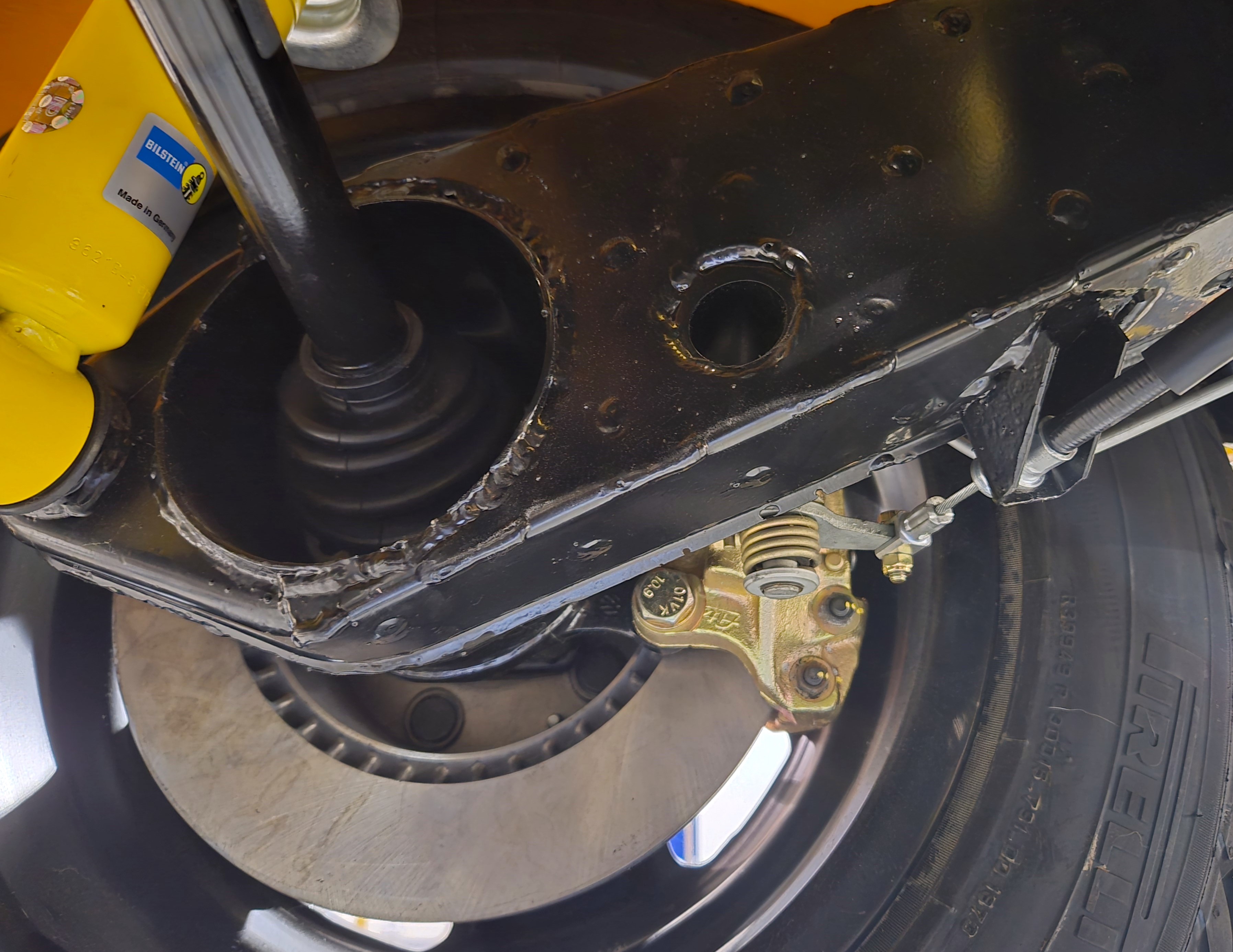

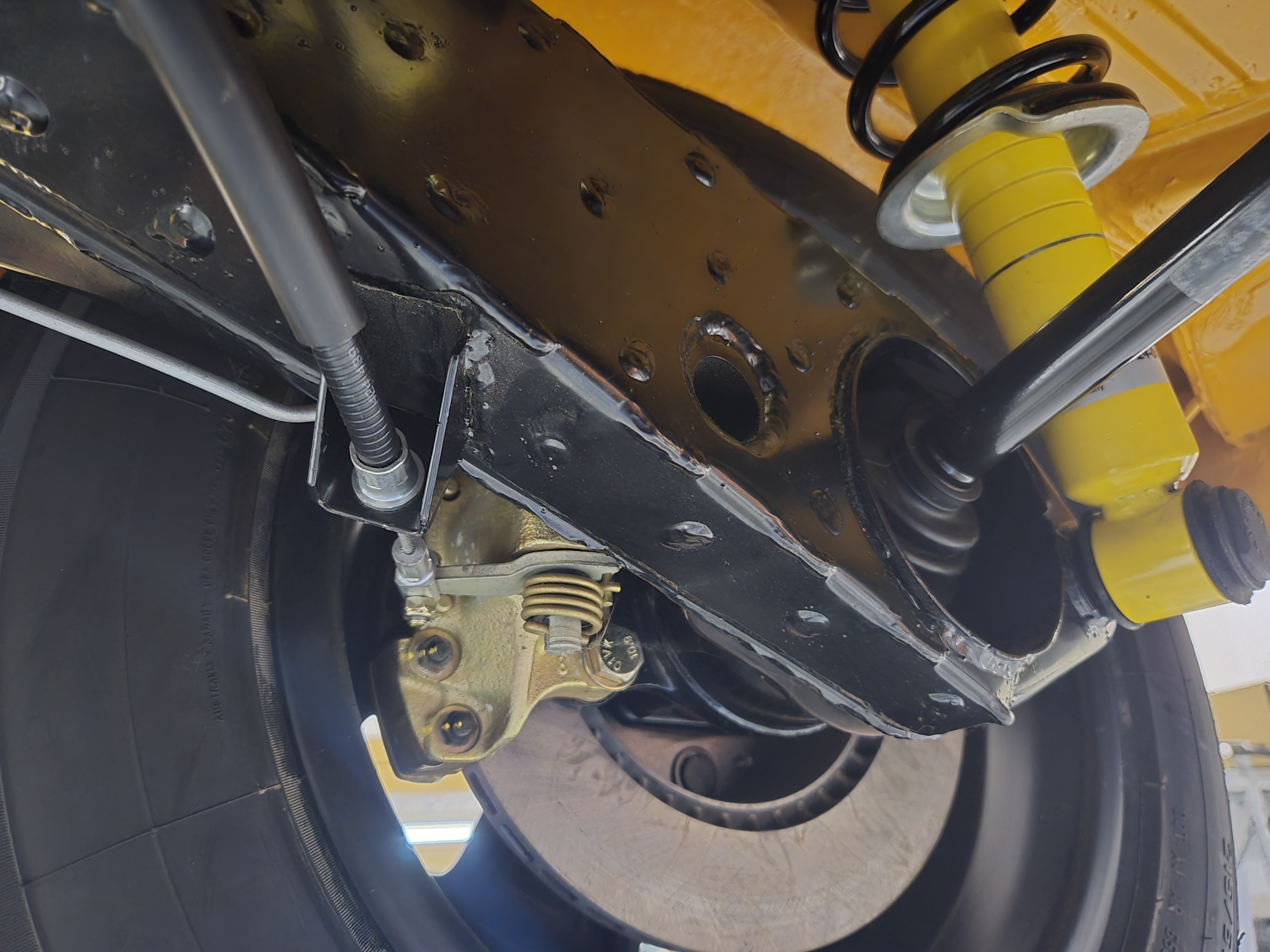

More detail of handbrake install. Thought we may have to modify 911 cables, but stock ones fit perfectly. This mod was way easier than anticipated, mounting plate for adjustment and a small bracket to keep the cables away from the headers.
Will also be wrapped with heat barrier.
