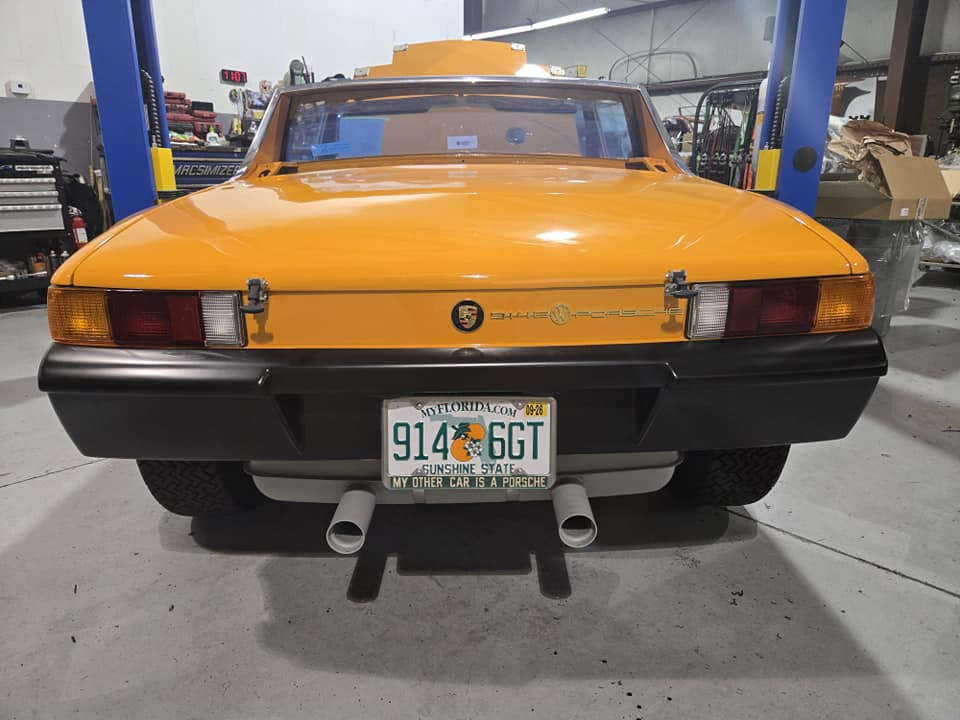

It's street legal! (IMG:style_emoticons/default/driving.gif)
All of the niggly bits are being completed, will post photos as the punch list is addressed.

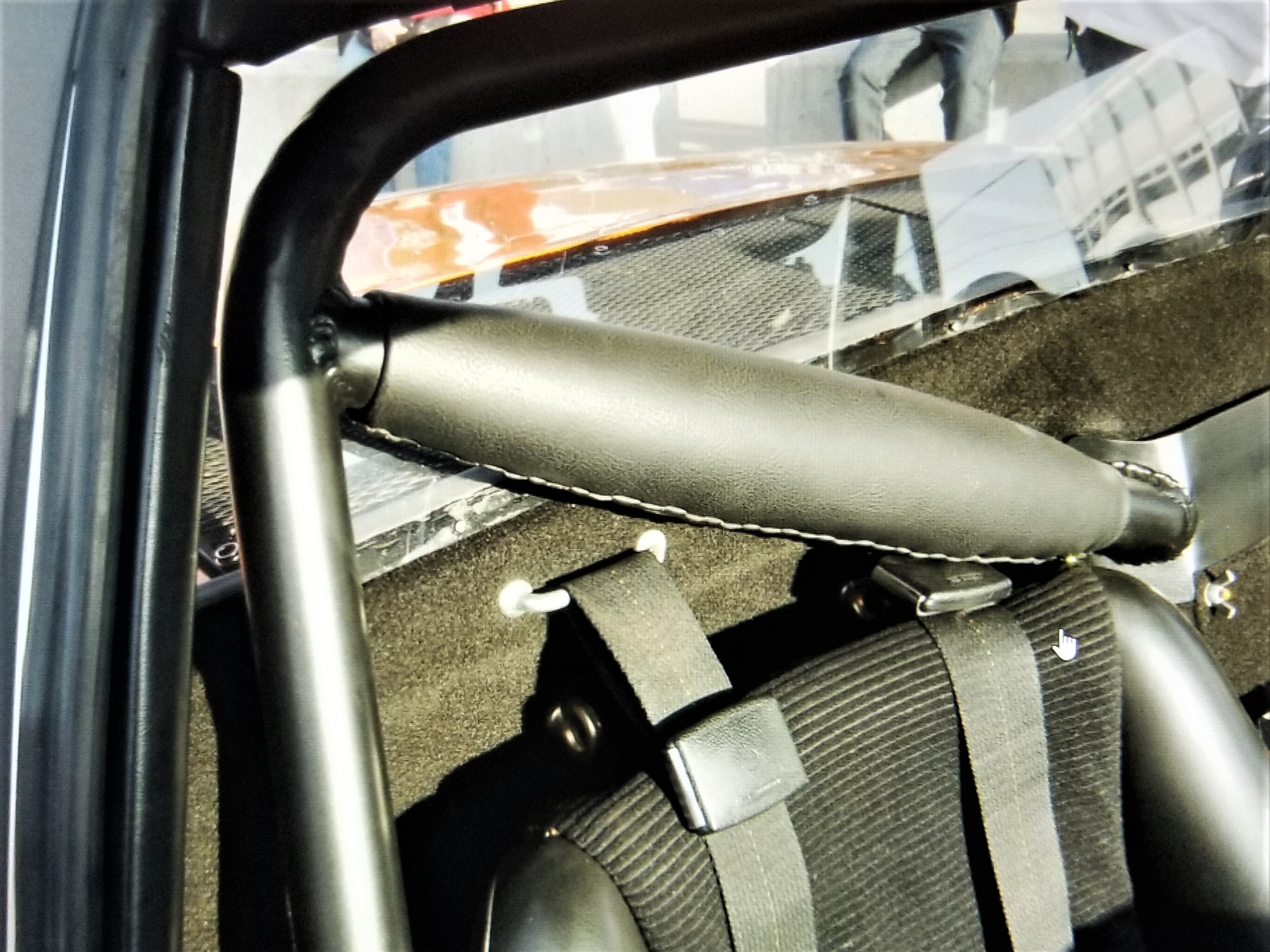

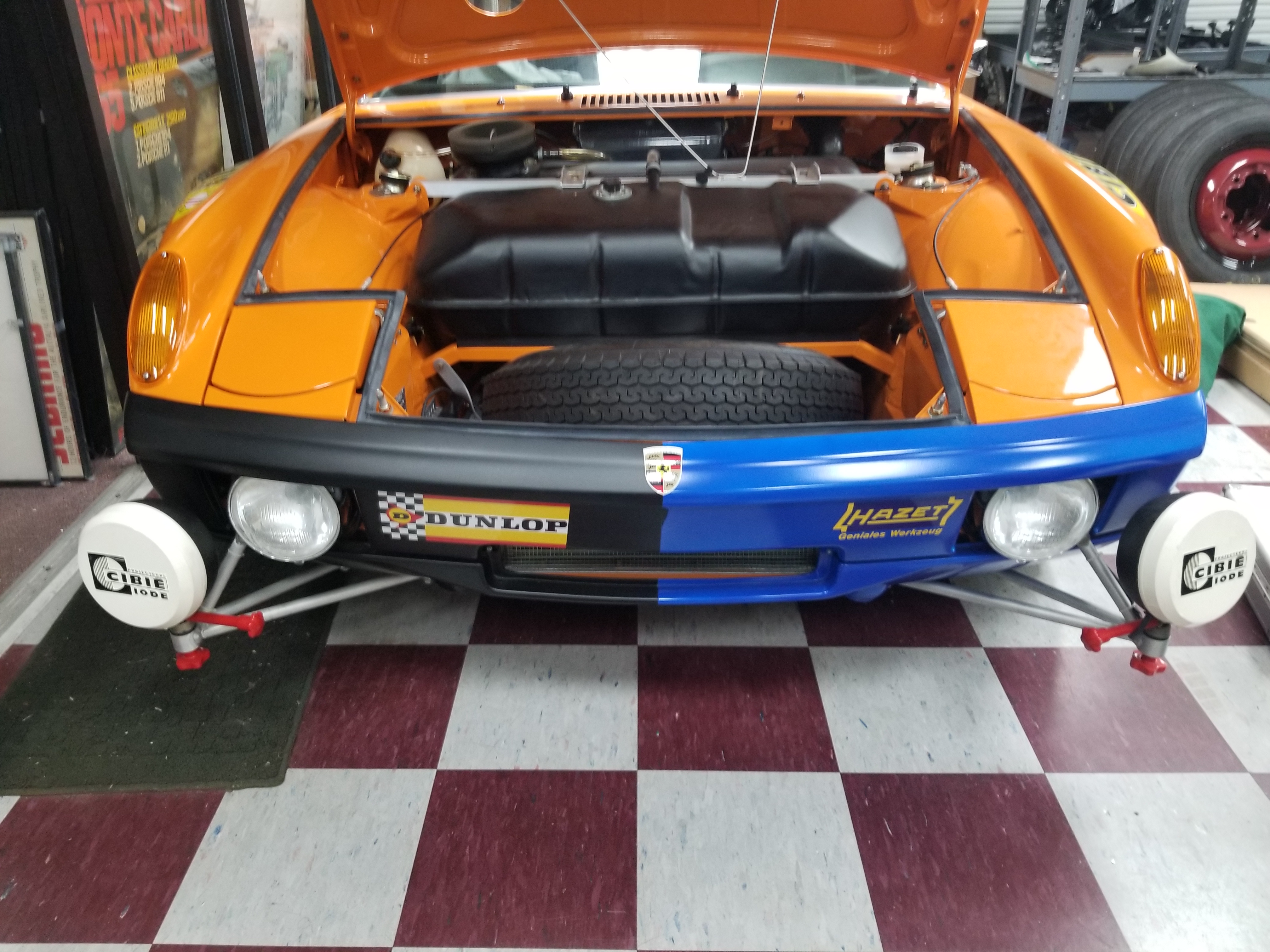

Hit an unfortunate snag with the roll bar: factory GT roofs are bolted in place, I thought it would be nice to take the roof off occasionally.
So we need to modify the bar because the latches aren't accessible, not sure we'll get that done in time for Highlands next month. Stay tuned.

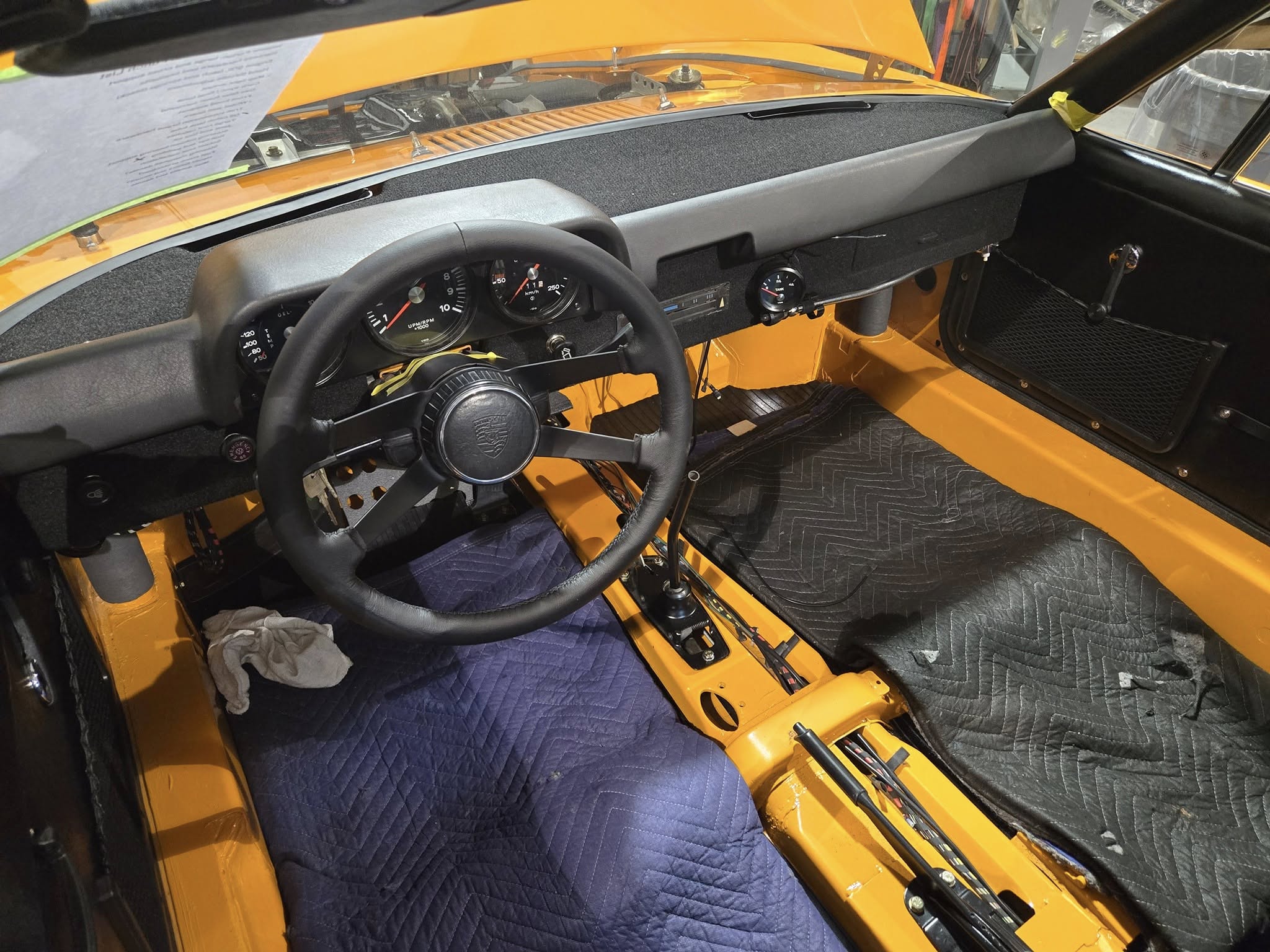

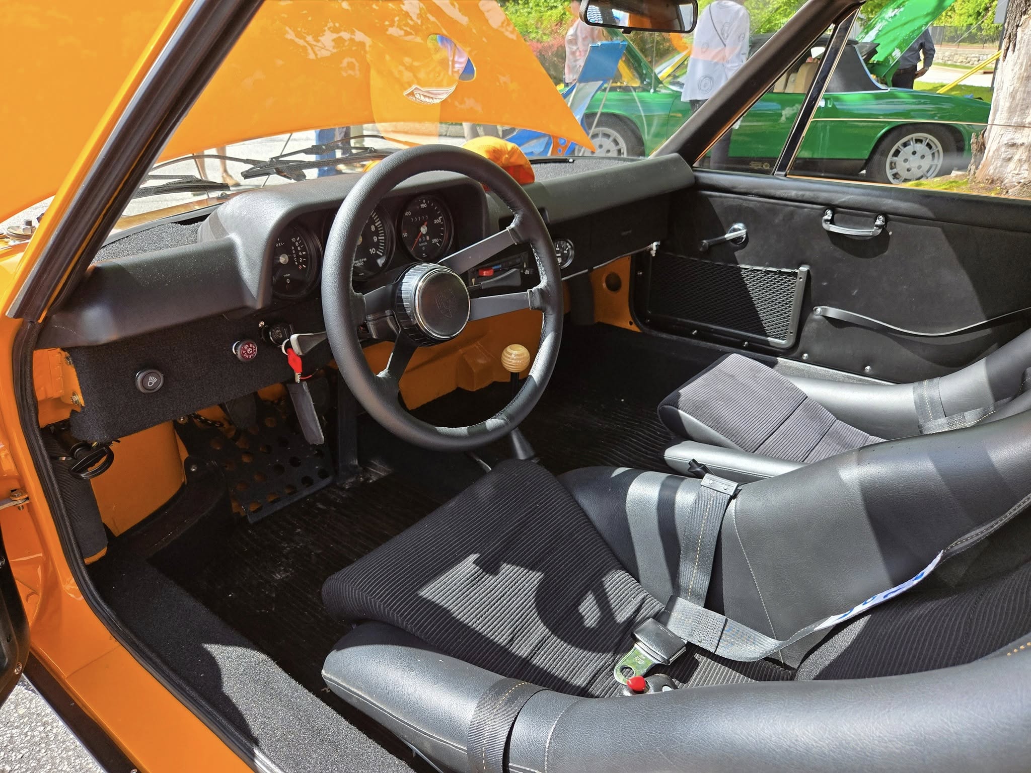

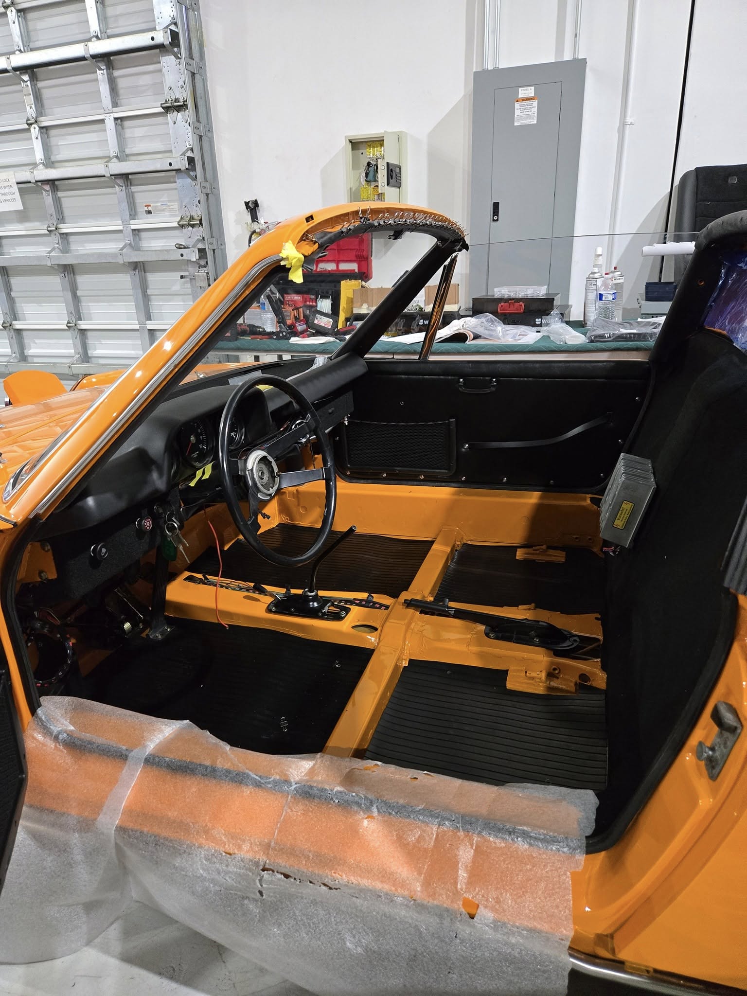

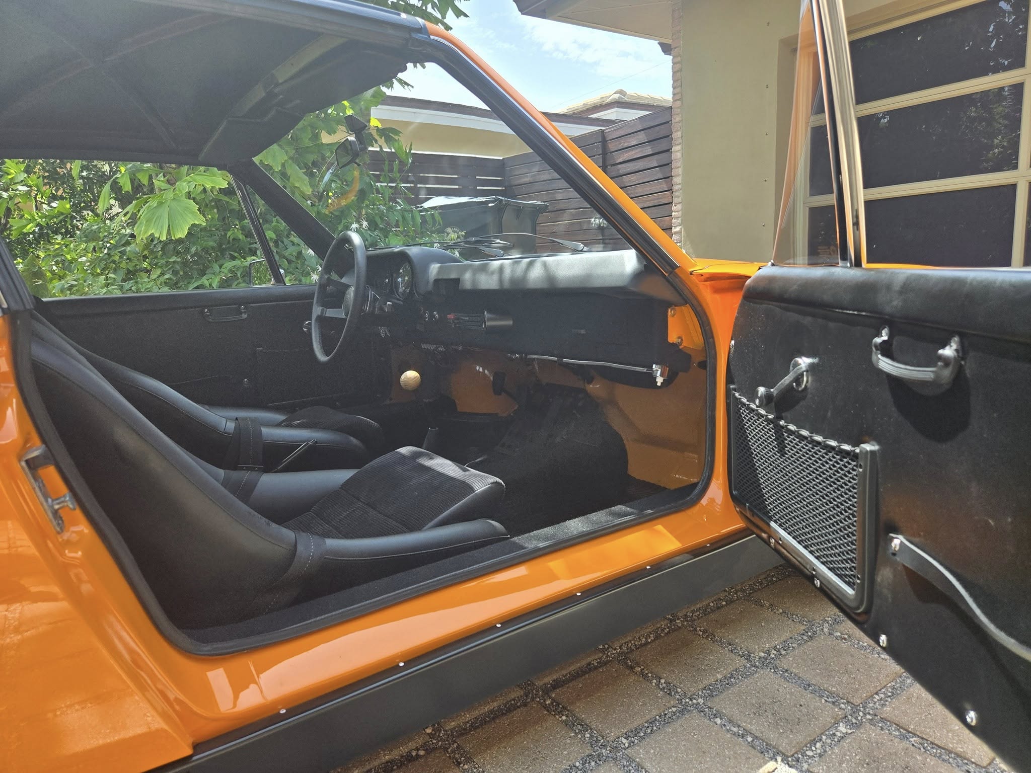

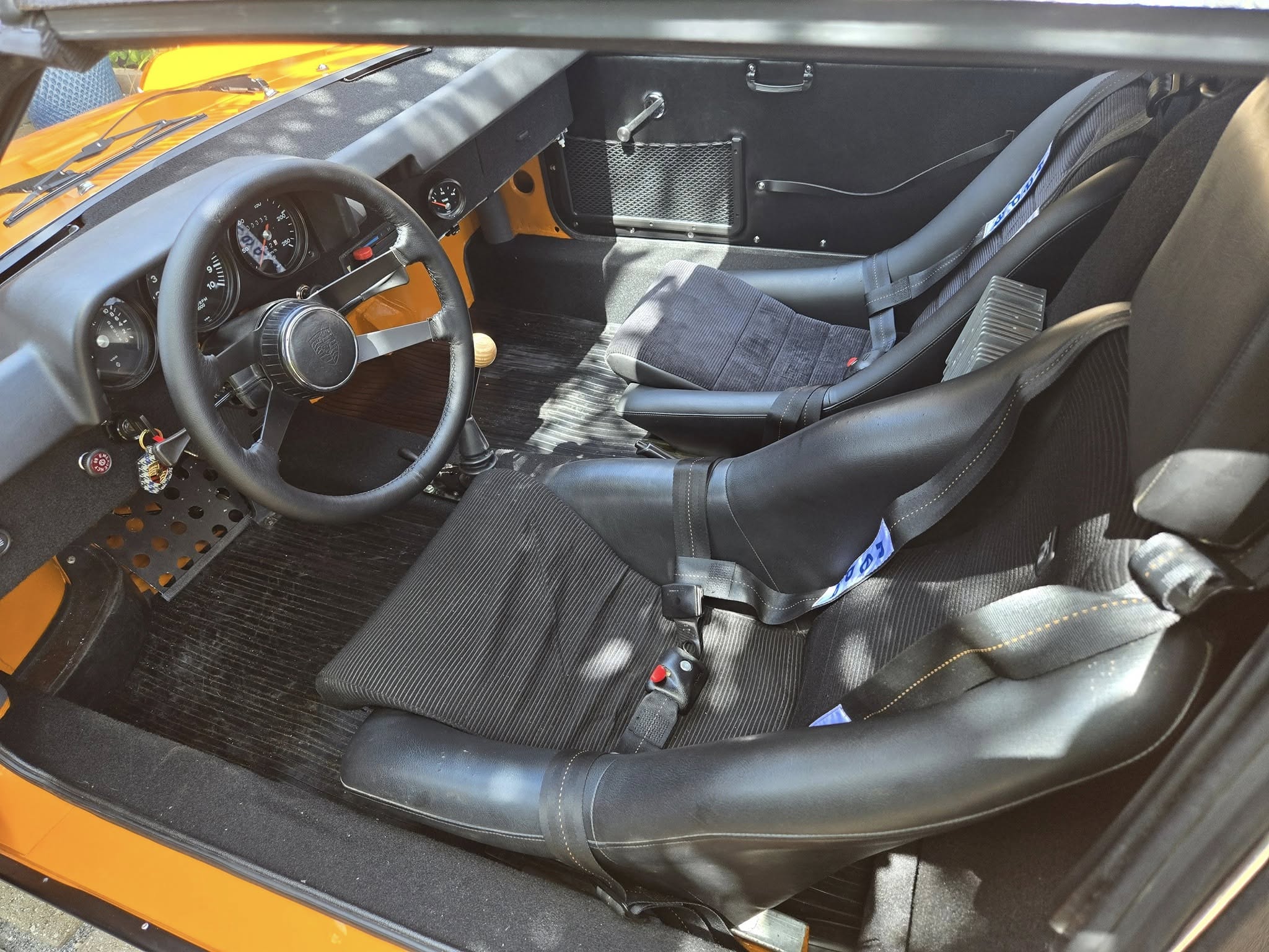

Door cards and rubber mats came out nice, will fit the Perlon next.
Had planned to make a box for the passenger door, but found these mesh pockets on Amazon for cheap so applied to both doors.

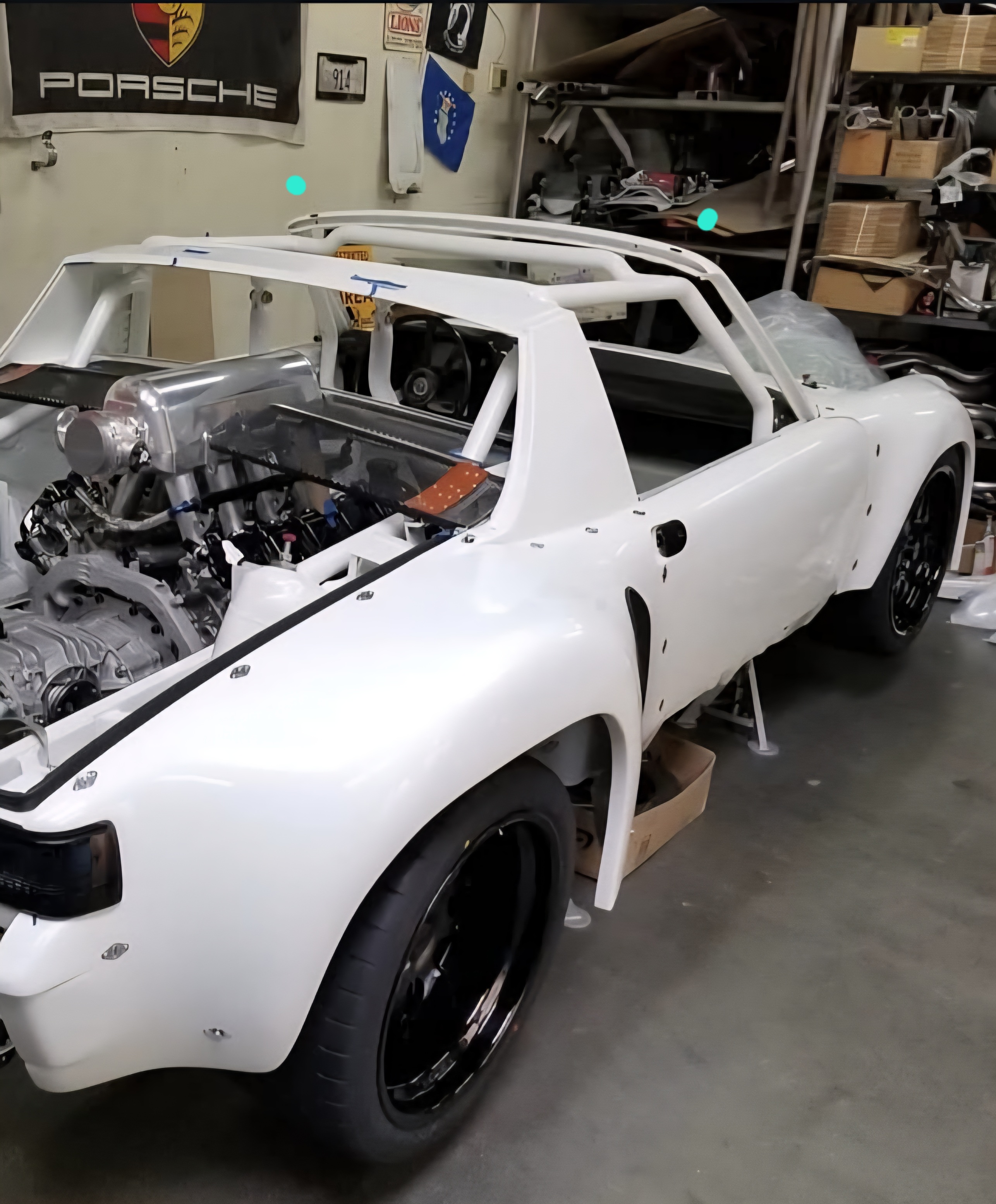

@Bullethead ...Russ, have your fabricator make these compound bends of the Left + Right ends on the top bar, a bit of work>> but I like it when the 914 tops can be removed. OE latches work with this design.

(IMG:style_emoticons/default/smilie_pokal.gif) Thanks, was just out for an evening drive and something similar jogged in my head. Moving the top tube inward a couple of inches will clear the latches, and the cross tubes can be moved down to accommodate.

I am using Chris Foley's (Tangerine Racing) GT roll bar. Test fitting seemed to indicate that there will be enough room for the rear Targa latches. Fingers crossed on that.

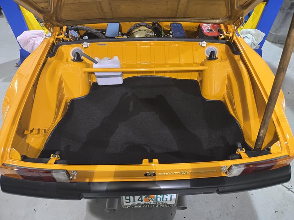

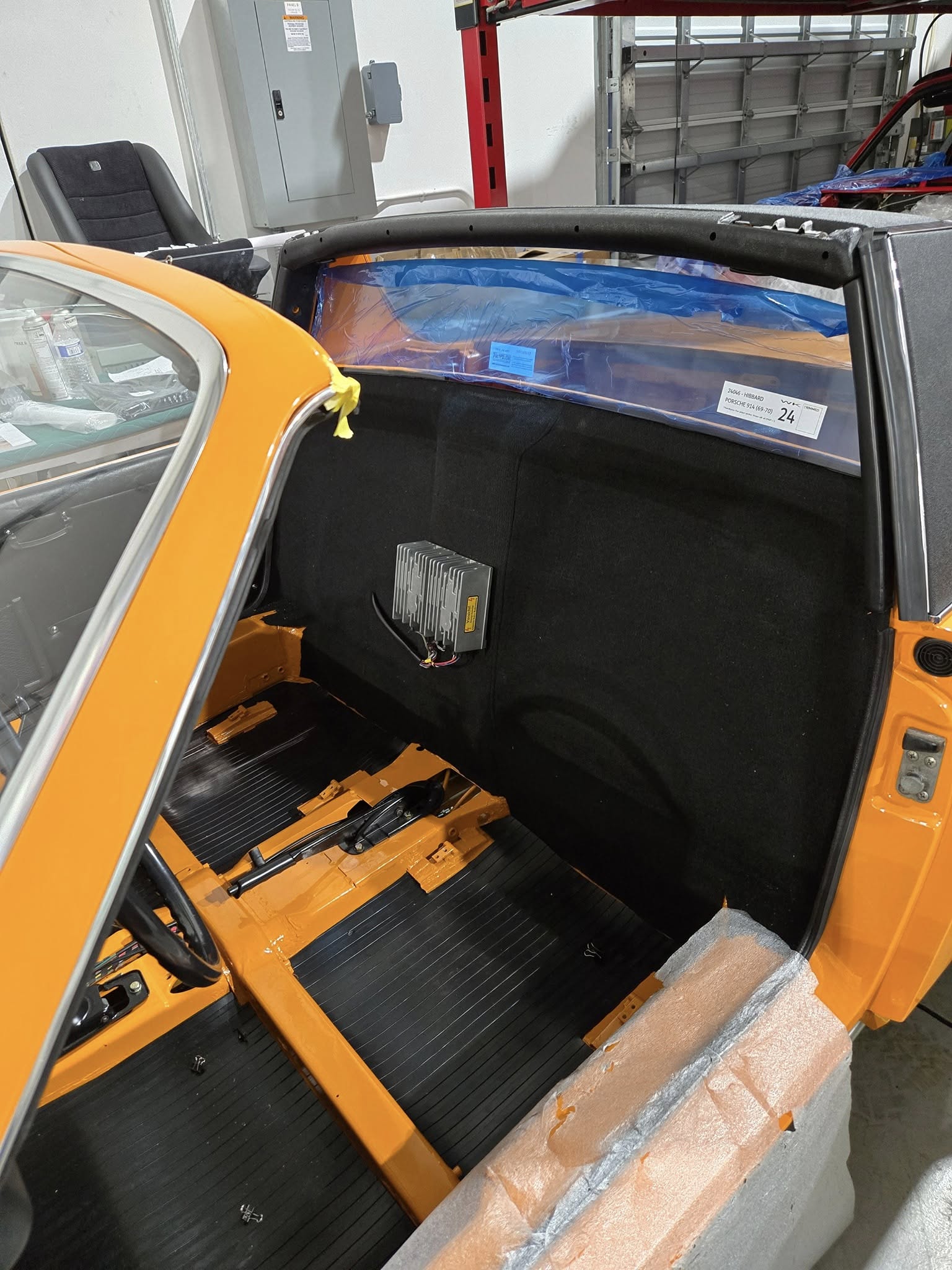

Trunk is done, fancied up a bit with a Perlon mat. Restoring the jack. Installed Porsche crest, new wheel. Off to a four-wheel alignment next Tuesday...

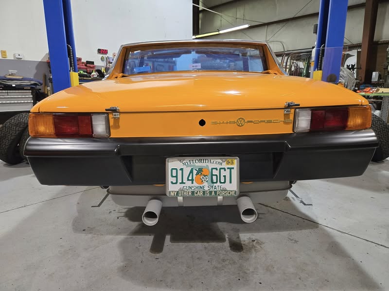

Both trunks are done and tomorrow the rest of the interior will be finished. Need to put some miles on before it's shipped to Highlands on Monday. More images then.
Meanwhile, the engine grill is high on the right as can be seen in the photo. Anyone have an idea of how to get it even? Feels like the springs are holding it up.

A question on the GT front hood prop: The springs on the one I bought from PMB are not strong enough to hold the prop against the inside pf the hood when closed. Did you have any issues with yours?

I struggled with the same problem Tom. I wound the spring an extra time to get enough tension but it would pull off the bend in the bar, so I hacked a little cable clamp. Not the most elegant, but it works. John

Hey Tom, PMB's prop worked fine in it's OG configuration... but won't for a GT tank! It's symmetrical, and the GT tank has a fuel hose smack in the middle, so what works is asymmetrical. I made a new one using their springs and it's inadequate. Will re-do when we get back after next week in NC.

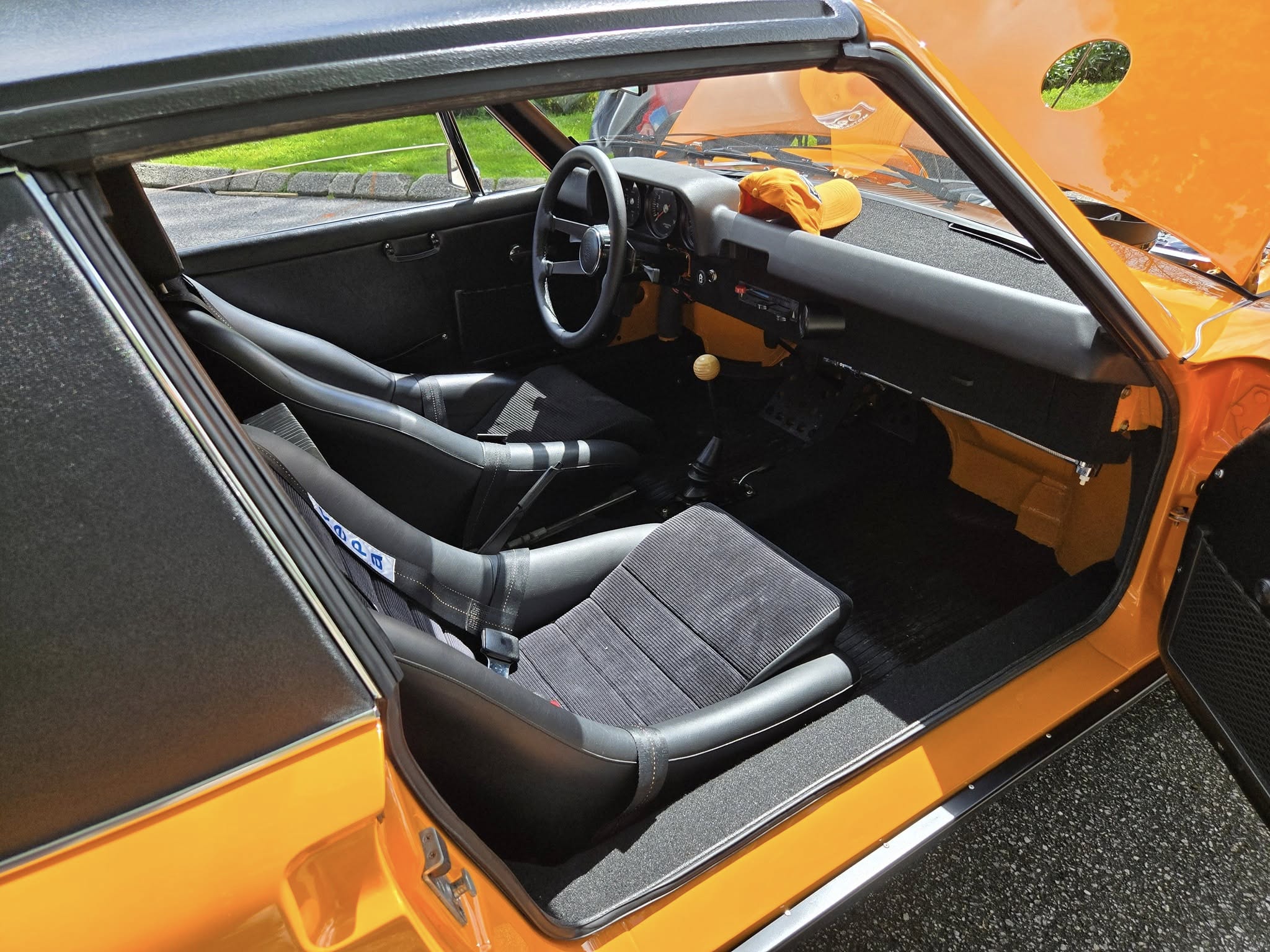

Winding down to the finish... sort of. There are a few niggly items that need massaging/correction/replacement/etc. The roll bar must be redesigned to work with a removeable top. The engine lid doesn't fit well, should have made sure during bodywork. Three attempts to get the roof window seal tracks from Stoddard failed. Gave 'em the part number, they sent A pillar twice and B pillar once. >sigh< With no time left, contact cement to the rescue... but the windows don't seal completely. No matter. It looks great, runs fantastically, sounds and feels like the beast I thought it would be. The resurrection began a looong time ago, so driving it home was really special.

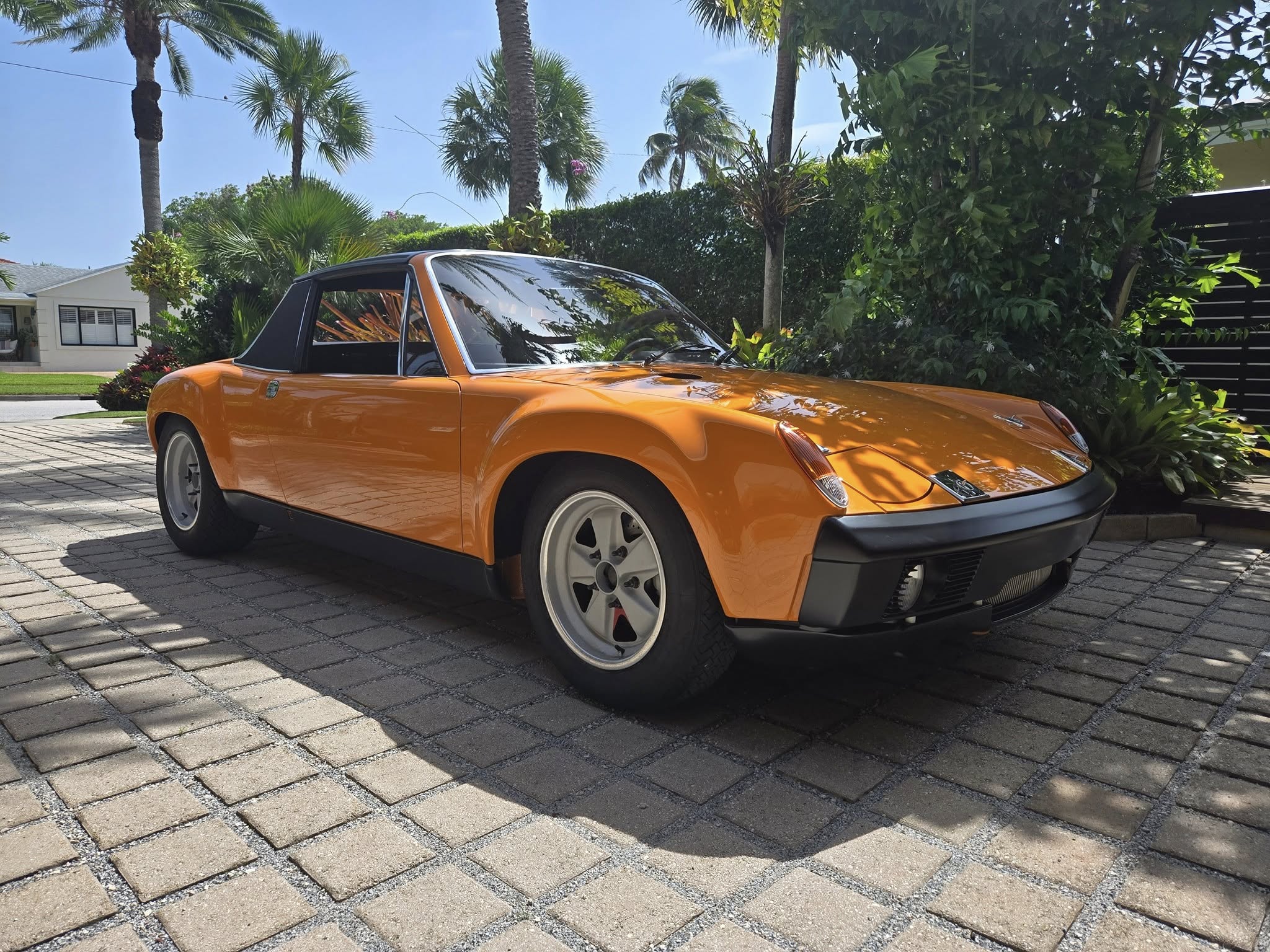

Finishing up this thread... we took it to North Carolina and put on some twisty mountain miles. The Highlands Classic Motoring Festival is three days of driving and a Saturday Concours.
Our entry was awarded "Spirit of the Highlands" so we are very proud. Normally, we don't name our cars, but this one is brash and loud, so we're calling it Rude Boy.
