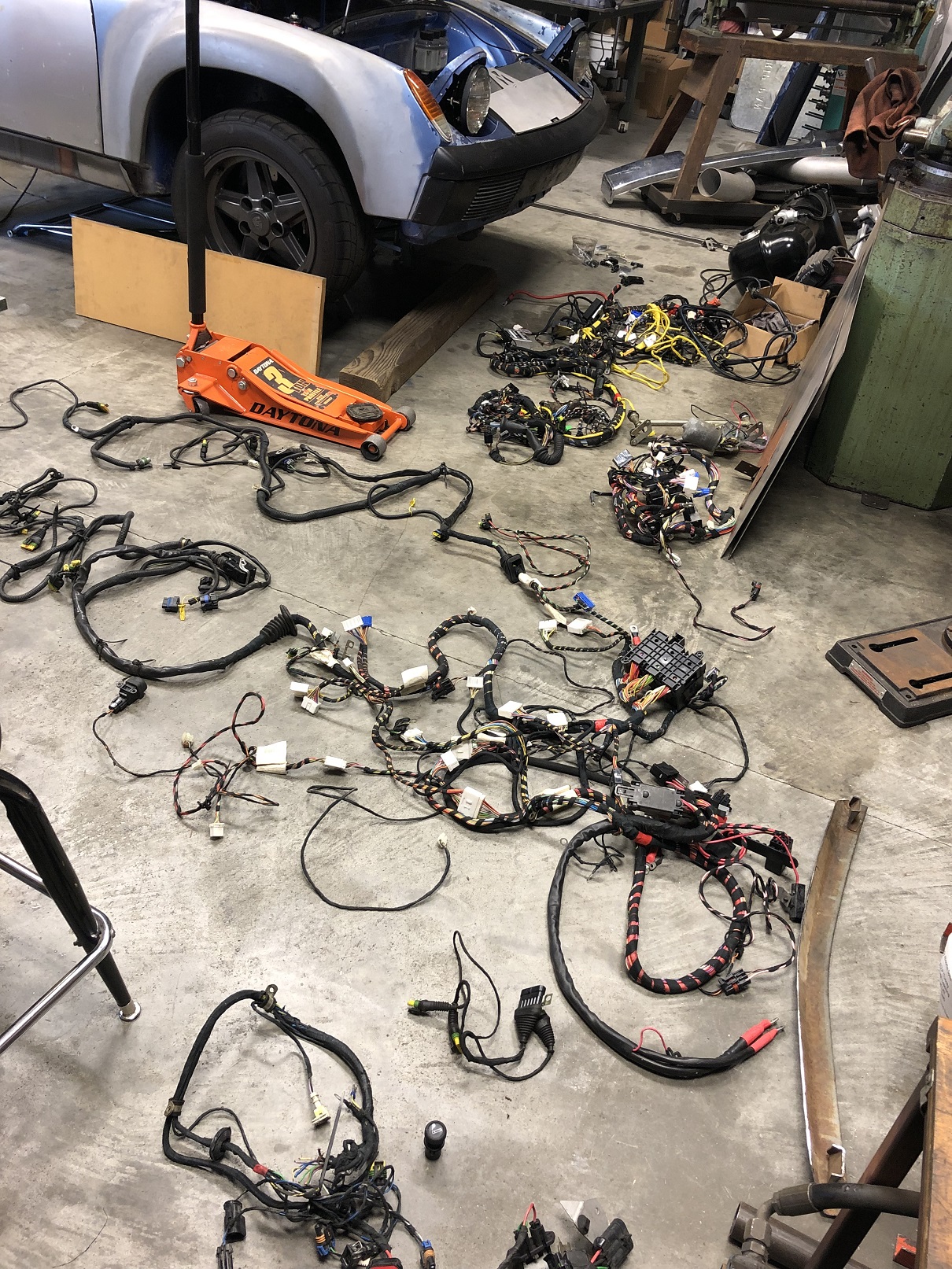

I've been spending most of my time trying to understand what it'll take to make the engine run stand-alone. There's an immobilizer that has to be bypassed. Good news is that there are a few companies able to supply the needed black box for that, as well as reflashing the ECUs to account for the bypass.
It's now a matter of getting hold of a wiring diagram and working out which circuits in the chassis harness have to be retained. Good news is the key has no transponder so it SOUNDS like the bypass will address the biggest issue.
The wiring stuff I just did for my LS car is child's play in comparison, given thousands of people have "been there, done that."

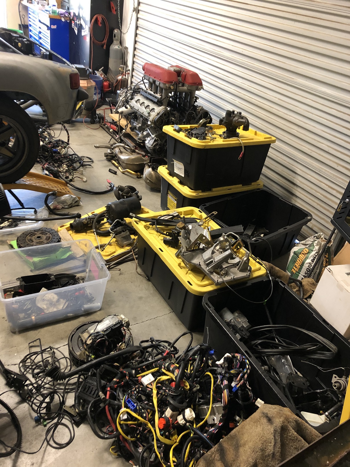

Then the owner said, "Come get the rest of the parts..." This is the first load. A bit of the back story is there were at least two 360s that contributed to the parts stash. One was an F1 paddle shift car, one was a manual. One was a spyder, one not. There are boxes of parts, not labeled other than "Ferrari". There's some F1 wiring, some manual wiring...
These are only some of the bins I've got to go through.
Who speaks/reads Italian? I'll need it to figure out which of these parts I need.
In cosa mi sono cacciato? (IMG:style_emoticons/default/wacko.gif) ( (IMG:style_emoticons/default/laugh.gif) )

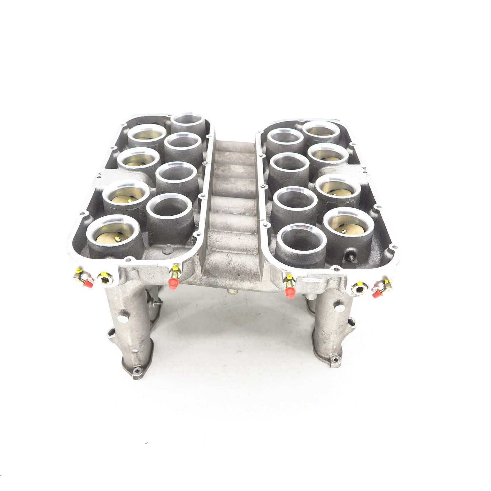

Some folks have asked about the intake set up. It really is quite the engineering marvel. If you're like me and find this sort of thing interesting, the link below will take you to a detailed write up about it.
At the very least, know this:
There are dual, DBW throttle bodies that control the air flow into the plenums, just like you'd expect. But those butterflies in the intake runners AND the valve that connects the plenums? They're operated pneumatically.
https://aldousvoice.com/2013/01/07/ferrari-...-intake-system/
Remember, all this was available on the '99 360 (maybe on some earlier models, I don't know). Want to see something interesting? Google the new 'Vette Z06 engine and look the design of its intake. Sure, its a bit more refined but it certainly seems Ferrari was onto a good idea.

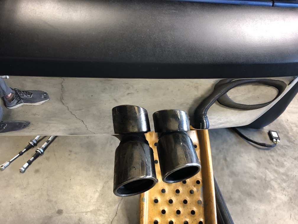

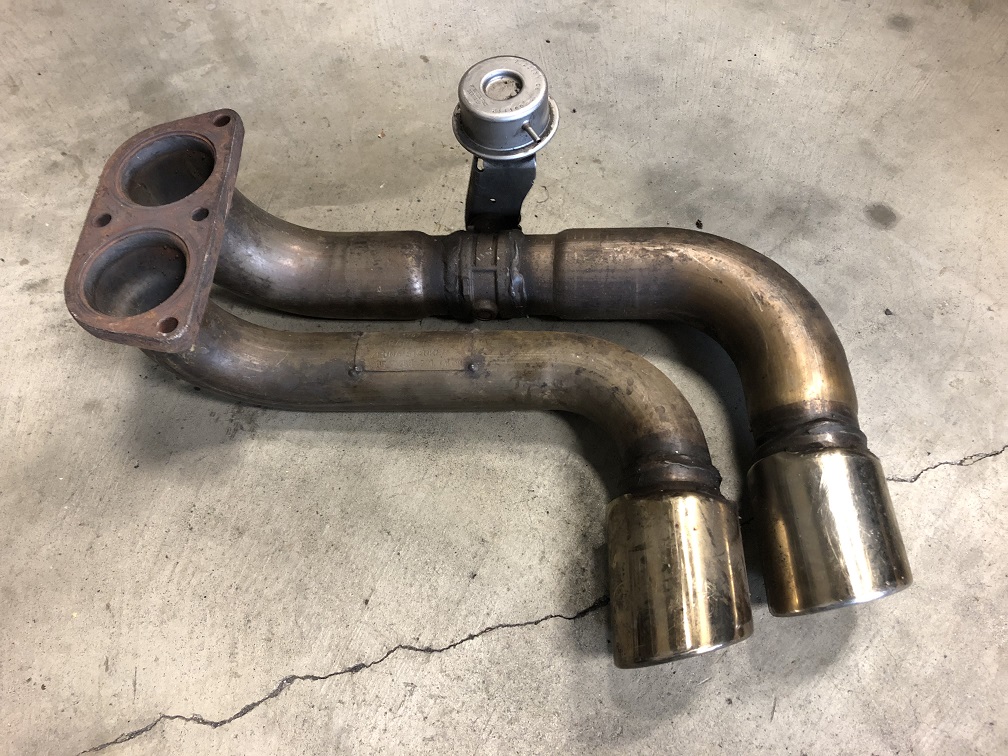

After scaring the crap out of myself with the wiring, I needed something to make myself feel better so when I came across part of the exhaust, I couldn't resist a "test fit".
It actually looks pretty good. Certainly better in real life than in these pics.
And yes, that exhaust bypass is actuated electro-pneumatically. An ECU signal triggers a valve to open and that same pneumatic accumulator that controls the intake manifold pops open a less restrictive exhaust path.

I love butterfly valved exhausts… such a cool idea. I planned on it with my car but didn’t have room.

QUOTE(tygaboy @ May 10 2022, 03:20 PM) *
The flange on that exhaust looks like a 914 2.0 (IMG:style_emoticons/default/idea.gif)

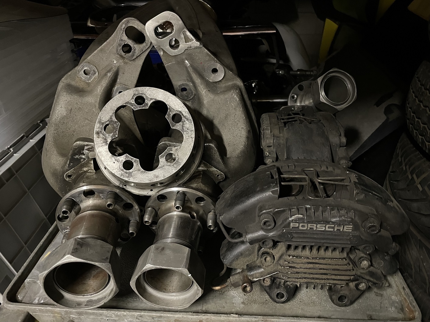

Too many projects, not enough time. Well, that and we were searching for all the Ferrari parts that were somewhere amongst a very large (I mean LARGE) parts stash of air-cooled 911 stuff.
And it always takes longer when your searching is interrupted when you stumble on something, umm, "unique".
Factory 935 rear suspension, center locks and calipers anyone? (IMG:style_emoticons/default/w00t.gif)

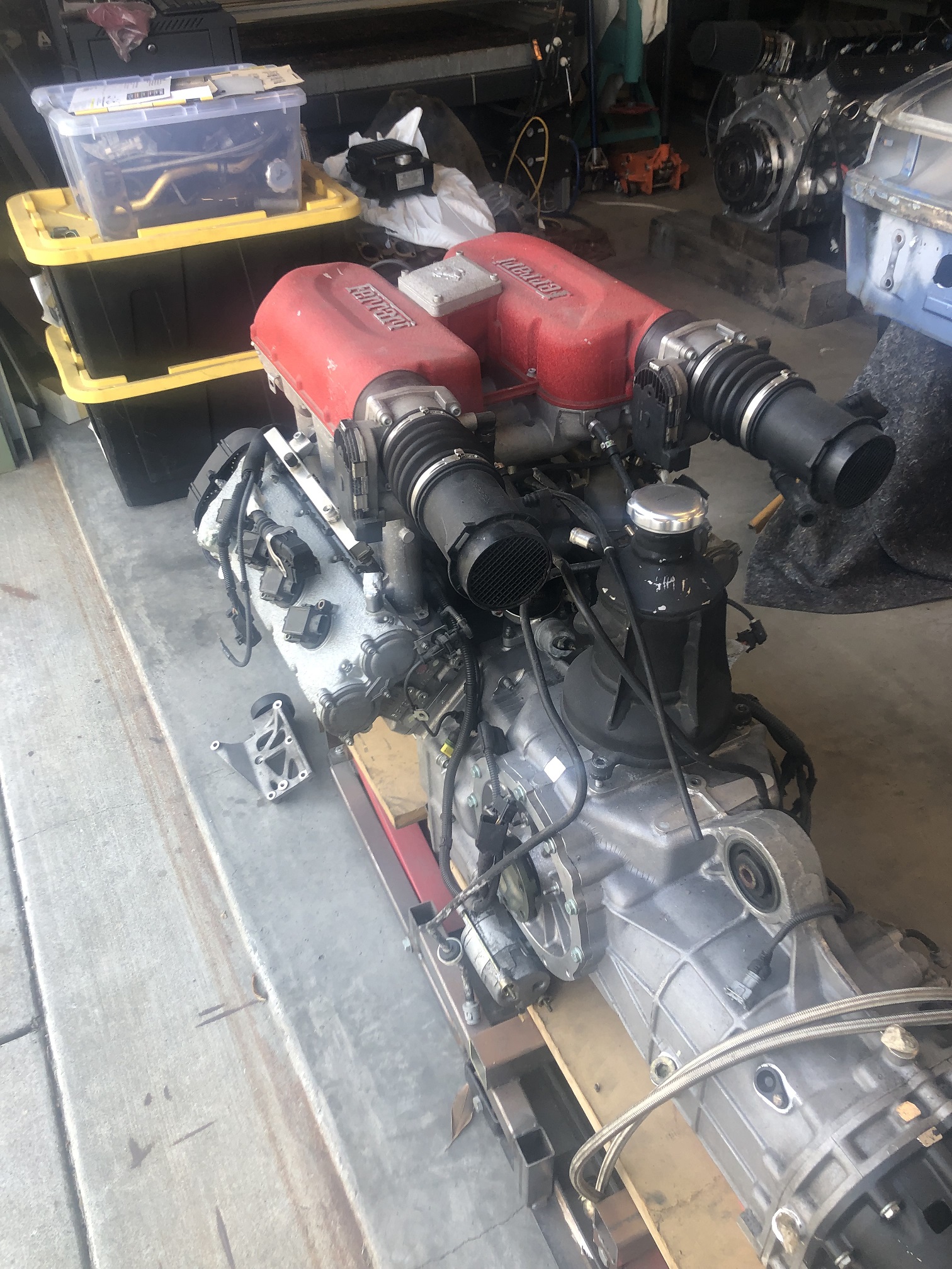

Posts: 5,859

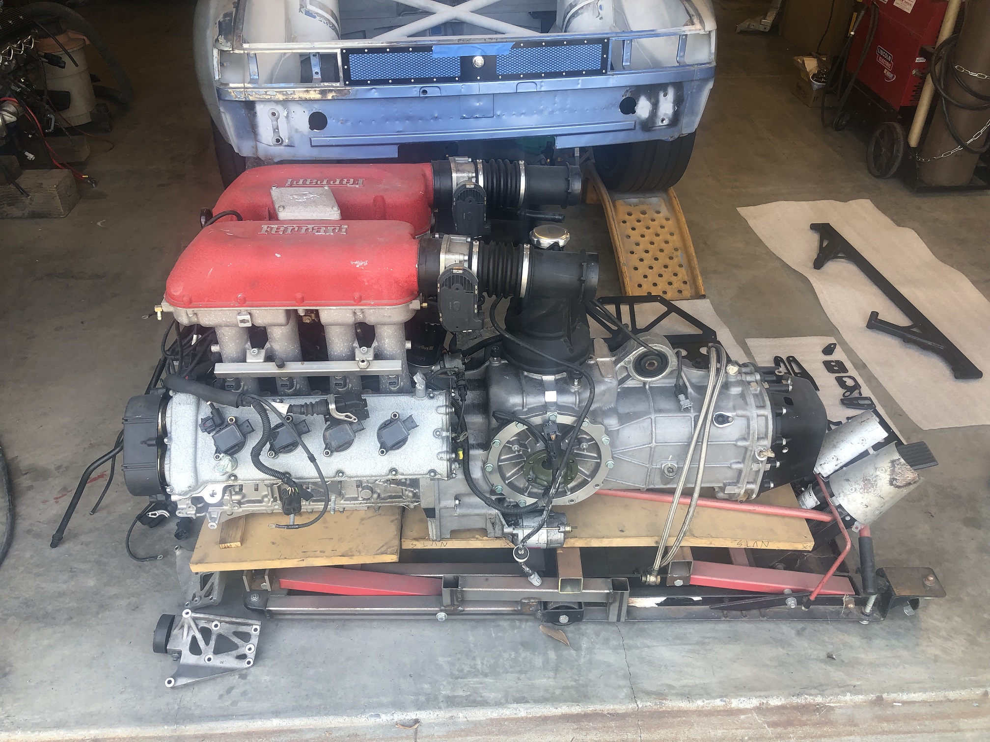

But back to this build. We found all the parts that were there, most importantly, the engine ECUs, oil separator tank (and cap w/dipstick) and the throttle bodies/MAF sensors.
And you thought the engine looked big before...!
Back to the parts. Just some perspective in a "and you thought Porsche parts were pricey!" sort of way:
The ECUs (remember, there are two) command ~$2500 - $3000. Each. That oil tank cap/dipstick? Used, they're about $200.
So finding all the parts we possibly can is a good thing.

QUOTE(tygaboy @ Jun 22 2022, 05:50 PM) *
Damn... I would love to have those to go with my flat fan on my 914-6.
I even looked up how much wheels would cost....
