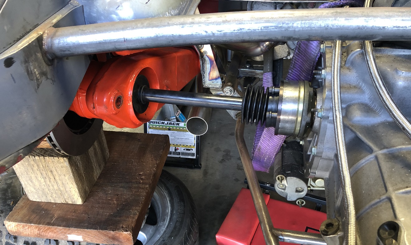

Teaser shot from tomorrow's video:
I'm pretty sure this is the world's only Ferrari gated 6-speed connected to a 914 trailing arm.

post May 31 2024, 06:02 PM
Post #1034
Posts: 1,981
Joined: 28-March 03
From: Millville, NJ
Member No.: 487
I think that’s a safe statement to make (IMG:style_emoticons/default/smile.gif)
