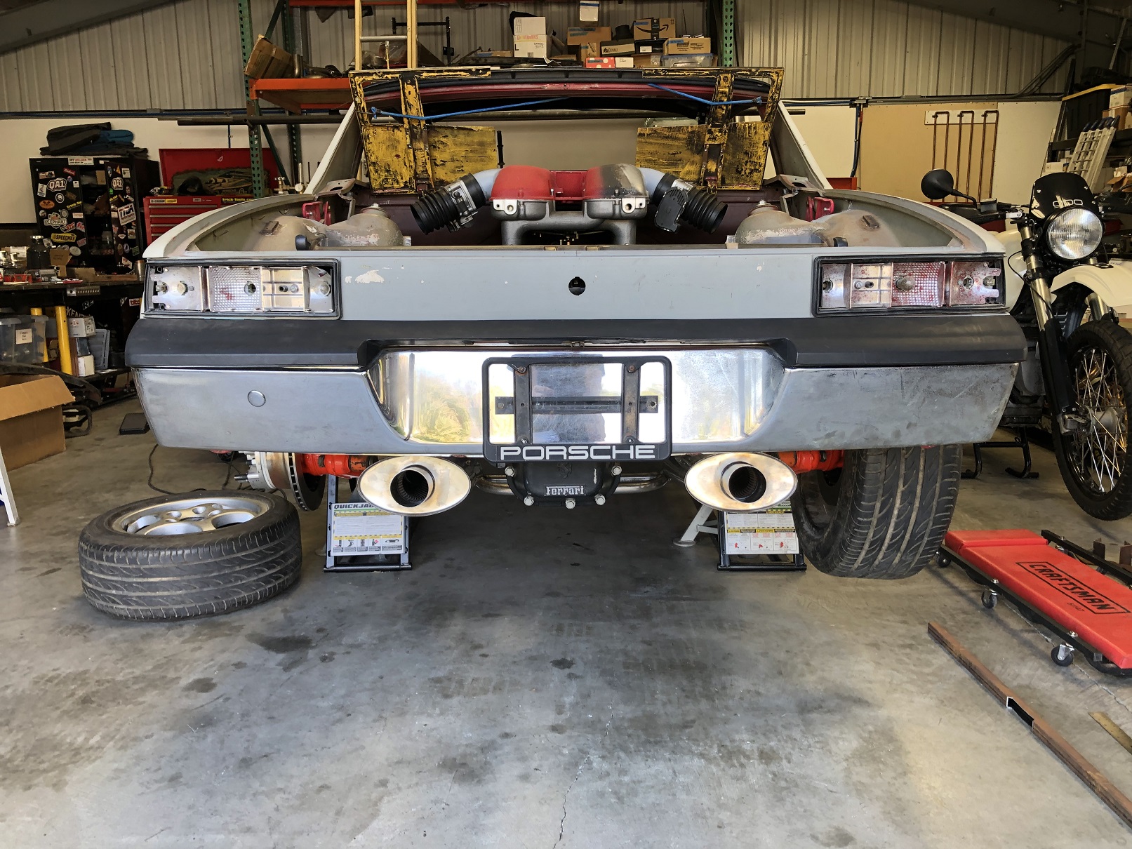

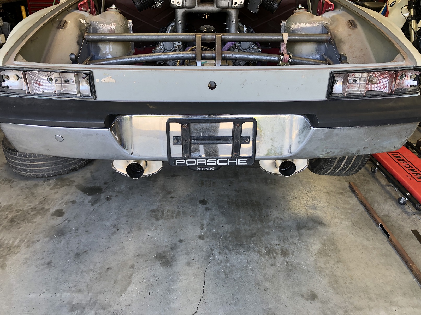

Everything tacked, ready for final welding. Note there's not yet a rear mount supporting the rear of the mufflers - they're only held in place by the double slips so things aren't completely in their exact, final location.
But I couldn't be happier with how this exhaust is turning out.

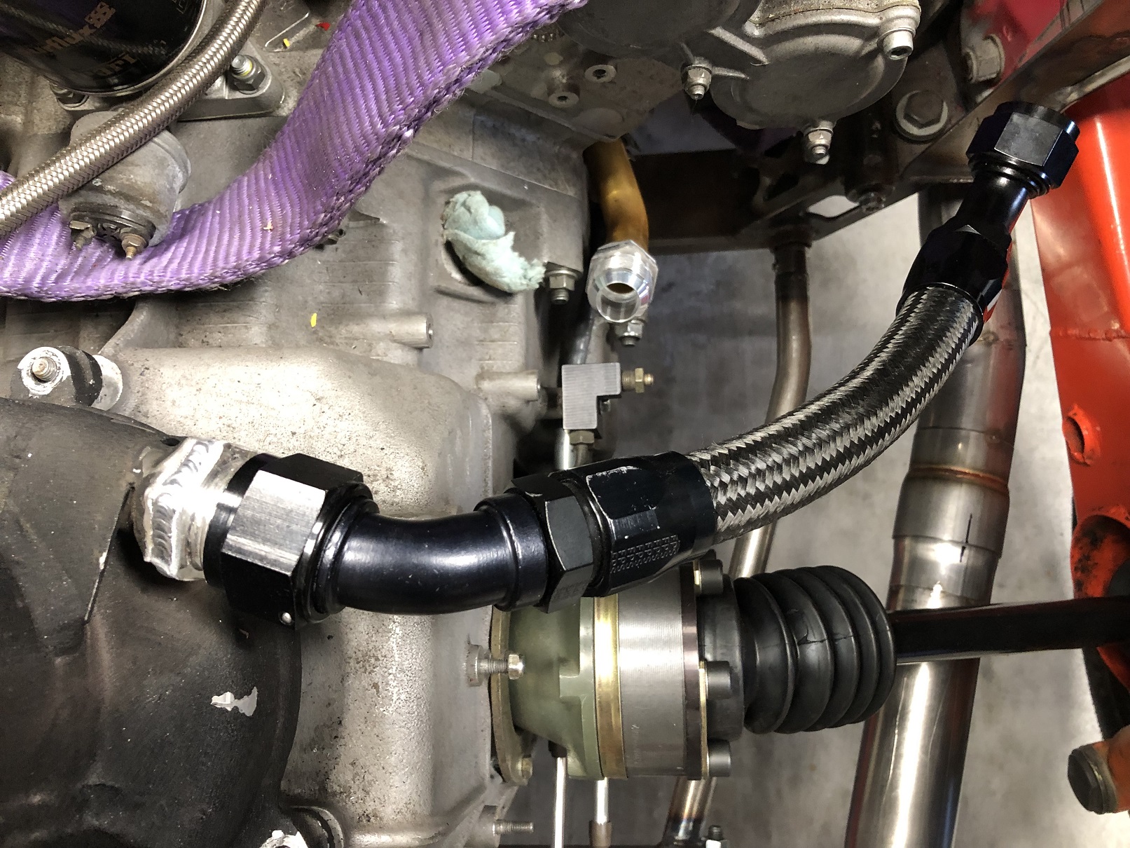

Getting started on the oil lines. First step was to install the weld-on -16 AN fittings on the air/oil separater and the low pressure return line. The oil cooler goes between these two fittings.
The line pictured is a spare I had, not the actual piece that'll be used.

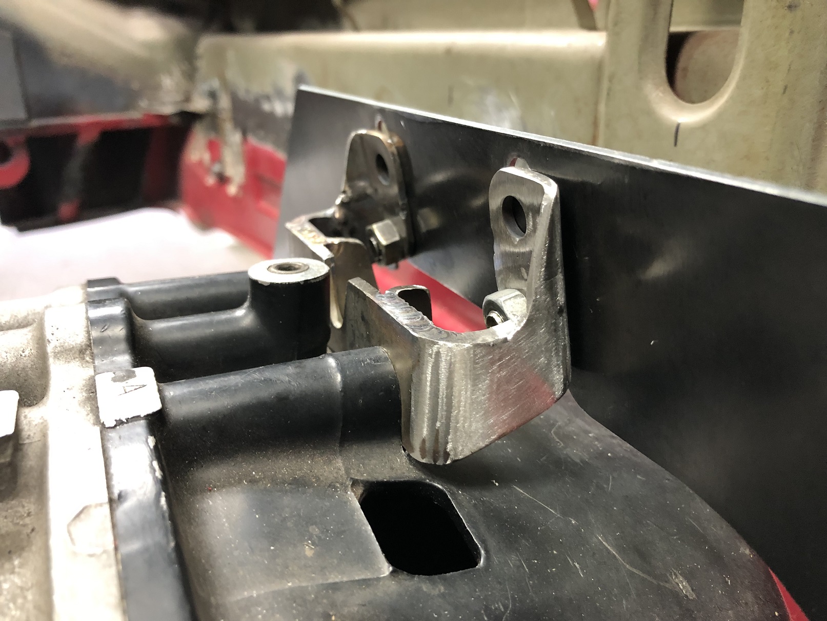

The factory Ferrari muffler mount (upside down pic, sorry. It's all I could find) versus one that's been subjected to some At The Red Barn mods. (IMG:style_emoticons/default/happy11.gif)
My version is lighter and prettier. (IMG:style_emoticons/default/aktion035.gif)
Yes, a little bit more tidying up to do but, as I regularly say: You get the idea.

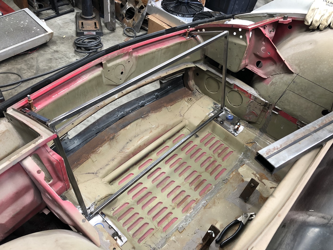

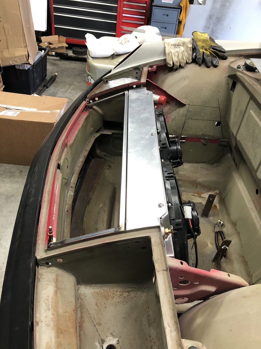

No rest for the weary injured! For those who may not want to watch the videos, here's the radiator mount, ready for final welding. I'm happy with how it's turning out.
tygaboy
post Jul 27 2024, 03:15 PM
Post #1135
Posts: 5,859
Joined: 6-October 15
From: Petaluma, CA
Member No.: 19,241

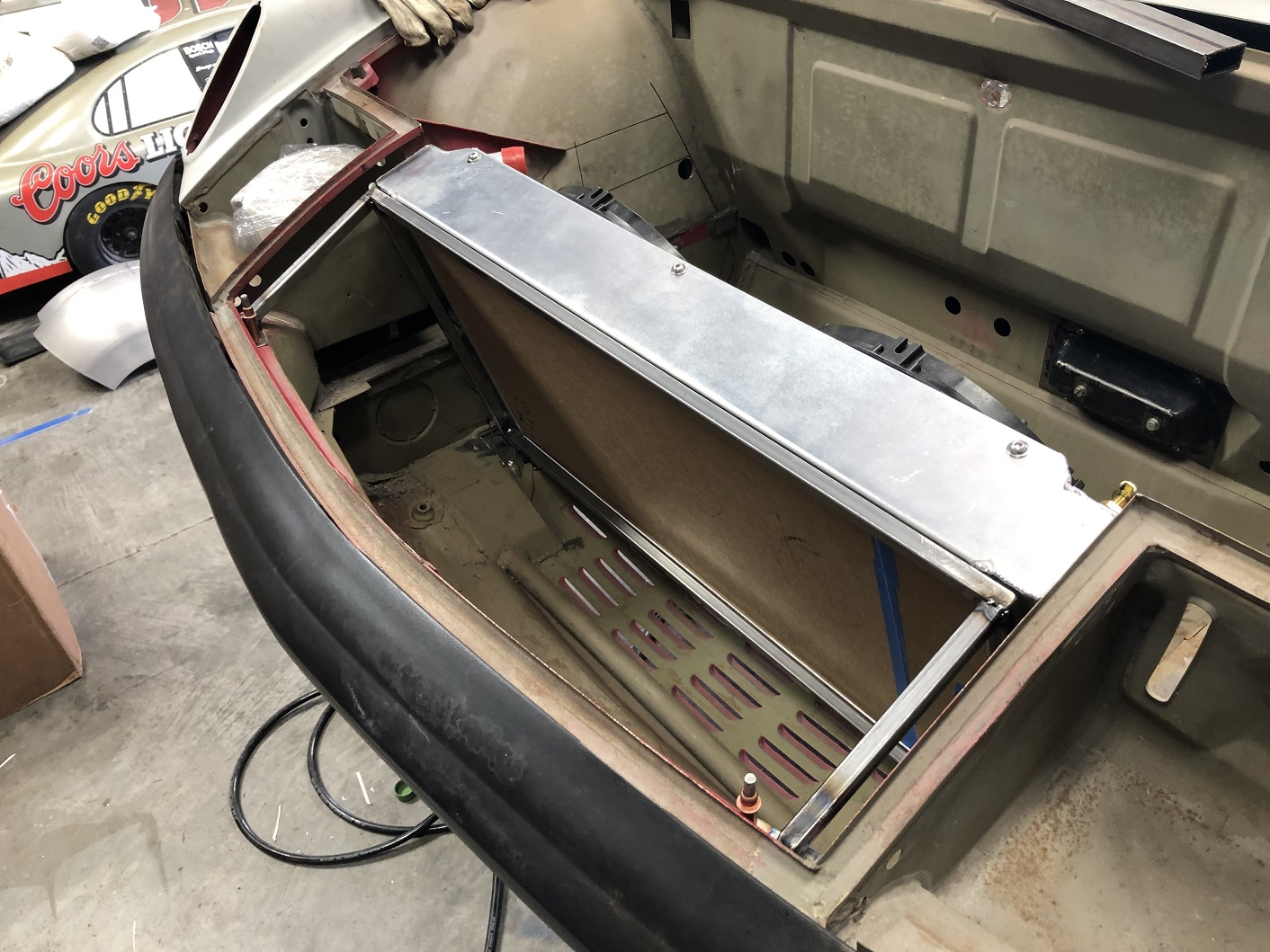

And a final test fit. Yes, it'll have a foam seal between the mount and the rad.

technicalninja
post Jul 27 2024, 05:20 PM
Post #1137
Posts: 2,531
Joined: 31-January 23
From: Granbury Texas
Member No.: 27,135
The kitties are completely trained.
One of the first steps is to use Humans as furniture!
Best place to be in on the shoulders.
Closest to the brain for the "Power of Purr" to work properly.
"Total and Complete World Domination" via subconscious manipulation.
That little red one has you and you know it... (IMG:style_emoticons/default/devil.gif)
Now, car stuff!
Plenty of room for a big condenser. (IMG:style_emoticons/default/ninja.gif)
It's properly ducted already...
