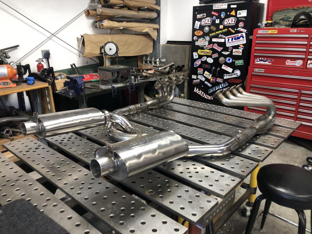

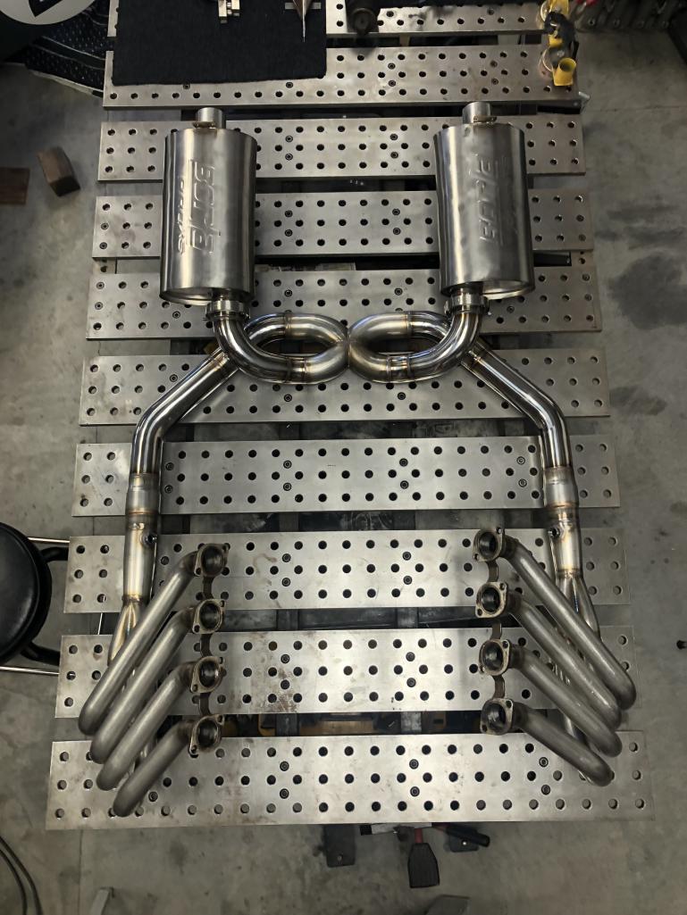

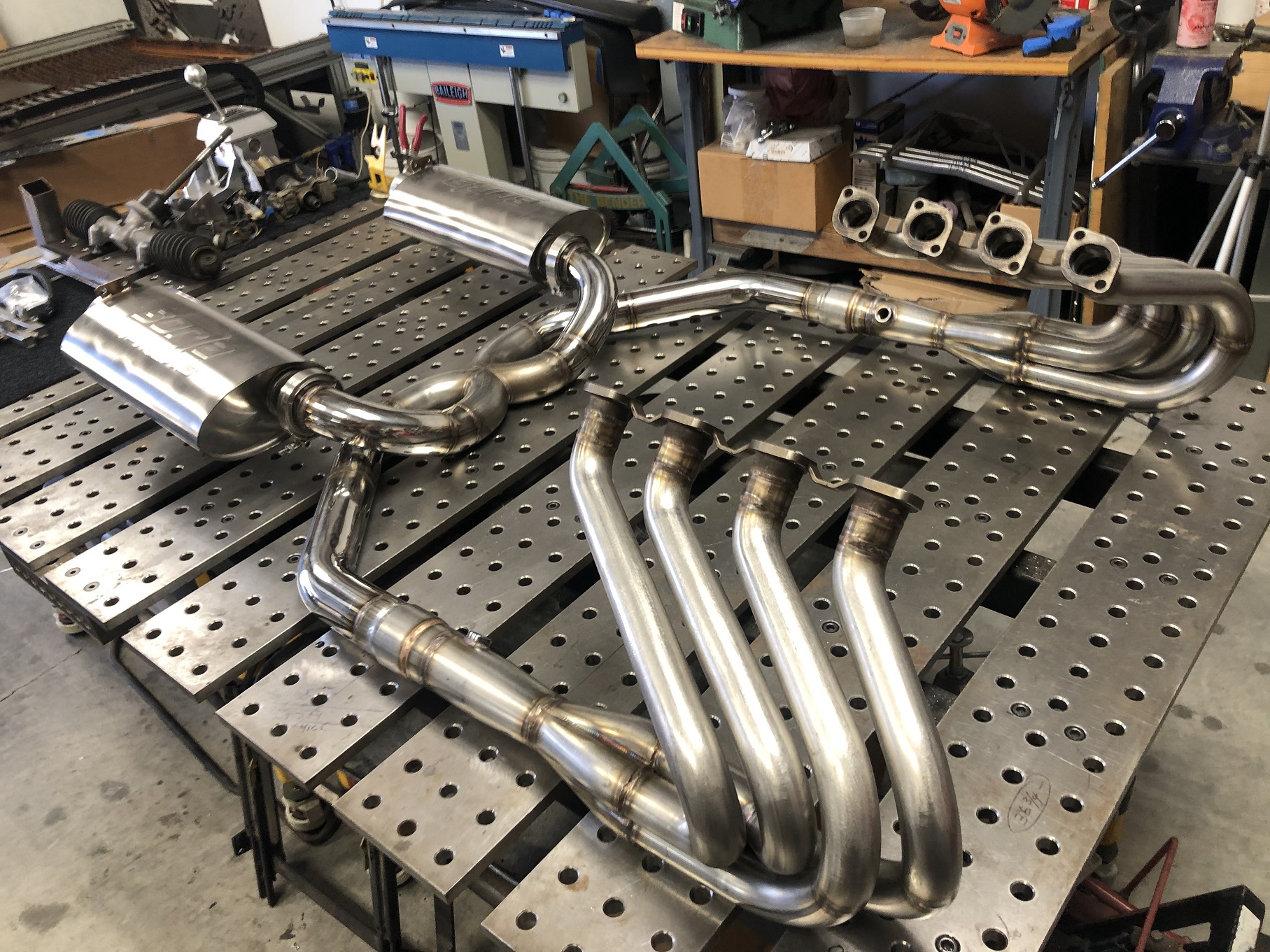

Getting ready to service the engine and I couldn't resist setting up the entire exhaust for some glamour shots. I couldn't be happier with how this turned out. I wish there was a way to see this whole thing when it's in the car.

Those look great! Nice work!

Send that beautiful exhaust to your local passivator for treatment

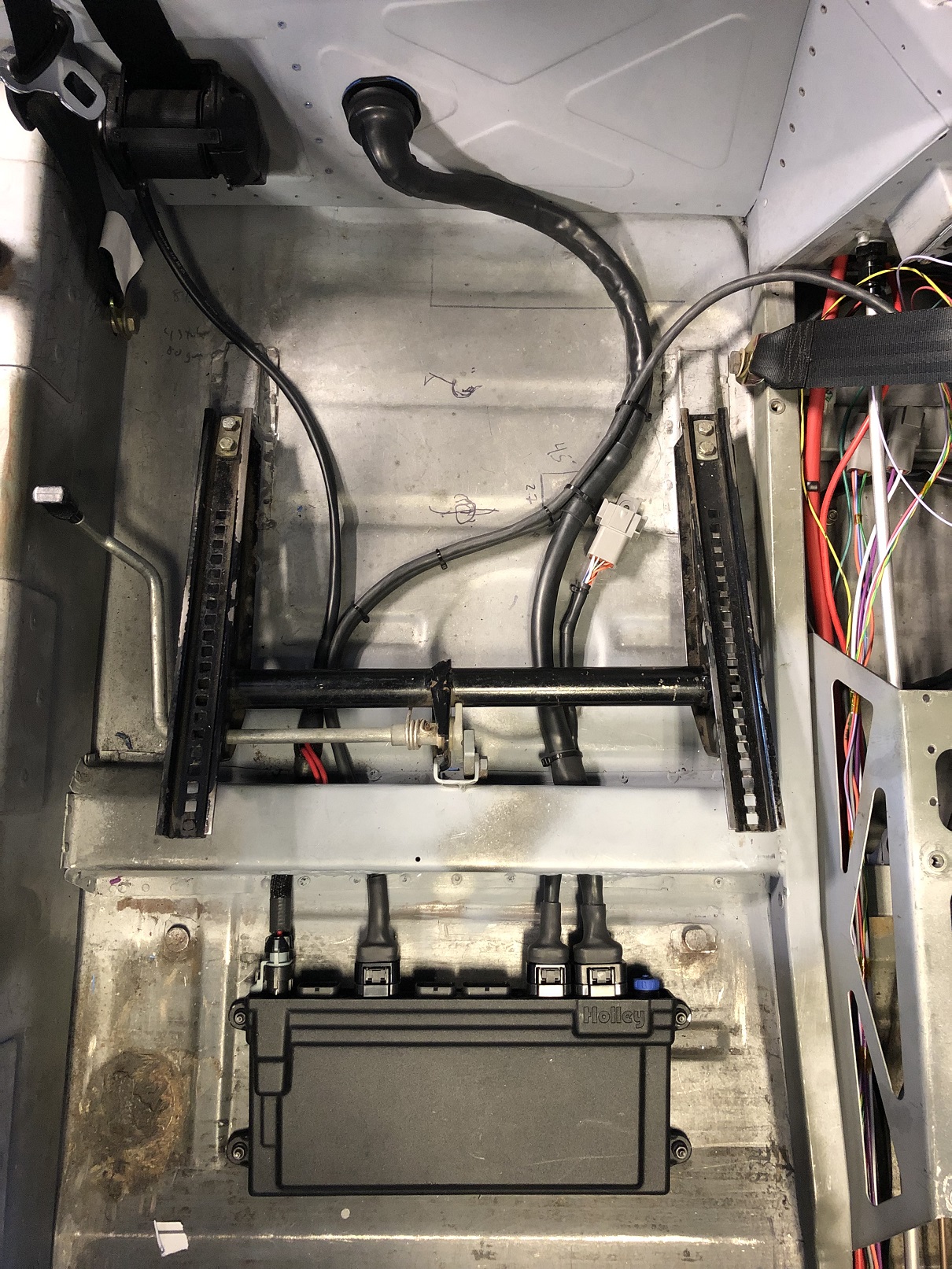

You are going to need a disconnect between the engine wiring and the chassis, unless you want to disconnect every connection on the engine before removing it for service.
I am using a 47 pin connector from Maven Performance. It is really nice and makes for a tidy way to disconnect the engine wiring.

@ClayPerrine Hi Clay - Yep, I used the same sort of approach on my LS build. This time, I'll probably go with multiple connectors. The ECU I'm running has built in power management capabilities so I need to pass a couple 20 amp circuits through one of the connectors.

QUOTE(live free & drive @ Sep 13 2024, 09:44 AM) *
Agree! Keep it looking that great forever. Passivation is usually pretty inexpensive. The best shops do food processing or aerospace work.
