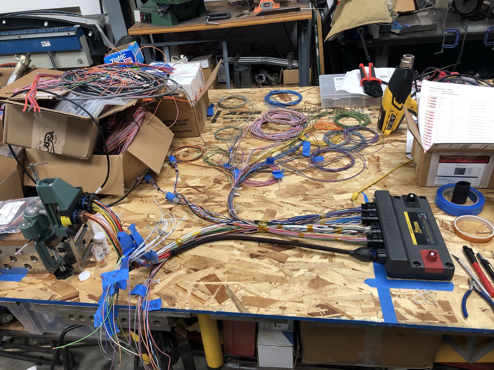

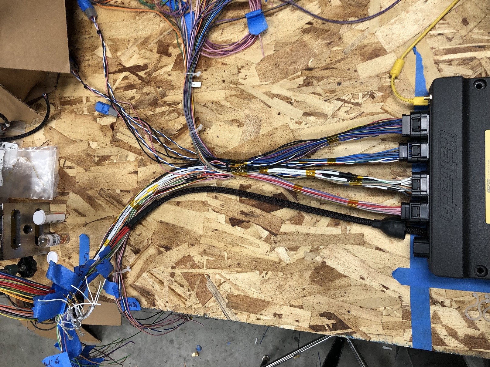

No video this week as the wiring work doesn't really lend itself to being watched. So it's pics of this part of the build. I'll do a video "wrap up" once the work is something a bit less tedious and repetative.
Anyway, here's the "VCU" (Vehicle Control Unit = ECU + PDM) and main harness:
- the connectors section takes care of the engine and rear body electrics: lights, etc.
- there's a CAN section with three connections that'll live in the cabin (there will be a CAN connection in the engine compartment, just in case)
- the remainder of the harness supports all the switches and power for interior stuff - ignition, lights, wipers, signals, gauges, seat heat, power windows, and... wait for it... Cruise Control!
Yep, this ECU supports real deal cruise. I'm also future-proofing the harness by building in circuits for things I may add going forward, including a Sport Exhaust mode. I can have the ECU control it as well as have an override button.
The Haltech stuff is crazy capable.

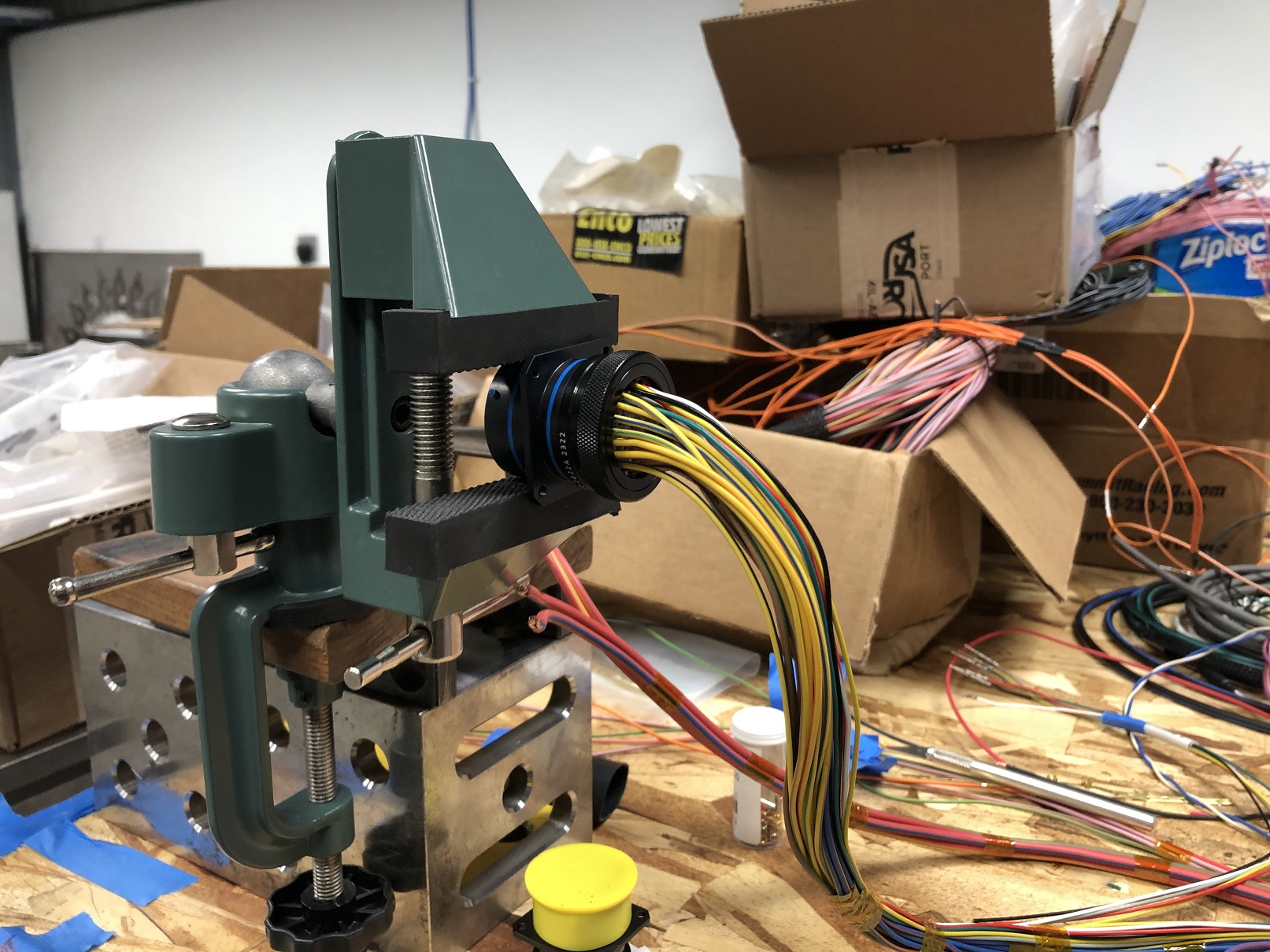

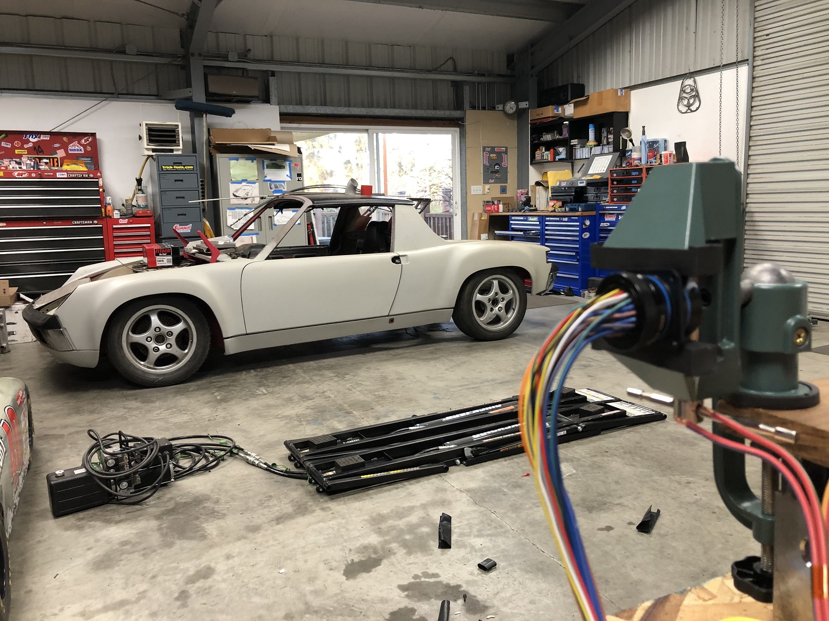

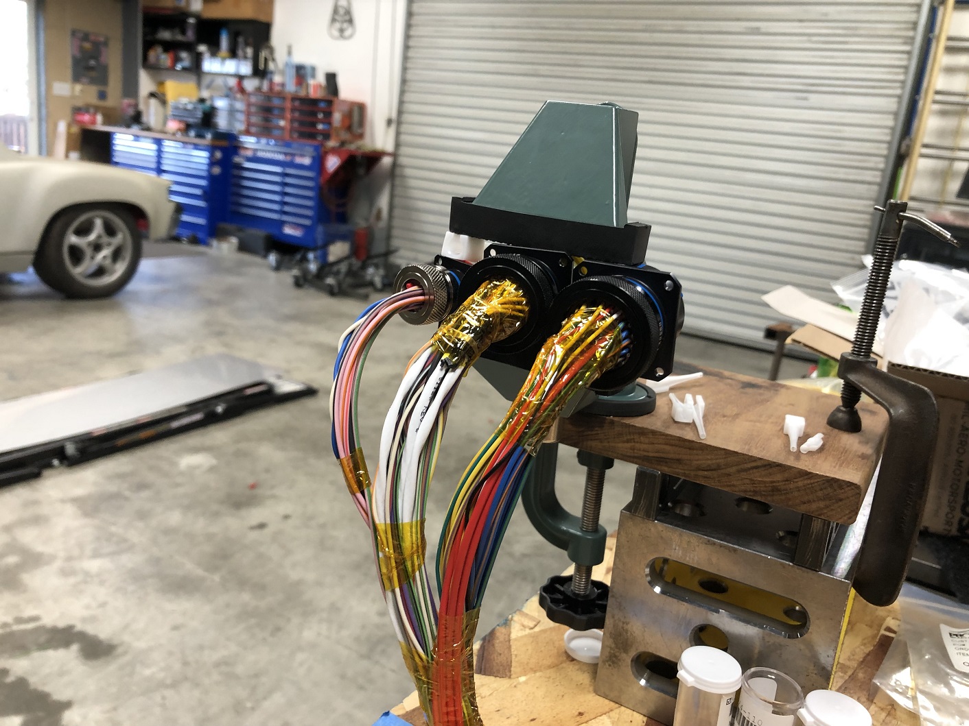

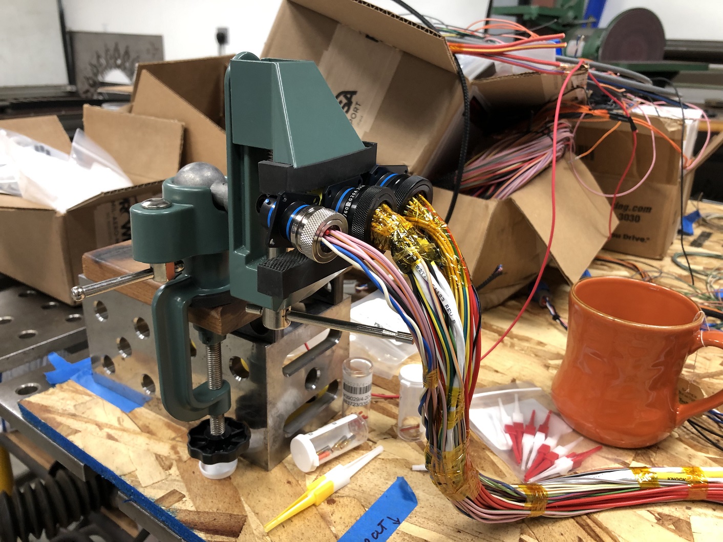

Interior side bulk head connectors completed. This takes care of the ECU connections to everything at the rear: all drive train functions, including a Hall-effect vehicle speed sendor and an engine compartment CAN connection, as well as all rear lighting. I'll sheath it once everthing is tested and working.
On to the engine harness.

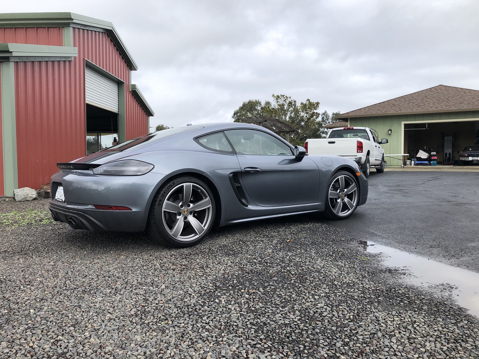

There have been a few distractions around The Red Barn that kept me from the build: this Cayman GTS 4.0 followed me home and my wife said we could keep it!
OK, OK so we ordered it a while back and picked it up on 12/27.
And I can now safely state that all the review videos on these things are true. It is wonderful - and I can't rev it over 4k rpm yet!
