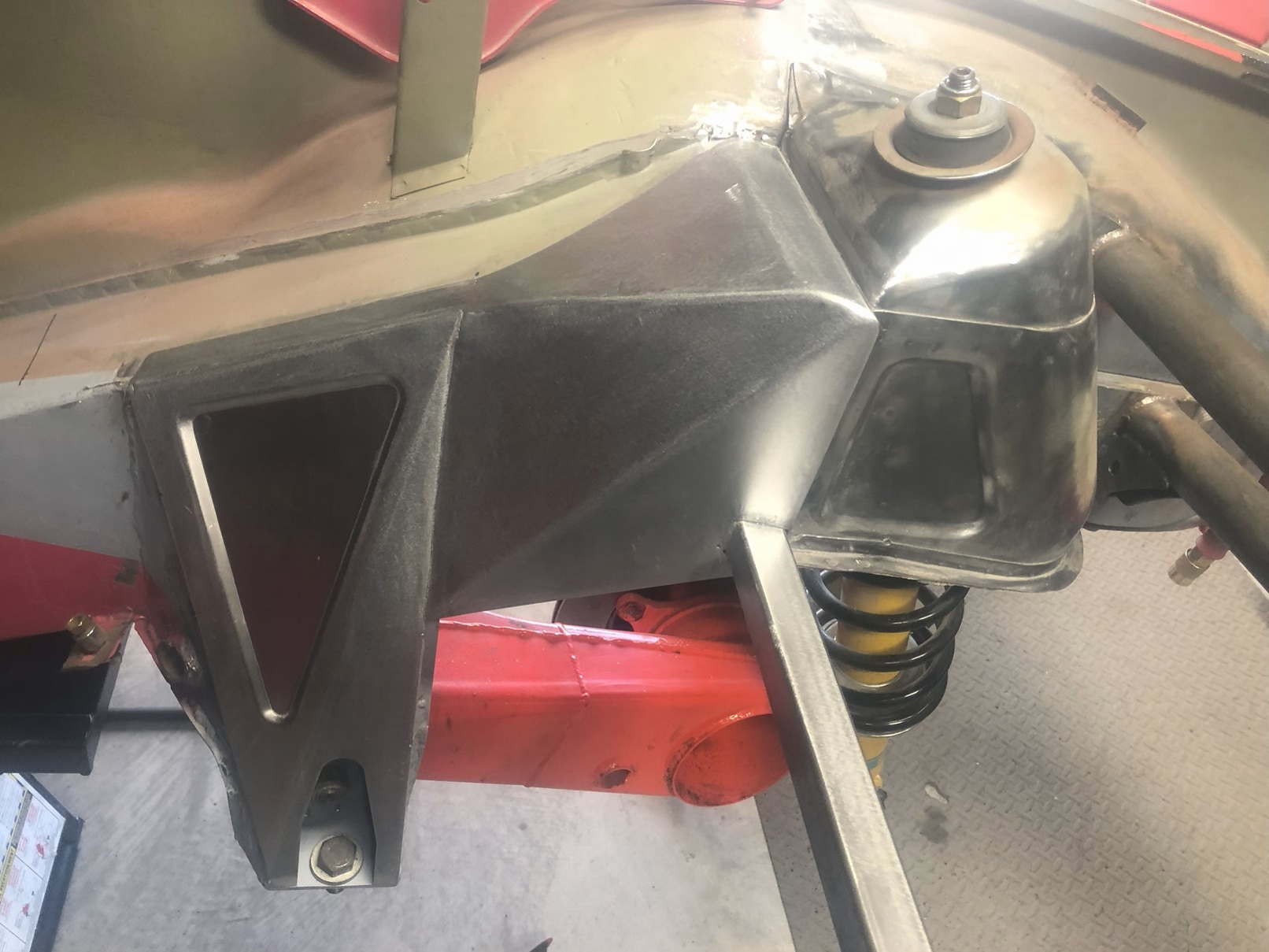

And here's a preview of what's coming in next week's episode. The upper section of the reinforcement is final welded, metal finished and ready for primer.

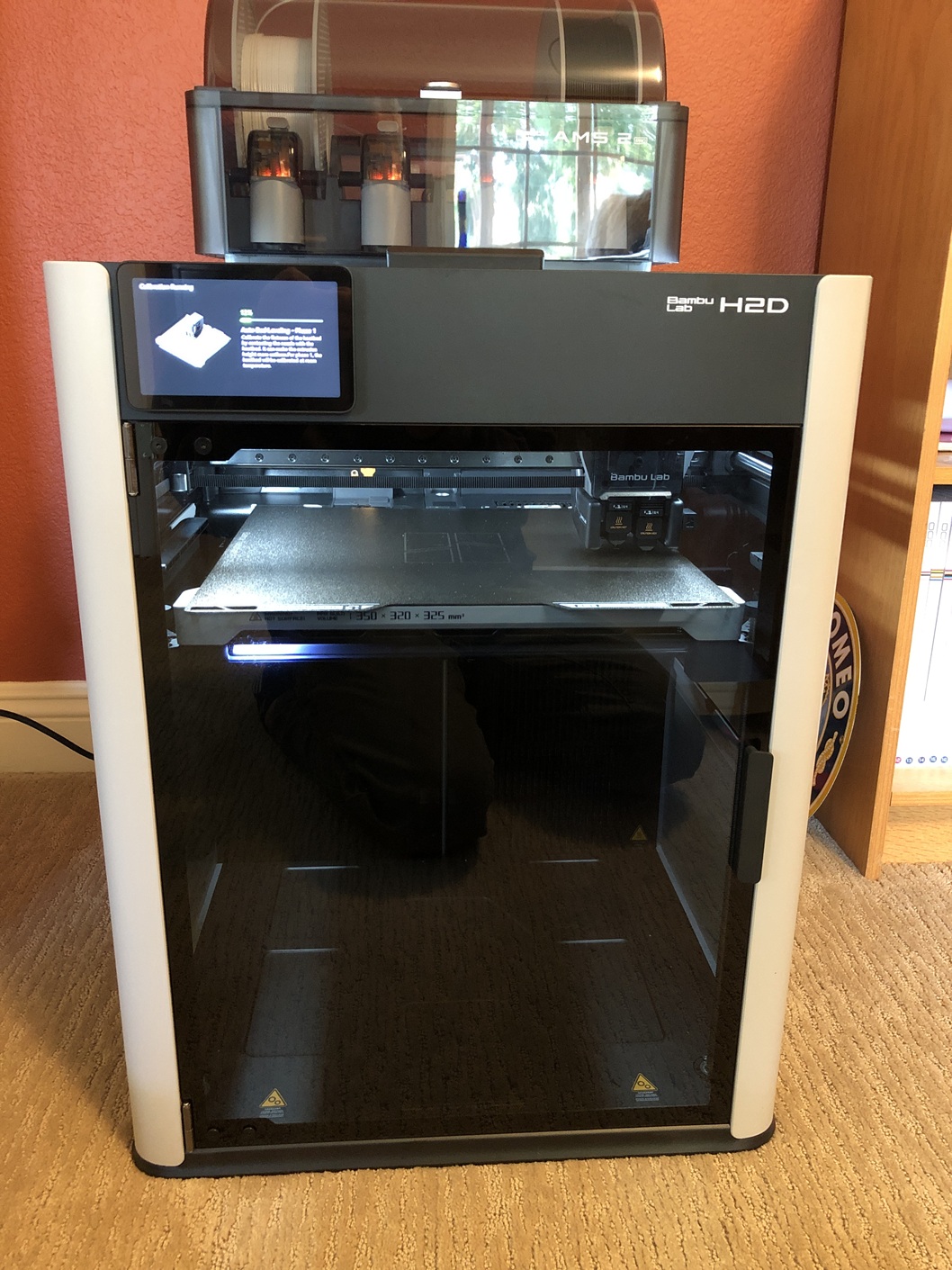

Tool Whore update:
With the plasma table gone, it was time to implement my plan for upping my fabrication game. I started by adding a Bambu Labs 3D printer to the mix. It arrived yesterday and took maybe 1.5 hours to get set up. As soon as it let me know it was ready, I sent the first job to it.
All I can say is: If you don't have one, you need one!
Virtually every review talks about how Bambu Labs' products just plain work and really are "ready to go" right out of the box. I can report that it's true! I sent my first job to it and it did a flawless job of printing it.
Next to arrive is a Creality Raptor Pro 3d scanner. Between these two new tools, some super cool things will be showing up soon!
