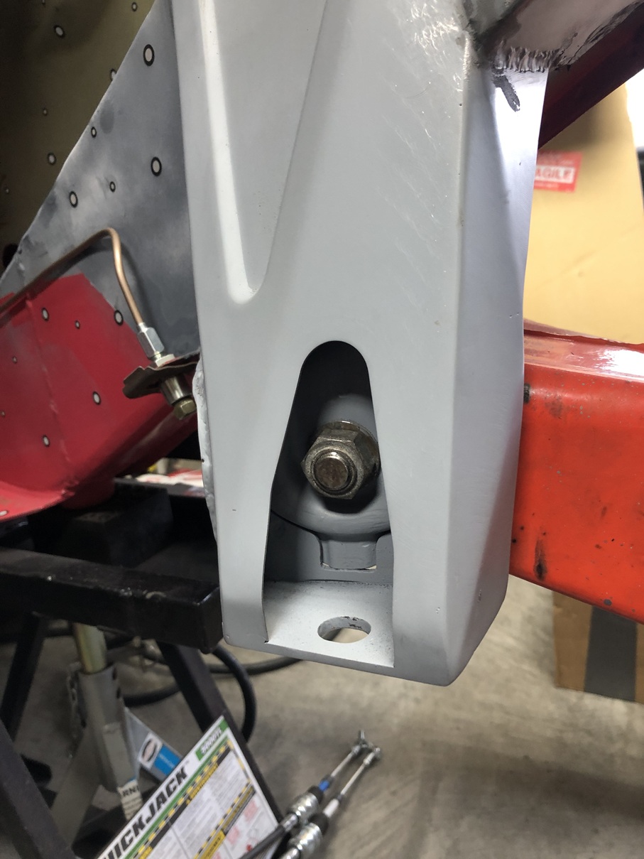

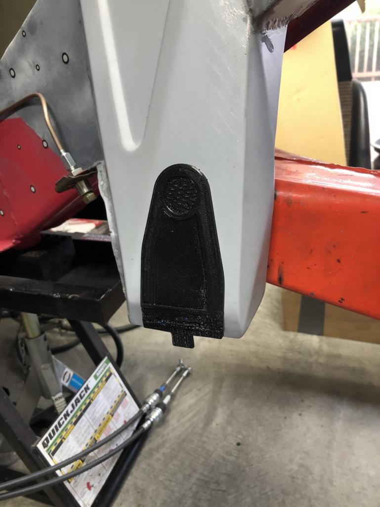

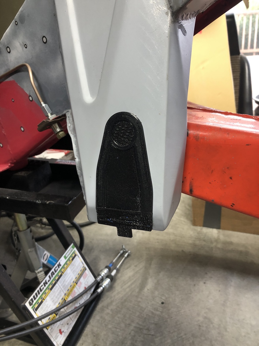

For those worried about junk finding its way inside the suspension ear reinforcement, have no fear: I 3D printed a snap-in cover!
Obviously, I still have a lot to learn about 3D printing materials and settings. This is my first go with TPU (a soft-ish rubber-like material) and the errors you can see are adhesion issues I had issues with the support material that's needed when printing overhangs of any significance. That lower section tips away at a 20 degree angle.
But even this version is 100% functional if not up to my target quality standard.
I'm sure I'll get there soon.

pics in support of the above post.

That came out very nice! Can you put your initials on that part?

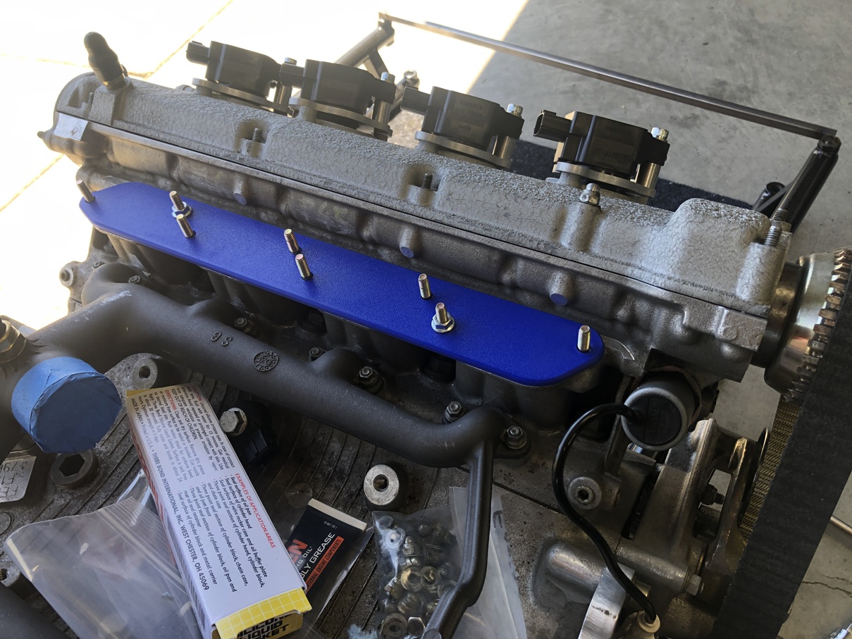

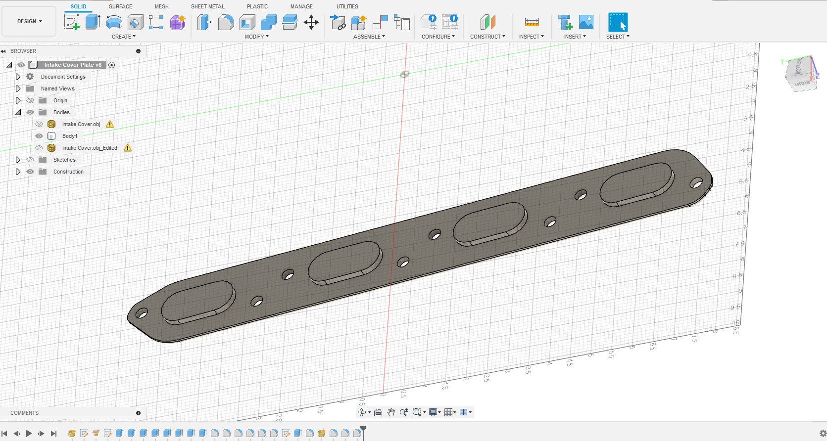

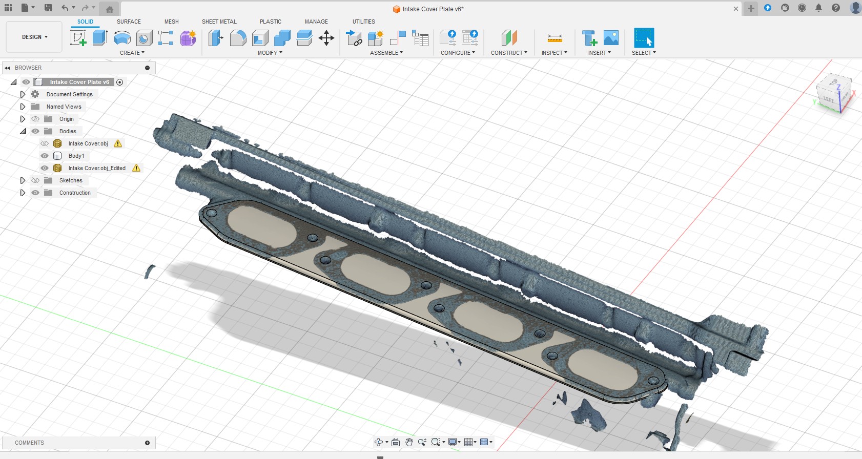

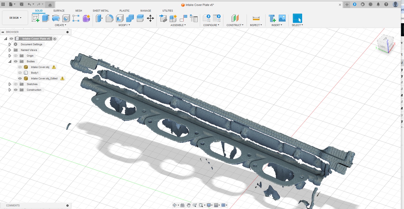

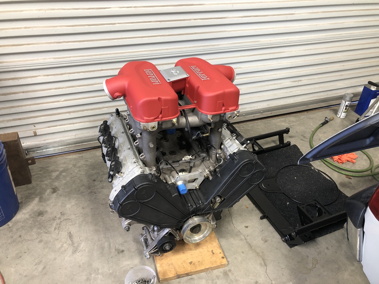

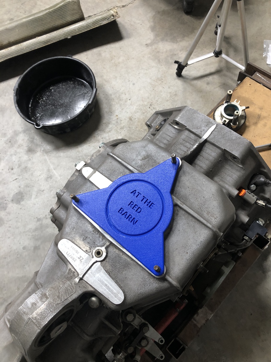

1. Scan the intake area
2. Use the scan to reverse engineer the manifold surface and mounting hole locations
3. Model an intake block-off plate (with totally unnecessary extrusions that fit into the ports!)
4. 3D print and install
And no, none of this gets me any closer to making it run!
But it sure is cool tech and these are actually quite useful parts.

Figured I may as well do the same for the air/oil separator opening. Branded, too! (IMG:style_emoticons/default/happy11.gif)

@tygaboy - Oh, I need something for my car branded from The Red Barn!!! Love that. (IMG:style_emoticons/default/beerchug.gif)
@Cairo94507 - Michael - I keep forgetting to give you an "At The Red Barn" t-shirt. NExt time, for sure!

Only a few things left to do before I try and start this thing. If only I weren't distracted by the scanner and printer!

The plenum has been refinished and it may look good in this pic but the powder coat is a "No-Go", quality-wise. If you want more detail, watch the next episode. I'm very disappointed...
