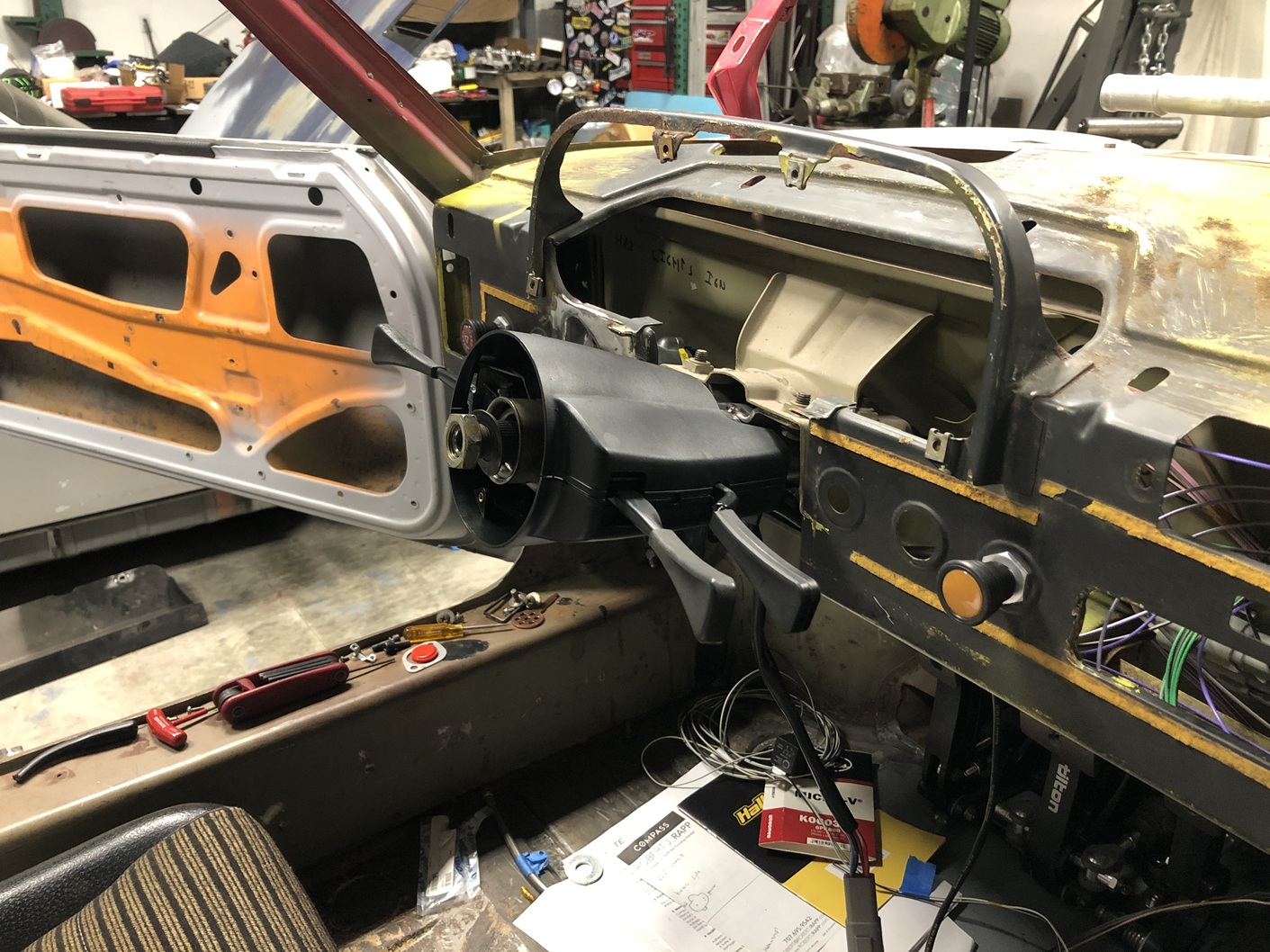

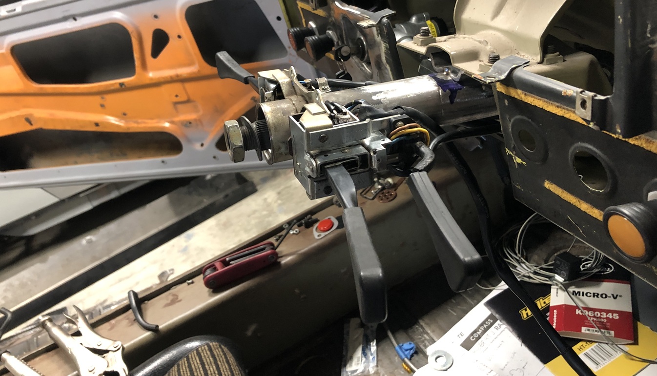

Another one for the "because I can" column. With a bit of tweaking (and a bit left to go), we have cruise control controls! This is a lightly modified 911 SC cruise control switch that bolts to existing mounting points on the wiper switch.
I chopped off the end of the stalk and clearanced a space in the column cover.
Summit Racing and URO to the rescue with that matching lever end!
I'm still playing with the up/down ergonomics. But if you ask me, once I tidy up where the lever end meets the stalk, it'll almost pass for factory.
As with a lot of what I spend my time on: will this help get the car running? No.
Am I doing it anyway? Yes. Yes, I am. (IMG:style_emoticons/default/laugh.gif)

QUOTE(tygaboy @ Dec 31 2025, 02:37 PM) *
The 911 steering column fits the car better than my Subaru column fits...it's keeping the stalks that tempted me!
