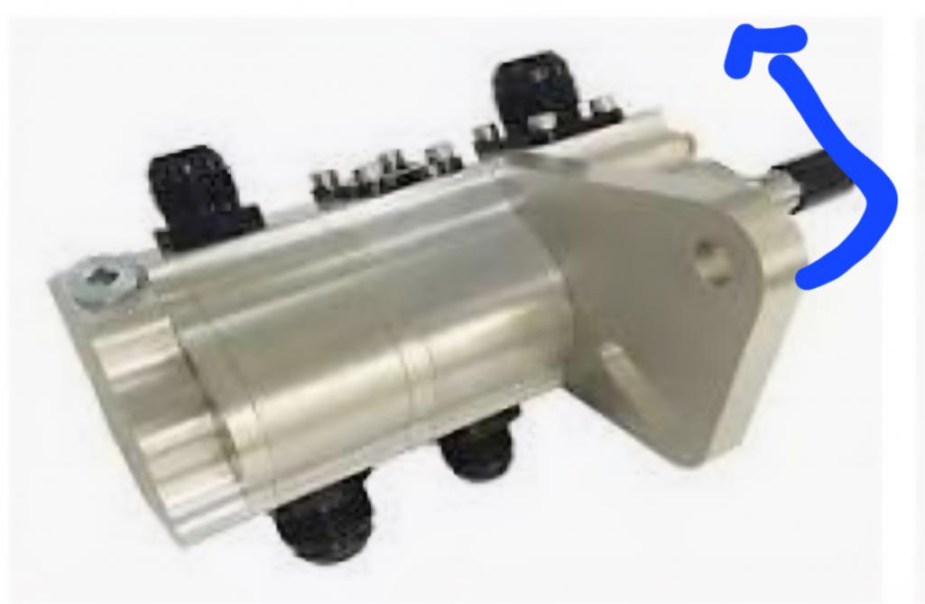

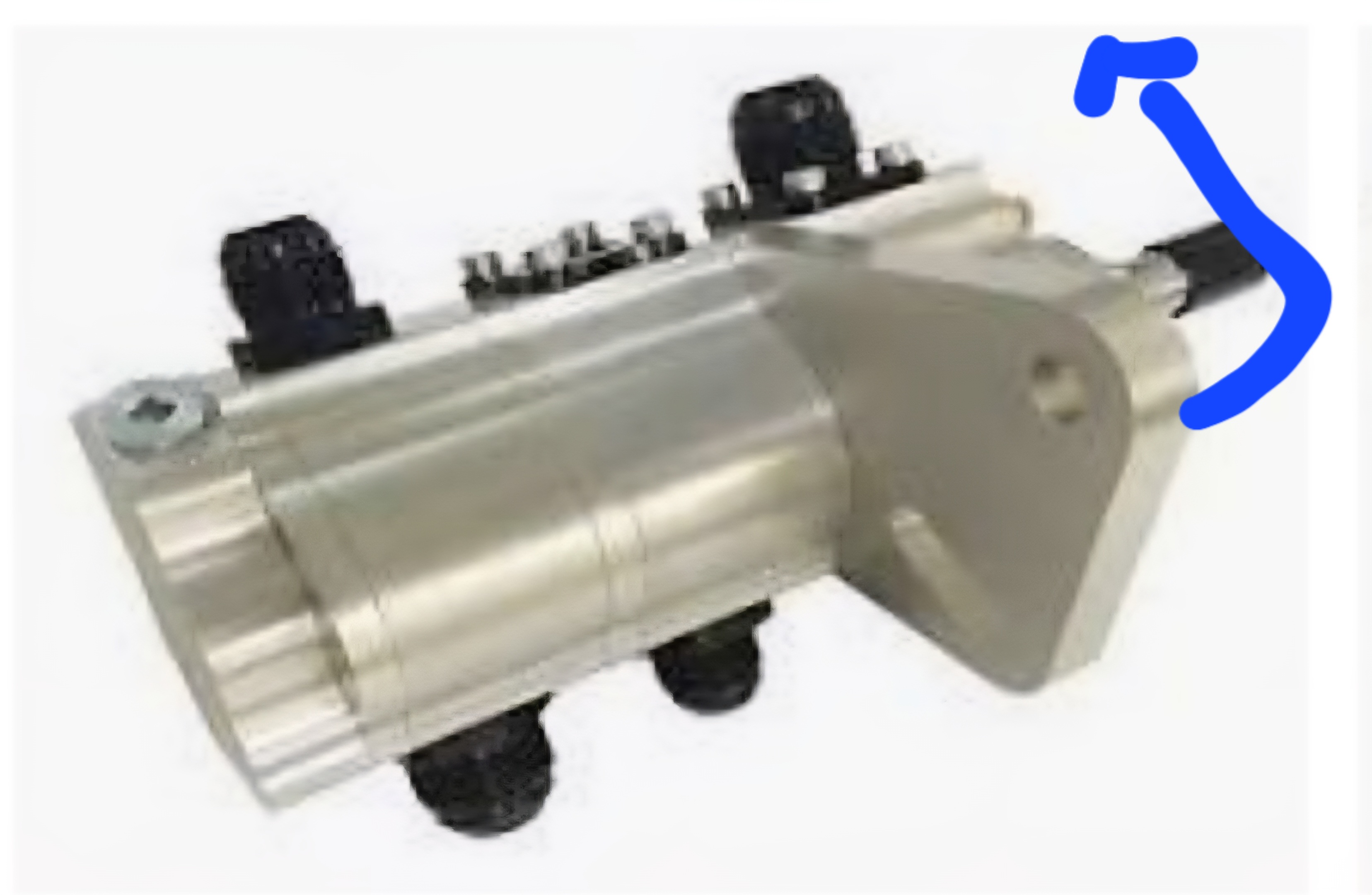

Chris , thank you for this tip on pre-oil; I just canceled the plan to pre-oil the Cayenne engine via spinning the dry sump pump via drill motor.
Since I have minimal space to do so in that area...I will do it your way> simple job with the right equipment ¡
Blue arrow indicates CW direction which I would need to spin pump, tight area near lower firewall and require (small) 90° offset drill motor.
(IMG:style_emoticons/default/marty914.jpg)

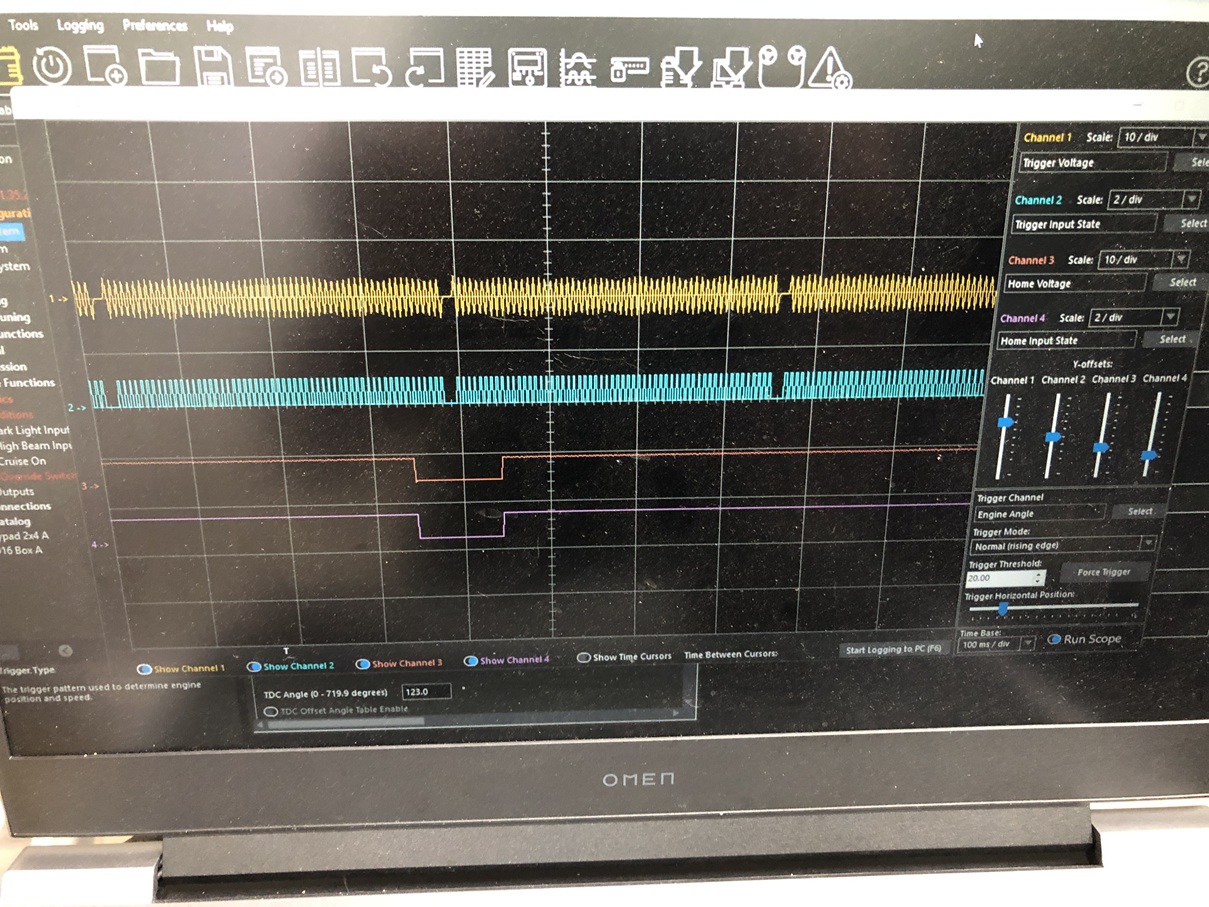

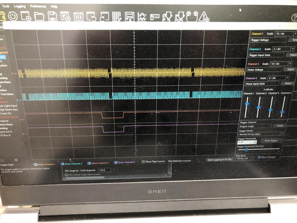

Spoiler alert for the next video: It's going to be a tech geek fest on the electronics package. At this point, the engine is still out of the car and I'm not trying to start it. All I'm trying to do is establish base timing information. This is a required step ahead of trying to fire the engine.
So, for the first time, I connected key elements of the engine harness to the engine (as well as battery power!) to the ECU. That alone took 2 years off my life.
Then it was the moment of truth: Say a prayer to the Gods Of Wiring and turn the key to "on"... (IMG:style_emoticons/default/wacko.gif)
SUCCESS! NO SMOKE ESCAPED! Then, the big nerve wracking step: Crank the engine!
What your seeing here is the result after a bit of "well, that ain't right" and a re-pinning of a sensor:
Here's a snapshot of the Haltech's oscilloscope showing strong traces.
- the upper two (yellow and blue) are from the crank position sensor. It's a reluctor sensor over a 60 minus 2 trigger wheel. The gap in there are the two missing teeth.
- the lower two (orange and pink) are the cam position sensor. It's a hall effect sensor over a single tooth on the cam, hence the one event displayed on the scope.
But what's most important is the Ferrari's trigger system is communicating perfectly with the Haltech R5!
This is a major milestone for the build as we've established the key values needed to attempt the first start.
Getting there! Slowly, I know. But getting there.

Chris - I count 58 pulses from each; that I assume is a problem?
FWIW I have spent many 10's of hours over my so-called career staring at scopes and logic analyzer displays..... let me know if I can help.
- Tony
tygaboy
post Jul 3 2026, 10:34 AM
Post #1557
Posts: 5,859
Joined: 6-October 15
From: Petaluma, CA
Member No.: 19,241
QUOTE(Retroracer @ Jul 3 2026, 08:20 AM) *
- Tony
@retroracer Tony, the crank trigger wheel is 60 minus two so 58 is correct.
And thanks for your earlier text asking about all this. It made me go back and actually understand what the scope traces were displaying.
This is all new to me and I was misreading the traces (big surprise!) I've updated my earlier post to correct the explanation.
