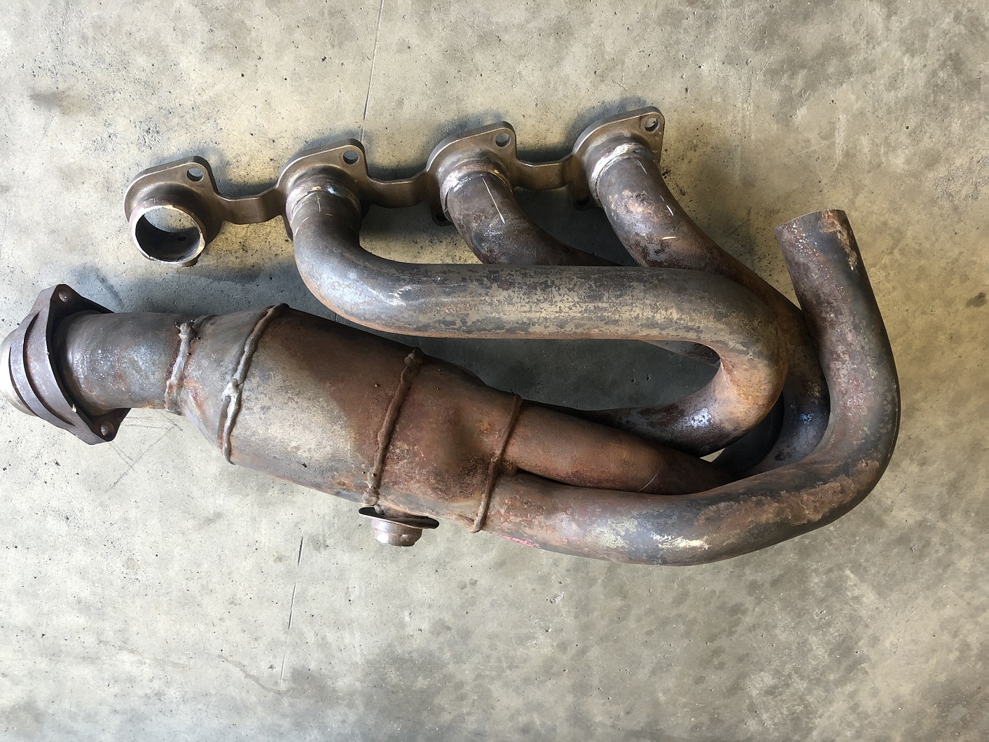

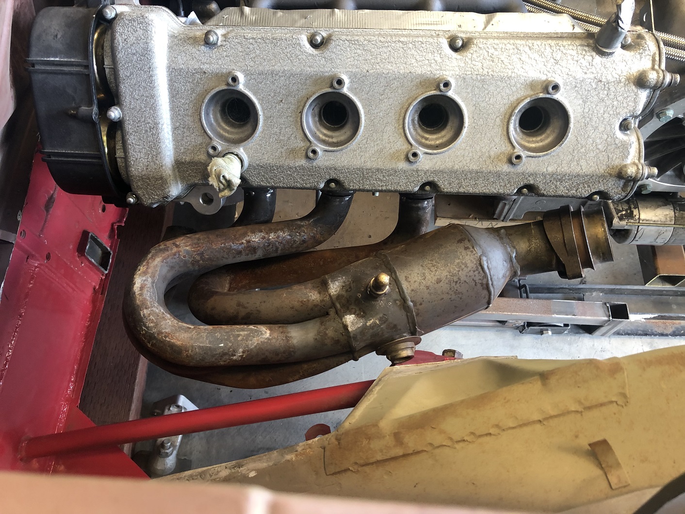

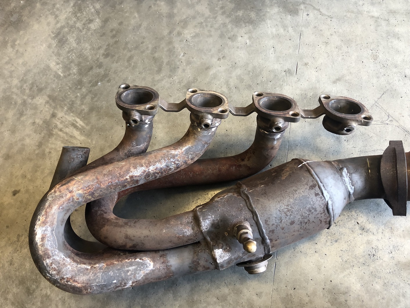

Many interesting guesses and suggestions but here's Martin's comment:
"Well, if all you need to do is move everything forward, why not just cut off the flange, move each tube forward by one cylinder and remake the one tube?"
Other than his use of the word "just", he nailed it!
Note, this is just tack/hack welded as proof of concept. But the interesting thing is that, you can see the there's plenty of room to get that front cylinder tube back to the collector while keeping appropriate length.
With this no longer an unknown, I can purchase a set of aftermarket headers knowing I can make them work. (IMG:style_emoticons/default/cheer.gif)

Like it was made for it! (IMG:style_emoticons/default/laugh.gif)
And that O2 bung was never going to work so don't worry about that.

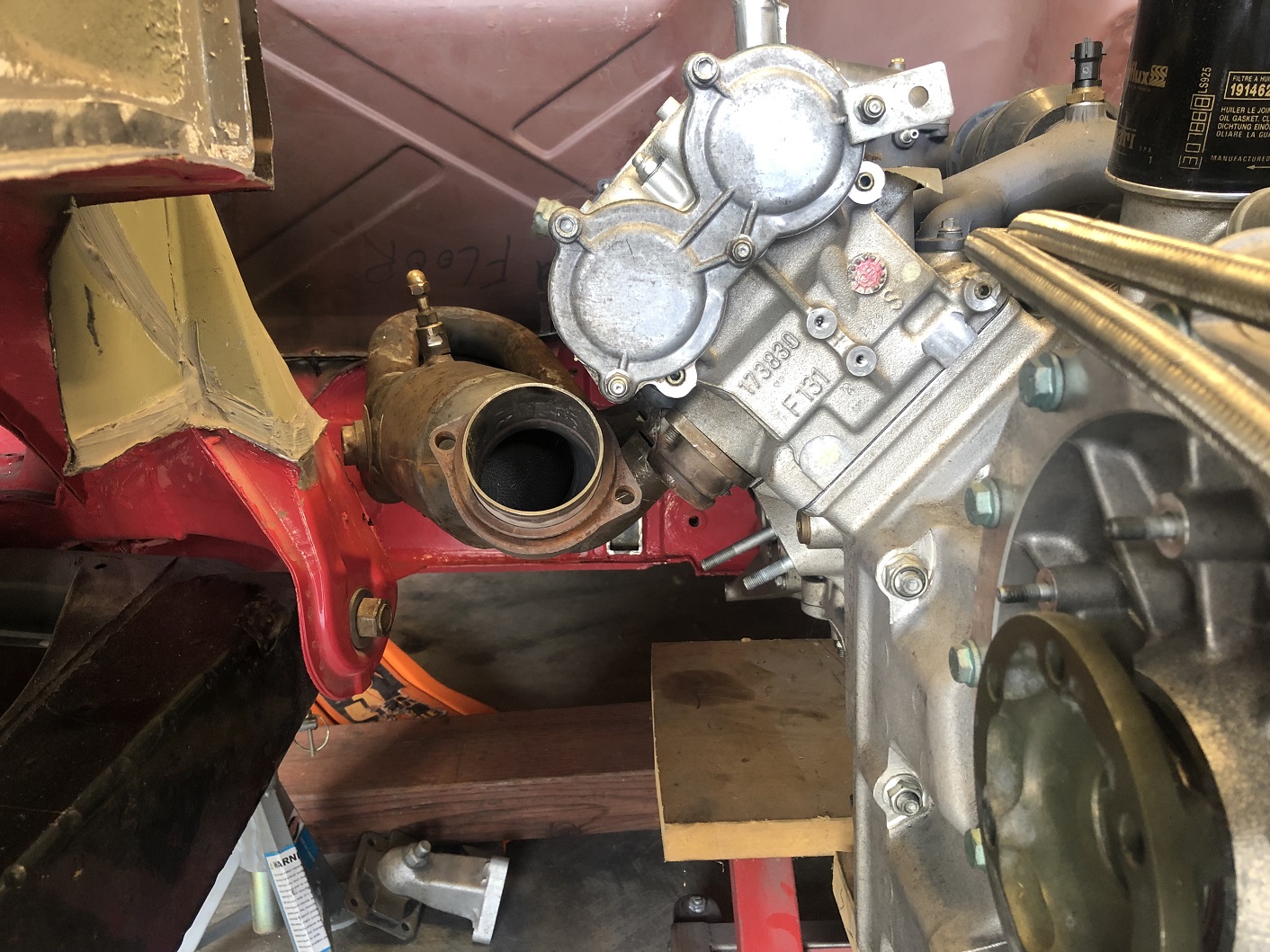

The build may be seeing a major change. I'm looking into what it'll take to work up an adapter to get the Ferrari engine mated to a Boxster S trans. I got a great deal on a G86-20 and in putting together a pro/con list, the Boxster trans comes out ahead by a fair bit.
Things like off the shelf axles, no need for limiting straps, far lower costs, shifters that are actually available (!)...
It won't be a simple adapter in that, the Ferrari trans houses the dry sump tank and the low pressure oil return is in the lower right side of the engine block. That's it, circled in the pic below. This means the adapter has to have account for that passage and accommodate an oil line fitting that pokes out the side.
Oh, and like @clayperrine Clay, I have to make room for a starter on the trans side of things.
So, this will delay things a bit and I may end up going back to the Ferrari trans. Just need to see what's what before committing to the chassis fab.
Another example of "if were easy, everyone would be doing it."

QUOTE(tygaboy @ Sep 13 2022, 03:51 PM) *
You asked for it (IMG:style_emoticons/default/biggrin.gif)
(IMG:http://www.914world.com/bbs2/uploads_offsite/i.pinimg.com-431-1663118866.1.gif)
I looked it up real quick... no difference in function between the 360 and Box shifter so no reason you couldn't use it. You will likely have to make cables the right length anyways. Since you have both trannys you can easily measure the lever throw.
I also don't fathom how an adapter/flywheel/starter cutout/oil tank could be less work than Sway-a-way making axles (IMG:style_emoticons/default/confused24.gif)
You might find 911/Bus/944/Box/996 axles fit just right since the Ferrari looks wider.
Have you measured the actual CV angle with the trans in place? I don't think it will be that much to worry about. You will need 930 size CVs anyways for the power.

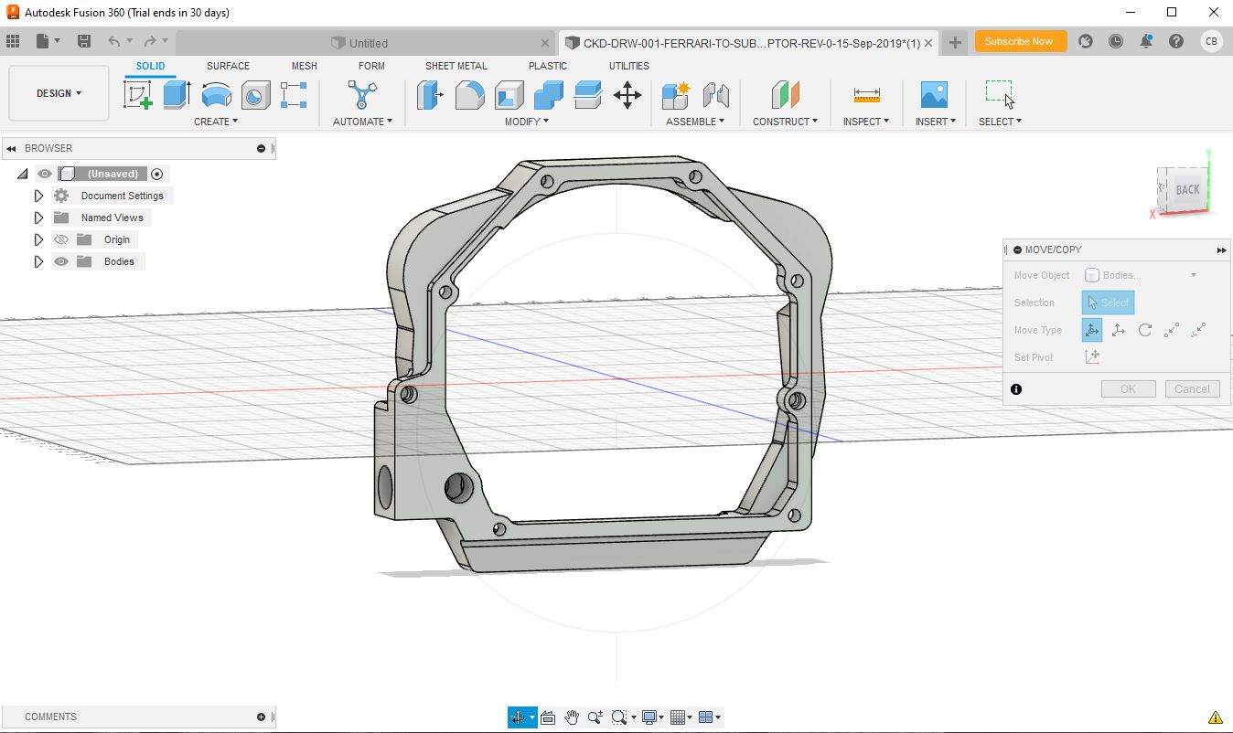

No screwing around here! Some of you may be aware of Home Built by Jeff's Alfarrari build on YouTube. He's putting a 360 engine in the front of a vintage Alfa. He got wind of my build and I've been communicating with him. He was kind enough to share his adapter file! This is the Ferrari side of things, including the oil return passage.
Ignore the other side as it's for a Subbie BRZ trans (!).
Anyway, this get's me a good way down the "what'll it take" road. And let me say it again:
I haven't decided which trans I'll use. But knowledge is power and I'll know more, regardless.
