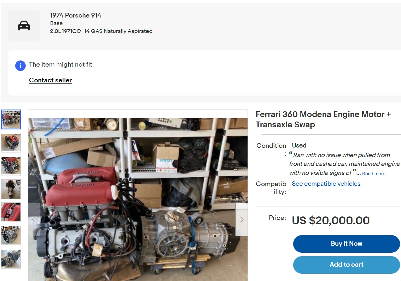

QUOTE(Steve @ Dec 20 2022, 08:35 AM) *
Sad... but that drive train is cheaper than a 993 3.6 motor and 915 trans.
(IMG:style_emoticons/default/blink.gif) (IMG:style_emoticons/default/wacko.gif) (IMG:style_emoticons/default/unsure.gif)

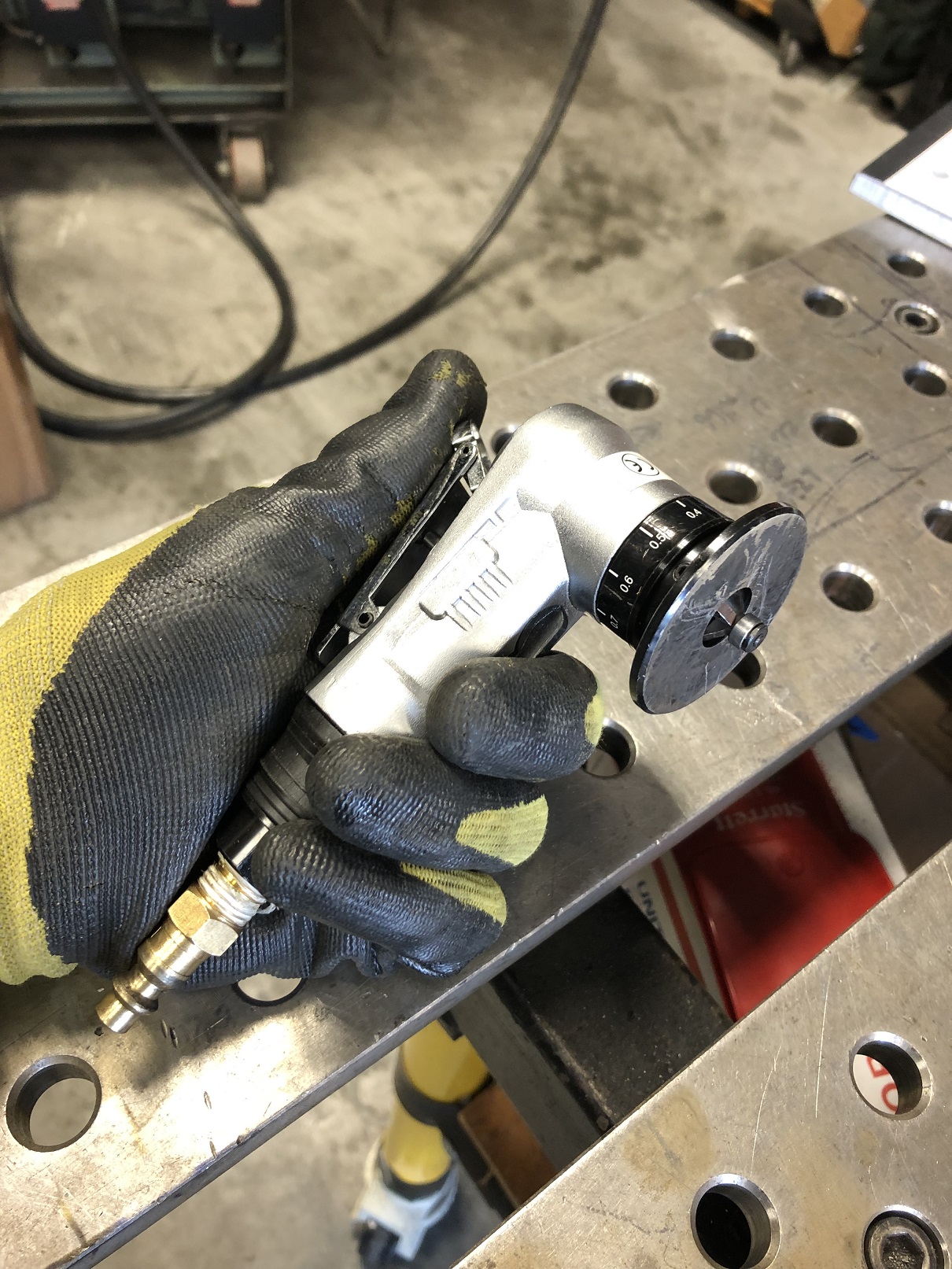

I might have missed a page or 2, did you cover the metal router at all? Love the way it looks after you run it on some of the parts.
QUOTE(Tferrer @ Dec 20 2022, 08:13 AM) *
Beautiful work. You better be careful, Chris- Before you know it you'll have a wait list for folks wanting one of your builds! (IMG:style_emoticons/default/chowtime.gif)
https://www.ebay.com/itm/354286038626?hash=...%3ABFBM-O6ThqZh
Well, sorta/maybe. Not to argue price points but it's important to consider that particular trans is missing it's near-unobtainium shifter mechanism. NLA and the one company that makes the parts charges ~$20k +. It's missing its ECUs, yes, two of them. About $2500 each. Engine harnesses, etc. etc. So plan to add a lot to that $20K asking price. You may have seen the new 360 crate engine that just sold for $30K on BAT.
Then there's the fact that a whole lot more people want a 3.6/915 than want a 360! It's all about the market...

QUOTE(SirAndy @ Dec 20 2022, 12:16 PM) *
"The item might not fit."
haha.
-Steve

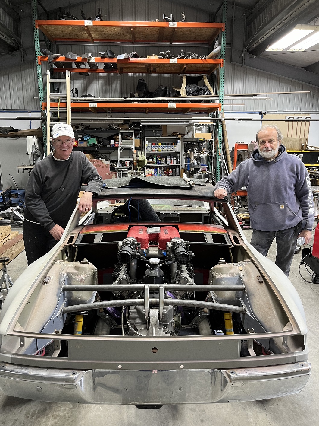

It's official: The drive train is mounted in the car! (IMG:style_emoticons/default/piratenanner.gif) (IMG:style_emoticons/default/aktion035.gif) (IMG:style_emoticons/default/smilie_pokal.gif)
Holy Jebus, that was a ton more complicated than I ever imagined. But we got it done! A major milestone, for sure.
Anyway, may I present what I believe is the world's only 360 914.

QUOTE(siverson @ Dec 20 2022, 02:05 PM) *
Clearly, the ebay algorithm isn't keeping up with 914world ...

QUOTE(NARP74 @ Dec 20 2022, 01:51 PM) *
@NARP74 - Here's a pic of the router. This is from when I used it on my LS car's trans mount. Available on Amazon for not much!
https://www.amazon.com/gp/product/B08SBRZCR...=UTF8&psc=1

ManuFromParis
post Dec 21 2022, 02:24 AM
Post #537
Posts: 21
Joined: 17-September 17
From: Paris
Member No.: 21,433
Region Association: France
Amazing job, I was wondering how you mounted the front brackets, now I know. Great job !
I am still concerned with the exhaust since both side supports looks pretty much in the way. It will be 100% custom I assume. Can't wait.

QUOTE(tygaboy @ Dec 20 2022, 04:53 PM) *
I love it, thanks for sharing.
tygaboy
post Dec 21 2022, 10:12 AM
Post #539
Posts: 5,859
Joined: 6-October 15
From: Petaluma, CA
Member No.: 19,241
@BuddyV Robert timed his visit perfectly! He stopped by yesterday in time to witness the moment the car was lowered to the ground for the very first time with its drive train mounted. And then he forced us to pose for a pic.
For those of you who've not had the pleasure of meeting him, that's Martin on the right.
And can I just say what a great "partner in crime" he is? Always willing to help but equally important, he spends LOTS of time thinking about what I'm trying to do and offers tons of input (and his wonderfully inspired sketches!). He brings decades of motorsport-related design and fabrication experience to everything he does.
We make a great team in that our skill sets nicely compliment each other - I'm into the CAD/plasma table/modern electronic stuff and he sketches, old school, makes ridiculously cool stuff on a manual lathe and mill and, of course, TIG welds like no other. Yes, I admit it: his TIG welding is my personal form of crack - I want to stop using but I just can't! (IMG:style_emoticons/default/biggrin.gif)
But what knowing Martin has REALLY taught me is patience and a "do it right" approach. All of my fabrication skills have greatly improved watching and/or working with him over the years.
I'm proud to call Martin a trusted friend and he's certainly a key contributor to the madness that's always happening at The Red Barn.
Thanks Martin. It simply wouldn't be the same without you! (IMG:style_emoticons/default/pray.gif)

Man, i hate my brain ...
Looks like the engine/trans is off to the left from the center line of the car.
I really hope that's just due to Roberts photography skills.
(IMG:style_emoticons/default/poke.gif)
PS: And while i'm at it, that engine lid cutout should really follow the contour of the upper intake and not just be square like that.
PPS: Ok, i stop now
(IMG:style_emoticons/default/biggrin.gif) (IMG:style_emoticons/default/beerchug.gif)
