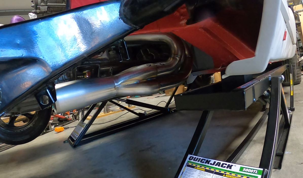

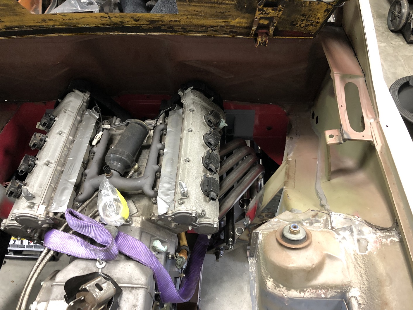

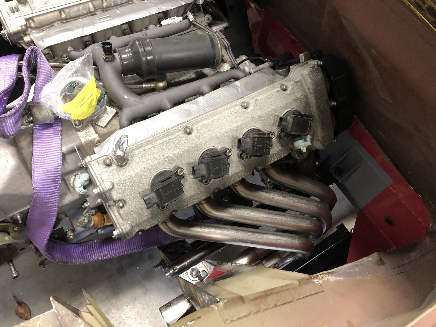

Figured it'd be prudent to test fit the first header. The good news is it fits as planned. The less than good news is that it's all but invisible way down there.

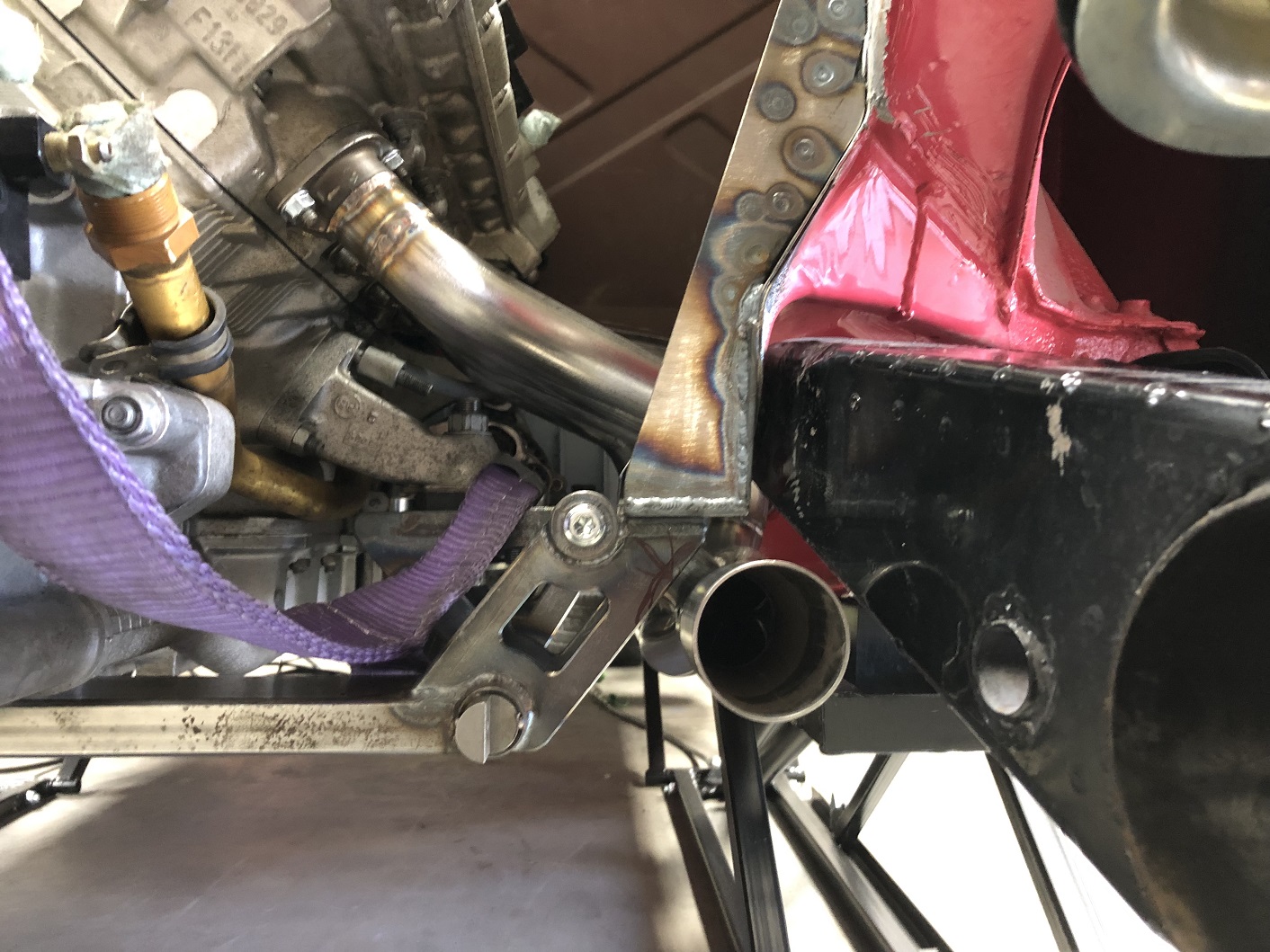

Clearance with the stock suspension at full droop. I'll be running shortened shocks to help limit axle angle so this area will have even more room.
O2 sensor will live just past the rear engine cradle mount.

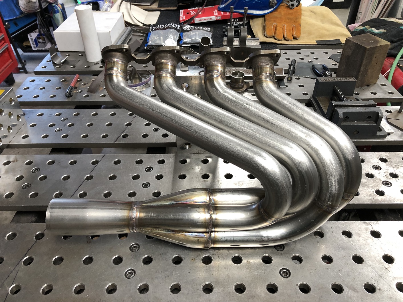

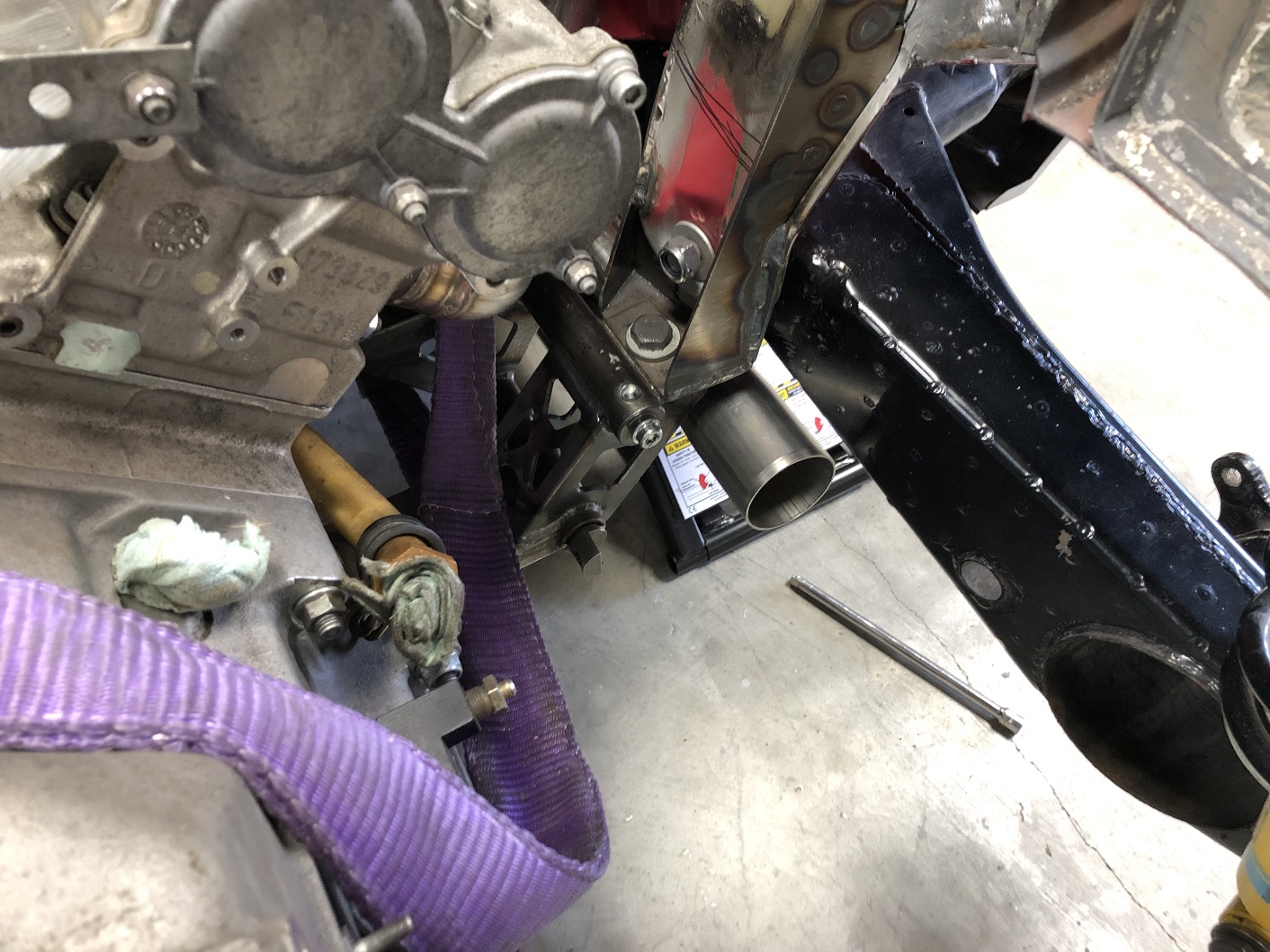

I worked up a fixture to locate the collector so I could tack it in place
tygaboy
post Mar 7 2023, 06:00 PM
Post #695
Posts: 5,859
Joined: 6-October 15
From: Petaluma, CA
Member No.: 19,241
Then everything was final welded. Still have the O2 bung to add, then it's work out the rest of the exhaust.

Is the support for the collector attached to the engine side of the motor mount
or to the chassis side ?
tygaboy
post Mar 8 2023, 10:16 AM
Post #698
Posts: 5,859
From: Petaluma, CA
Member No.: 19,241
QUOTE(rgalla9146 @ Mar 8 2023, 06:55 AM) *
Your work is incredible. Gigantic props. Form AND function.
@rgalla9146 That's not a support. It's a temporary fixture I made to hold the collector in position so I could tack it to the primaries. The engine and headers need to move independently from the engine cradle. I'll work out muffler hangers once I get to that point.
