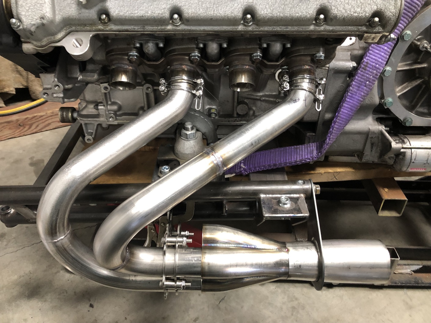

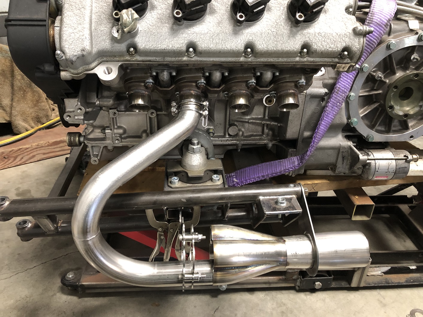

Here's the set up I'm using: air cooled #17 torch, gas lens with a #8 cup. And there's the first tube done - the upper weld filed and sanded, the lower weld wire brushed.

2nd tube fully welded, "main" weld still yet to be dressed. I'm happy with how all this is going.

So, first off, I’ve gathered from your videos that you’re excessively self critical… unfounded if you ask me.
Second, your welds are quality.
Third, that setup is not “basic”. That’s what I would use if I was cup walking an in-position large diameter stainless or inconel flange back in the day.
Fourth, either you buy the cup or I’m mailing you one… someone here will help me make that happen.
That is all. (IMG:style_emoticons/default/beerchug.gif)

2nd side header gets done! Well, almost. And yes, I'm battling a strong desire to start over, knowing I could do a much better job. But I'm not going to. At least not right now... (IMG:style_emoticons/default/happy11.gif)
If you do nothing else, watch from 13:40 - 13:50.
