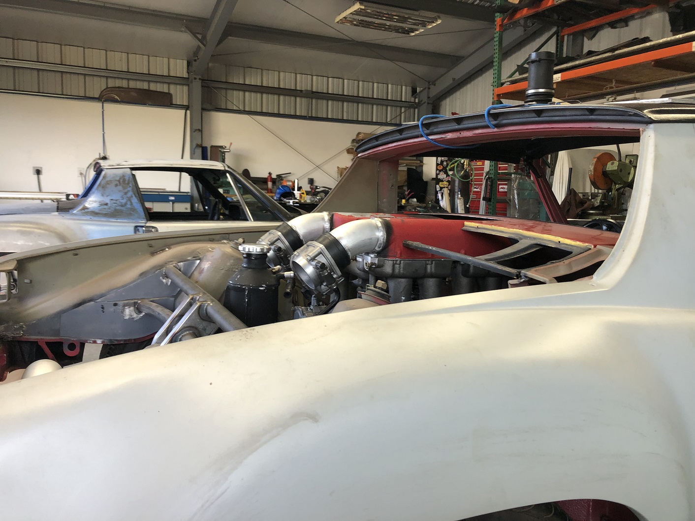

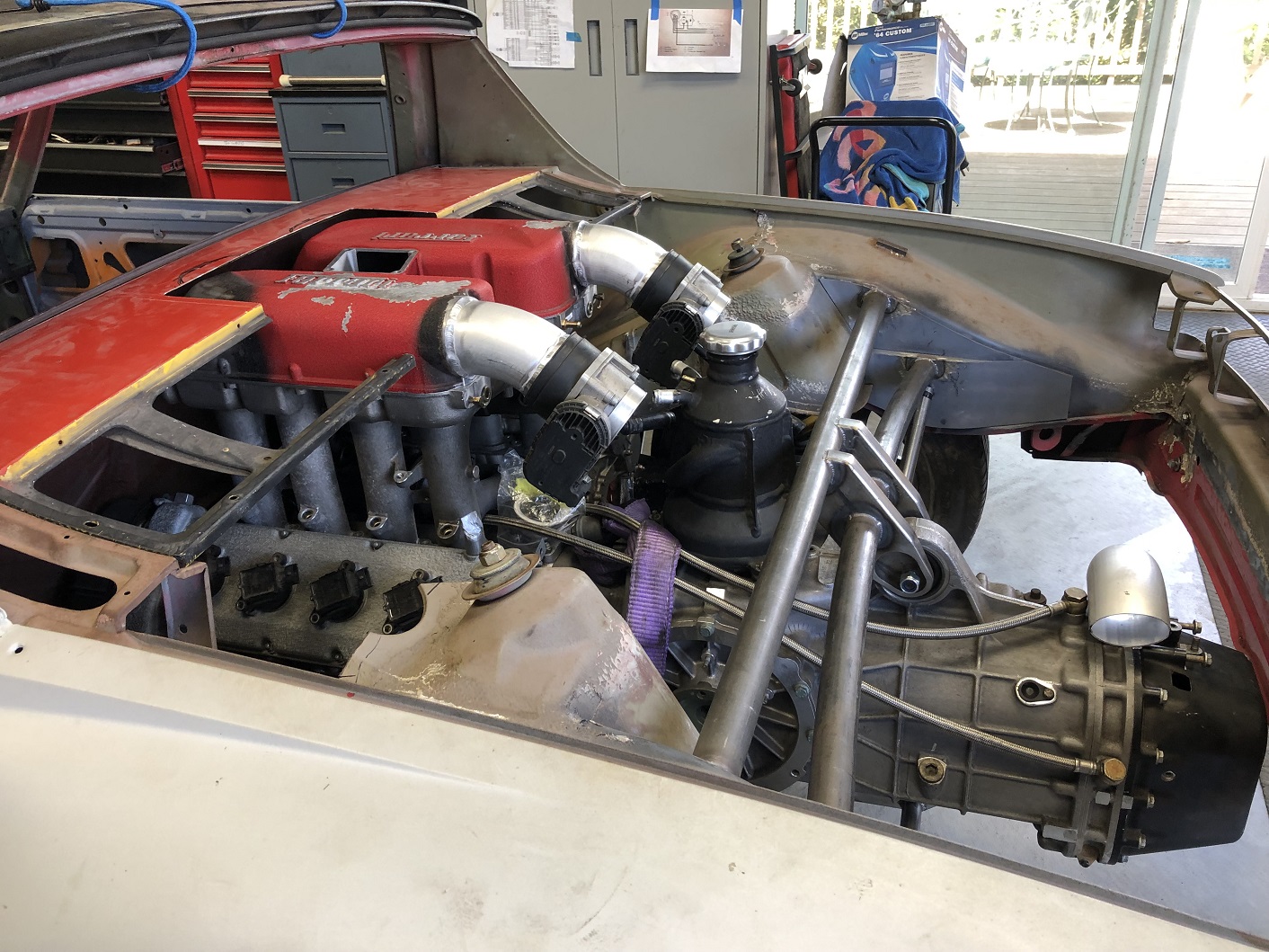

Got the throttle body (TB) "turn-downs" tacked on. These are 3.125 aluminum tubes typically used in boosted applications. Yes, they are WAAAAAY too long and will be trimmed back so the TBs angle downward and head under the trunk skin.
The factory set up has the TBs splayed outward a bit. Style-wise, I saw that as a bit out of place on the 914 so these are set to head straight back off the plenum.

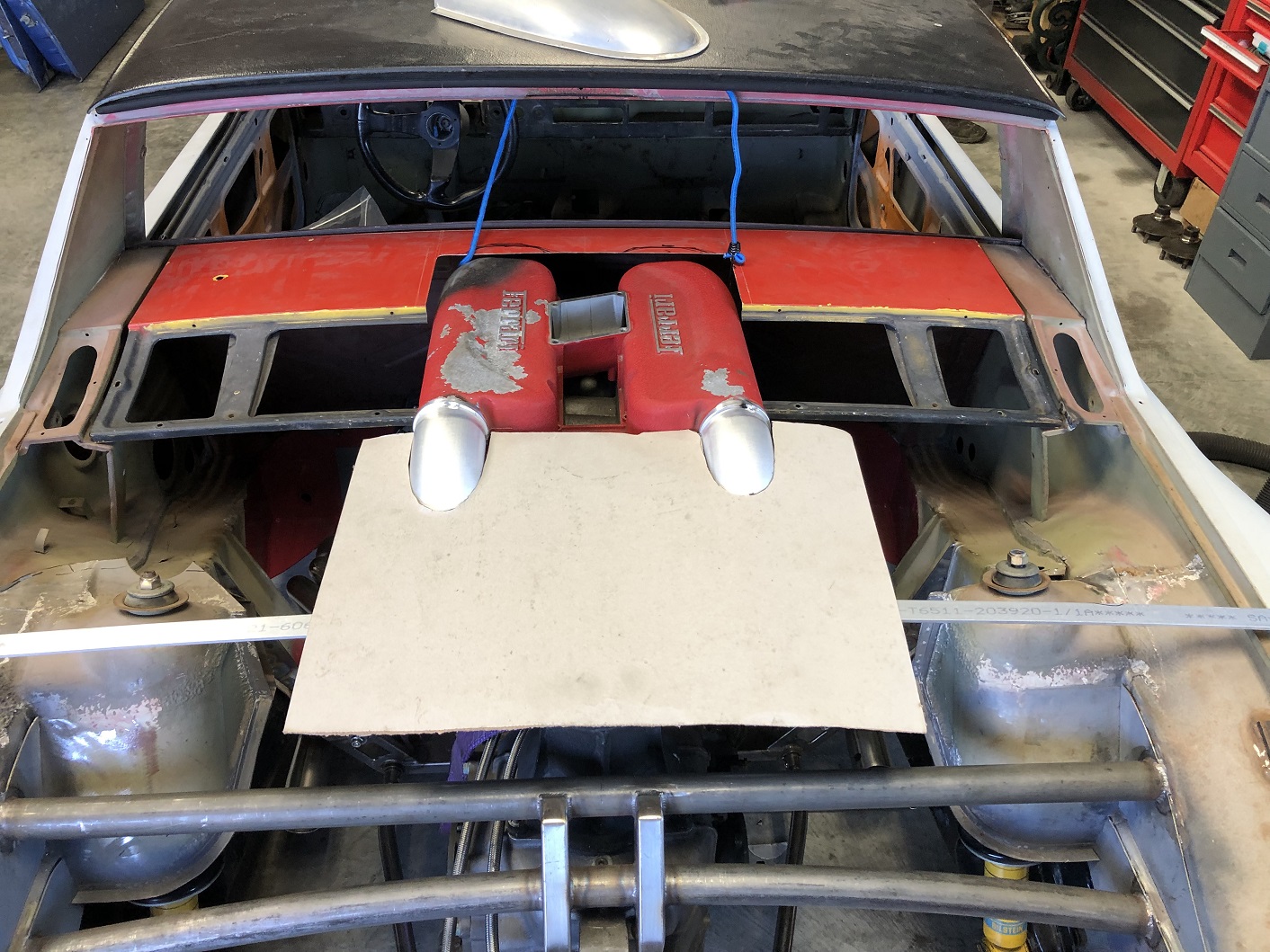

With the turn-downs in place, I couldn't resist playing with some "what might this sorta look like?" mock up.
Yes, a trunk will be sactificed. Such is the "cost of cool". (Hmmm, that might have to go on a t-shirt!)
LOTS of things to work out, for sure. But I think I can come up with something I'll like! (IMG:style_emoticons/default/aktion035.gif)

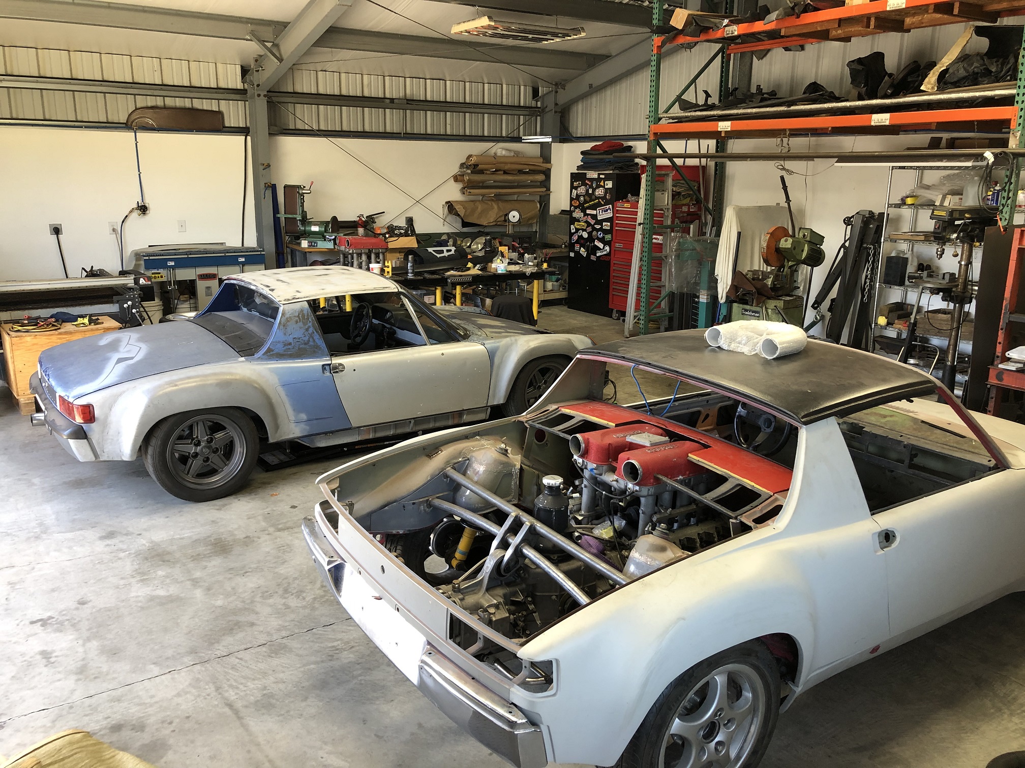

Sharp eyes may have noticed the 914 Ferrari car is sitting where the fixture table used to be.
The past week or so was dedicated to a Spring Cleaning at Red Barn. Much crap was tossed, low use tools and storage sold or consolidated. Fab now happpens mostly in the same area on the far side of the shop.
The end result is I can now fit - and work on - two cars at the same time! Seriously, it feels like I doubled the size of the shop.
Those of you coming to the Luft BBQ will experience it for yourselves!

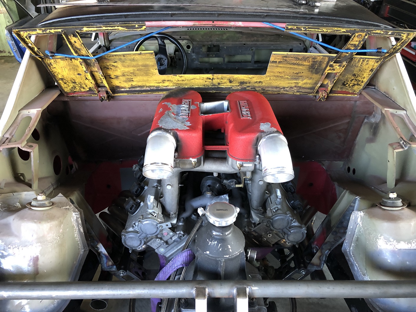

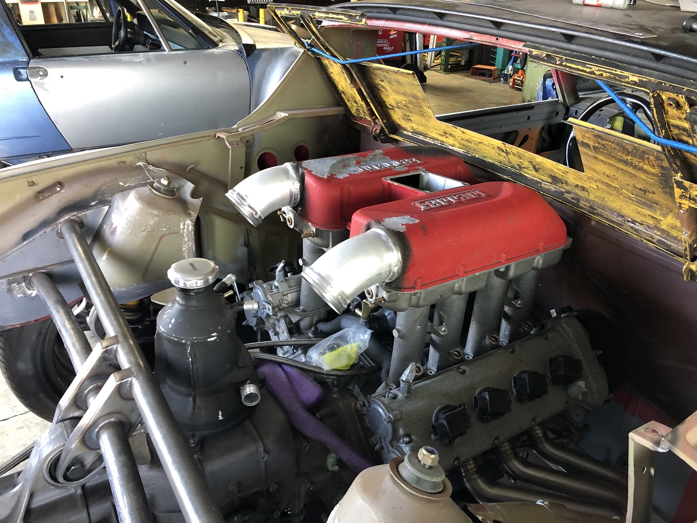

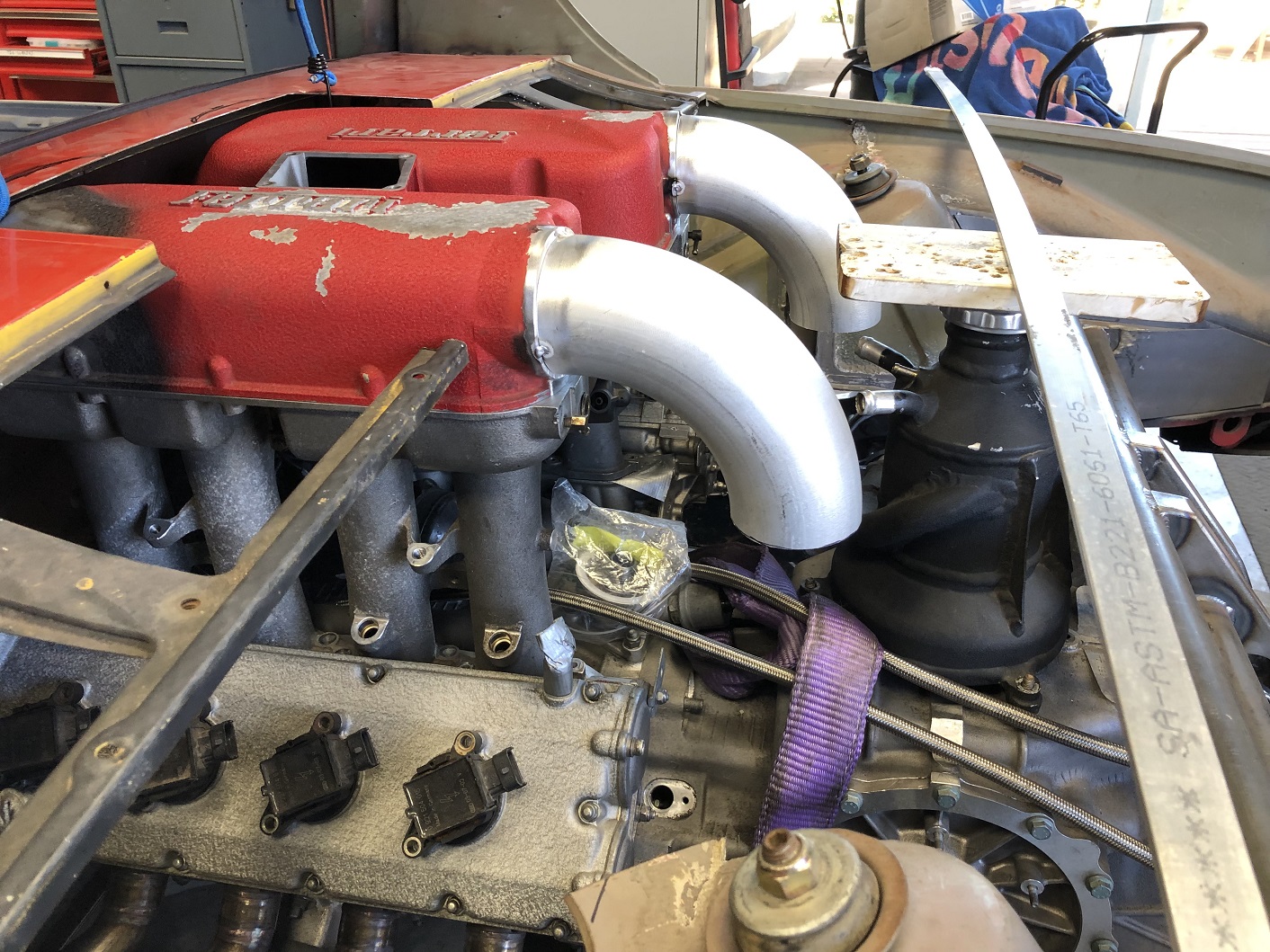

Turn-downs trimmed to length, fitted with the TB rings and everything fully welded.

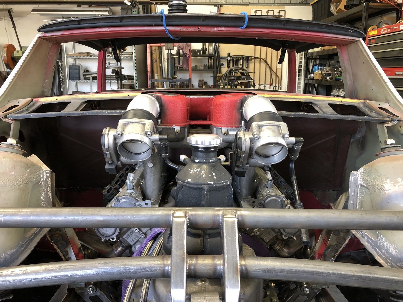

tygaboy

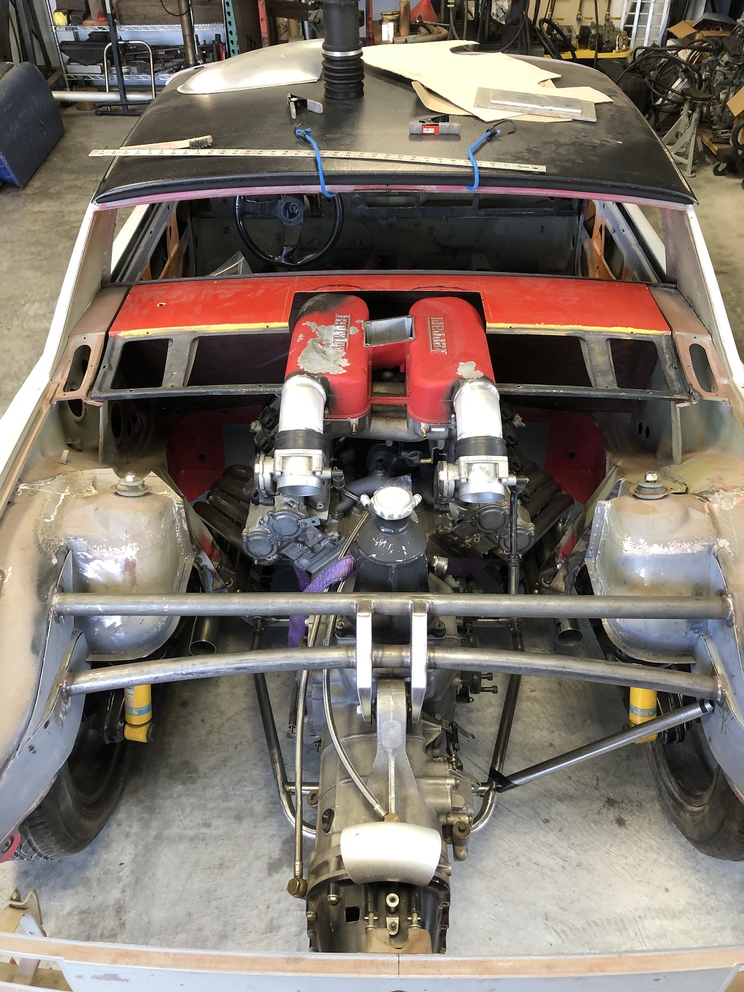

And with the TBs. Next is noodle out an airbox and intake setup. I've got a few ideas that I think will be pretty neat...

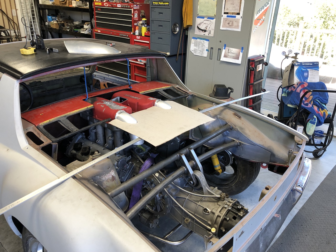

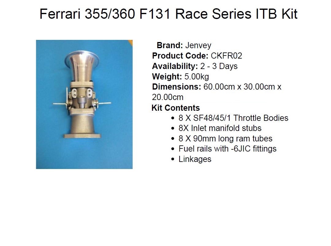

Then there's these. Available with a DBW actuator, which is what I'd do.
It would mean I could fit everything under stock body work, which would be kinda cool - the only tell would be the trans peeking out under the bumper. Plus, I'd have all the "trunk" space, which would otherwise be partially occupied by the intake tract and air cleaners.
I'm communicating with the company to get all the details. We'll see.
