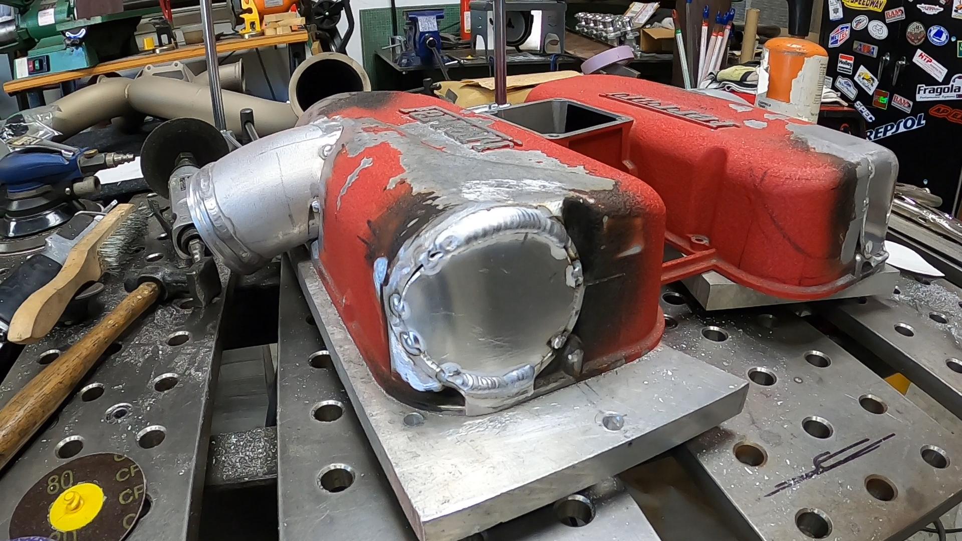

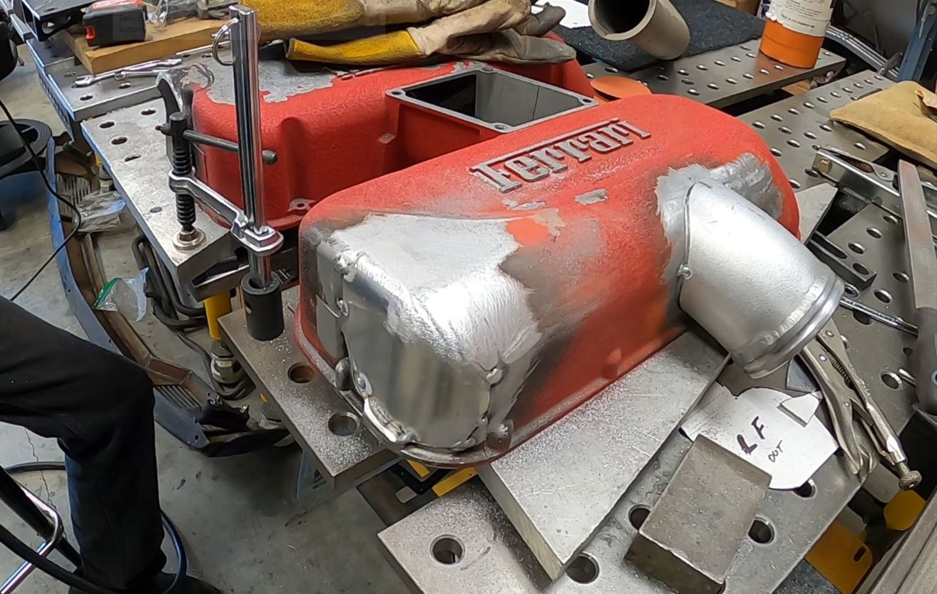

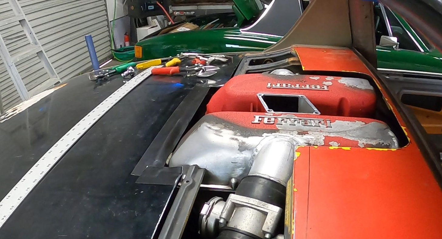

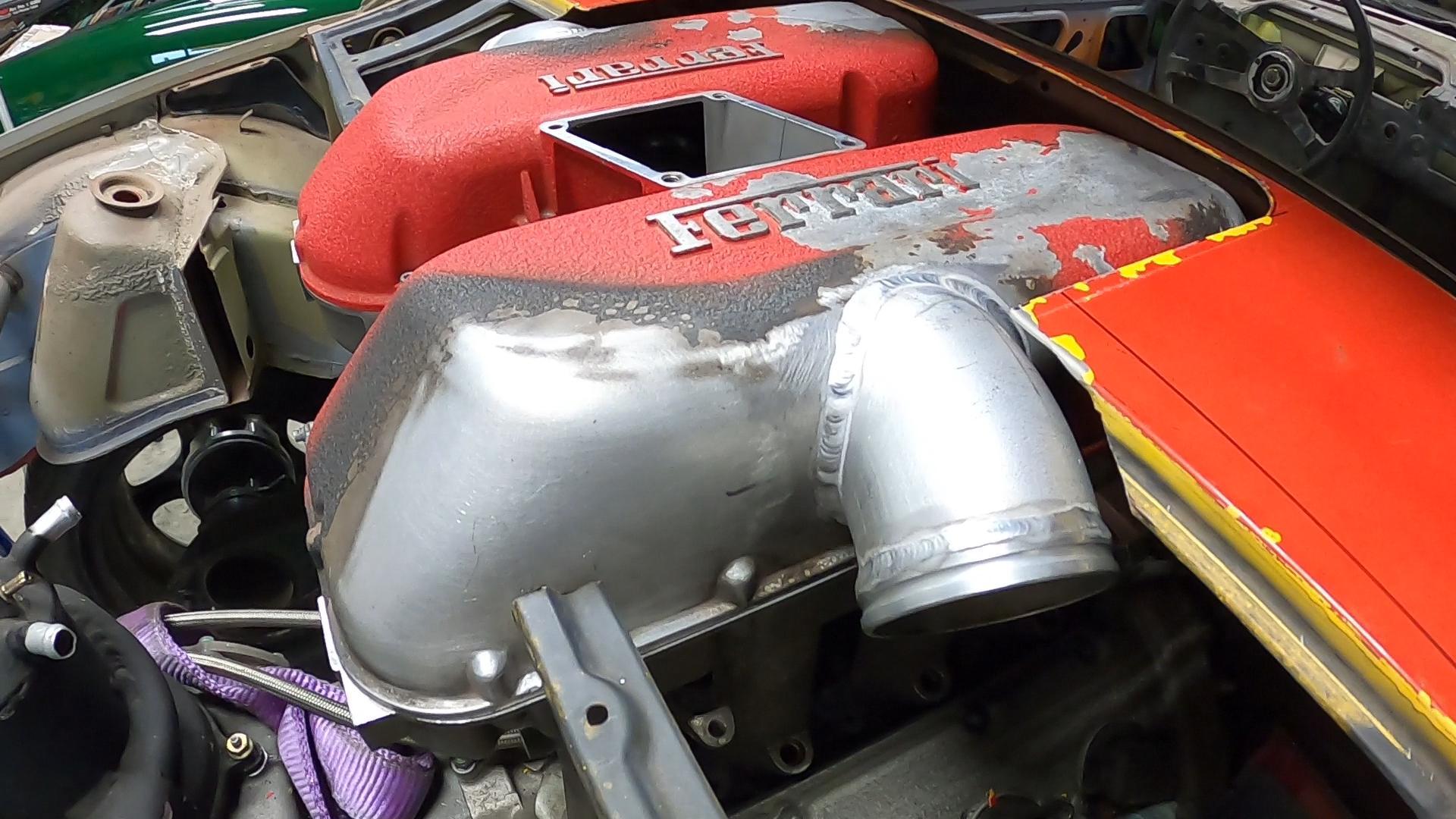

Here's a sneak peek at some content from the next video:
The driver side plenum partch was mostly in place and we couldn't resist seeing what it was going to look like once it's ready for new wrinkle finish. That top section got final welding, some file work then sanded. Yep, that'll work!

Then it was on to patching the passenger side.

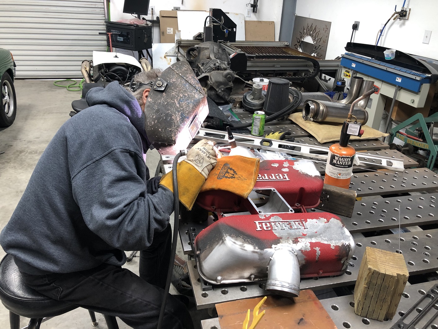

Martin is back at it! I serve as decision maker and Lovely Assistant when it comes to some aspects of my builds and this intake work falls into that category.
As you'll hear in the upcoming video, I'm good enough at enough skills that I'm OK when it comes to things I'm not good at! If I need help, I ask.
I can't afford to practice on parts that are this visible so I call in the expert!

And here you see why. Plus, it's great to take a break from working solo.
Point of clarification: I don't just call Martin and ask him to do all this. We've worked out a "bro deal" hourly rate. This works great because we can ask each other, "you feel like working today?" No one feels taken advantage of and while we are good friends, when he's At The Red Barn helping me or I'm helping him with his project, we focus on the job at hand. It's worked great for years.

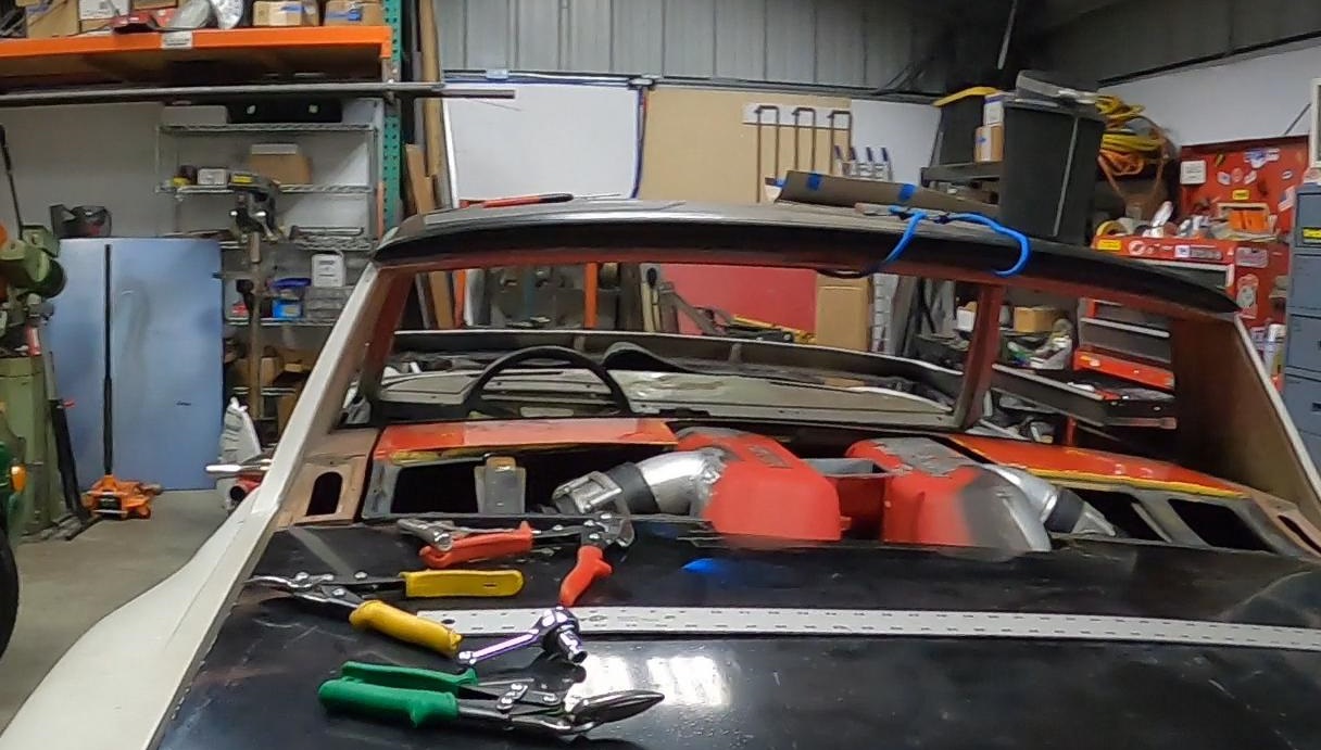

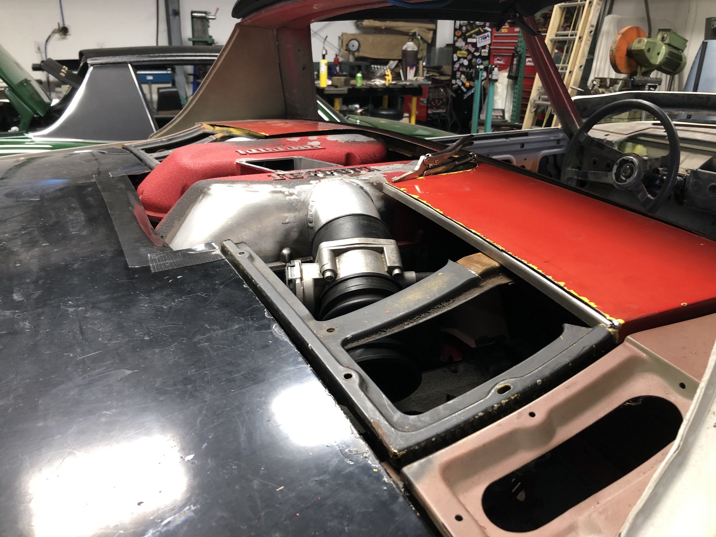

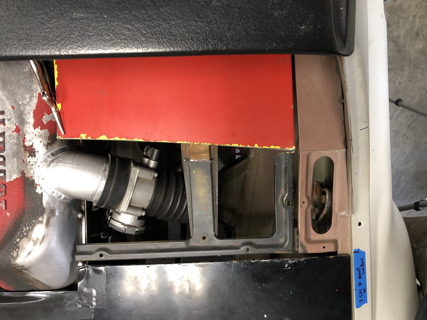

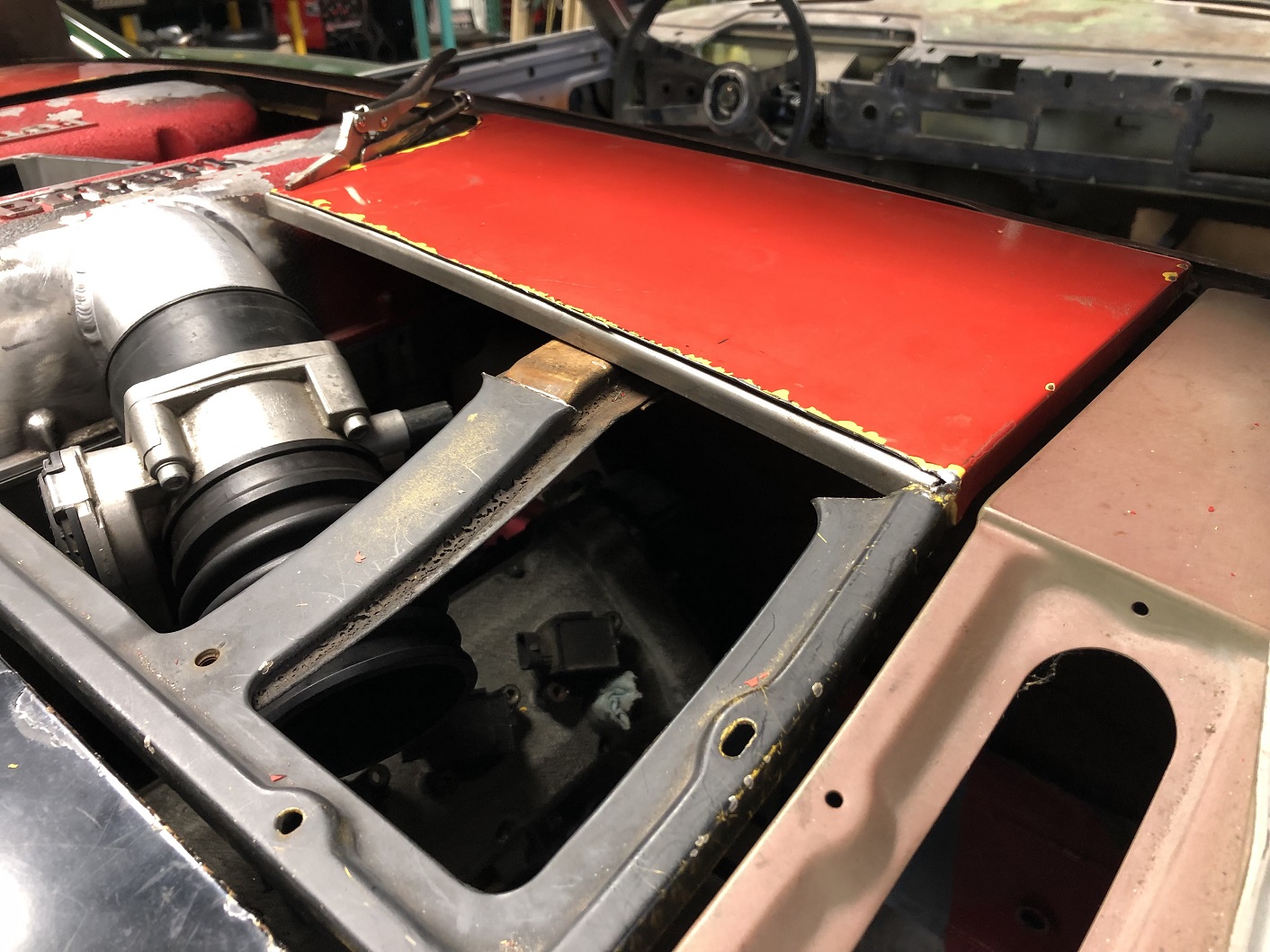

I took a swing at what I may want to do to the engine lid to get the clearance I need for the throttle bodies: curving the leading edge of the grill area.
I started with the driver side, just to see what my immediate raction would be... and I think I like it!
I was worried that messing with that very straight edge would go horribly wrong but when I look at it, it seems to flow with the sail panels, the curve of the roof, the arch of the trunk lid, etc. Comparing it to the right side, I think it softens the look in that area and doesn't look out of place.
I'll cut the other side and tidy it up a bit more but I think this may work.

In order to get a more accurate visual, I made a quickie return and clamped it onto the curve. With that dropped edge, it still looked crowded at the plenum so I moved that end of the curve forward maybe another .75".
That overhead shot shows just how much material has been removed but it's no where near as dramatic when viewed from the side. Of course, the car is on the Quick Jacks so much higher than it will be when typically seen.
But I think this curve idea works well and that return REALLY cleans things up and gives a better impression of how this is going to look.
