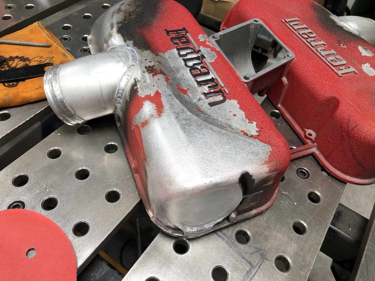

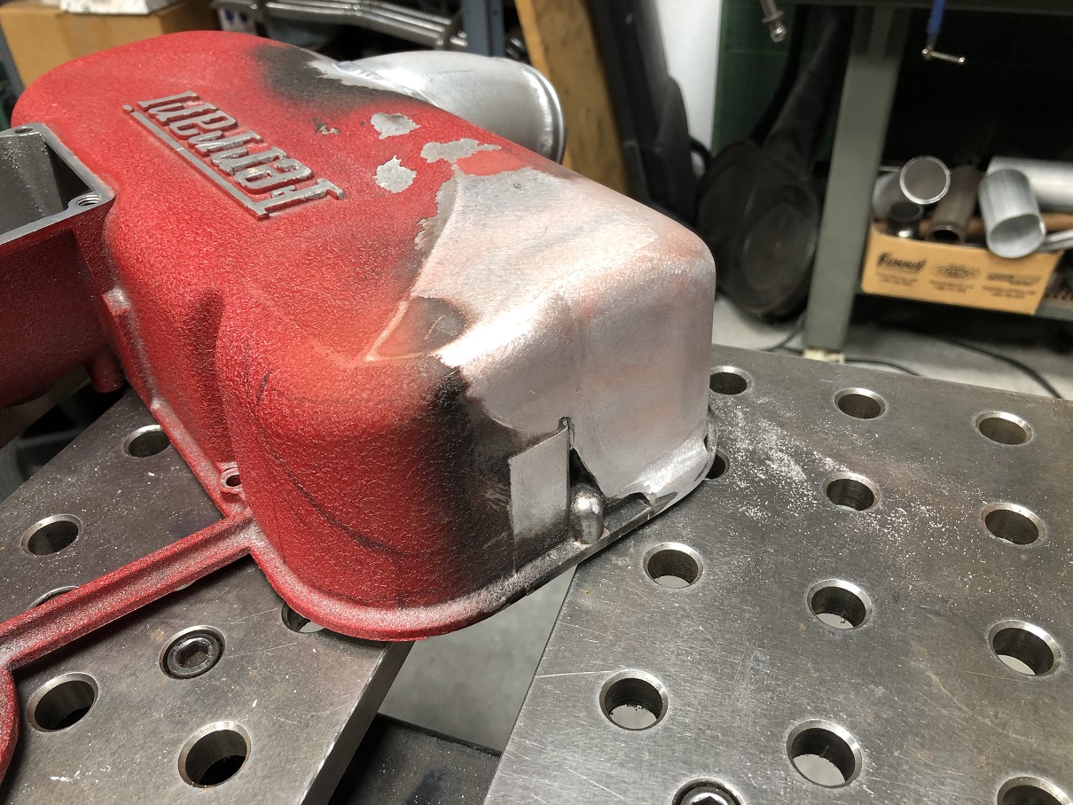

Files + angle grinders + d/a + a bit of time and the plenum patches are nearly ready. Even though this end is entirely hidden once it's in the car - all that's visible are the top and side radii - a few spots still need a bit of tidying up.

I’m pretty impressed with the quality of that sand cast aluminum. It welded really clean!

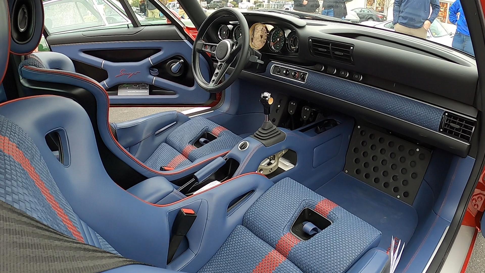

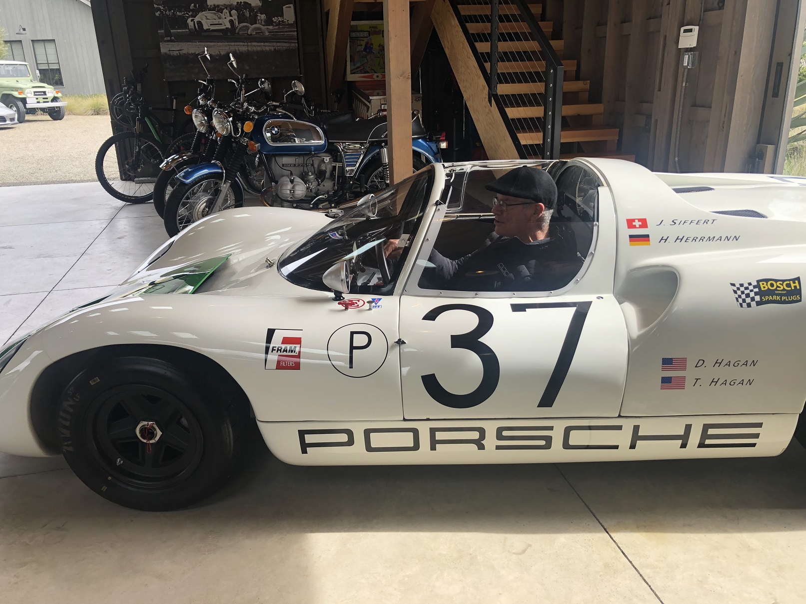

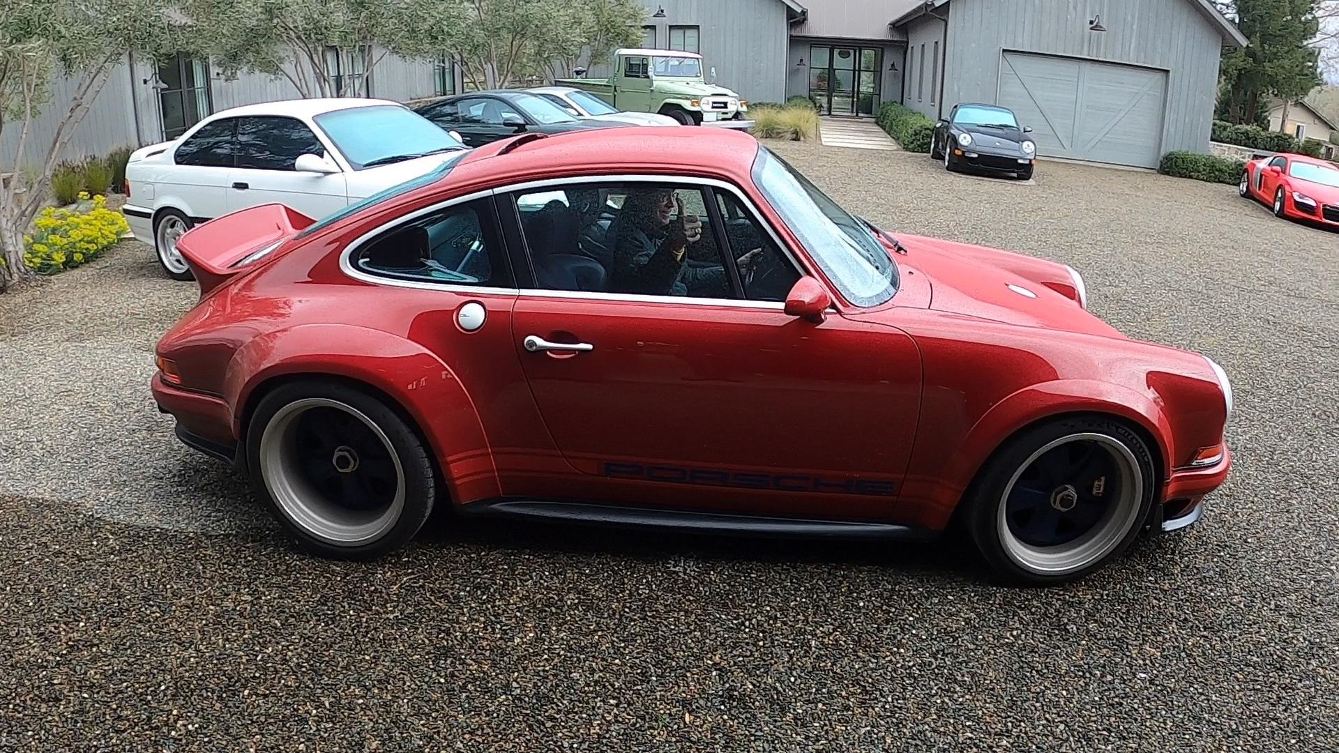

It's not lost on me how fortunate I am. Yesterday I had a unique opportunity to hang out with a group of serious Porsche folks.
While I thought the Singer DLS would be the highlight of my day, it turns out it was when the owner of the 910 said, "You want to sit in it?". Uh... Yes! Yes I do!
That 910 was 2nd in class/4th overall at Sebring in '67.
Quite a day...

The famous Siffert / Hermann / Baker car....!
What an opportunity!
