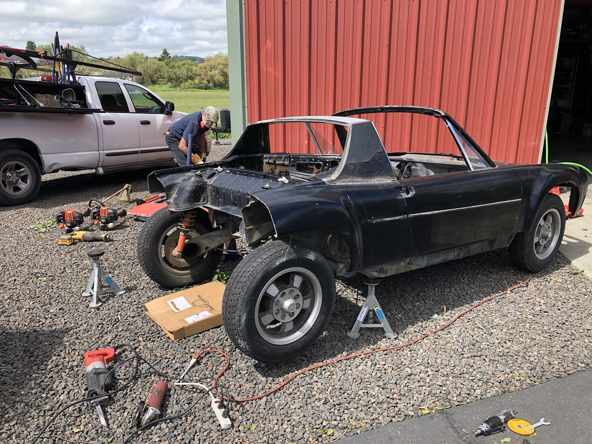

I'm back to working on a removable trunk insert. Martin helped and earned his keep by removing the trunk fire wall from the black parts car.
And these pics don't do justice to how cool this car looked with the back chopped off. All I could picture was a transverse drive train poking out, Lancia Stratos-ish.

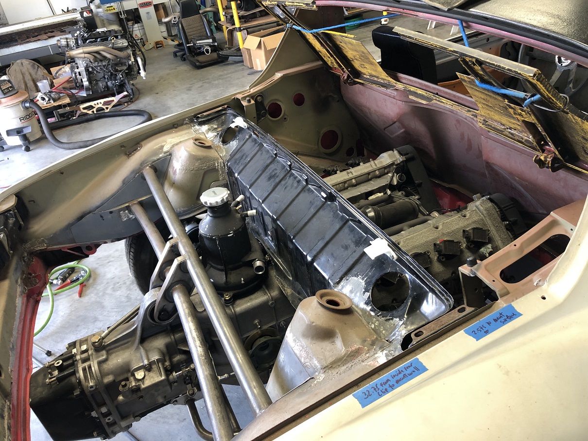

Then it was hours of work removing spot welds and "extra" material to get the panel down to what I needed. But here it is in place. Just what I was hoping for...

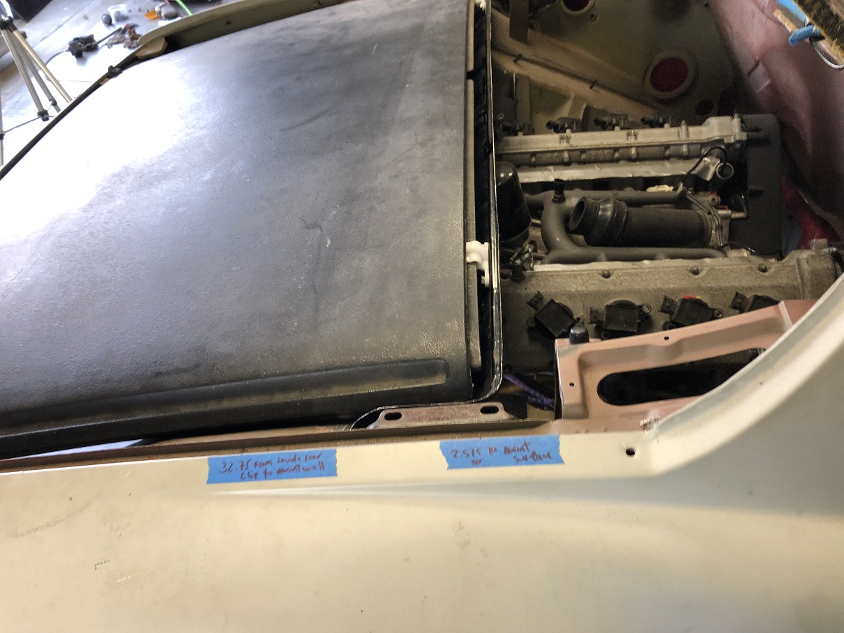

And who'da thought: A Ferrari-swapped 914 can still store its targa top! Yes, the air/oil seperater clears the underside of the top.
There's a bit more clearance work needed so the intake manifold can fit, but fit it will.
Pretty cool, if you ask me. (IMG:style_emoticons/default/aktion035.gif)
