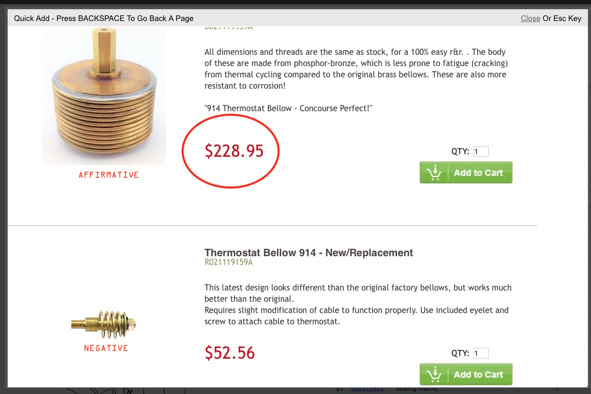

@Lockwodo .
i would not install the $55.00 thermostat.
the $55.00 one is the VW of Mexico beetle thermostat (spring design) that superceded the original german design which is the upper one (bellows design) in illustration attached.
the old style belllows thermostats have to be rebuilt. not cheap to do and not necessarily rebuilt to original specs. difficult piece to remanufacture.
hence much higher price on AA website.
its the same where-ever you look.
the original design fails in the open position. fail safe.
mexican revision fails in the closed position. result = cooked engine.
don't ask me why VW would be so stupid as to have done this.
its probably a simpler and cheaper device. but whats the point?
a thermostat even in a watercooled engine is designed to fail open and mostly they do.
thats why i have not hooked up my thermo on my car.
the bellows unit is shot and its been for 30 years.
i haven't found a rebuilt/reman/aftermarket one anywhere for less than around that $300 AUD mark minimum.
EDIT
i am going to have to find this stuff again.
it might be that the bottom spring one is the revised mexican design.
there is some problem.
let me look back through my stuff on this again that i looked into a year ago.

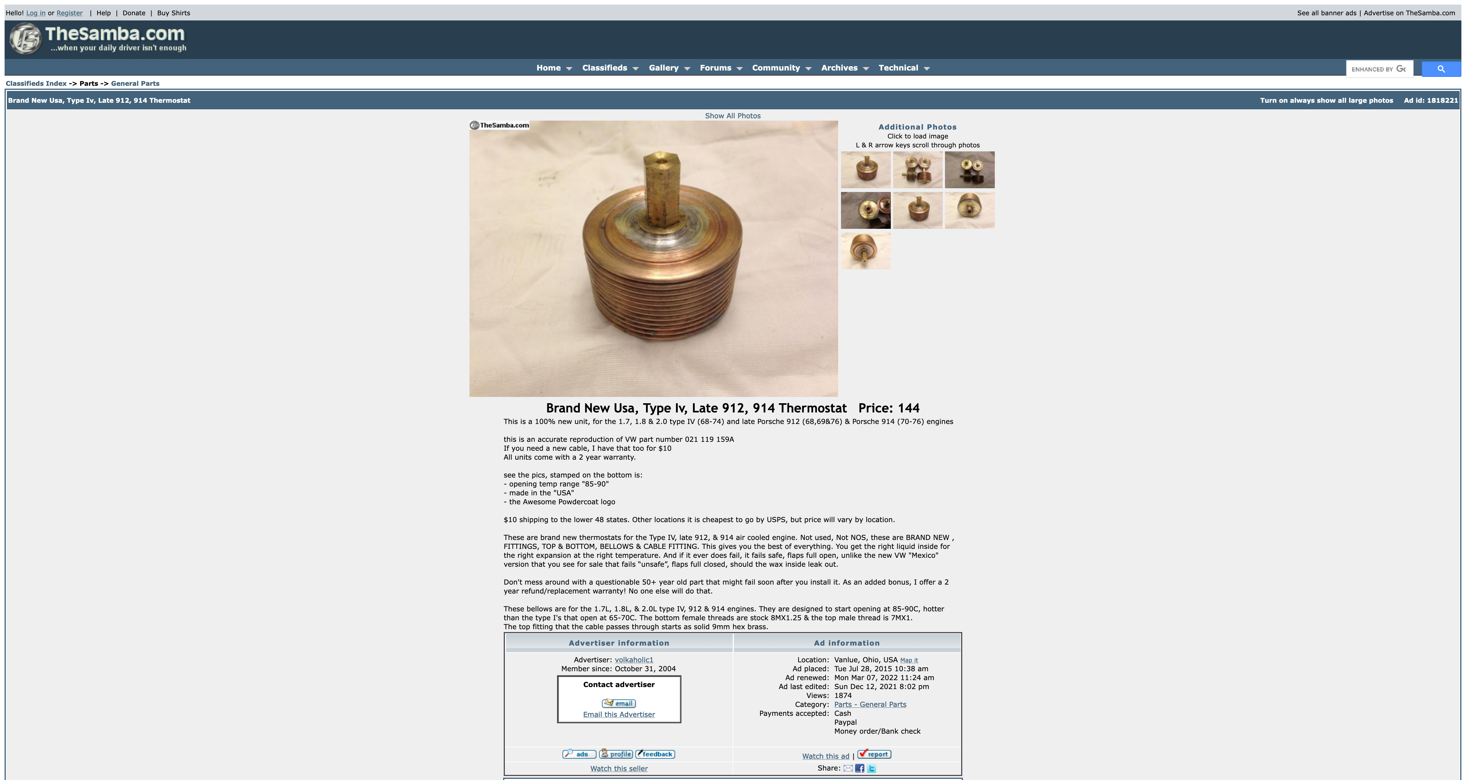

here is a link to the discussion.
the mexican one works by having some kind of expanding wax in the cylinder part.
the spring is to push it closed when things are cold. ie pull flaps shut.
the expanding wax can leak out of these.
if it does there is nothing to make the unit extend and open the flaps.
only the spring which is pushing cylinder back in other direction until it is closed. hence it fails pulling flaps closed.
you got to kind of look at it twice to figure out how it works and why it isn't so good.
https://www.thesamba.com/vw/forum/viewtopic.php?t=630252

Here you go. Brand new made in the USA. Guy also makes all new flaps set up and new bearing roller thermostat pulley.

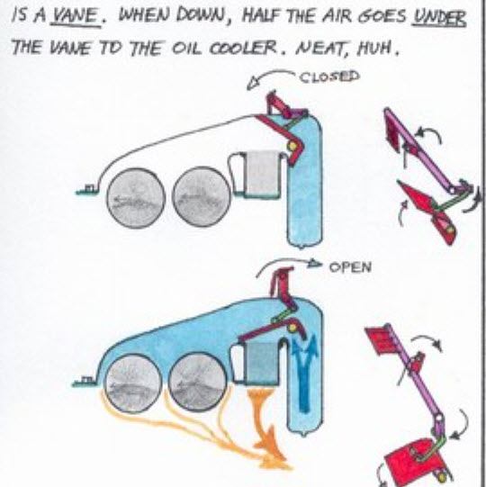

There are several things going on here.
Fix the flaps - get new thermostat if necessary. I'm going to recommend the opposite of previous advice. Fix the flaps 1st -- engines aren't cheap.
The flaps provide proper warm up (i.e. quickly) and drive condensation moisture out of the oil. Air cooled engines don't like to run cold. Personally I had an engine come with my car as purchased that was wrecked by rust and condensation caused by running without flaps for who knows how long. There are other reasons related to engine running clearances too.
With respect to your temp gauge. That measures oil sump temperature -- the fact that it is running on the low end of the gauge is yet another indication that your engine oil is not running at proper temperature and may not be warming properly due to the flaps issue.
Nice graphic someone crated:
Note that when flaps are failed open you're constantly running cooling air across the oil cooler.

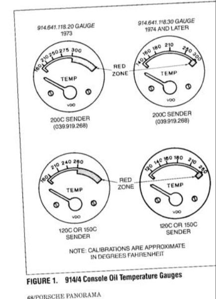

With respect to the temperature gauge, here are the graphics for rough calibration points depending on which oil temperature sender your using (i.e. in the taco plate).
039919268 is the OEM sender (200 C) for 914's. Many have had the wrong (120C or 150C) senders installed over the years which is why the graphic contains the gauge calibrations for those as well.
Normal oil temps for an air cooled engine are much hotter than water pumpers. Oil sump temps in range of 240 - 280 F are not outside the norm for air cooled motorcycles and air cooled T4 engines. You can see this was reflected on the OEM gauge calibration which doesn't start the red zone until 300F.
