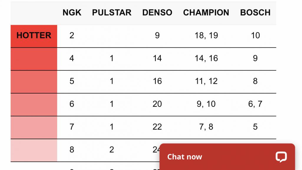

I’m having trouble keeping the Bosch WR5DC+ (7992) plugs in my 914/6 from fouling.
The engine is an RS spec 2.7l except with Webers & more aggressive cams w/ faster acceleration ramps.
I’m thinking the operating conditions are causing the problem; frequent moderate to heavy traffic, numerous traffic lights, and 45 mph speed limits half the time.
Despite the CDI ignition, keeping revs @ 2000 at traffic lights, and rpm above 3000 while moving, the plugs foul quickly.
Planning to change to the next step hotter plug … WR6DC+ (7995) and see what happens.
Comments? Anyone have experience w/ a similar engine configuration?
Feeling like even driving on open roads w/ 60 mph speed limits the “5” would be too cold.
