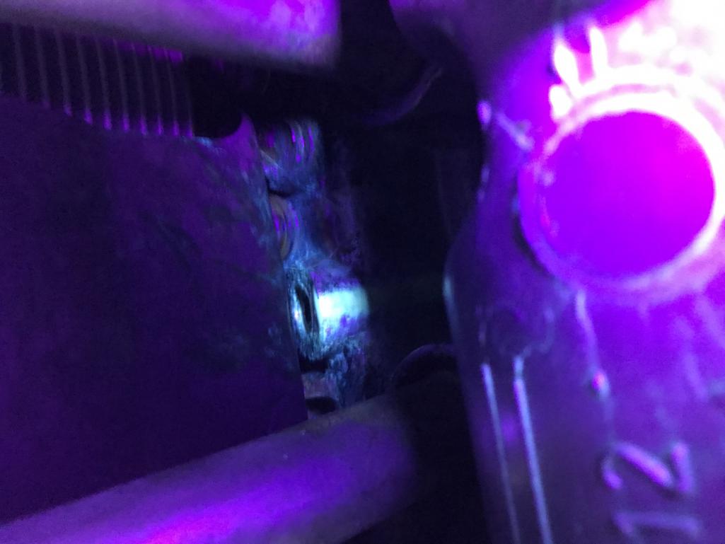

Hello,
I am trying to repair a leak in the oil gallery under cylinders 3-4 As you can nearly see, the air deflection plate is up against the leaking clean out plug. I would like to know from someone who has done this before, can I remove the rocker arms and pull the push rods and tubes as far as they will go, can I move the deflector enough to get access to the plug? Thanks for your help. Mike |
mgphoto Oil gallery leak under cylinders 3 & 4 May 17 2022, 07:48 PM
r_towle You can pull the push rod tube out, you can’t ge... May 17 2022, 08:08 PM
mgphoto So pull the engine? May 18 2022, 01:19 PM
r_towle I would pull it, mount on engine stand, flip it ov... May 18 2022, 09:34 PM
mgphoto Don’t need to pull the engine, push rod tubes an... May 21 2022, 01:22 PM
Dave_Darling Pull the pushrod tubes halfway out, then swing the... May 22 2022, 12:02 AM![]() ![]() |
