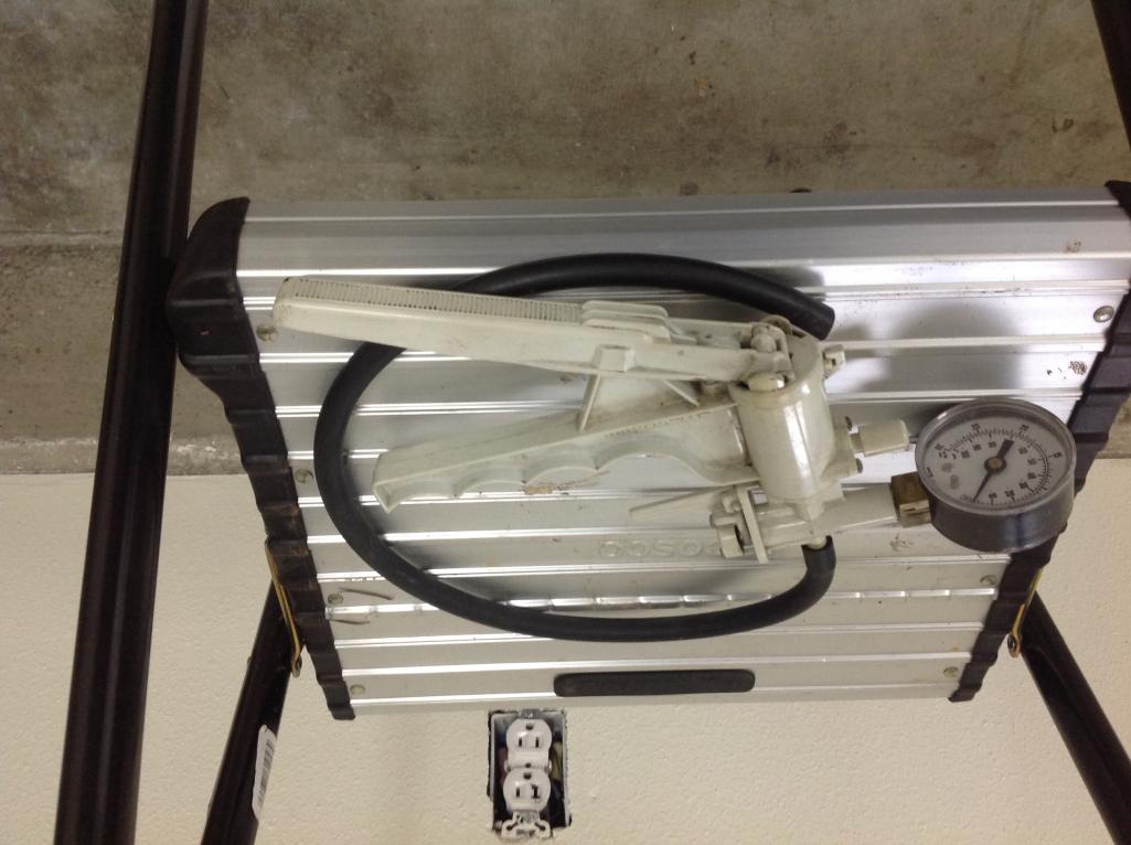

mgphoto   First test is simple, get a hand vacuum pump with ...   May 27 2022, 09:57 PM

rhodyguy   This is a MittyvacII. You will know if the diaphra...   May 29 2022, 08:35 AM
shredtherad   This is a MittyvacII. You will know if the diaphr...   May 29 2022, 10:49 AM
shredtherad   All, thanks for the replies and insights I teste...   May 29 2022, 10:54 AM
