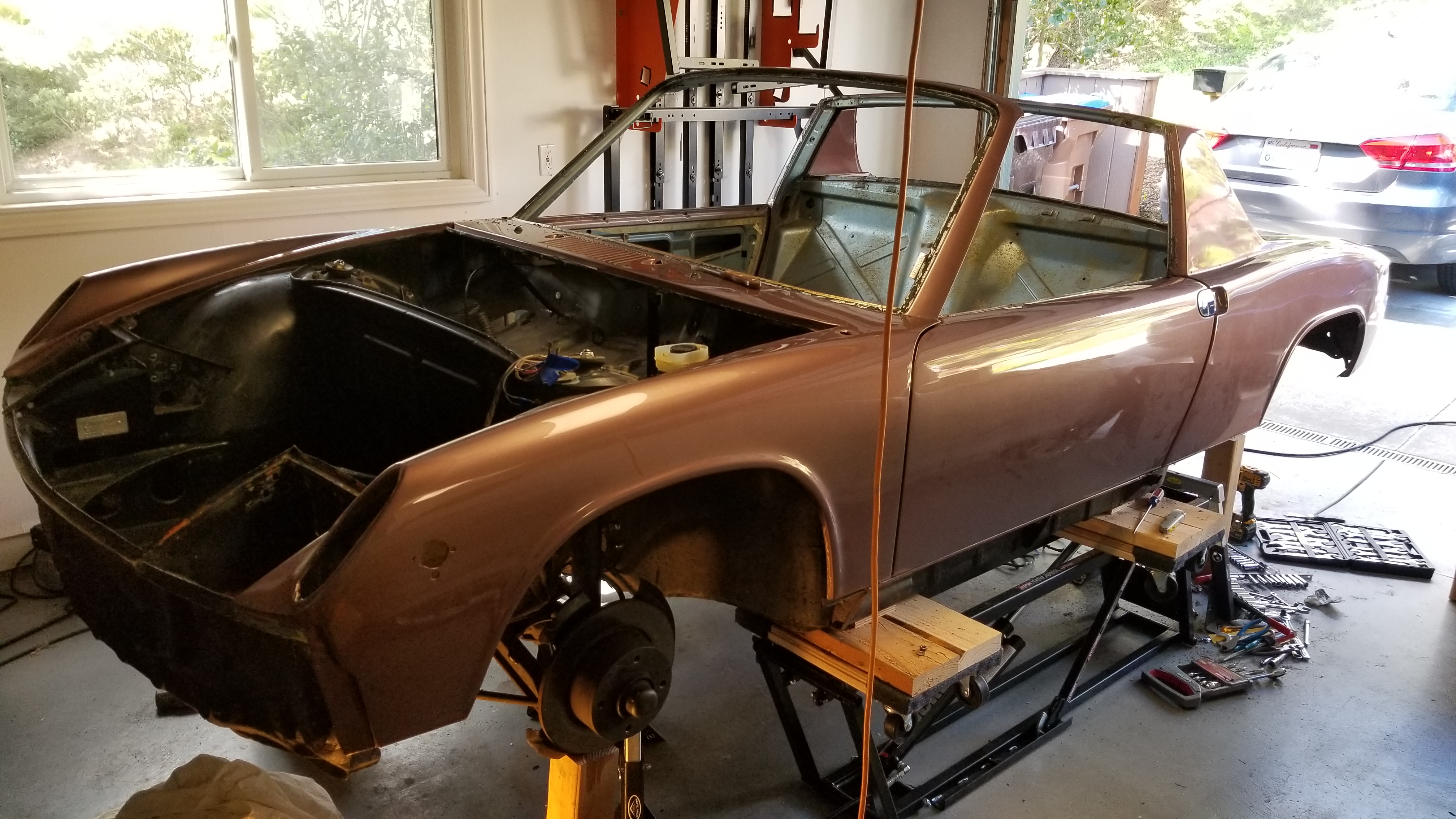

Fast forwarding, this is the car stripped down.

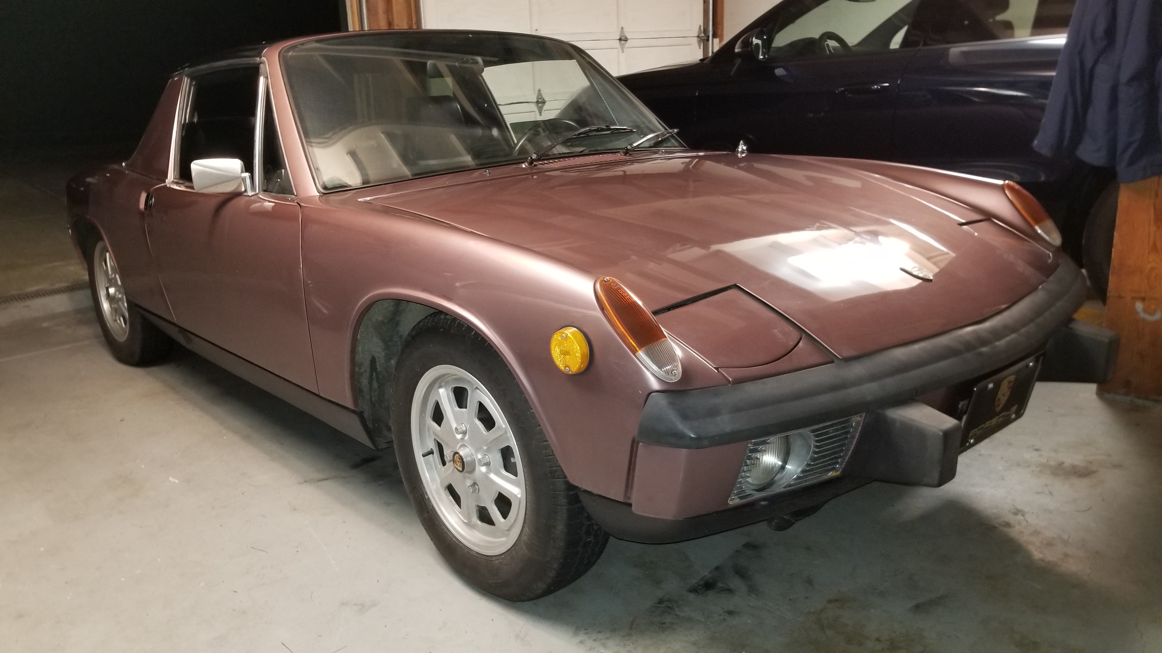

Car was originally Marathon Blue. There is worse, but the floor was eaten pretty bad.

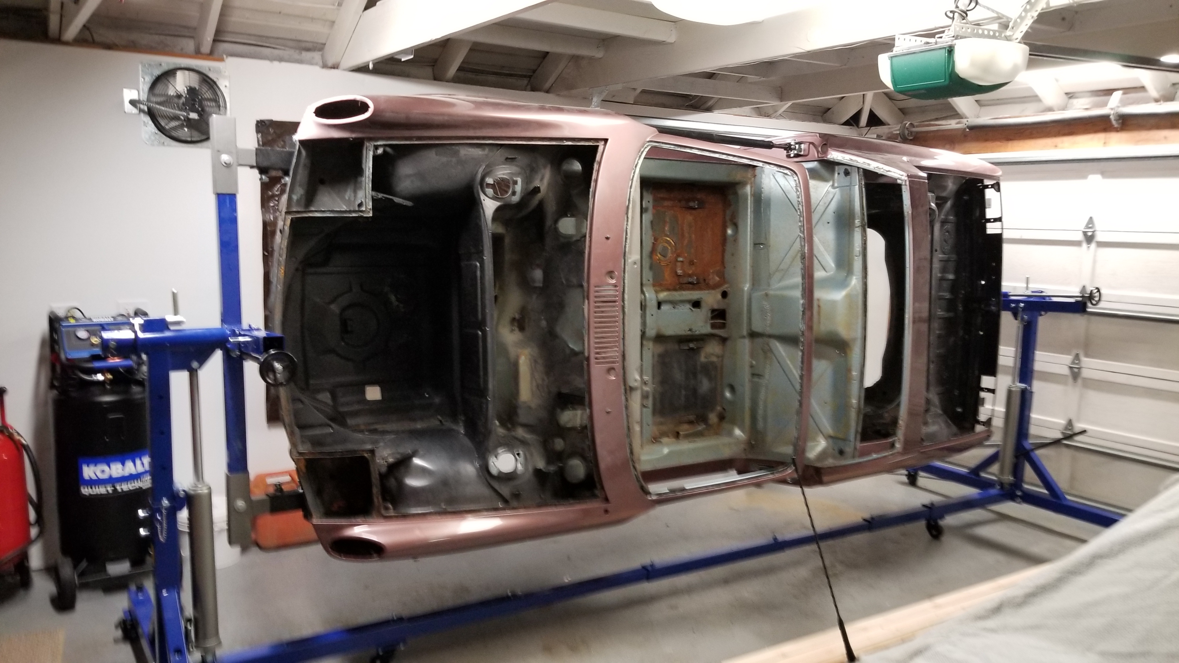

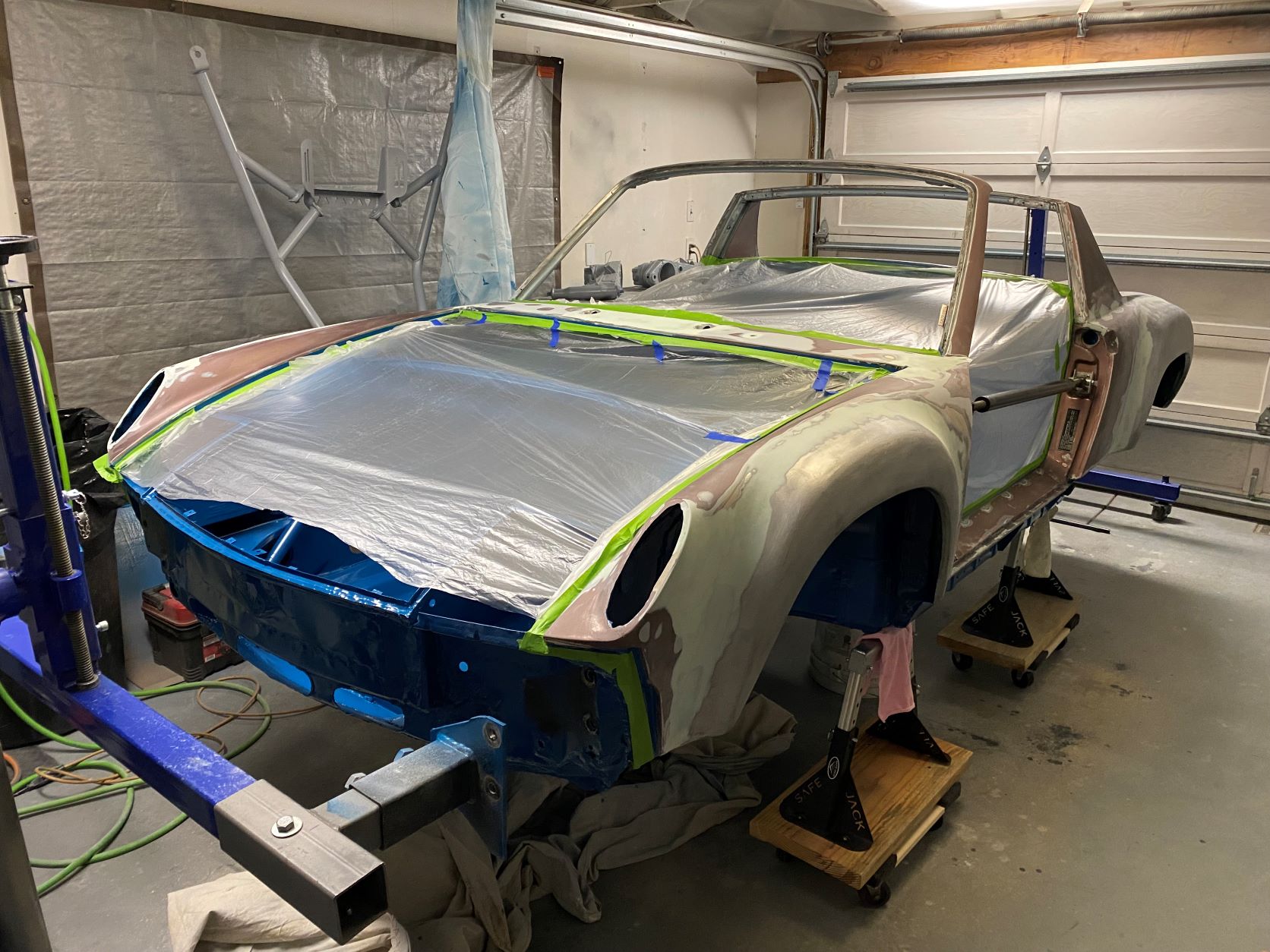

Up on the rotisserie for sand blasting and body work. The Kobalt compressor did not last long. Not enough oomph.

Sand blasting is not fun unless you have a dedicated set up, which I do not have.

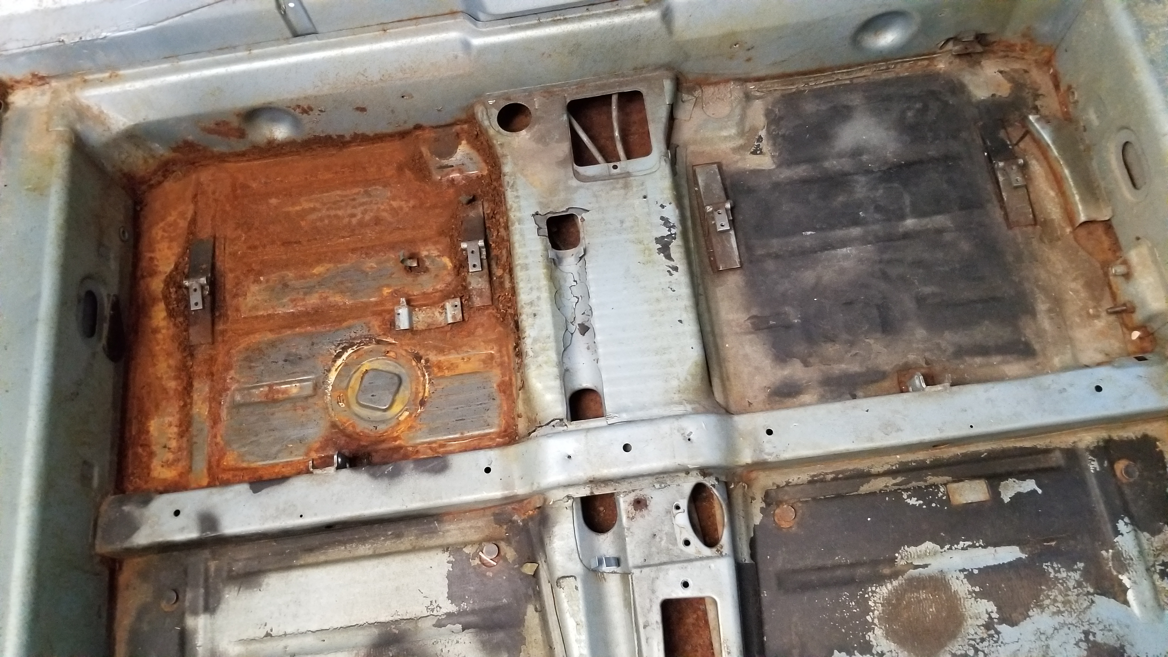

post Jul 4 2022, 11:49 PM
JEH
Posts: 24
Joined: 1-November 21
From: Bay Area, CA
Member No.: 26,046

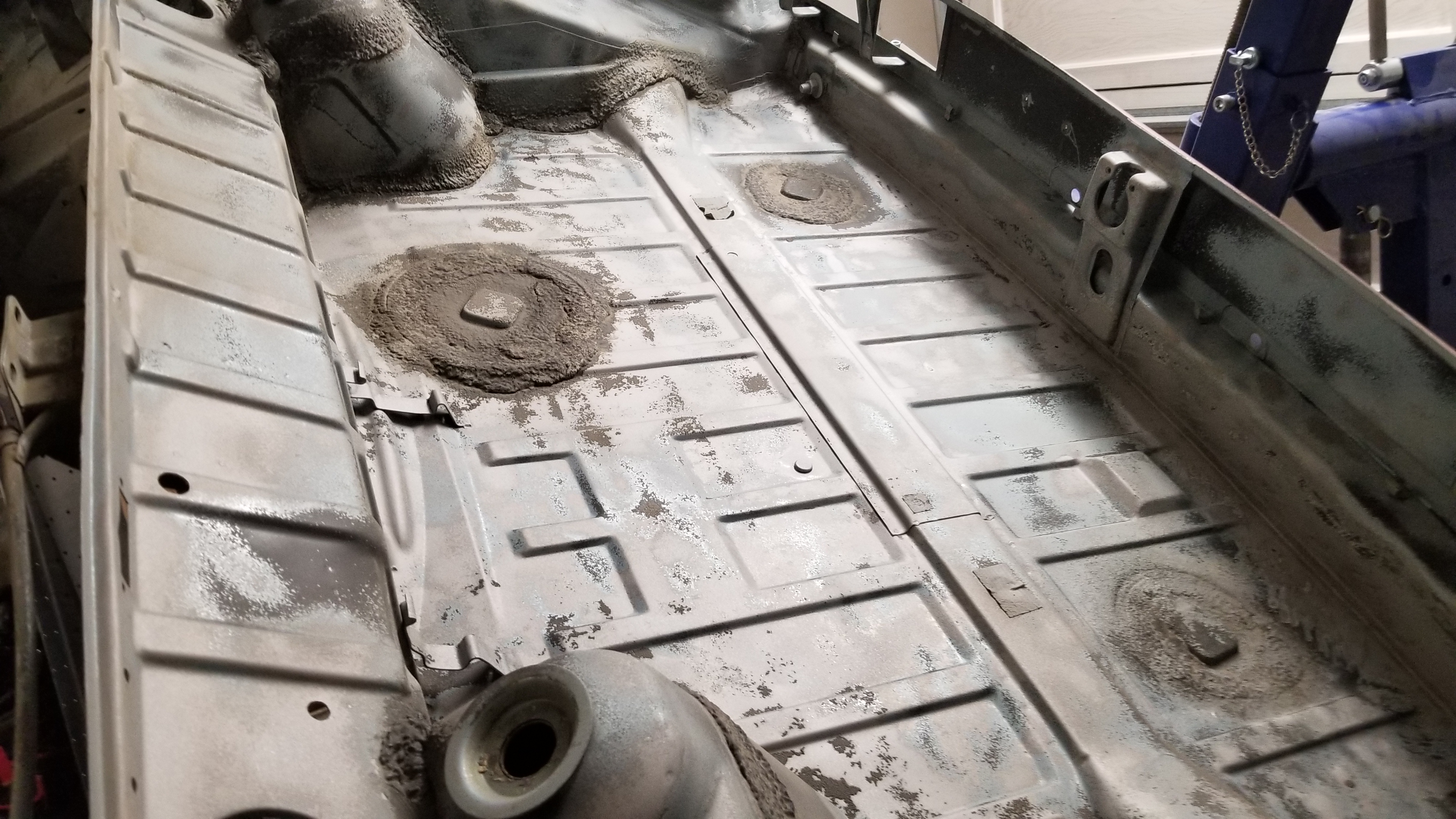

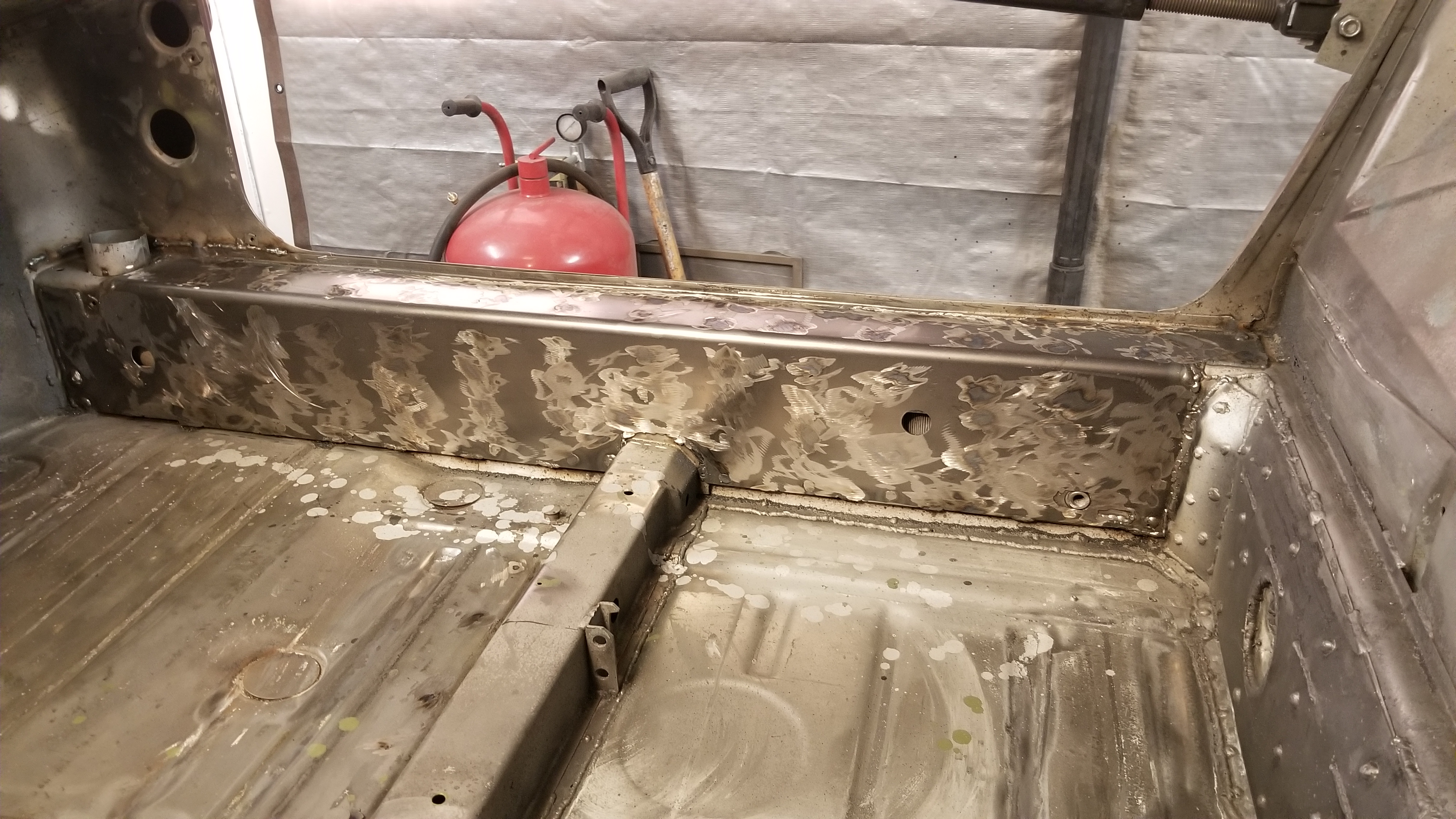

Welded in new rear floor and inner reinforcements. Yep, I know the welds are not perfect. Learning as I go.

Welded in the outer clamshell reinforcement.

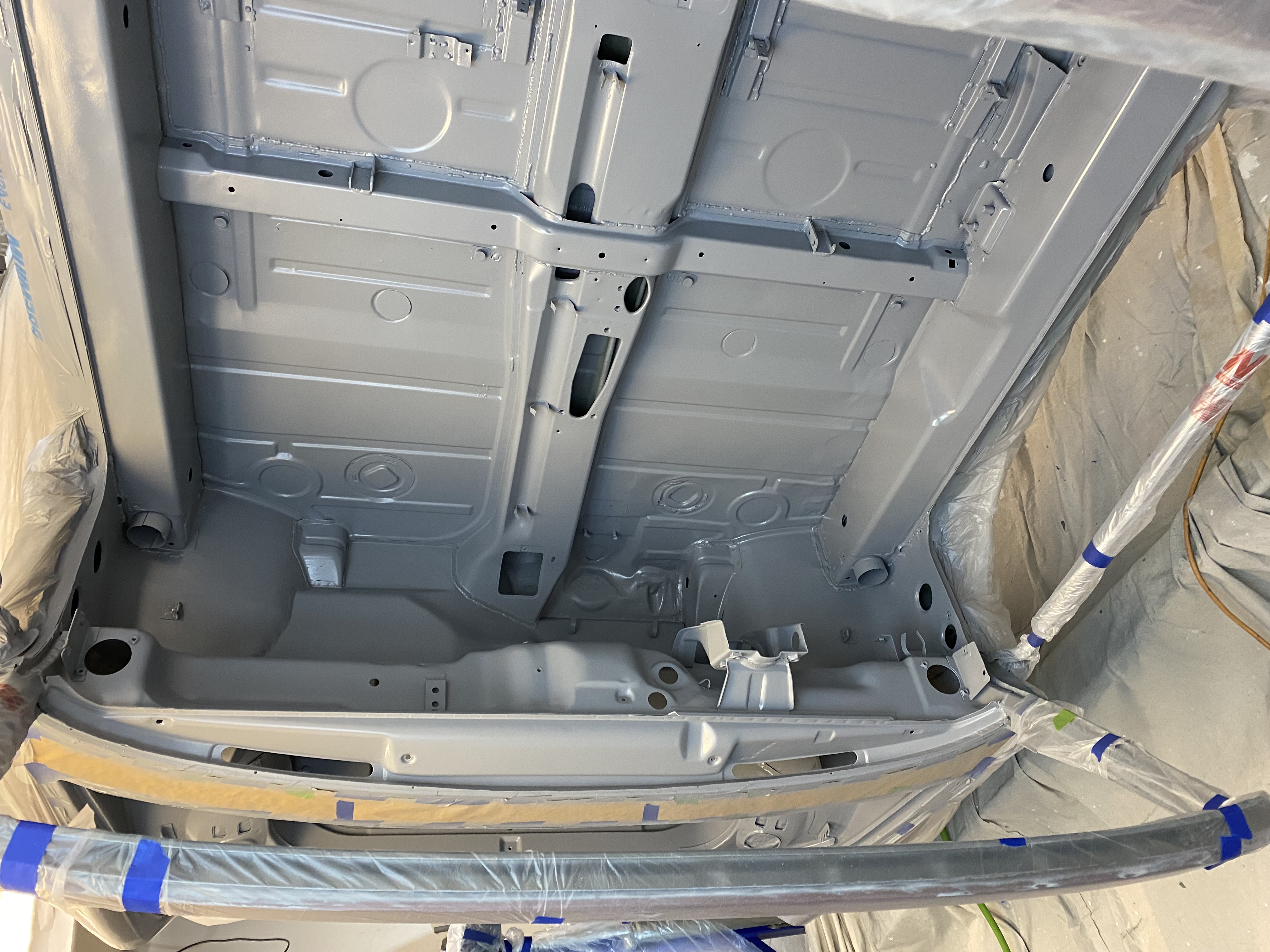

post Jul 5 2022, 12:03 AM
JEH
Posts: 24
From: Bay Area, CA
Member No.: 26,046

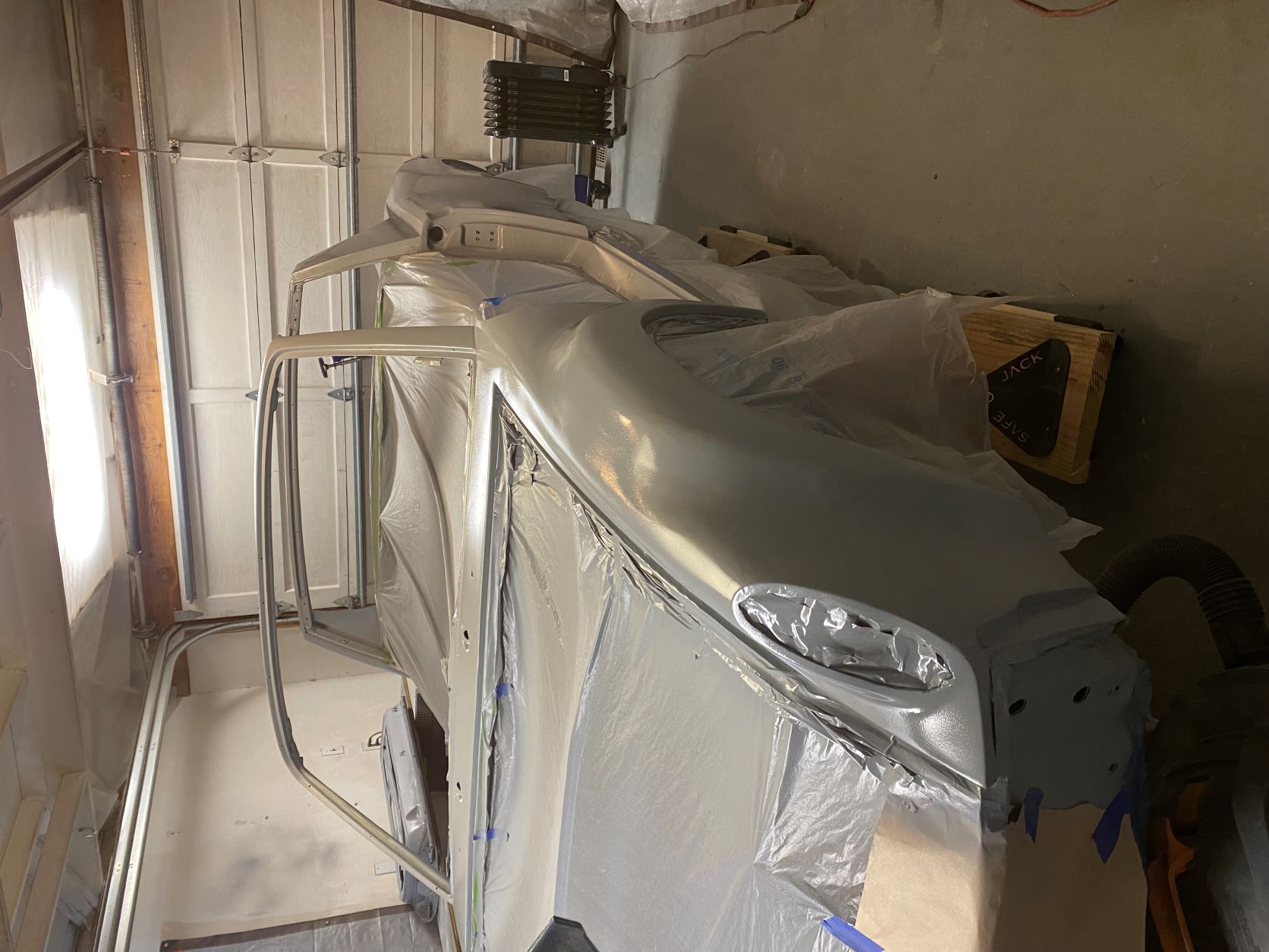

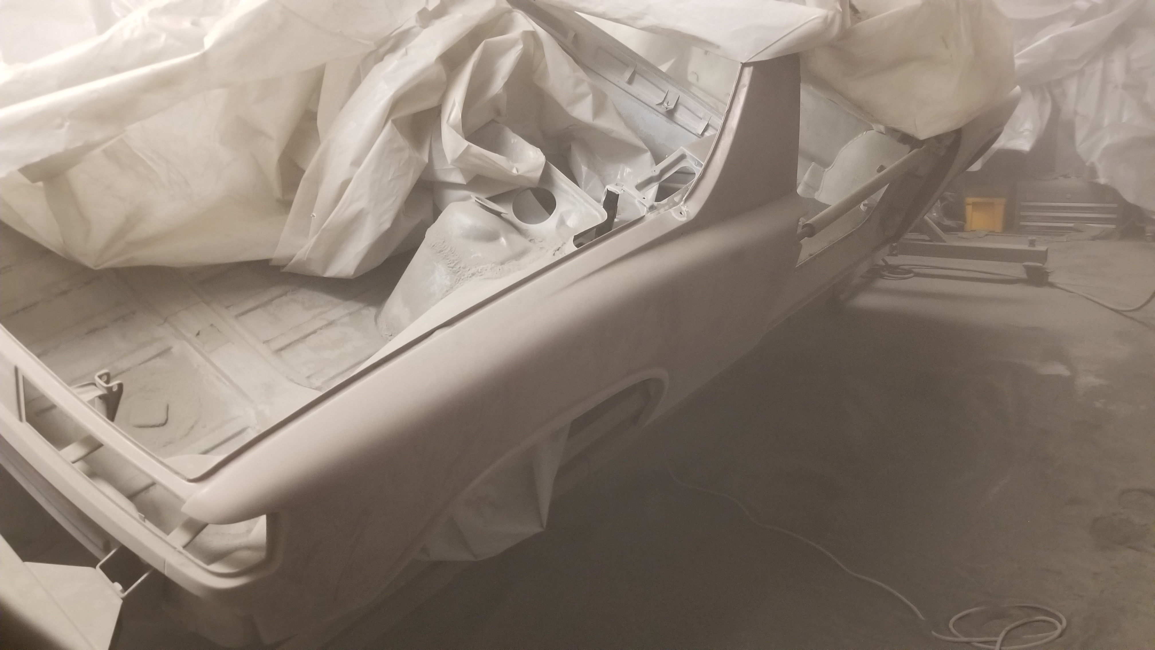

All primed with 2K Epoxy.

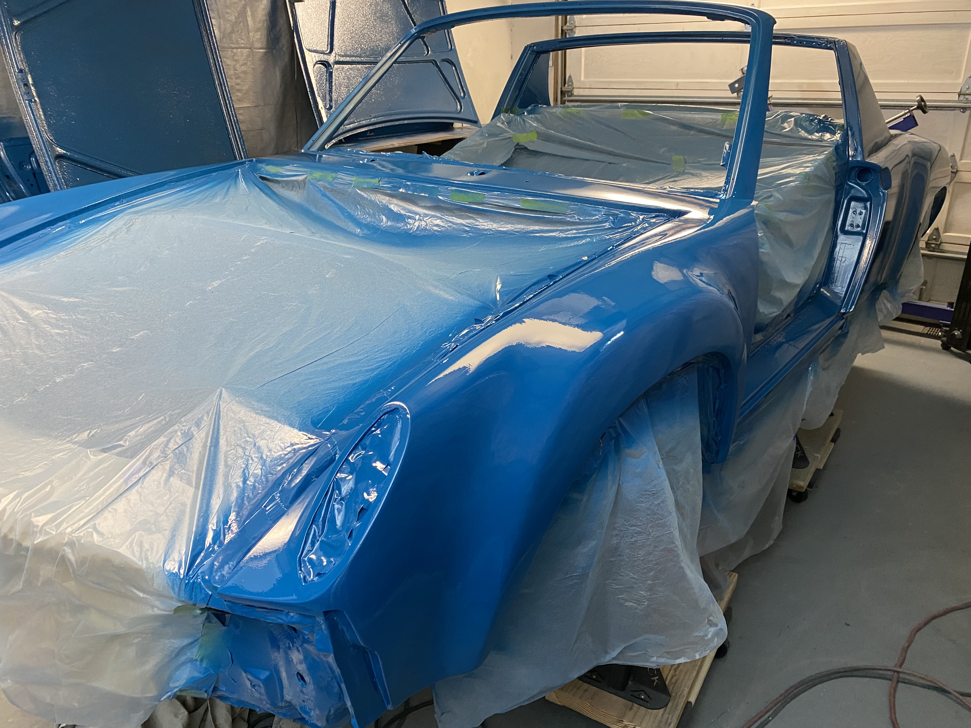

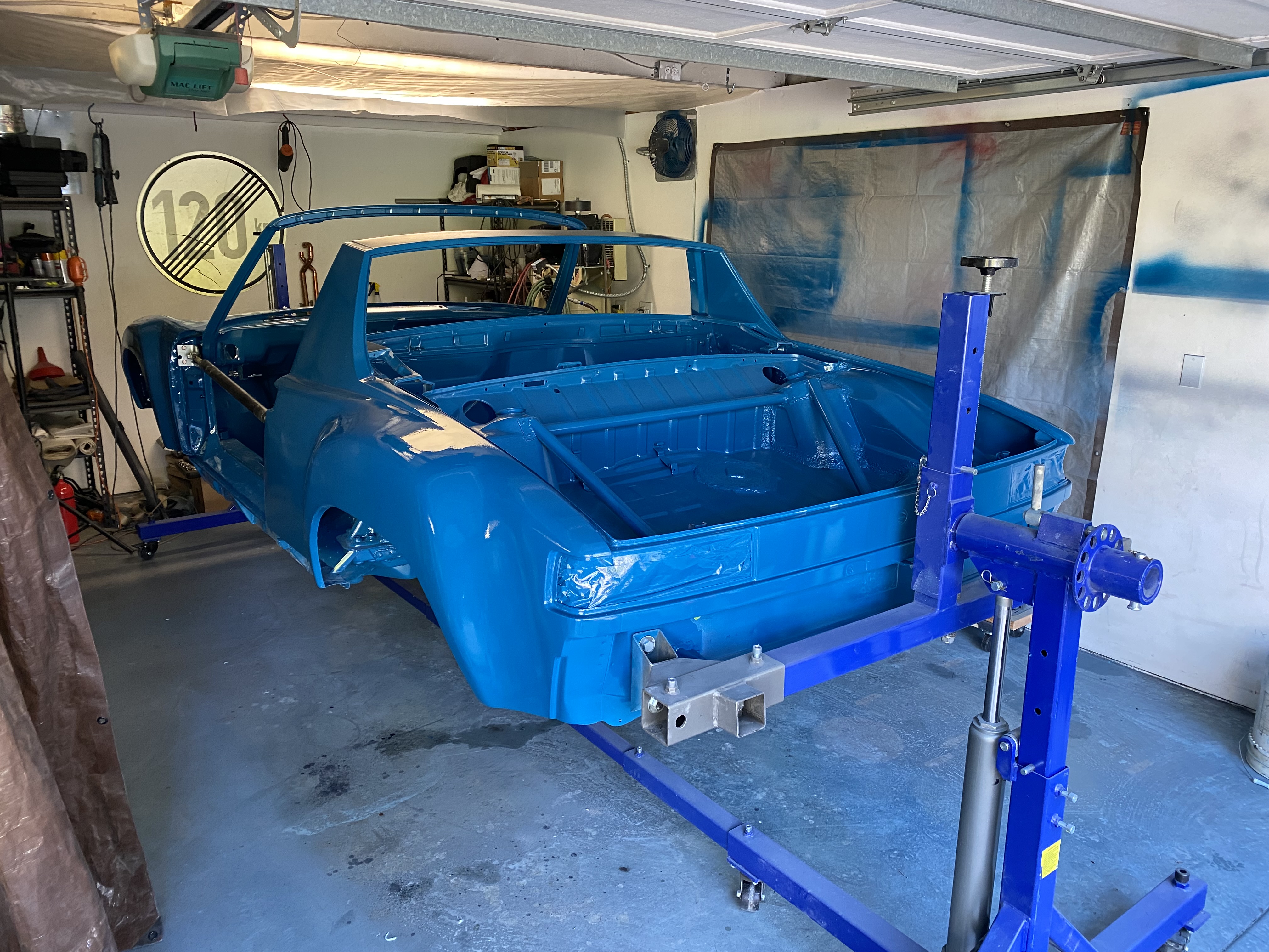

Fresh coat of Blue Turquoise J1.
harlespeed@yahoo.com
post Jul 5 2022, 12:11 AM
JEH
Posts: 24
From: Bay Area, CA
Member No.: 26,046
Digging the color. Ready to start the long process of putting back together.

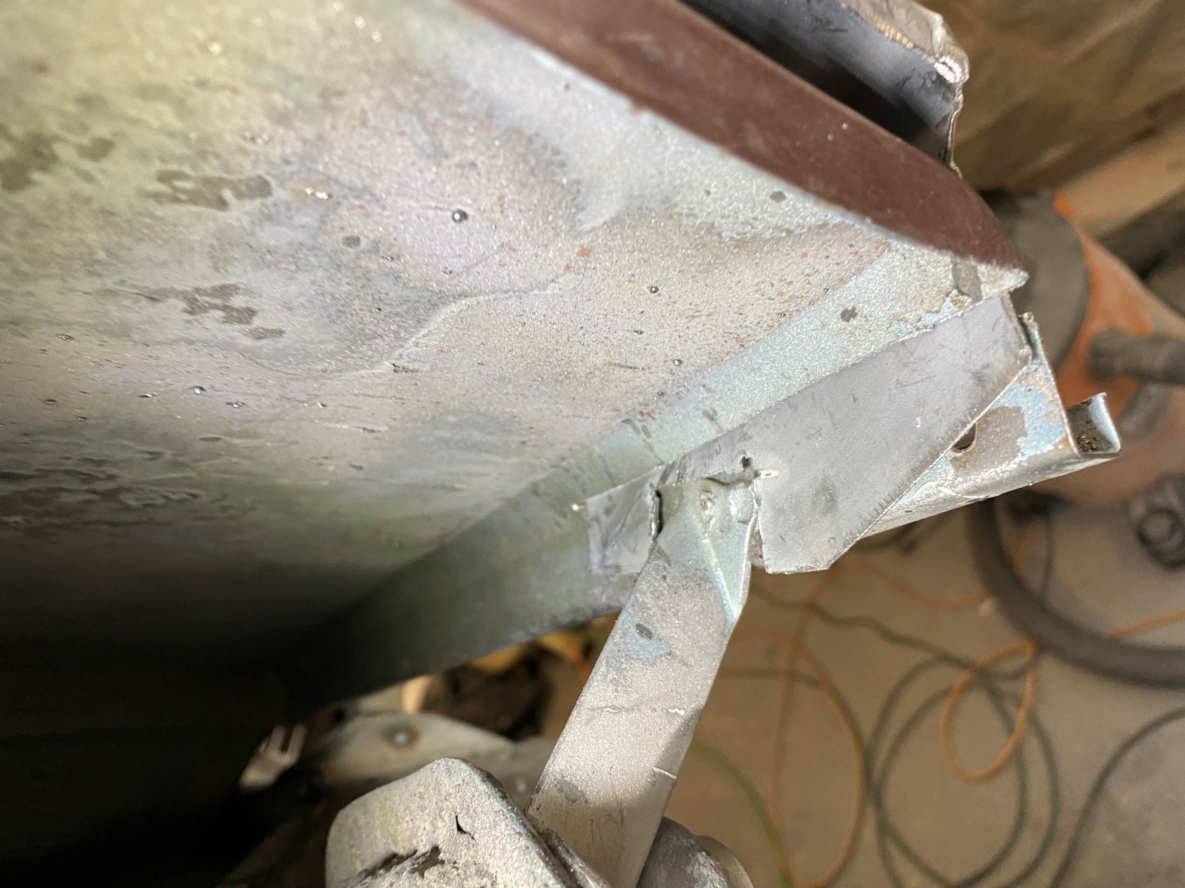

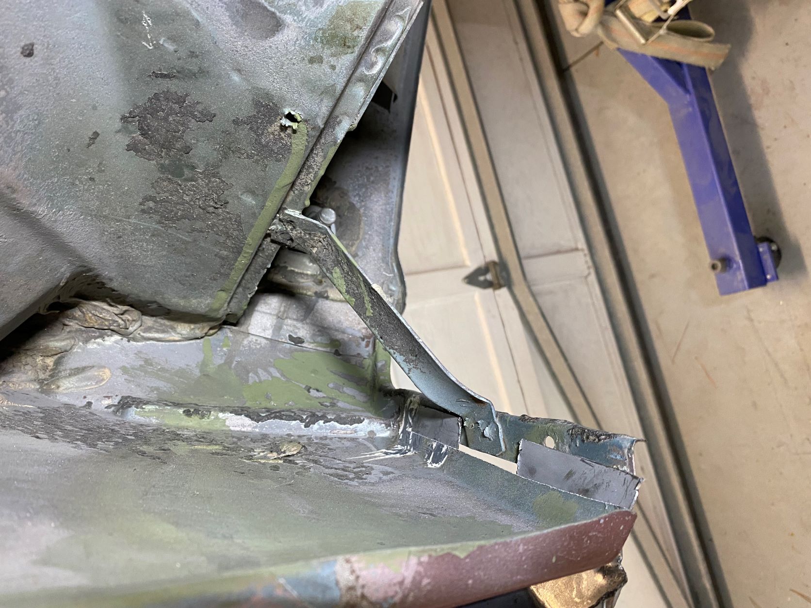

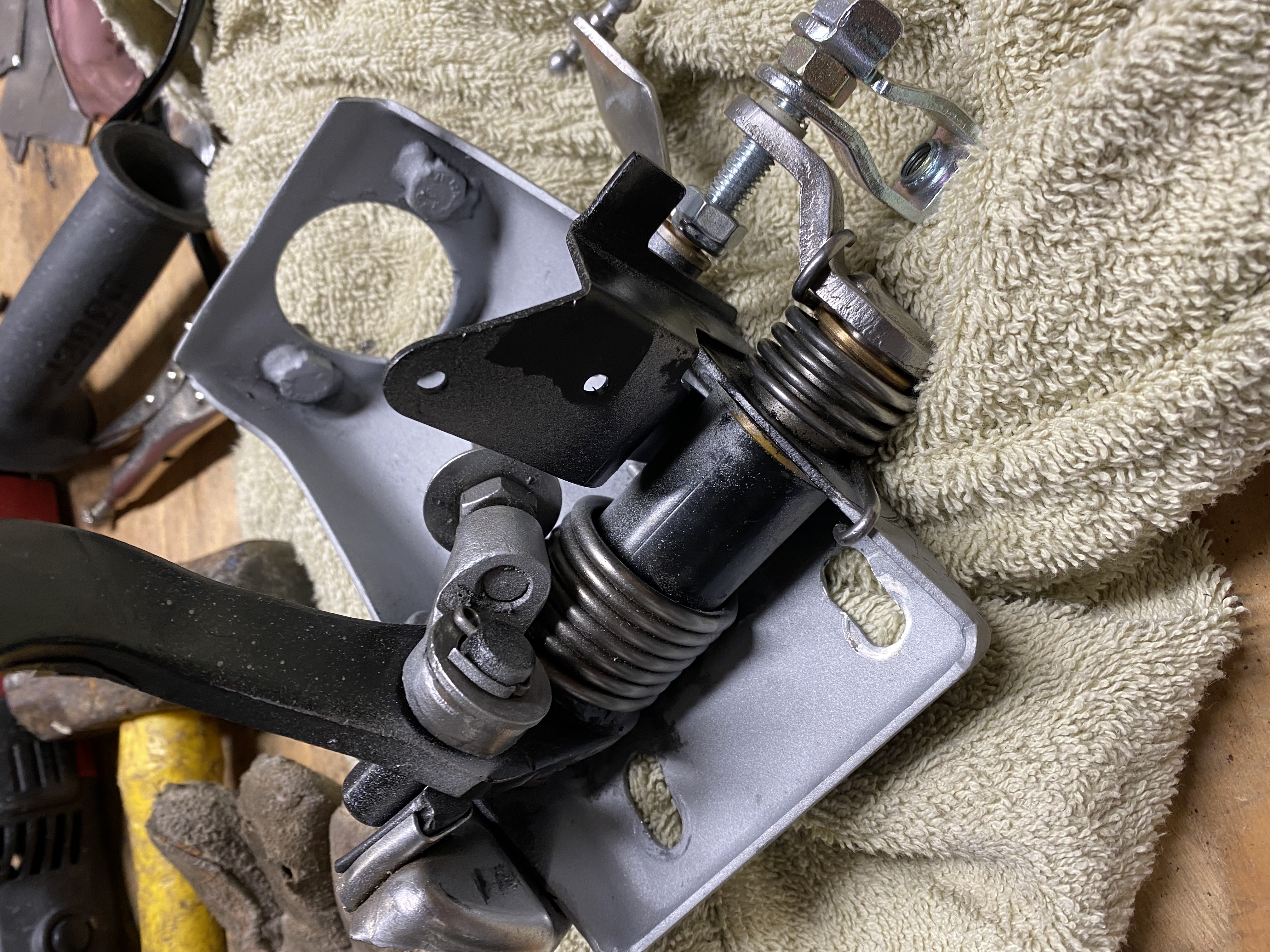

Modified the pedal assembly to attach to a hydraulic clutch. Reversed the clutch pedal spring to return after the pedal is pushed (opposite of how it normally works - it is counter acting the clutch cable).
Requires bending the spring in a vice to reverse it. And drilling a new hole near the bottom of the pedal assembly base.
This is a picture of the pedal assembly unmodified. I will see if I can find the picture with the modification.

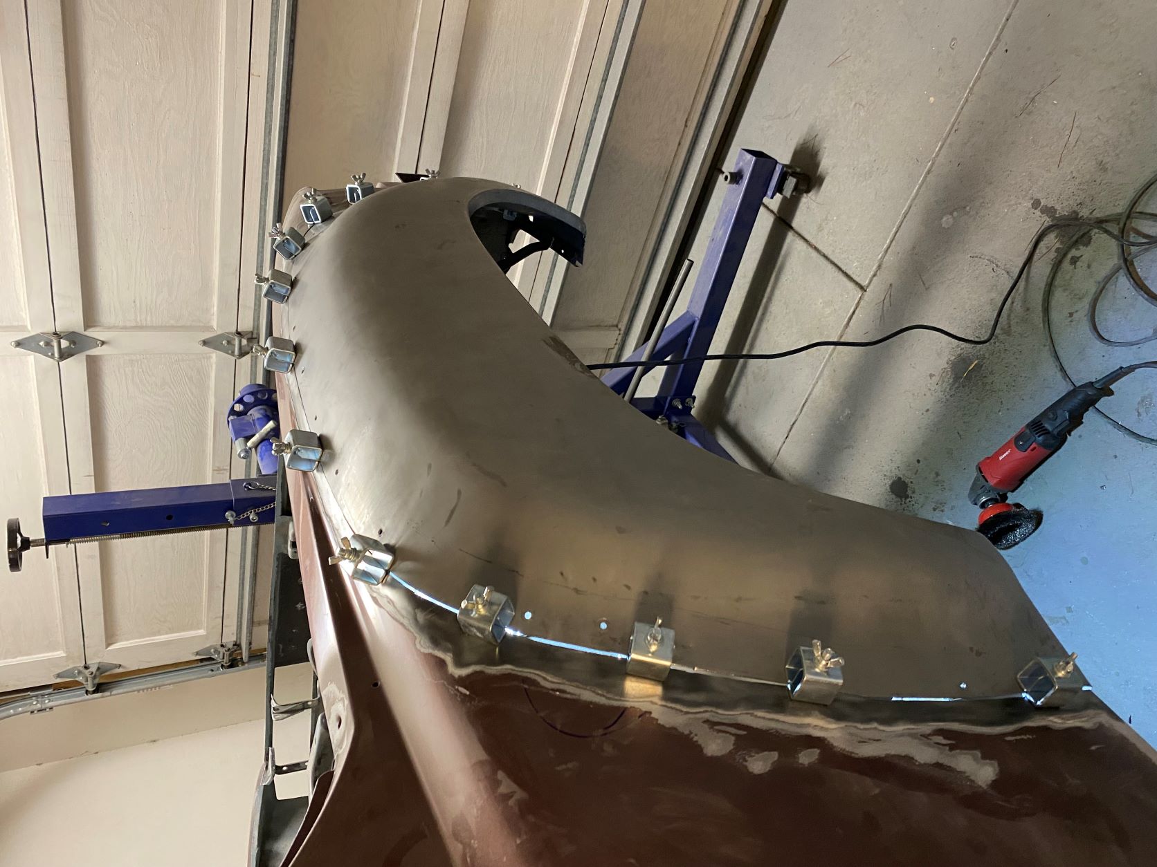

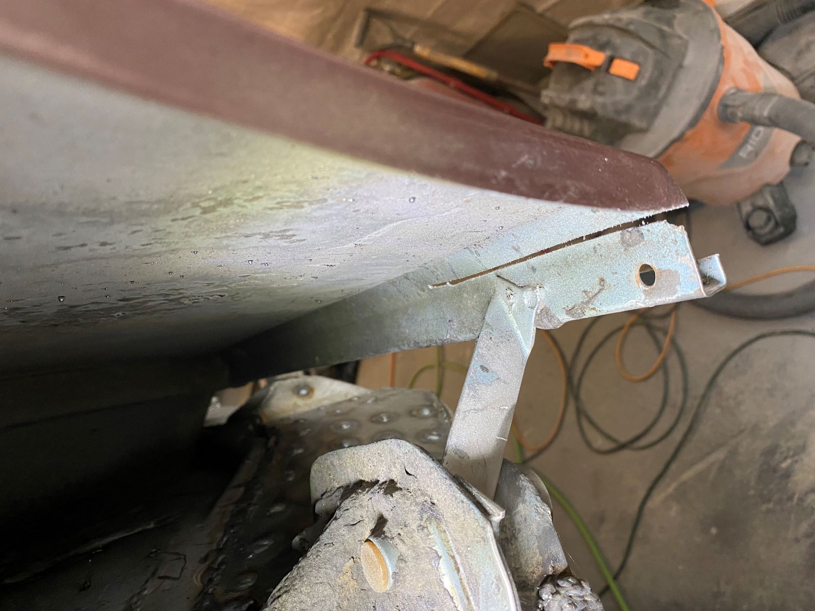

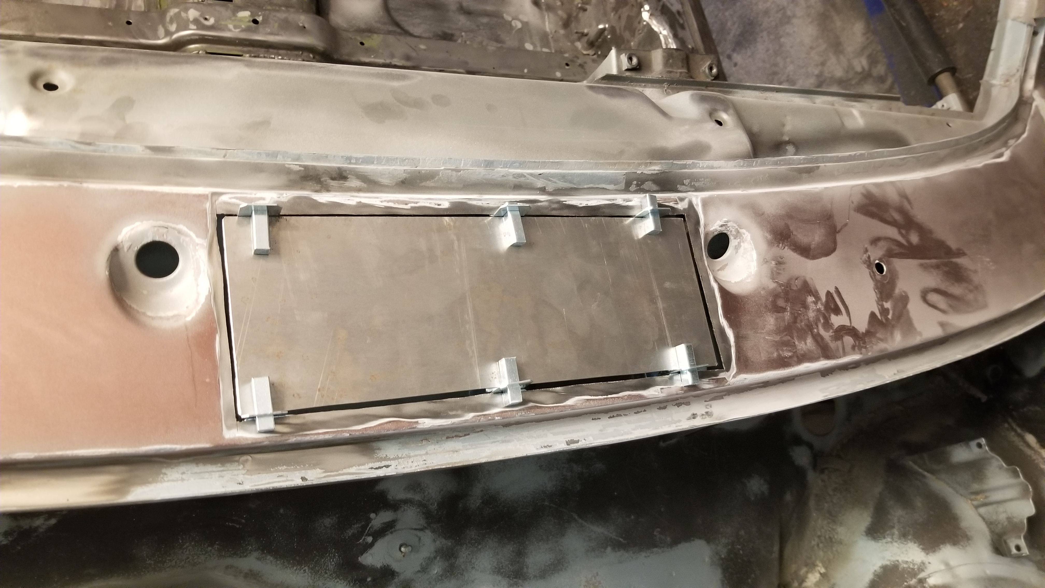

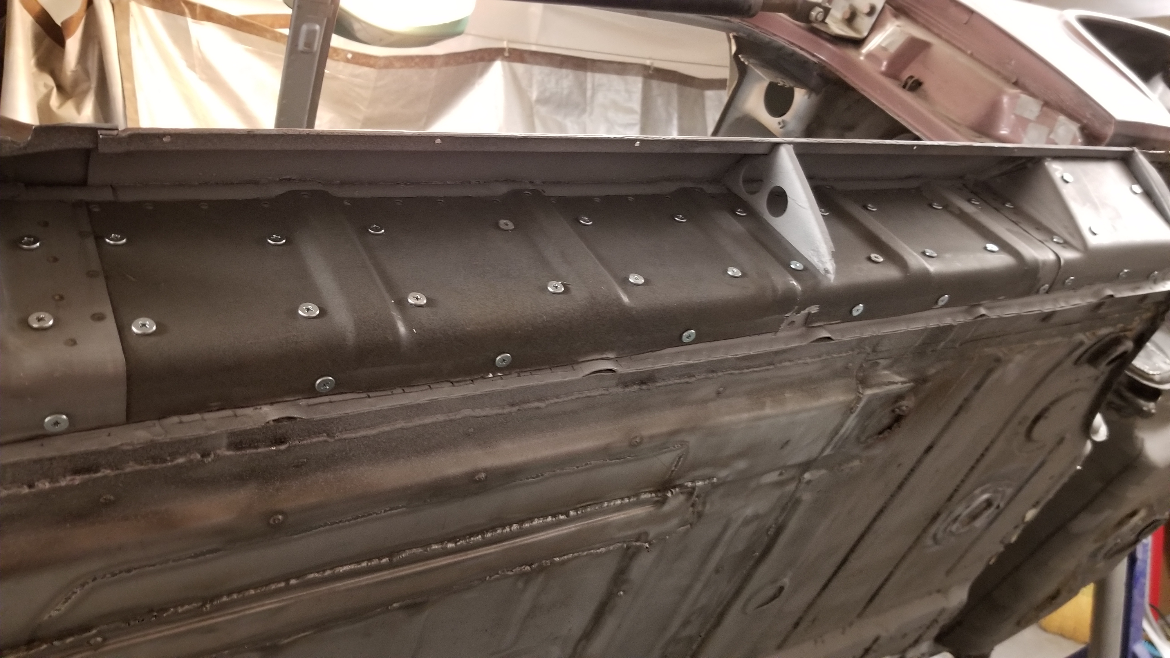

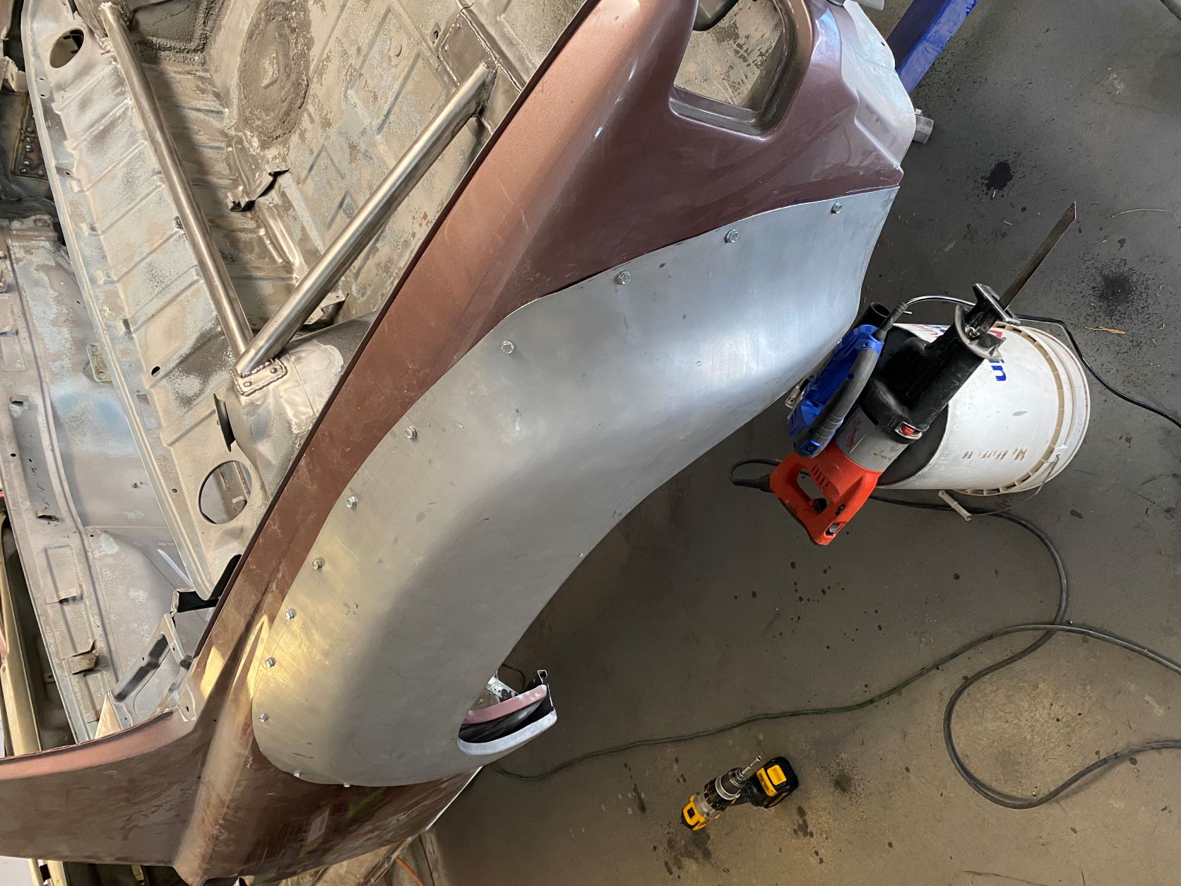

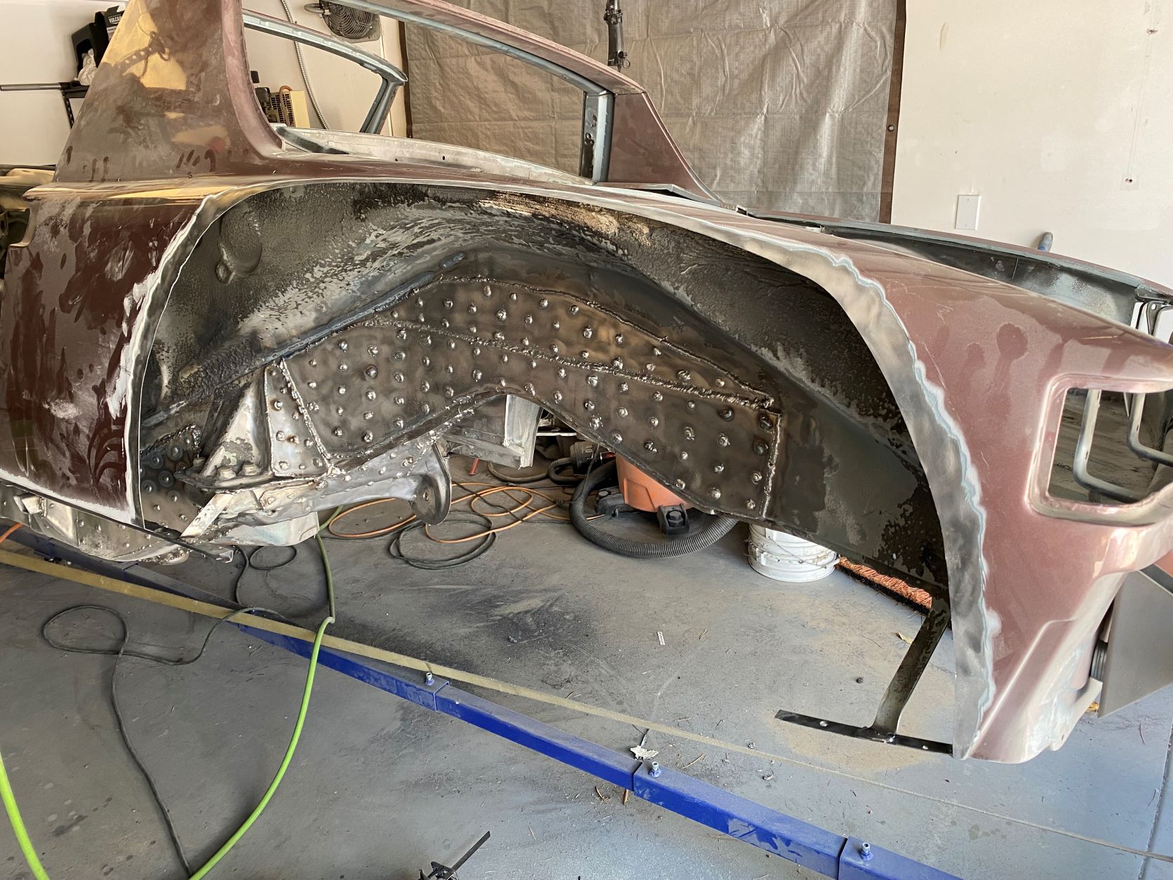

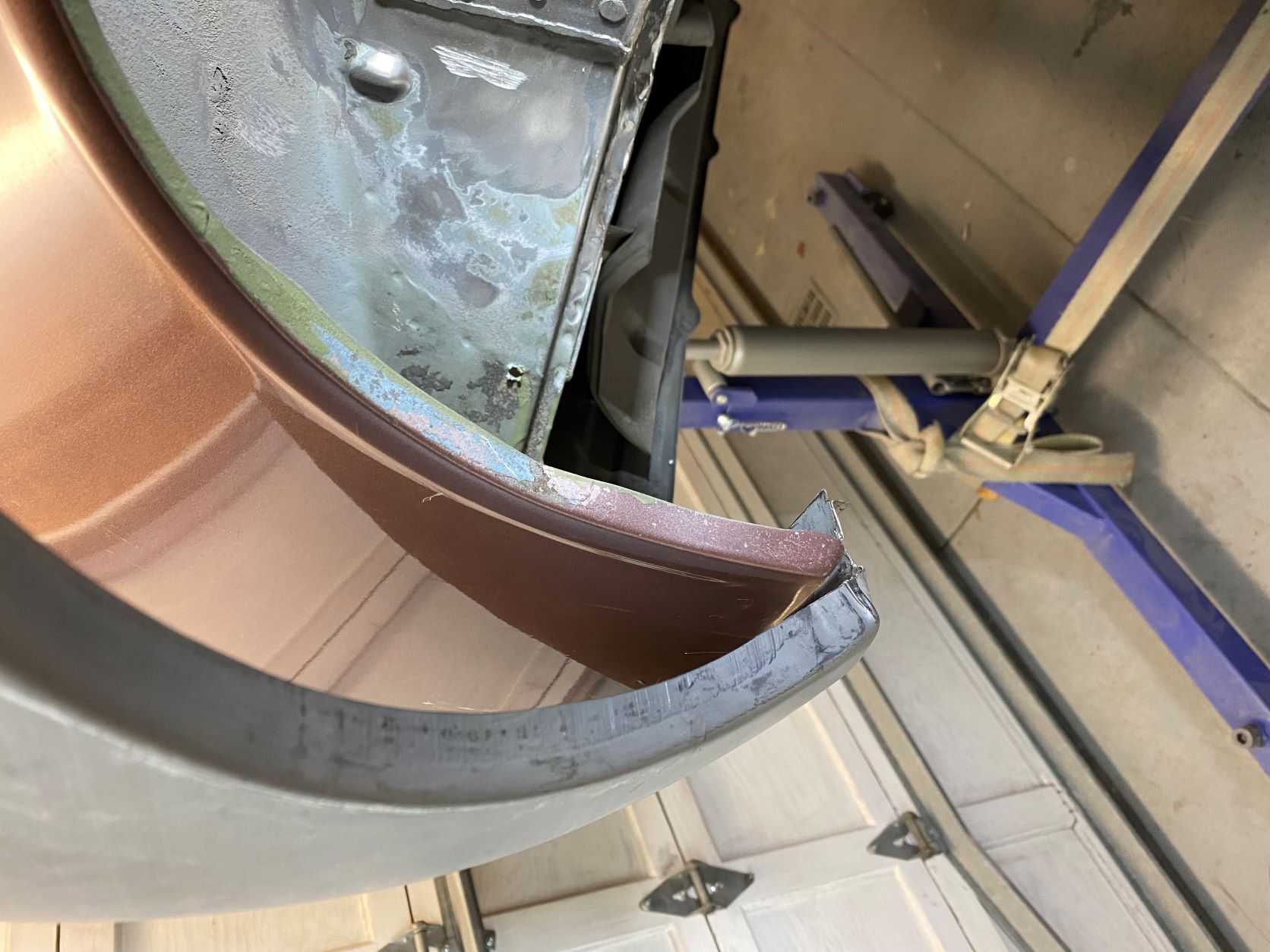

@76-914 , @tygaboy , @Cairo94507 . Thanks for the words of encouragement. Good advise on resizing the pictures, although not sure why the forum software keeps some pics in their correct orientation, and skews others 90 degrees (even though they were uploaded in the correct orientation).
Here are a few (many) pics of the flare installation. I included some detailed pictures of how the flares integrate with the existing body work. In my searches this was not very intuitive and took some digging. Hopefully will help someone visualize more easily in the future.
I have new respect (mind blowing amazement!!) for the folks that have enough talent to weld in flares with all metal and no filler.

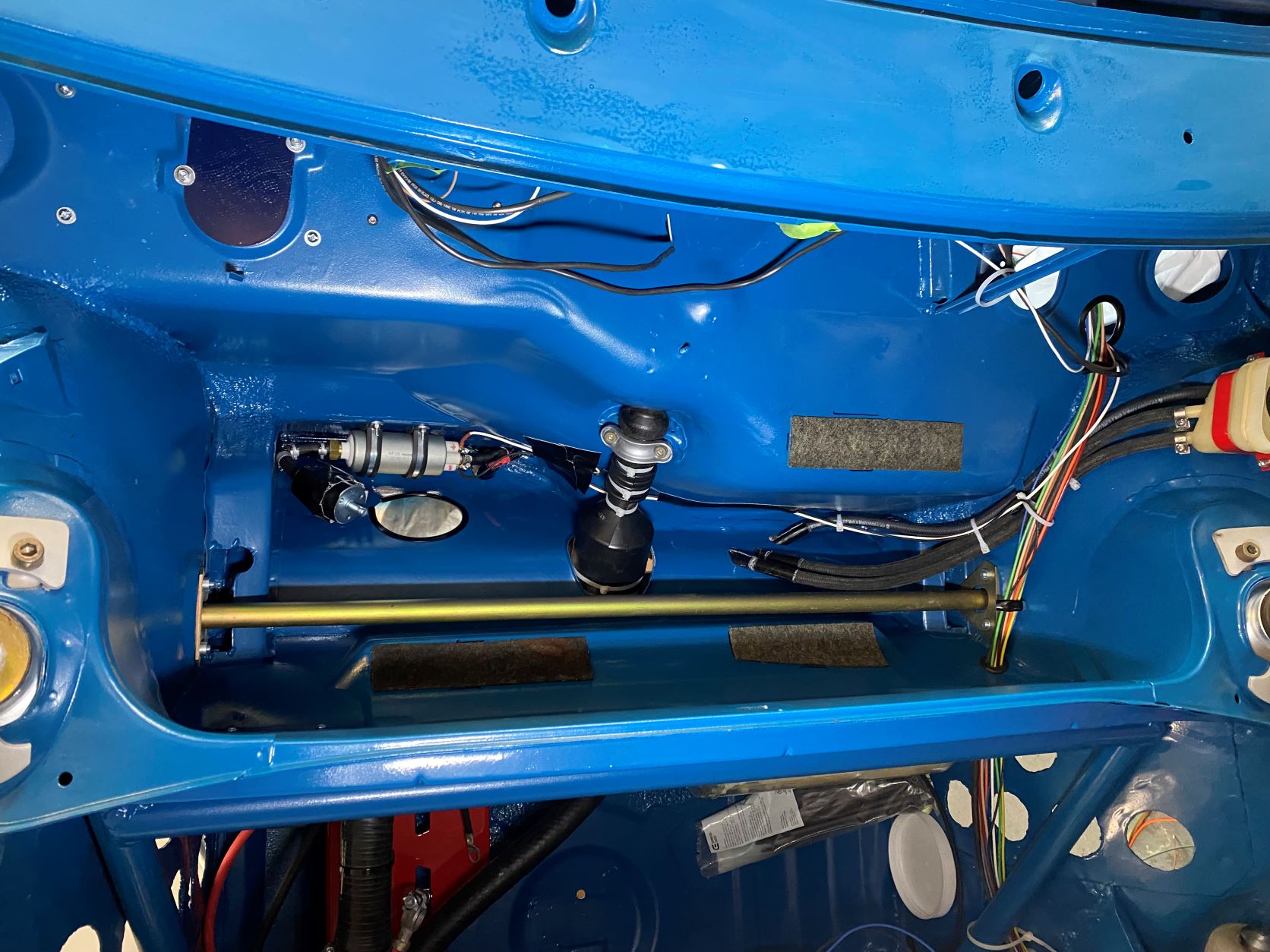

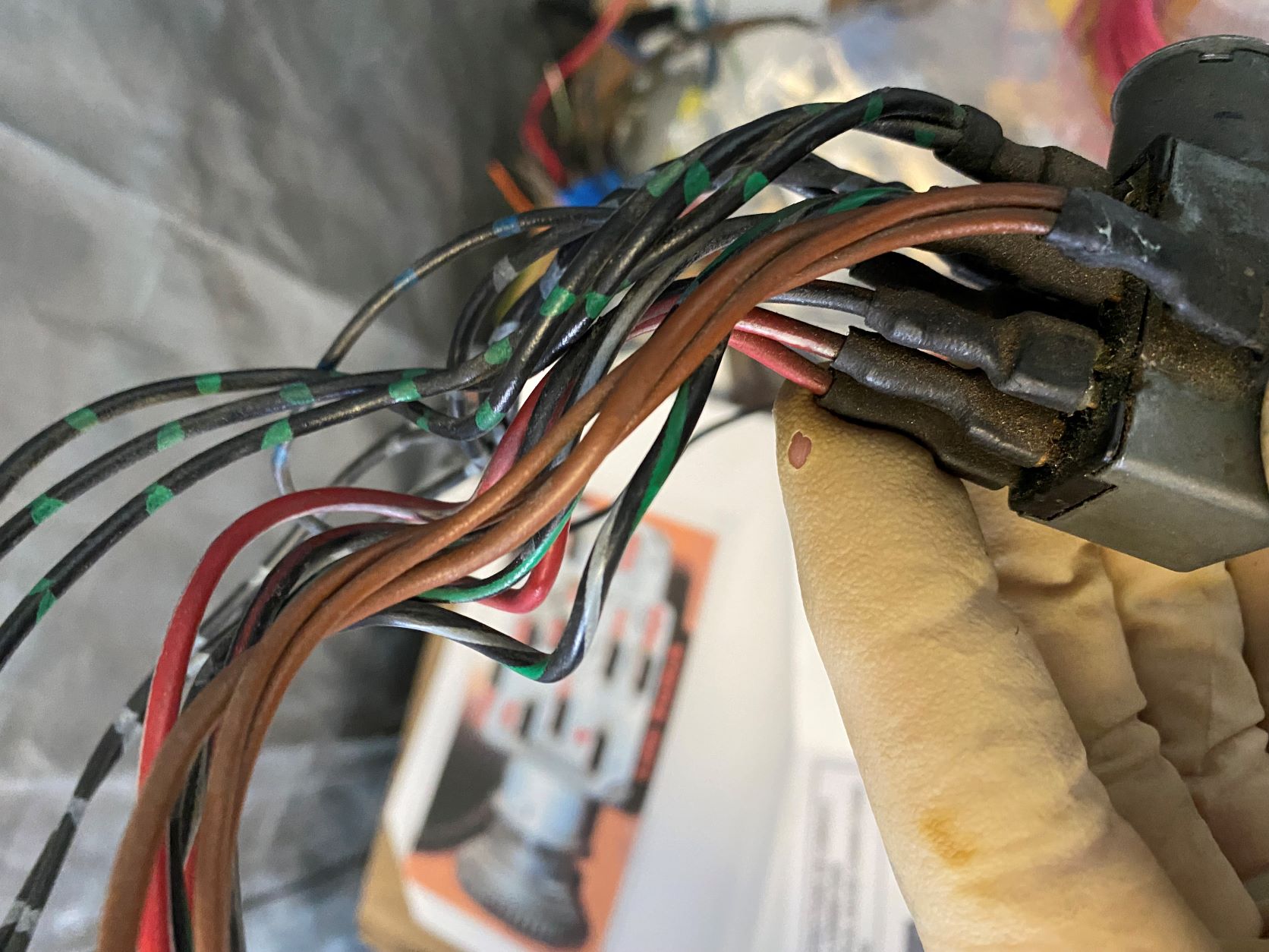

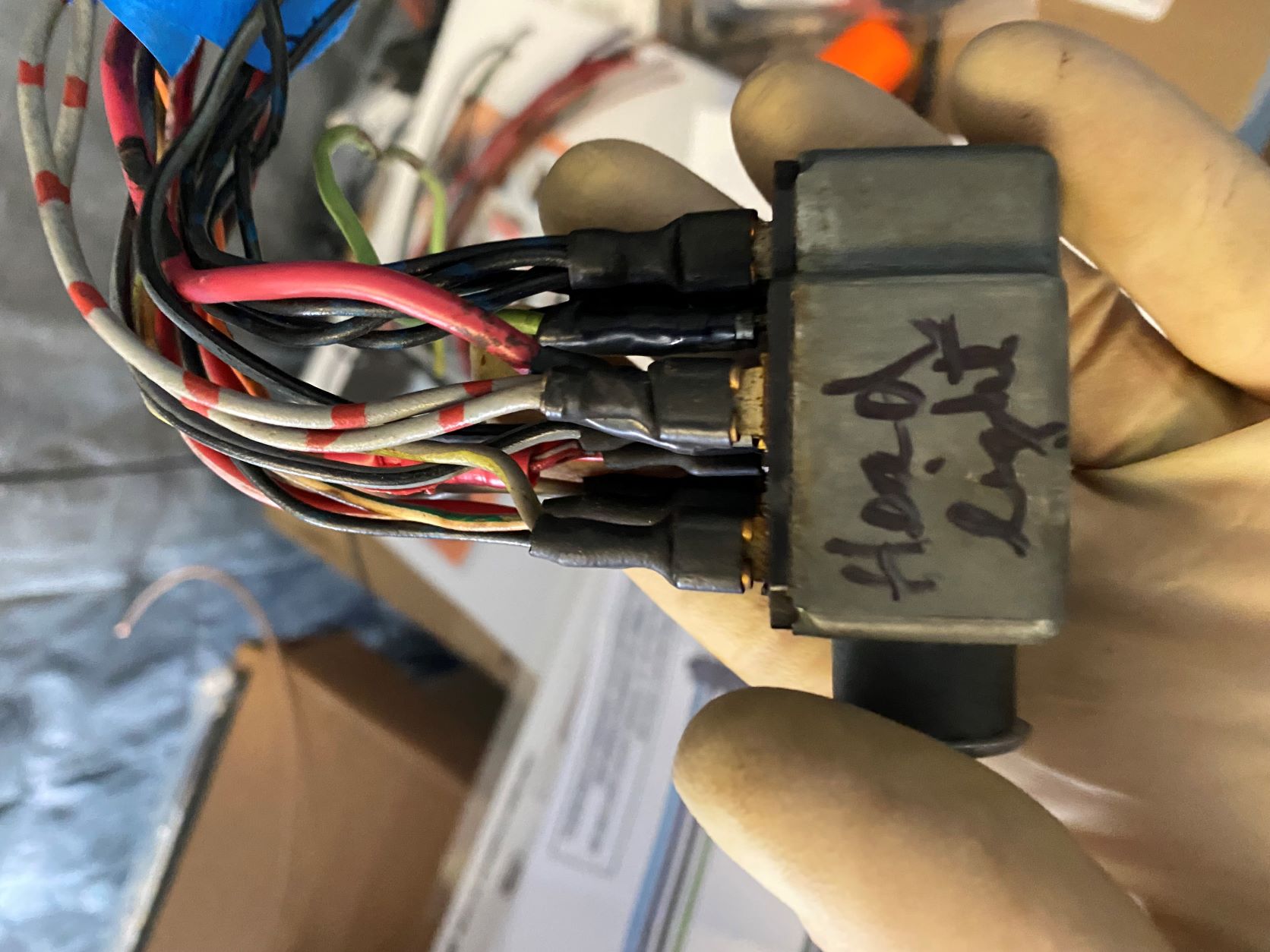

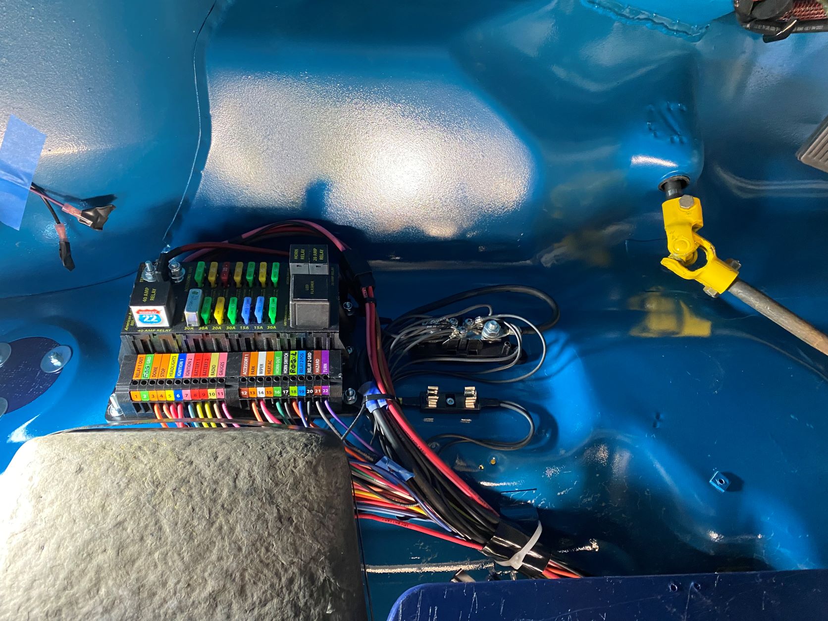

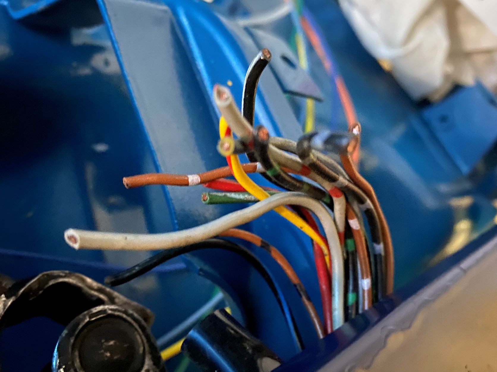

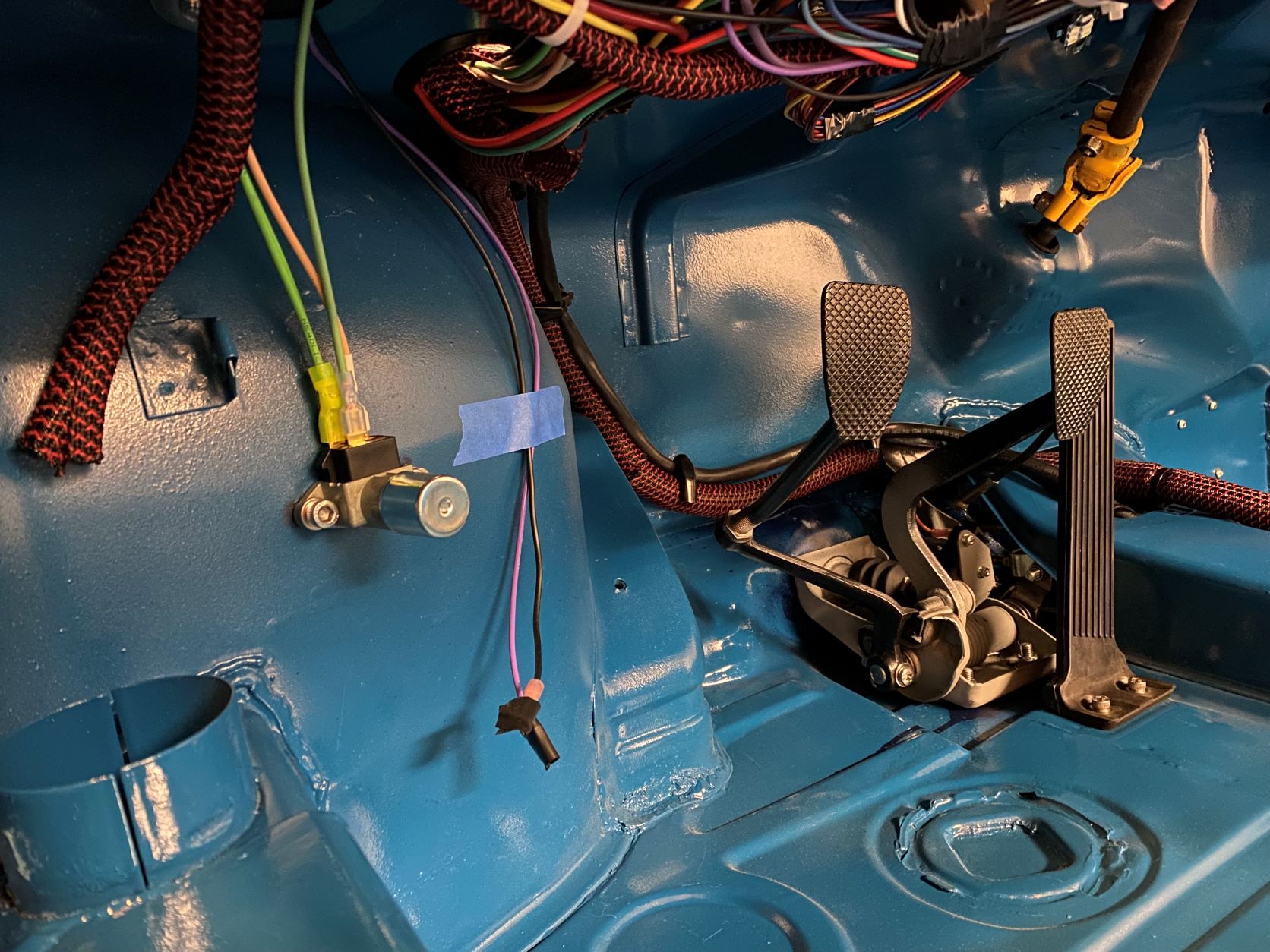

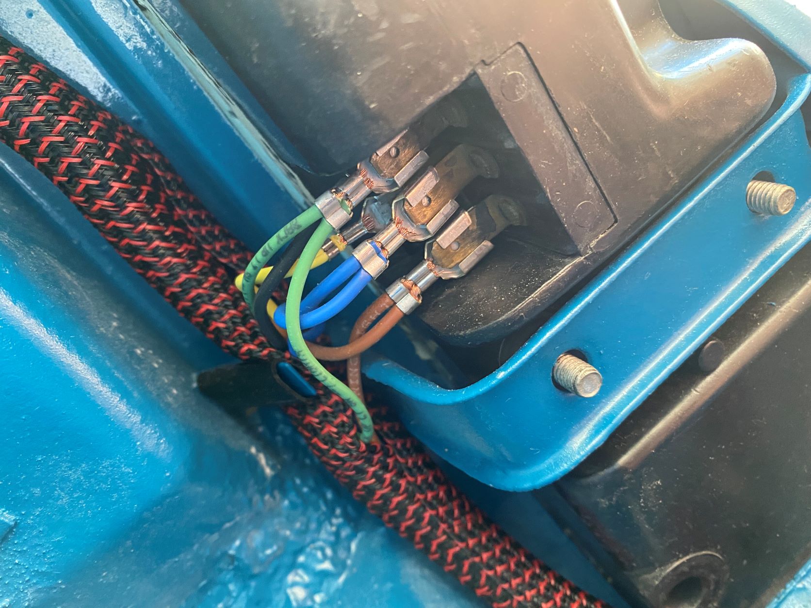

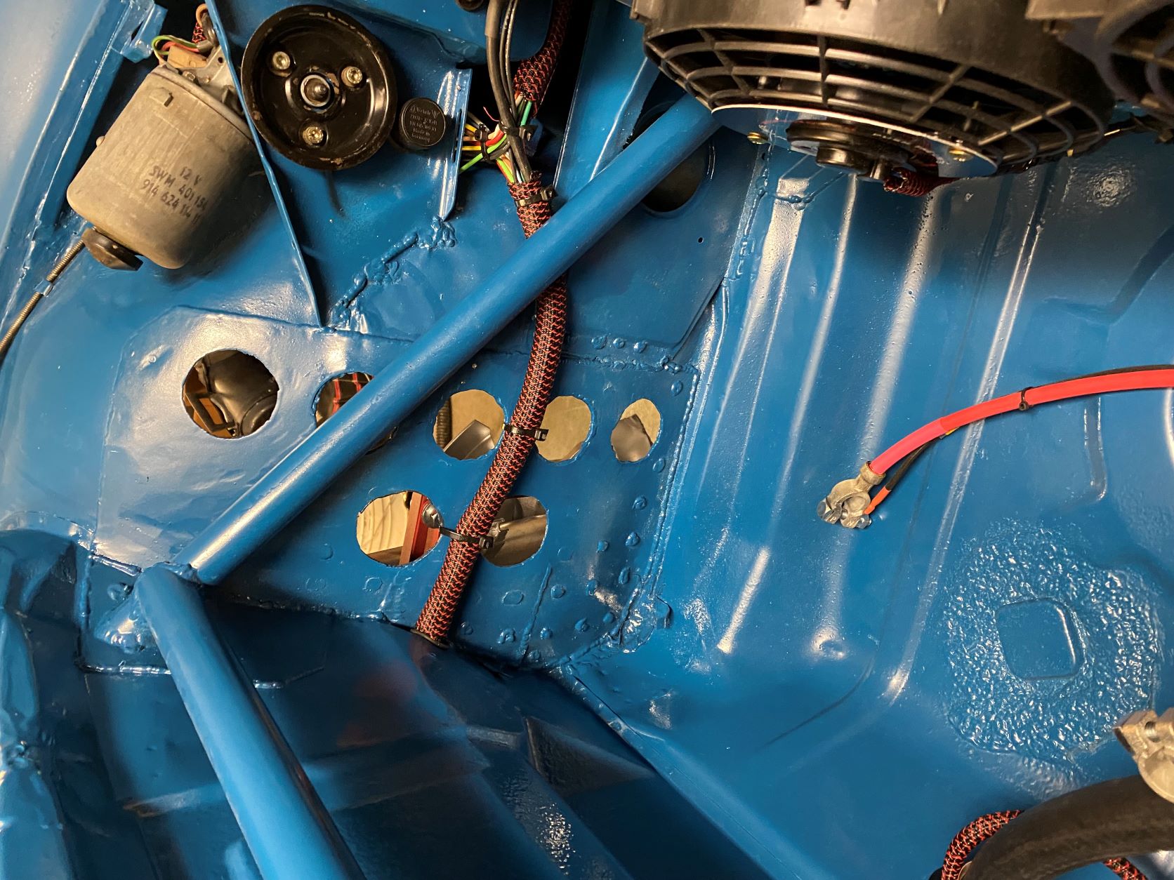

Network wiring pictures. Rewired the entire car including new fuse panel, upgraded LED relay. German car, Japanese engine and trans, American wiring kit designed for a Camaro or Mustang. Really difficult to figure out - kind of like doing this puzzle (IMG:style_emoticons/default/headbang.gif) .
The steering column wiring was the most difficult, figuring out about 20 wires. Every year 914 is different and the configuration of the relays is convoluted and not logical, like they were trying to save money on materials over logic. This makes using the stock headlight switch impossible (I spend many hours and could not figure a way to make the headlights AND the motors work together), as the relays that it depends on are part of the architecture of the stock wiring harness, which is gone.
Between the steering column
The headlight switch
And the hazard light switch, I almost had a nervous breakdown. (IMG:style_emoticons/default/wacko.gif)

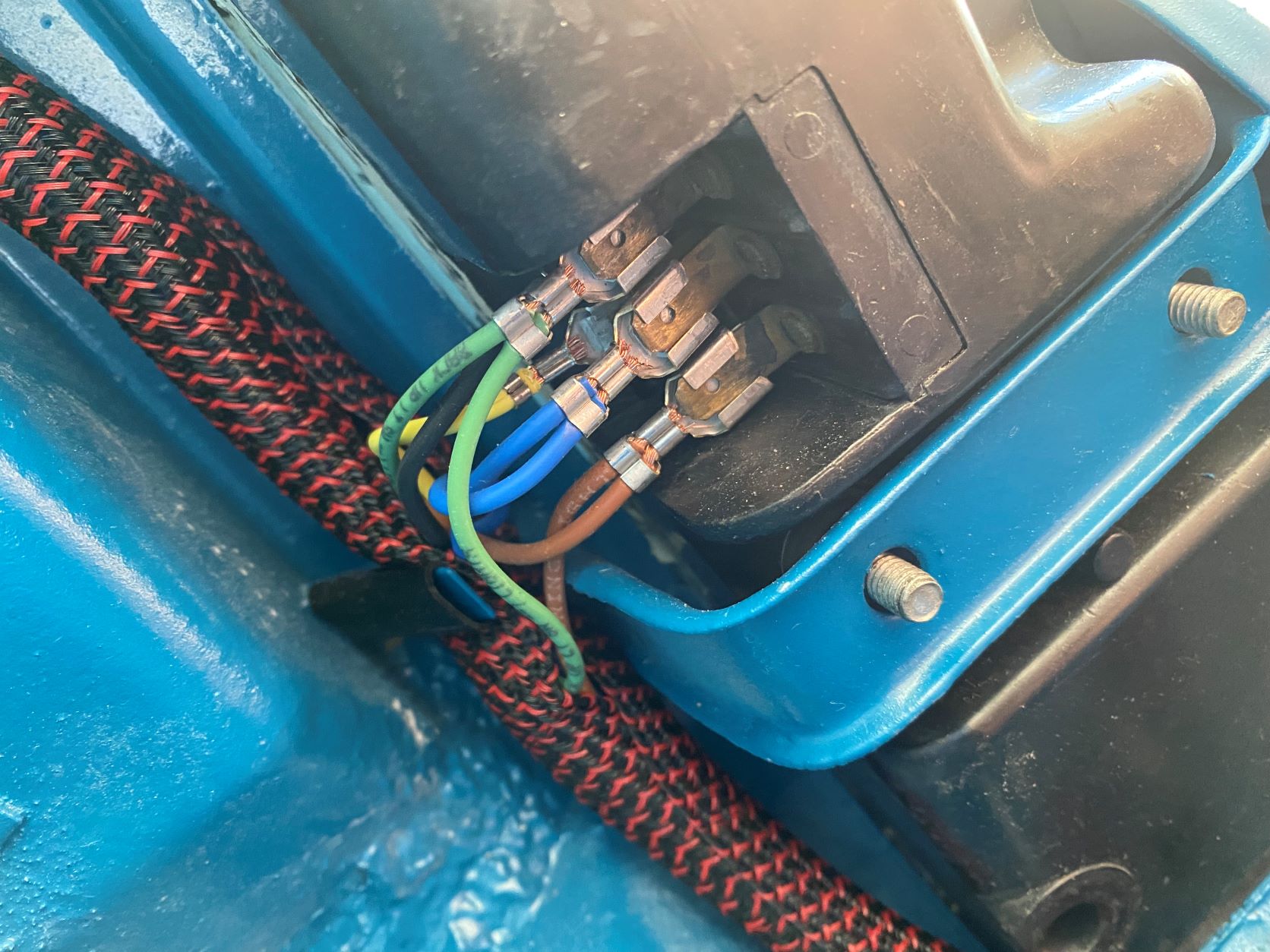

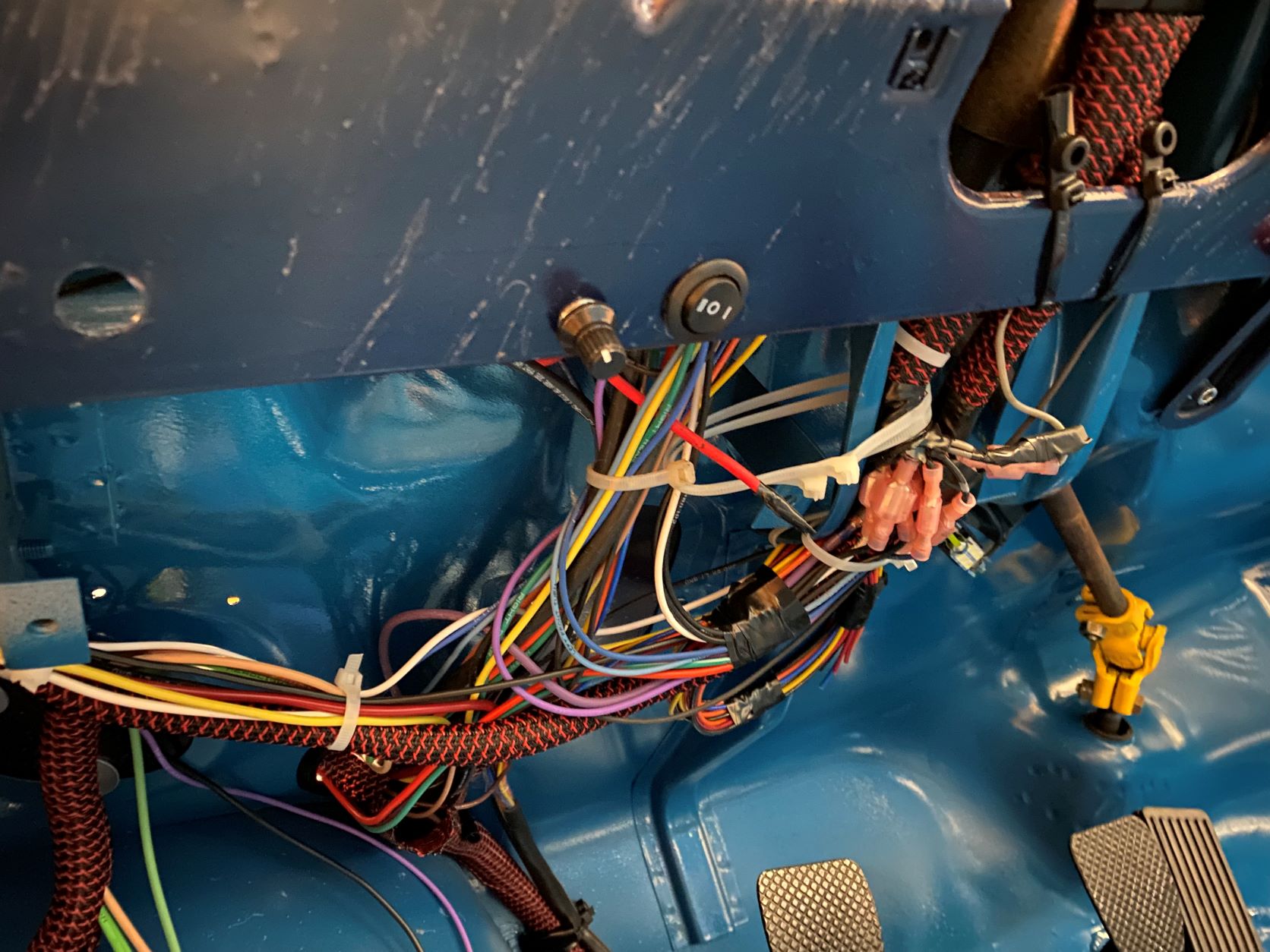

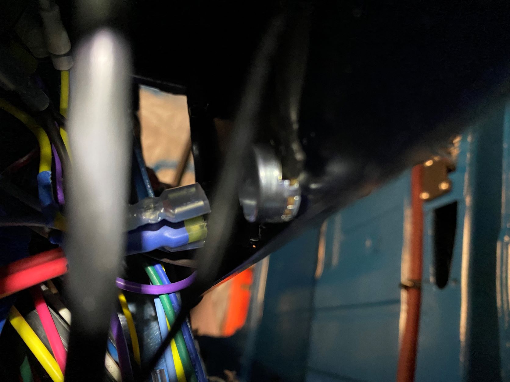

Prospero's Garage color wiring diagram helped A LOT and was about 90% correct - Best $25 I have spent in my life! Trial and error, and scouring the internet. I ended up having to use the GM headlight switch, with floor switch, to operate the high / low beams. I will modify to look mostly stock.
I wired in a separate, hidden, 3 way switch to operate the headlight motors, similar to a home 3 way switch. Most switches are a two stage switch. This one is a right circuit #1, Center Off, left circuit #2. The switch interacts with relays in the headlights, and the #1 raises the headlights, and #2 brings them down, and then they reverse. Works like a dream. Not sure if others have done it, but I thought it was pretty ingenious. 3-way toggle switch on the right in the picture below.
The power feed to the switch comes in from the fuse panel, and then out again to the headlights (red wires) below. Then your white (circuit #1) and yellow (circuit #2) completes the circuit to raise or lower the headlights. Either can be on either outside connector.

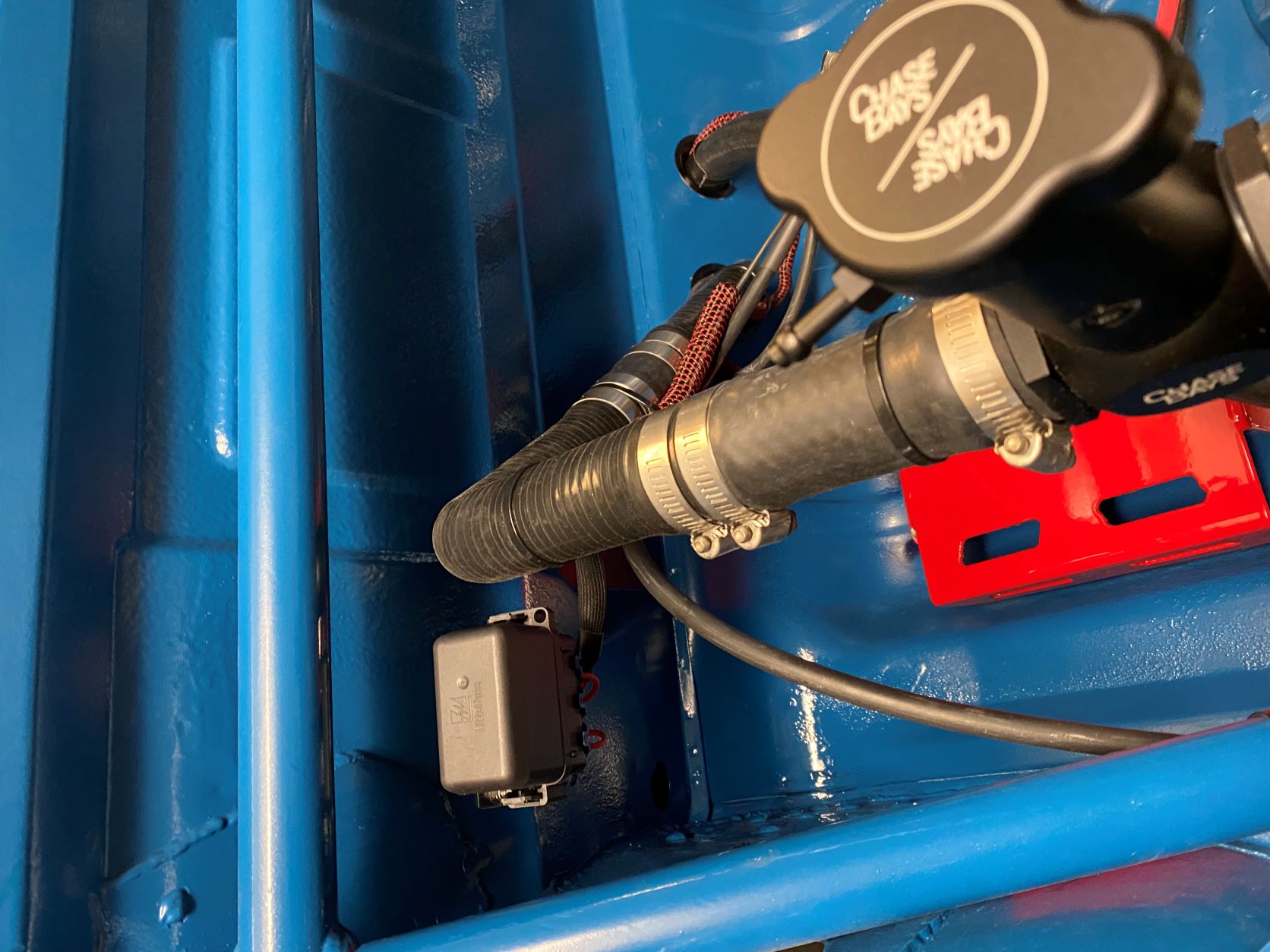

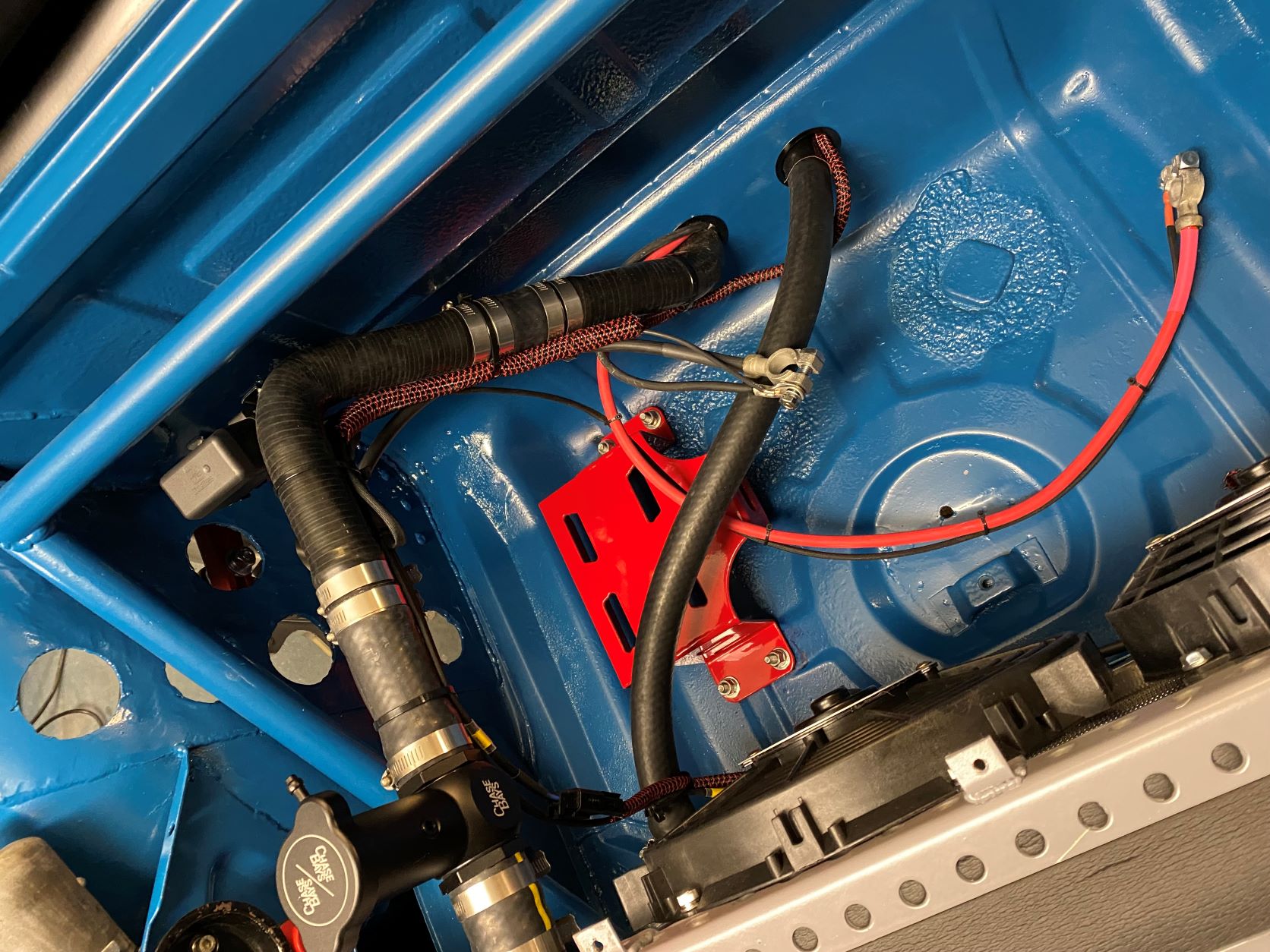

Wired up fuel pump.
DynaBat Battery holder and dedicated fan relay in front trunk.
Fuse panel tucks up under dash on passenger side, behind the glove box.
Encased everything in wire loom. Note the picture below, the blade connectors were shrink wrapped after the picture was taken.
