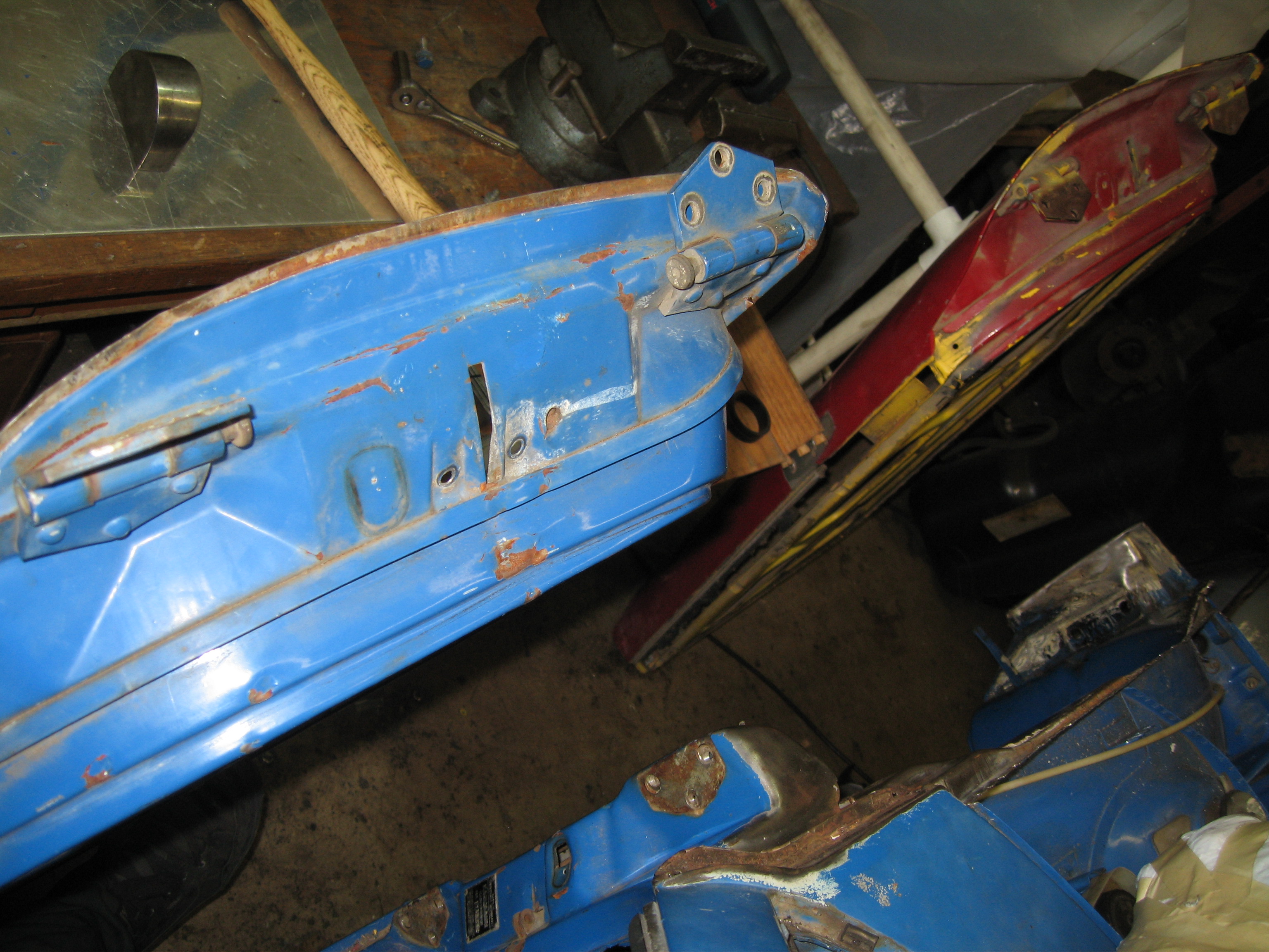

QUOTE(SirAndy @ Aug 3 2022, 01:00 PM) *
Always only seen fully painted on original cars ...
looking closely at blue six on previous page it looks like blue paint around edges of top of pin. as if it was painted all over but perhaps has had pins driven out or paint has come off tops of pins.
maybe the 6s were all painted originally?

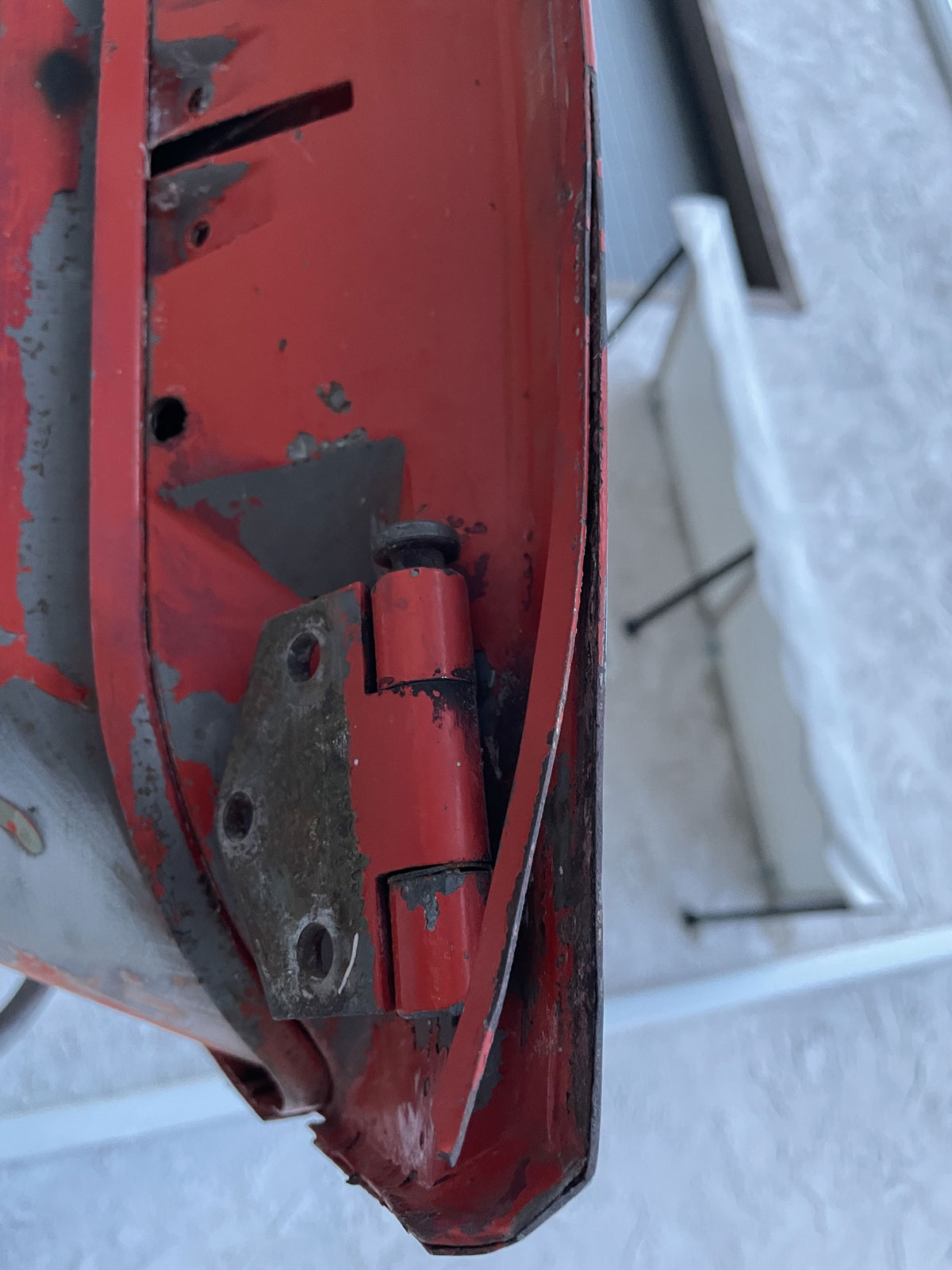

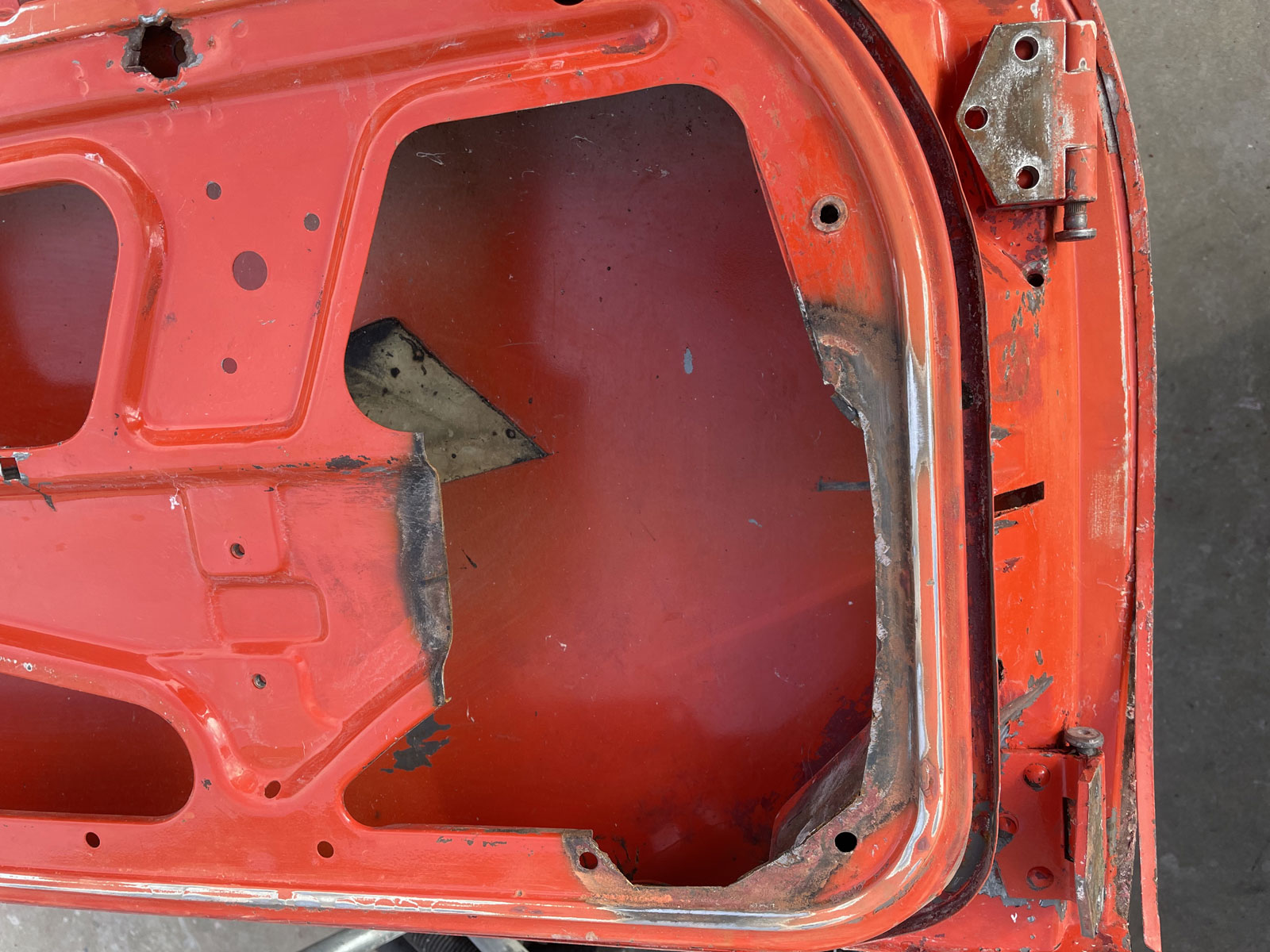

The car I've been working on is pretty early, 987th car built, November 69 chassis number. I'm working on the doors. I stripped the paint using Citrus Strip which doesn't take the original paint off very well, and the is no orange on the pins.

The doors appear to be original.
That door was painted 3 times after the factory — 1 time Tangerine, and then red and then a lighter red.
However, after stripping, the original orange paint was evident on the door bolts but not the pins which is consistent with rest of the cars shown in this thread (except the 6 that is highly suspect on account of it having overspray on the rubber seal).
One could say that any car could have had the doors taken off at the pins and the paint chipped off and then reinstalled. It's unlikely in my mind that plasma torch wielding car audio installers did anything to the door pins on this car (IMG:style_emoticons/default/biggrin.gif)

the blue six on previous page has blue paint around the edges of the hinge pin.
and there is SKL1's car.
definitely later 914s are not painted there.
there are enough real original condition cars to say that for certain.

My 4/72 build date 72 was never painted (after the factory). The pins are unpainted, the door bolts are painted.
The later cars (my 72) have pointed end door bolts but my 70 and 71 have flat end "regular" door hinge bolts. Possibly this could indicate the doors were taken off then put back on at the factory, Idk.

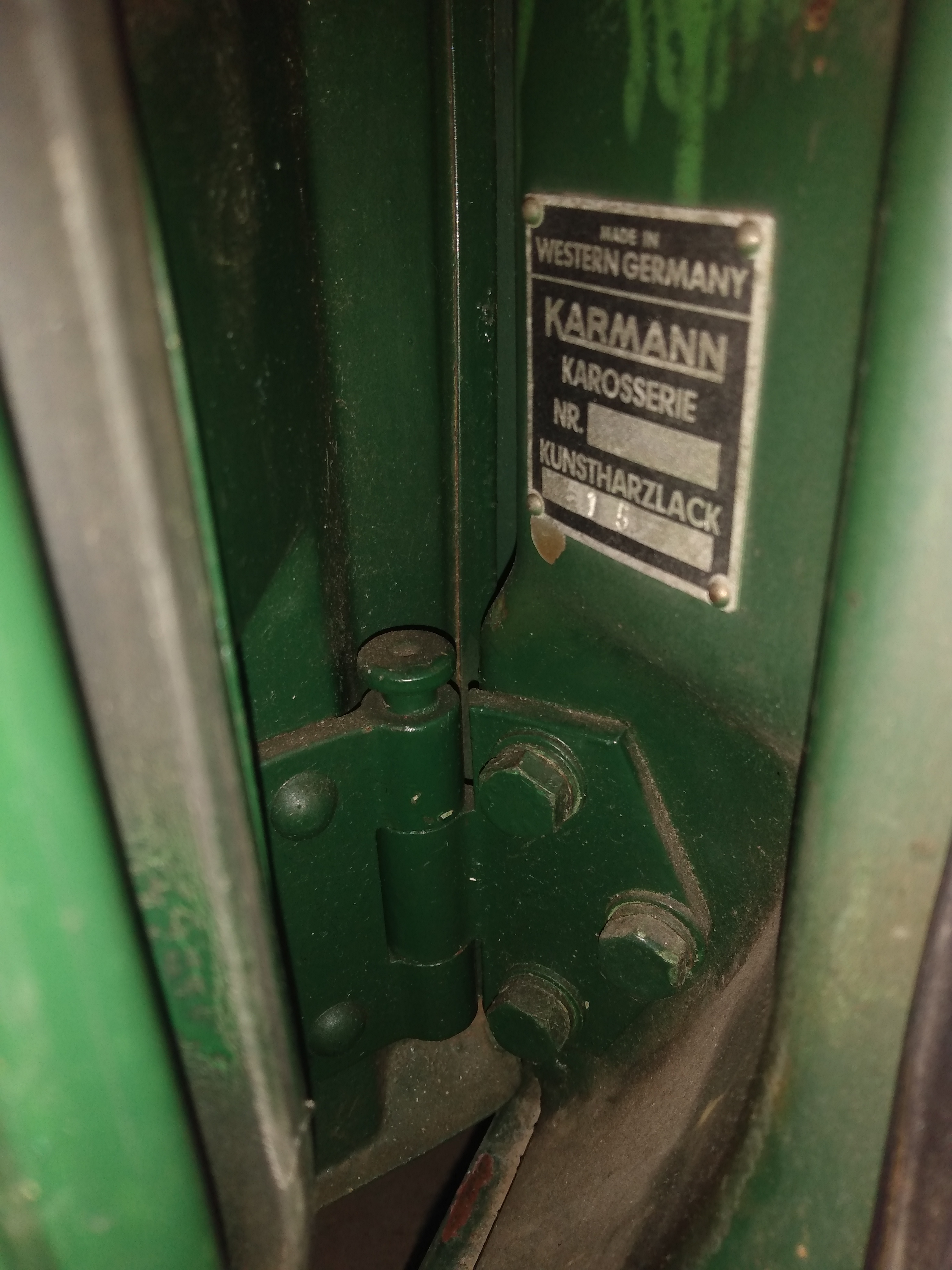

here is a 72 just up on BAT.
inners all looked to be factory original paint on it.
wonkipop

had a good look in 912 section of BAT.
managed to find a couple of cars that looked in the main unrestored with original paint on inners.
bit hard to find as most 912s have been restored, in some cases several times over.
looks reasonably certain that karmann were painting hinge pins in the 60s when doing these porsche bodies.
this one looks at first glance to be unpainted hinge pin, but close look you can see paint on edge of pin top.
