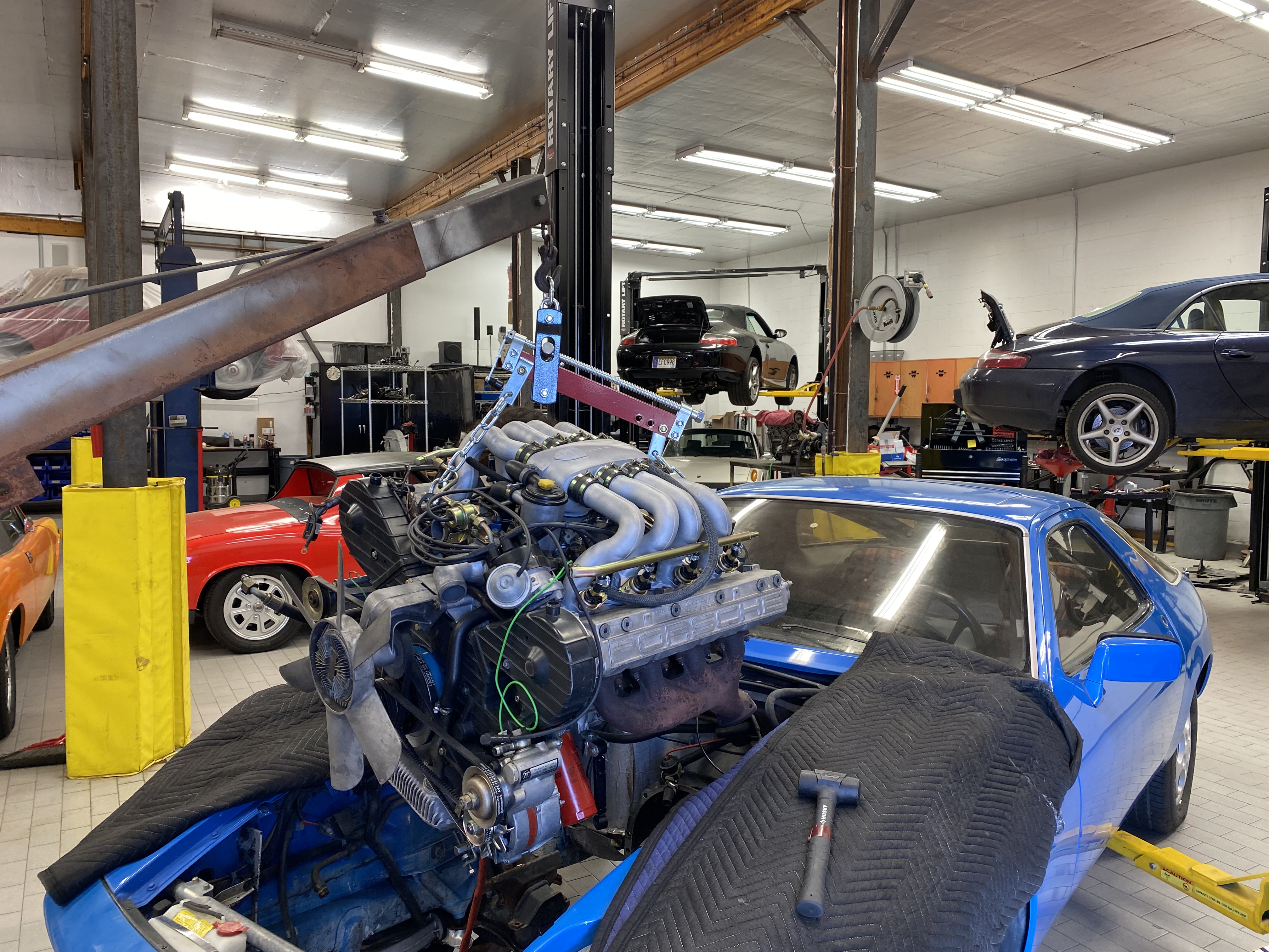

yup installing the rebuilt engine in our front engined 914(the hammer is for a bit of persuation!! (LOL) Attached Image
