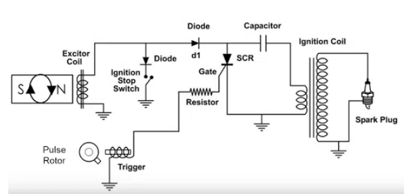

To answer OP's question. VIntage CDI not easily tested DIY. Due to components inside the box (vintage switching components SCR/thyristor/transistors, and aging capicitors) CDI is subject to instantaneous failure just like any electronics on modern vehicles. Even if it tests OK today, a vintage component inside the box may fail tomorrow. If it were me, I'd replace the 50 year old part, putting it aside for someone concerned about originality, and replace with a more modern CDI that doesn't have 50 years of age / use on it. Modern electronic components like SCR's/Thyristors/Transistors/MOSFET's are generally more robust & durable than vintage components that perform the same function.
Here is a simplified schematic of what a CDI is (this is a motorcycle application with the stator supplying excitation to charge the capacitor)
If this diagram has no meaning to you - move on. DIY testing is not for you.
If you want more info on actual Bosch CDI start at this link for more info.
http://forums.pelicanparts.com/porsche-911...schematics.html
