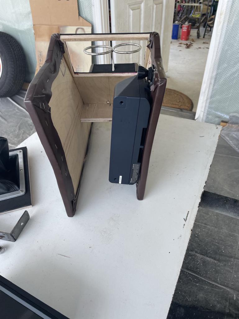

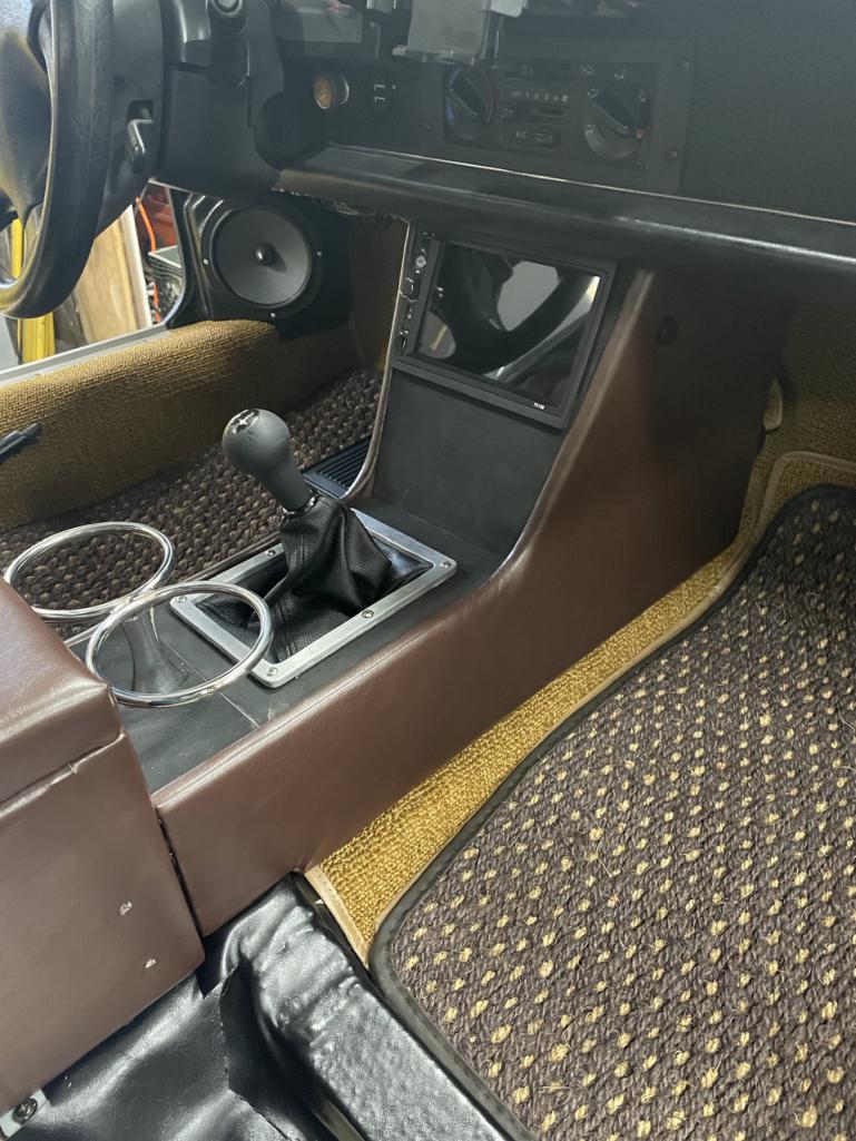

chmillman   Has anyone ever tried mounting the Pioneer TS-WX01...   Aug 17 2024, 09:32 AM
chmillman   Has anyone ever tried mounting the Pioneer TS-WX0...   Aug 17 2024, 09:33 AM
East coaster   I put mine inside my center console. That said, it...   Aug 17 2024, 03:07 PM
chmillman   Quoting myself... So, yes, it does fit in a sto...   Sep 3 2024, 10:53 AM
drdriddle   I choose the less hidden route…and I realize itâ...   Sep 3 2024, 11:34 AM
