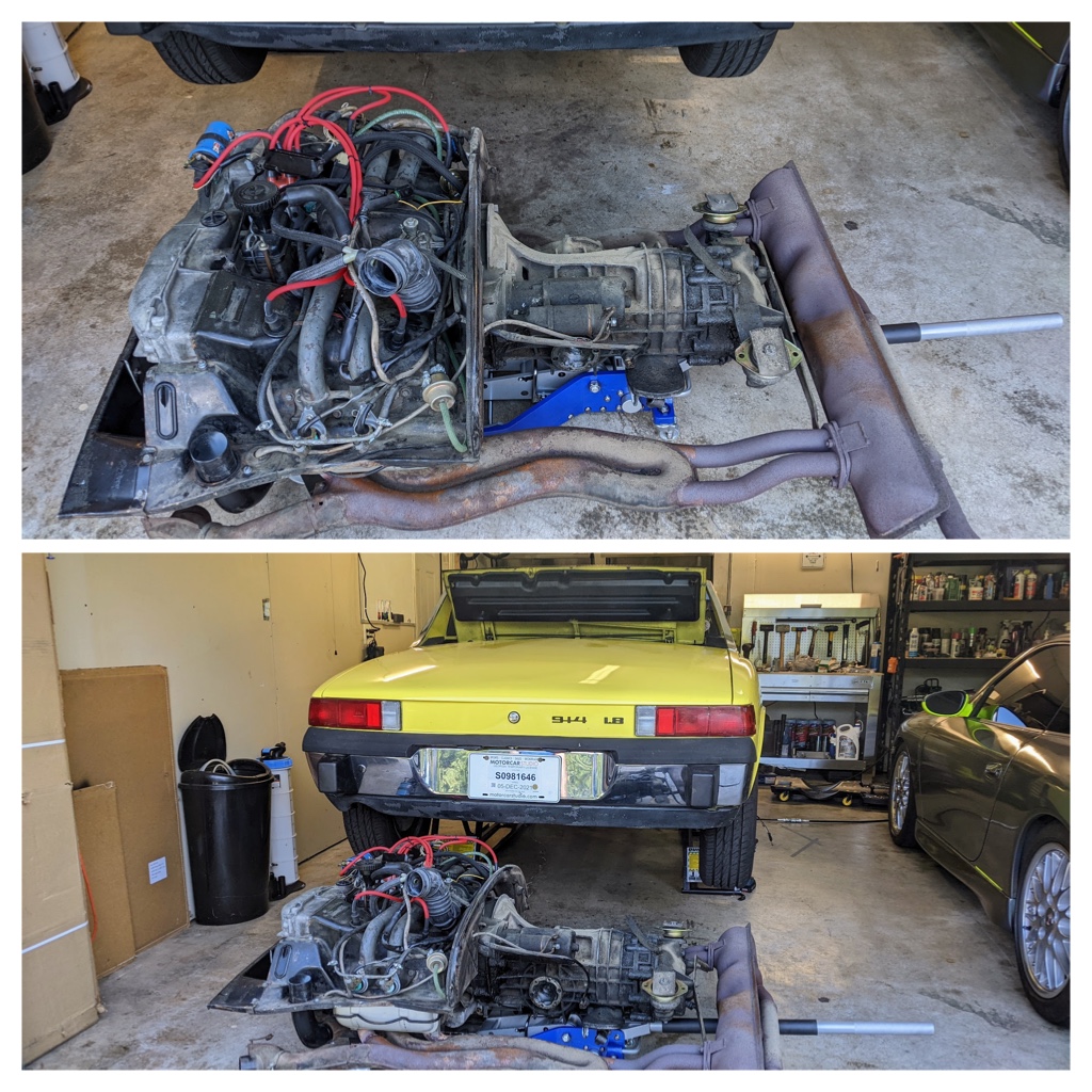

Day 1: removed the engine (IMG:style_emoticons/default/beerchug.gif)
