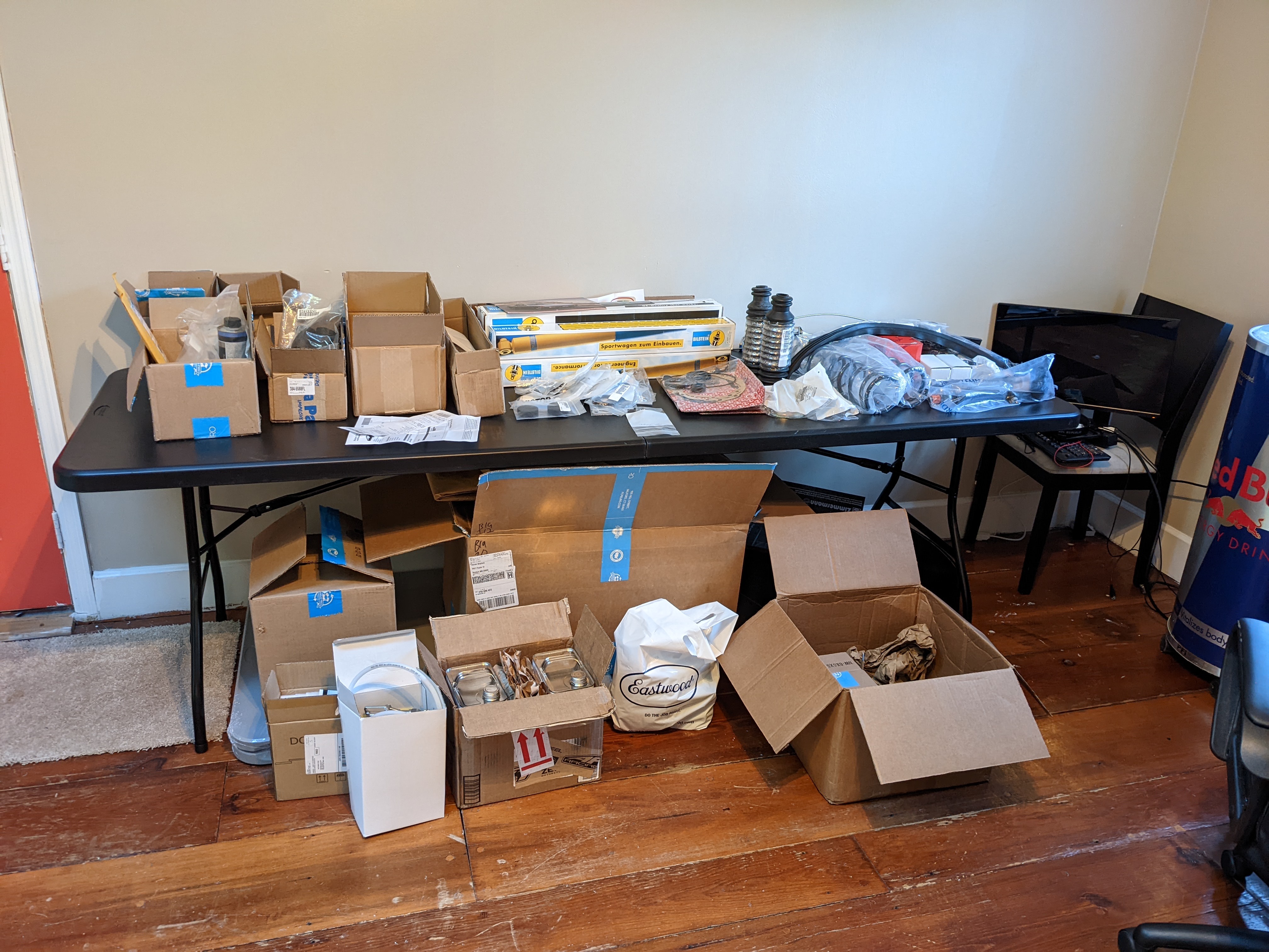

Evening 914 World!
I’ve been gathering parts over the past few months and have finally reached critical mass. So, let the project thread begin!
After working on the FI through the winter, I’m satisfied that the engine remains in good health with it’s original 53k miles. However, the rubber and plastic holding everything together is a different story.
Which brings me to the scope and objective of this project. In short, I am looking for what I will call, “Improved Original”. What the phrase means to me is that I want to maintain the character and feel of the original car, but still take advantage of any and all modern improvements that will either, improve reliability, safety, operability, or any combination there of. This will include a suspension and chassis rebuild, power train reseal and refinishing, brake system rebuild, and fuel system overhaul.
When I’m done, I want to have a car that drives like it’s nearly new, but doesn’t look over restored. Because the car is a survivor, I think it’s important to keep the stories and history of the car intact.
Finally, I’d like to post my thanks to the community and vendors that make it possible to enjoy this hobby. Stay tuned!
