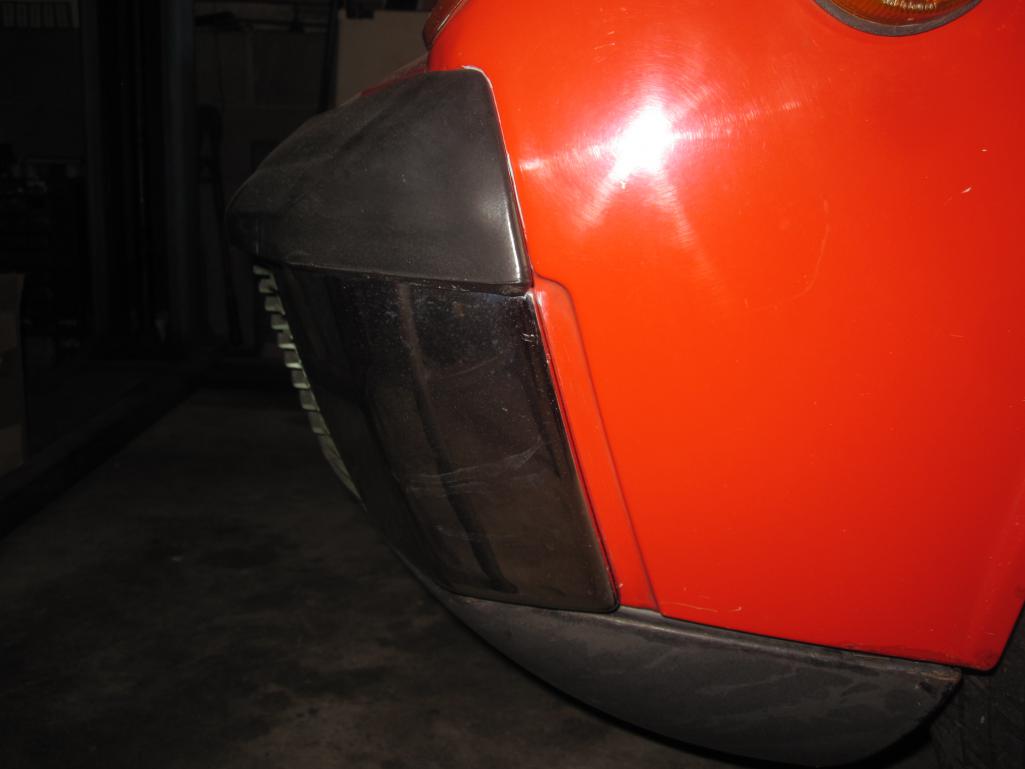

Any suggestions for improving front bumper alignment greatly appreciated. The mounting bolts are fully seated with the appropriate washers/lock washers. Right side is better than the left side; neither are very good. My trusted local body shop declined to try as this is the first 914 they've seen...LOLAttached Image

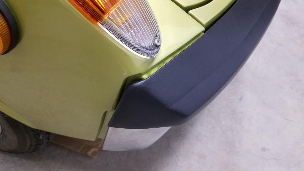

I have FG bumpers. But I had to modify all of the bumper spacers on each bolt to get a pretty good fit. Could not use the factory dog bones. Best, MarkAttached Image

The bumper looks tweeted, brackets could be bent. Also did you install the rubber spacers between the bumper and the rubber bumper pad?

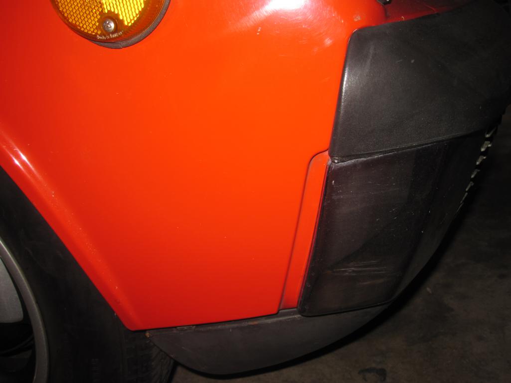

This is the right side. I appreciate all the suggestions!
