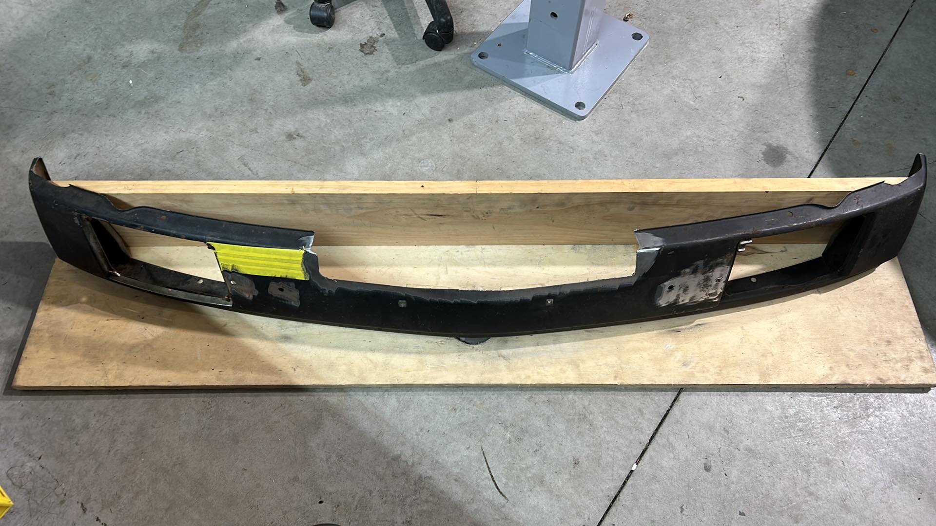

Anywho, I did spot a front bumper on Facebook marketplace for a decent price (I already scored a clean rear bumper for the backdate locally.) The front bumper met a few requirements, mainly that it was not chromed and not severely rusted. Seller sent me a pic of his kitchen sink too! :-D
It looked pretty clean so I made a deal to have it shipped from NC to WI where I asked Ben Mcfarland to apply his metal skillz to customize it for the GT opening.
He sent me a few pics of his progress already and I'm excited to get it mounted up.
I also asked him to delete the license plate holes. That's something I did on my 911 valance and I really like the smoothie look.

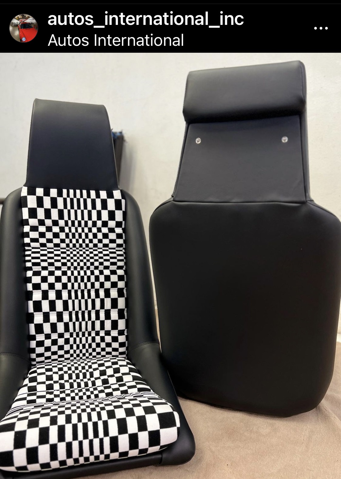

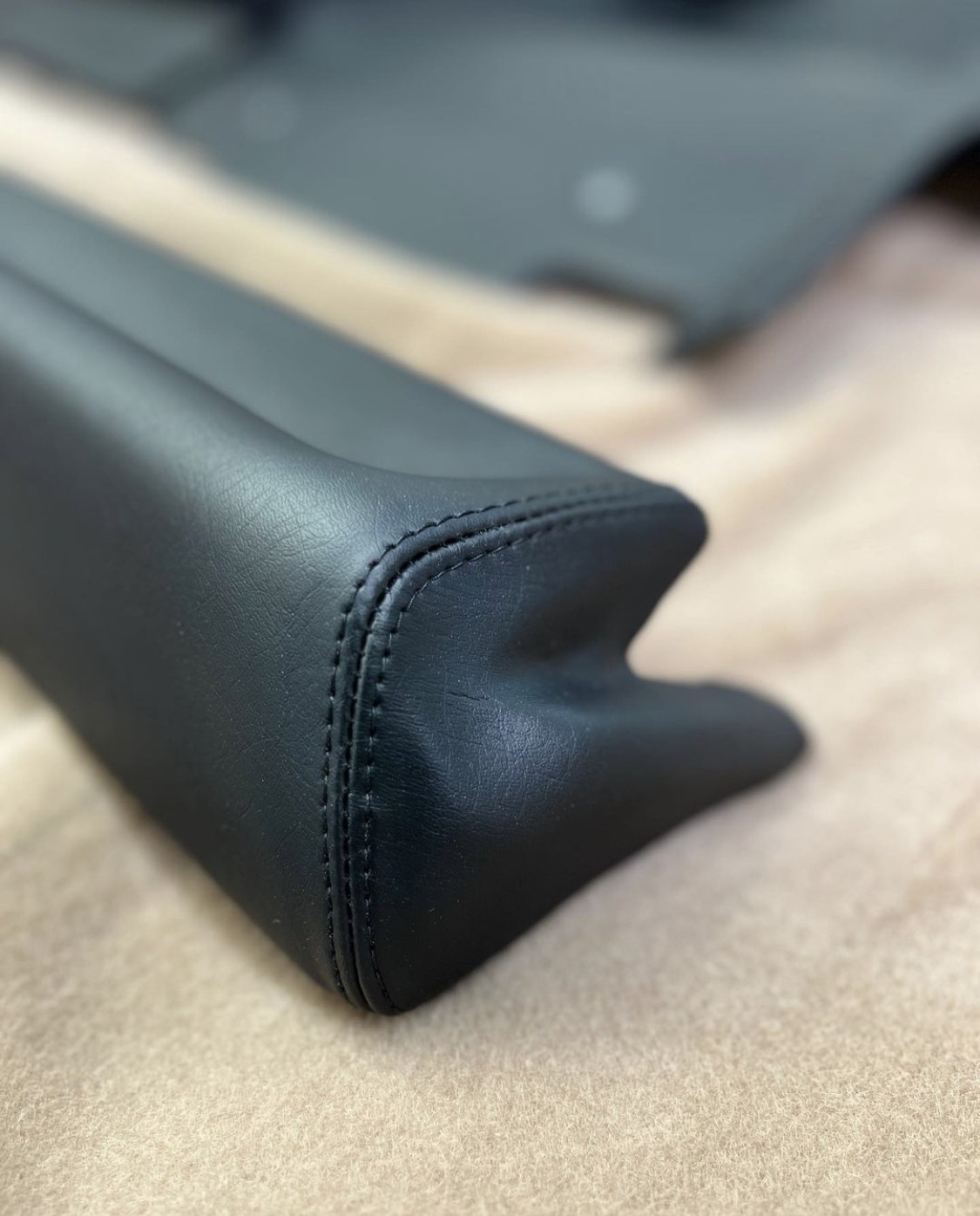

I was able to get my interior bits down to Autos International in SoCal. Initially, I had my buddy take just the seats, the dash upper and lower, and the rear pad behind the seats.
My friend John had some extra interior bits that he brought down to give to our interior guy and without me knowing. John offered to let me have them, and after thinking a bit more about it, I decided to use the targa pieces he brought down. There were two front targa pieces, the back and the two back side pieces.
While the originals are still here in Vegas, I had only planned to reuse the side pieces as they were serviceable as is. I already purchased new front and back pieces from 914 rubber, so I thought I was done with those pieces.
After looking at the 914 bits, they are OK, but I thought it would be better to have all the interior bits recovered with the same material from the same place.
That's going to be a nuts bill when it comes up, but the Targa interior pieces are so important. They need to look great and feel great and they are high visibility for the project. I want it all to match too. It would have been a shame to put nice seats and dash in and have it not match.

When it rains, it pours. I got a call from Ollies Engineering AND Autos International telling me my engine machine work and interior was complete. I was hoping to space those two bills out a little more, but you never know with items that take long lead times.
I haven't been able to swing on down to ollies yet, but I did have a friend pick up the interior this weekend and bring it back to Las Vegas.
Here are some pics from Autos International:
The backer pad turned out beautiful, I want to thank Matt Whitesell, and Scott from 914 Rubber for the assist on that.
I thought it would be really fun to do the interior in Pascha. The material is a beautiful authentic Pascha Cloth that I think was sourced from Germany.
I've always loved that pattern and I think it will look great inside. I know the 914 never had Pascha as an option, but since this is an outlaw build anyway, I'm just having fun.
What do you all think?

Details, details, details. Autos International nailed it and just earned a future customer! (IMG:style_emoticons/default/wub.gif)

He also had a full stock 914 front end, but I have no use for that as I have a donor 911 front going on.
Lastly, I picked up a Rennshift 901 shifter and ordered the Tangerine racing firewall bushing. That will really improve the shift feel and look at home in my new interior.
